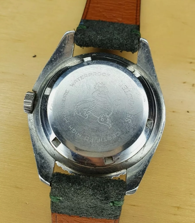

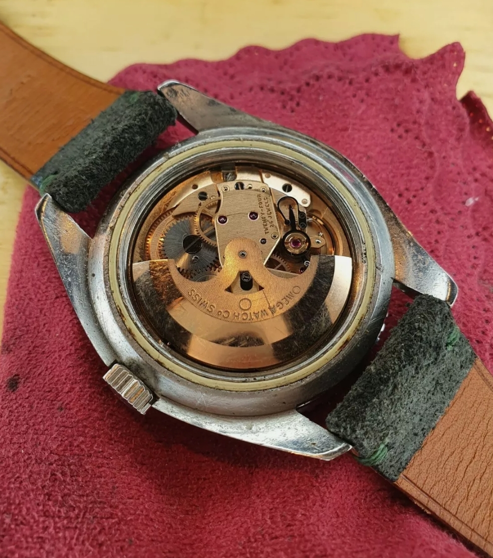

Seen a vintage 1969 166.024 Seamaster for sale. 565 movement, looks in a pretty good condition. An absolutely lovely watch. Dial looks a bit too perfect for this age, redial perhaps?. He advised the dial is original and said the signed crystal on the watch is very rare.

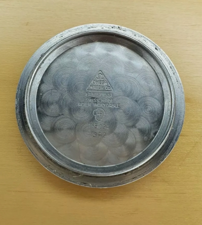

Although caseback states 165.024 the seller said "the case back has been restamped. Omega did this a lot especially with the 165. and 166. models as they used the same cases so restamping meant they could use the same parts for both."
Just wondering if any specialists knows any more info on that.
Any advice on it and thoughts on value?
Thanks

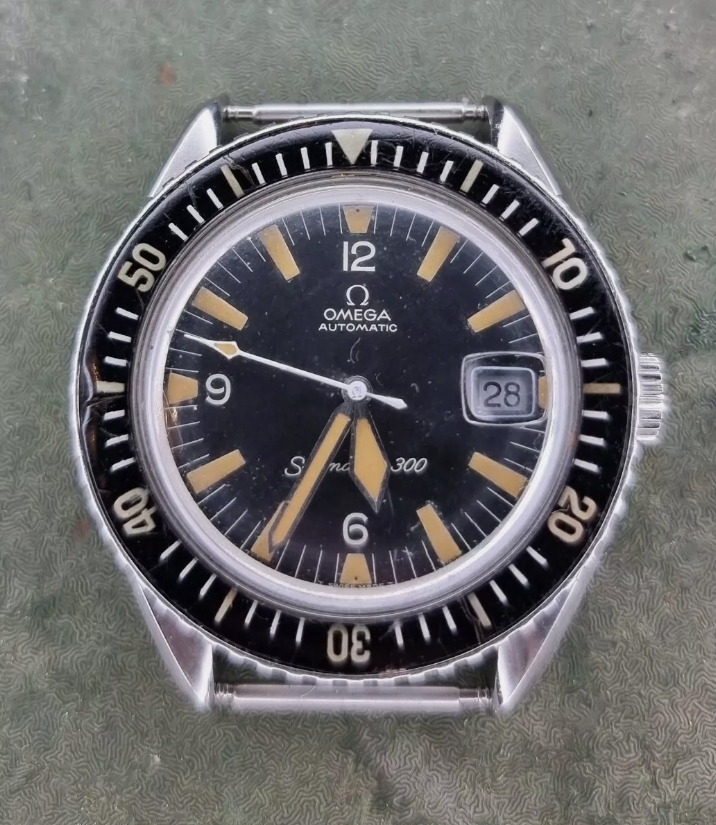

565 movement, looks in a pretty good condition. probably, serial-number???
An absolutely lovely watch. Dial looks a bit too perfect for this age, redial perhaps?. yes, I doubt the colour of the lume...look at the difference to the bezel
He advised the dial is original hm...., the dial itself: yes
and said the signed crystal on the watch is very rare. no

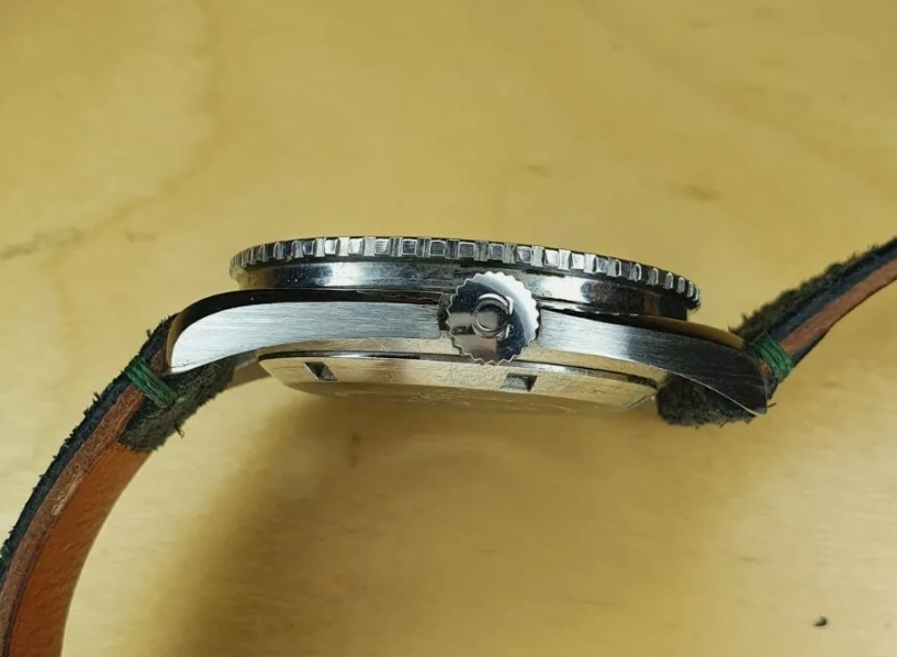

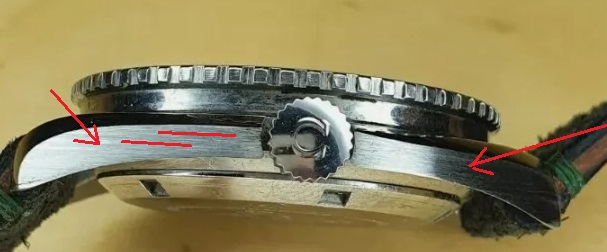

The case is unpolished馃憤 (picture 4)

"That particular signed crystal is very rare as they didn't provide them as service parts. My watchmaker who is a big collector sold one recently for over 拢300."

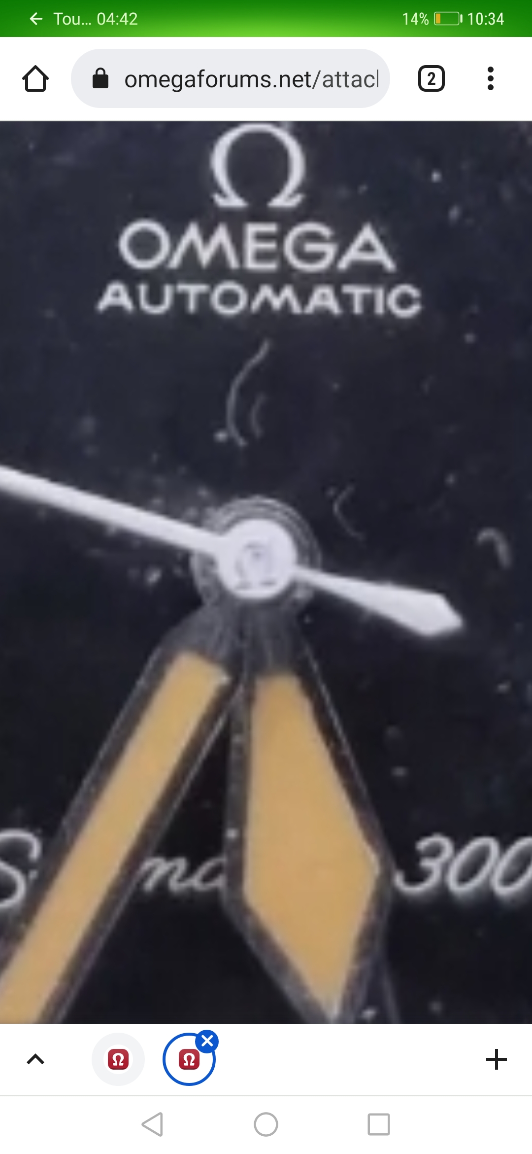

Do you not think that's the case?. Pardon the pun. It does to me look like the crystal has an omega symbol in the very centre, which I thought was on the originals.
They stopped doing them down the line.
Redial or relume but what do you think of it overall, still worth it?

Also see attached photo of omega symbol on crystal I was referring to. Meant to attach to last message
I don't think so, look at the different done lines here:
That's no Omega standard
Minty sides and the caseback doesn't match at all
2,859
5,987
IMO the sides are not polished....馃槙 and the horizontal lines are visible and original 馃槙

IMO the case sides have been refinished.

Ended early as it was listed as a 165.024, seller realised the 165 was a no date and it was in fact a 166. Other than that the description was the same. As I said earlier regarding the restamping on the case back, apparently it was common with these models. Either that or its a date version case back.

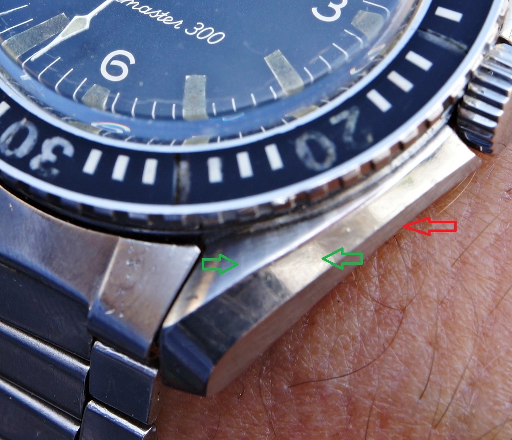

My opinion
green: polished red : grinded
The only polished surface is the top of the lug, so the middle arrow. The left green arrow is a brushed finish, and so is the case side.
Given the condition of the rest of the watch, the case sides have been refinished.

Polished/refinished/stamped or not it is overpriced at your guy's listed offer.

Many questions from the pictures.
and you asked for opinions
if you go to sell, questions remain, and your market will be newbies with uncritical eyes.
Now, if you like it and plan to keep forever, then it is a good price.
