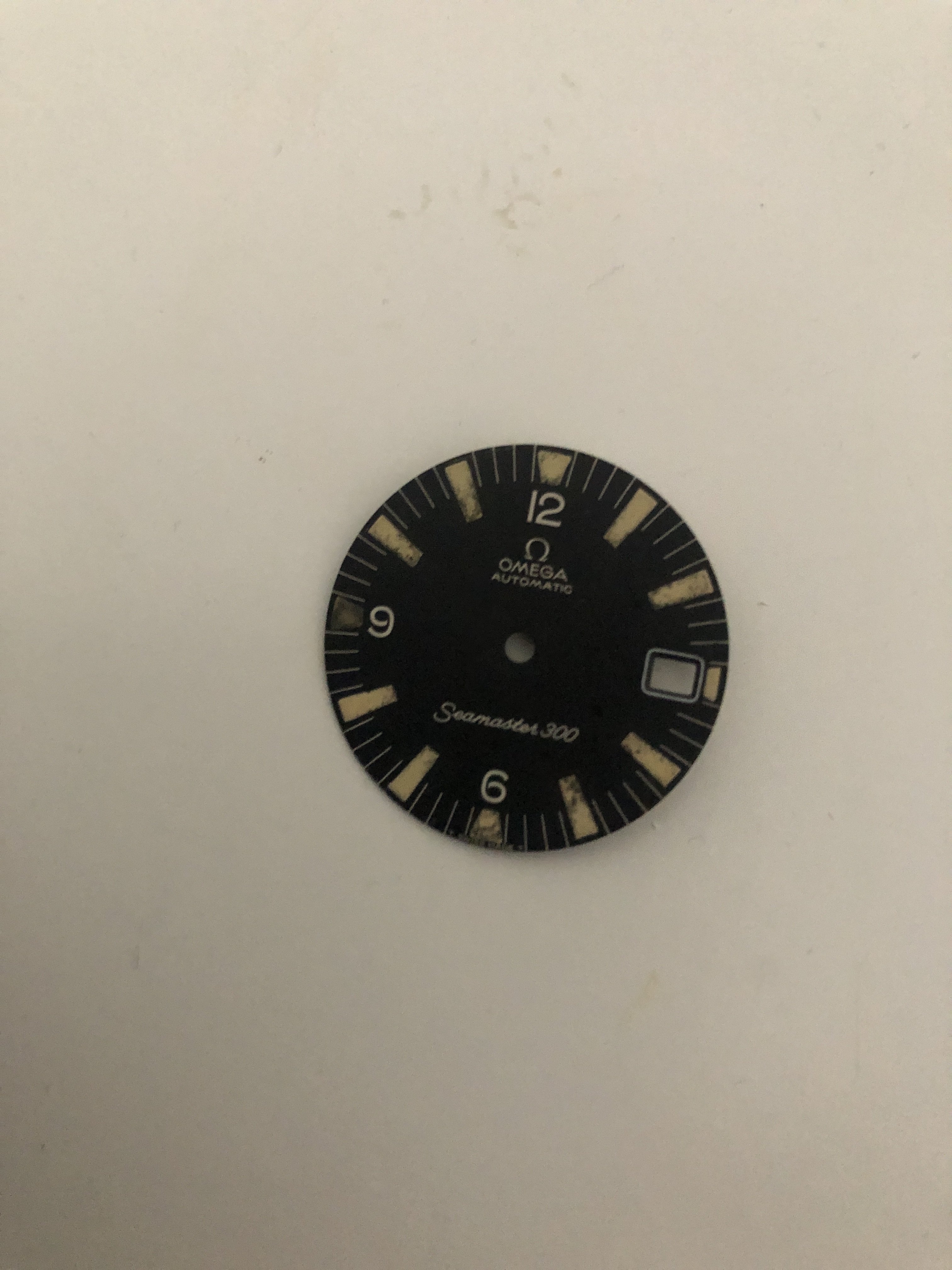

To the OP it appears you have a genuine Seamaster 300 that's received service parts. Requesting an 'extract of the archives' from Omega will hopefully confirm that the movement originally came in a 166.024.
The reason this is important is because service cases, bezels, crowns, hands and dials are still available for this model. What this means is that many people (individuals and dealers) take movements that original came in a DeVille or Geneve and make a 'new' Seamaster 300 out of service parts. These 'WatchCo Seamaster 300's' as they are commonly known use genuine parts but are not original and as such are not worth what an original watch is.
Once you've confirmed that at it's heart your watch is a vintage 300, you then need to decide whether to put the original dial and hands back on. Almost every Omega collector in the world would advocate reinstating all viable, original parts.

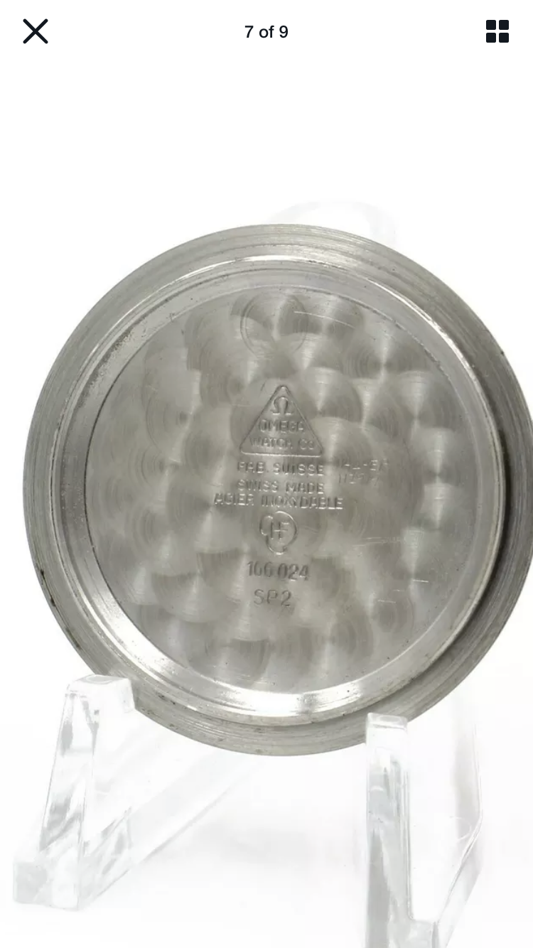

Quite a few parts have been changed there. As noted above, how you did rather depends on how much is original. You may have in essence a Watchco with a few unrelated spare parts thrown in, or you may have an original SM300 watch in kit form. The bezel and caseback do look like replacements though (is it 166.0324 in the back or .024?) so if you haven't got those, then I would think its nearer Watchco than original.

Agree with @padders an inside picture of the caseback will help along with some pictures of the sides of the case. My gut feel is that's an original rather than a service midcase.

Hi thanks for the reply I’m not going to do anything with it just wear it and love it .I was just after as much information as possible on it . In the past I’ve purchased some dubious sea masters 120 but everything thing I’ve got with this it seems correct but sometimes it’s best to get a better opinion sorry for the confusion cheers Dave

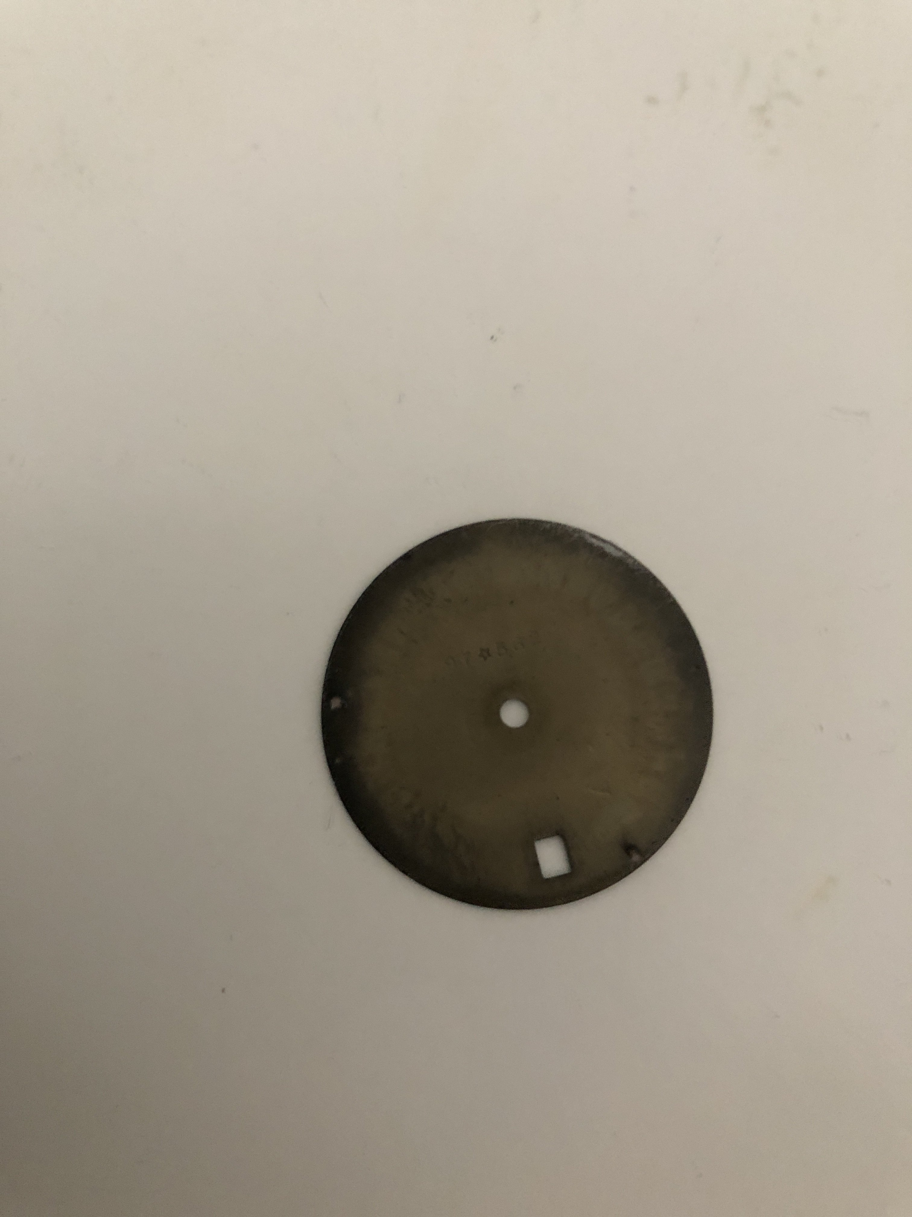

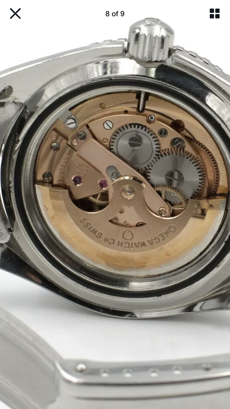

Hi it’s has a 563 movement 17 jewels for the us market and a 166.24 in the back of the case the original dial has a number 97*562 on the Back of it
10,309
16,137
Looks like it is mostly original then with a few replaced parts. An extract will tell you if its 100% as the only remaining question really is did the movement start life in a SM300 case, sometimes they didn't but this may well have done.
12,966
22,489
Good to see the case back is correct.
So do you have any plans for it or are you leaving as-is?
If it were mine, I’d be reinstalling that vintage dial and handset and requesting an extract.

I will keep all the old parts safe and maybe reinstall them at a later date also I will get extracts from the archive later when I get better photos of the movement does it take long to receive back thanks again for your input
