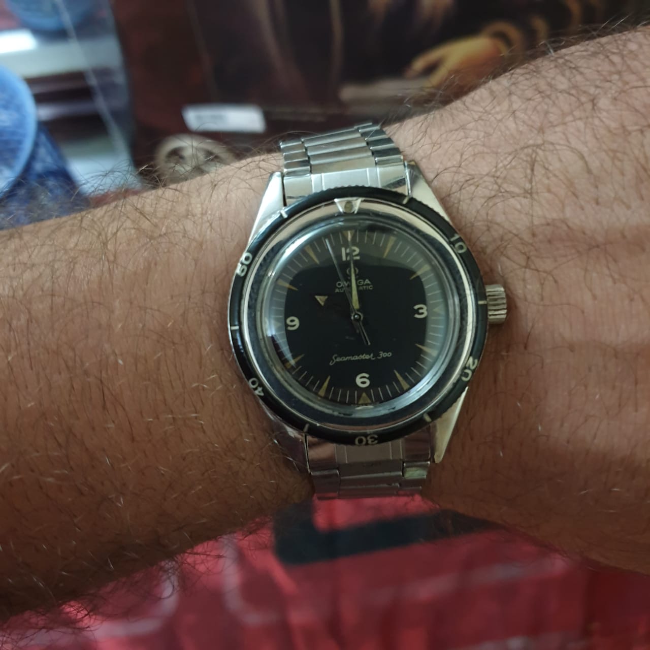

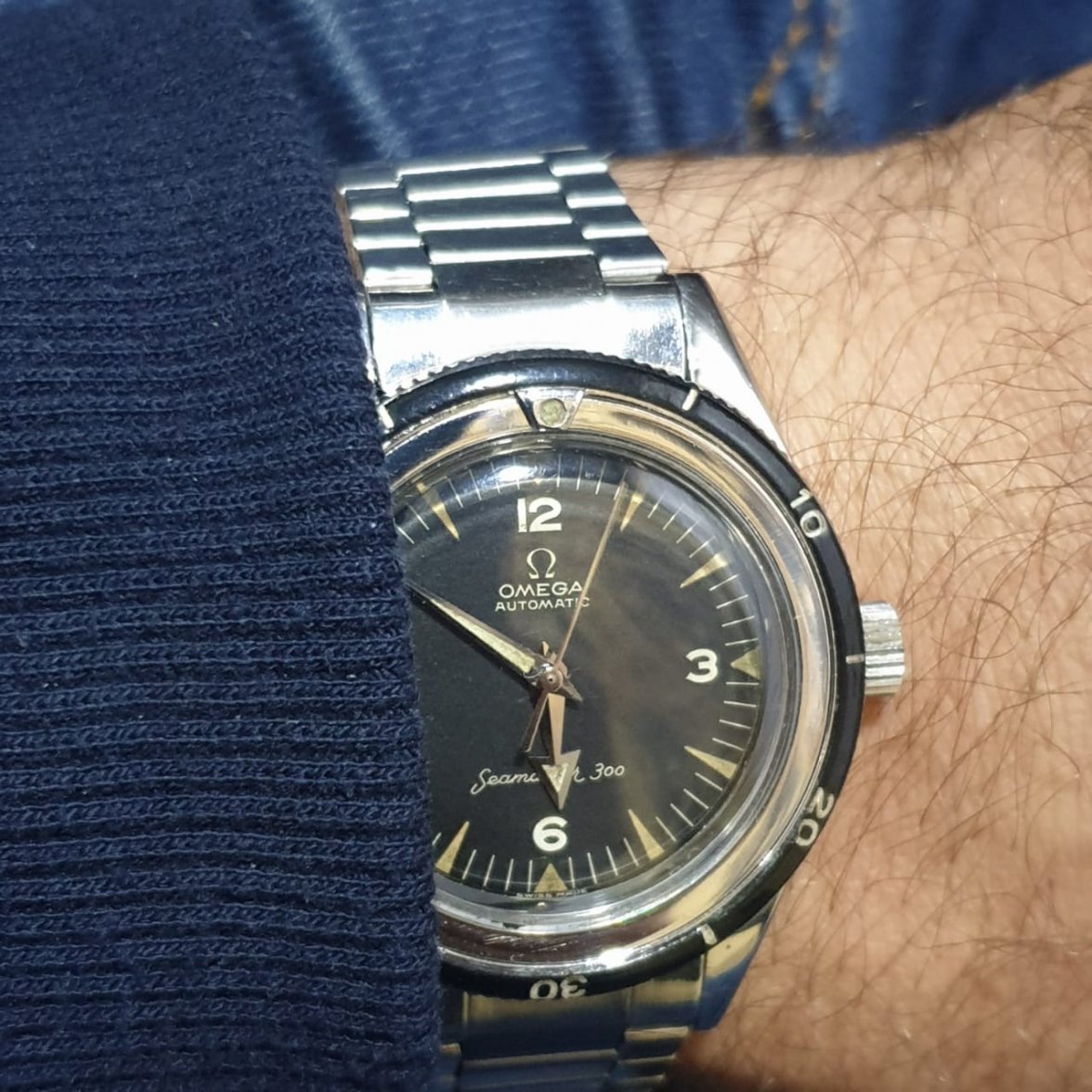

Saw this beauty at my local watchmaker's and I'm considering making an acquisition.
He and I had a question on the handset. Are they correct for the watch or should the arrow be on the minute hand?
Any other comments on the watch are appreciated, but I believe everything else is in good order.
Thank you in advance,
AA
609
789

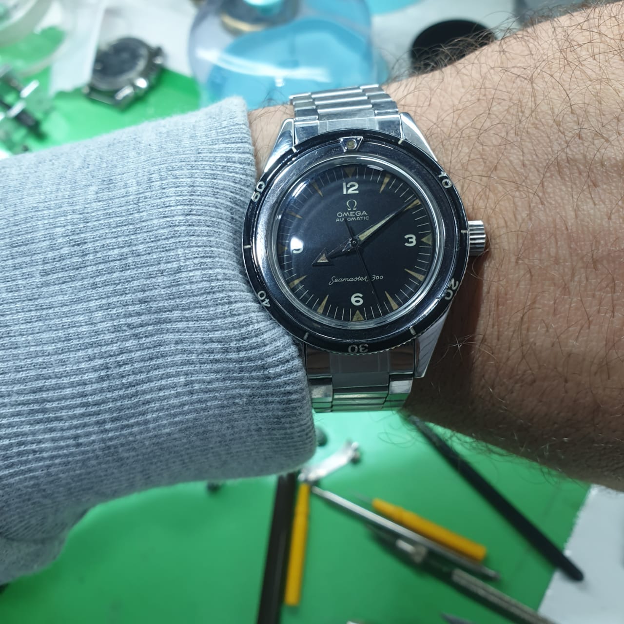

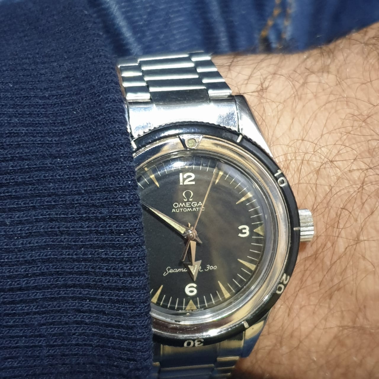

I knew that the 14755 had the broad-arrowed minute hand, i.e. the reverse of the CK2913. Mine has.
somebody will come up with “transitional” specimens, but should be uncommon IMHO
f.
265
783
I wouldn't expect to see broad arrow hands from a 2913 on a 14755, but those look like service hands to me rather than originals.

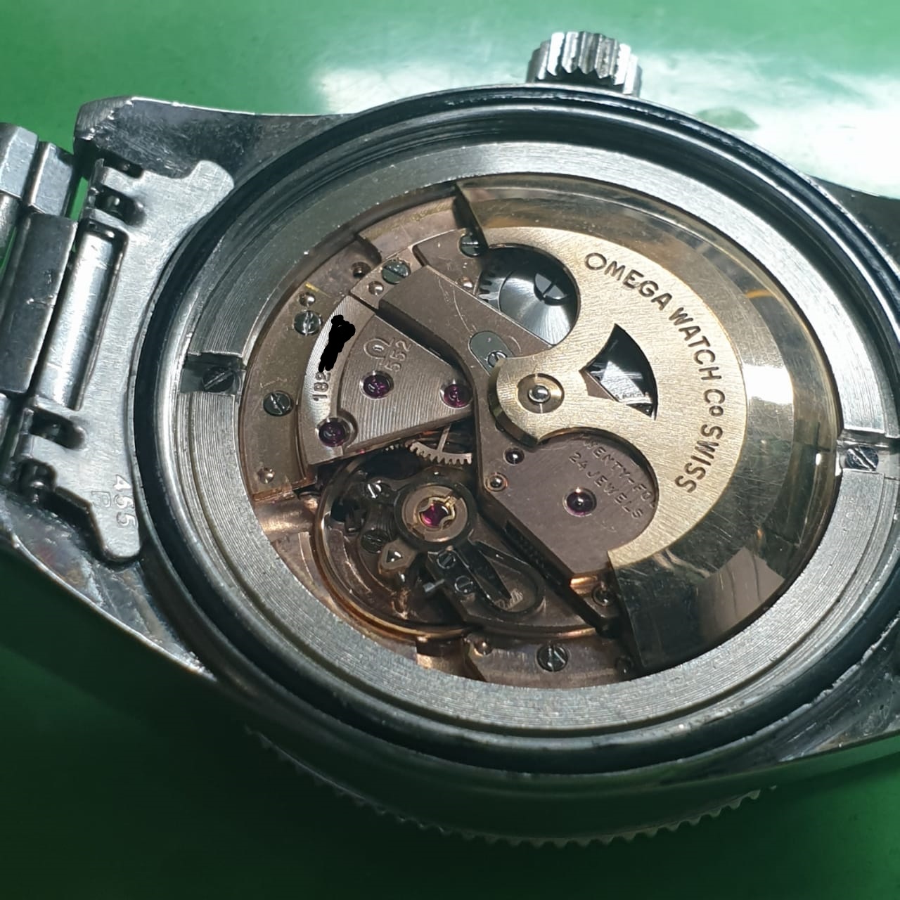

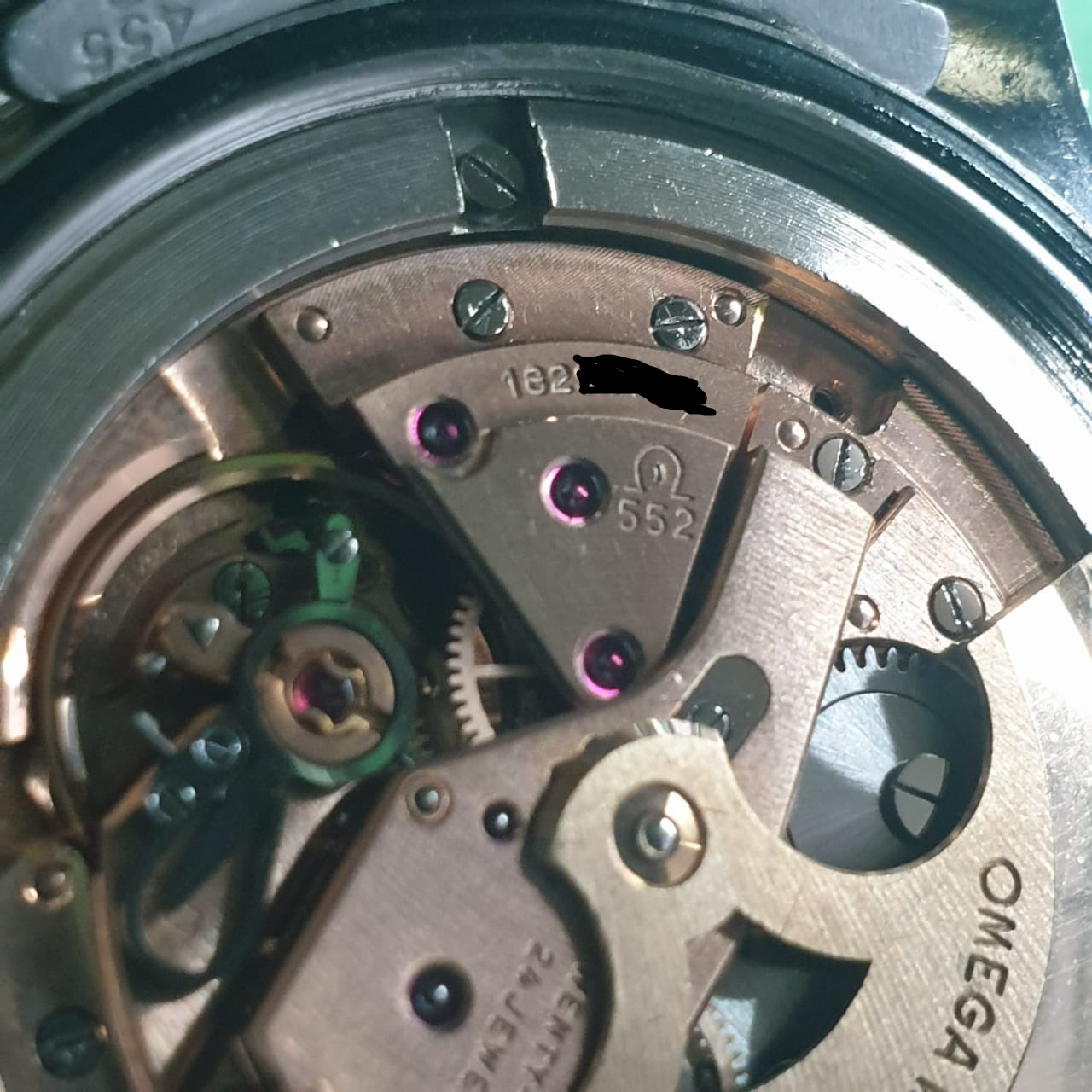

18.2m movement number is good for a 14755-1 or -2, the bezel has been redone but quite poorly. It all depends on price I suppose!
As a side note - I'd be interested to see the bracelet, those look like Rolex end links?
2,774
10,129
they look poorly relumed and definitely not correct...and not 2913 or Seamaster hands at all for that matter.
Bezel and crown are not correct either.

Thanks everyone for the input.
One I pointed out the feedback to the seller, he confirmed everything. I'm staying away.
