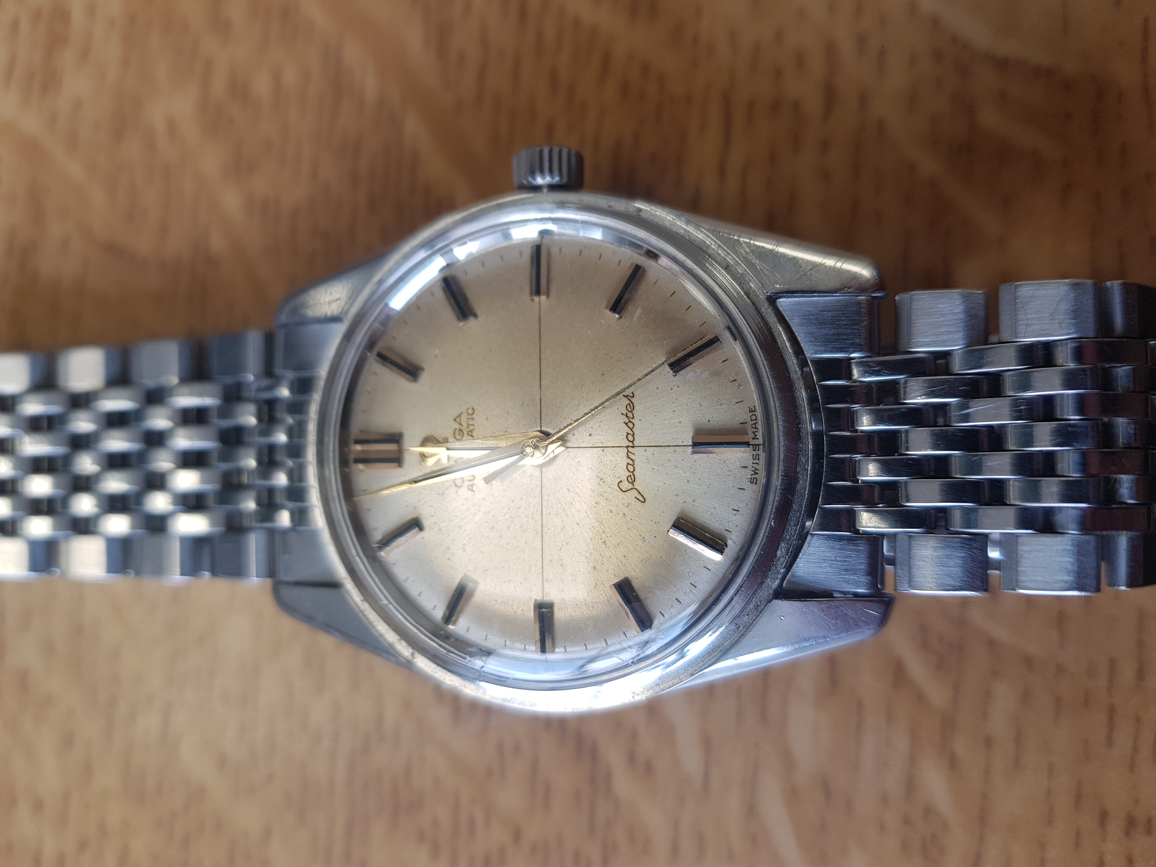

Hi OF members,
I finally got to wear my Seamaster 14700 2 CS in public and the bezel has popped of and is now lost to eternity. Please can I have your help in identifying the part number required for it's placement?

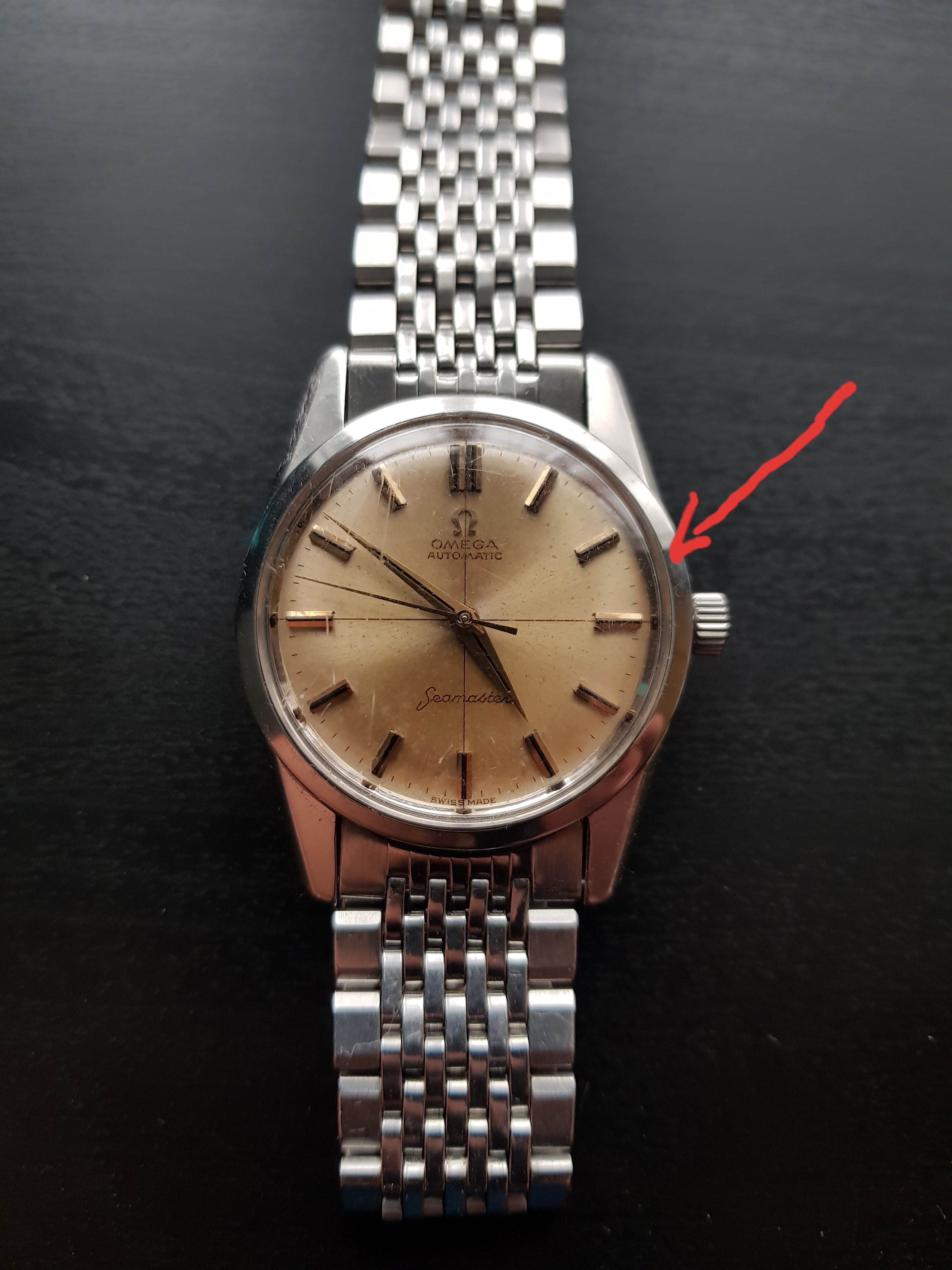

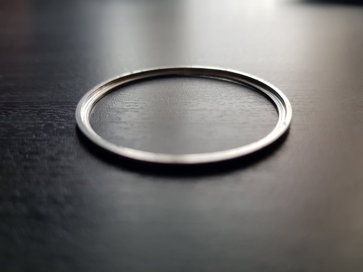

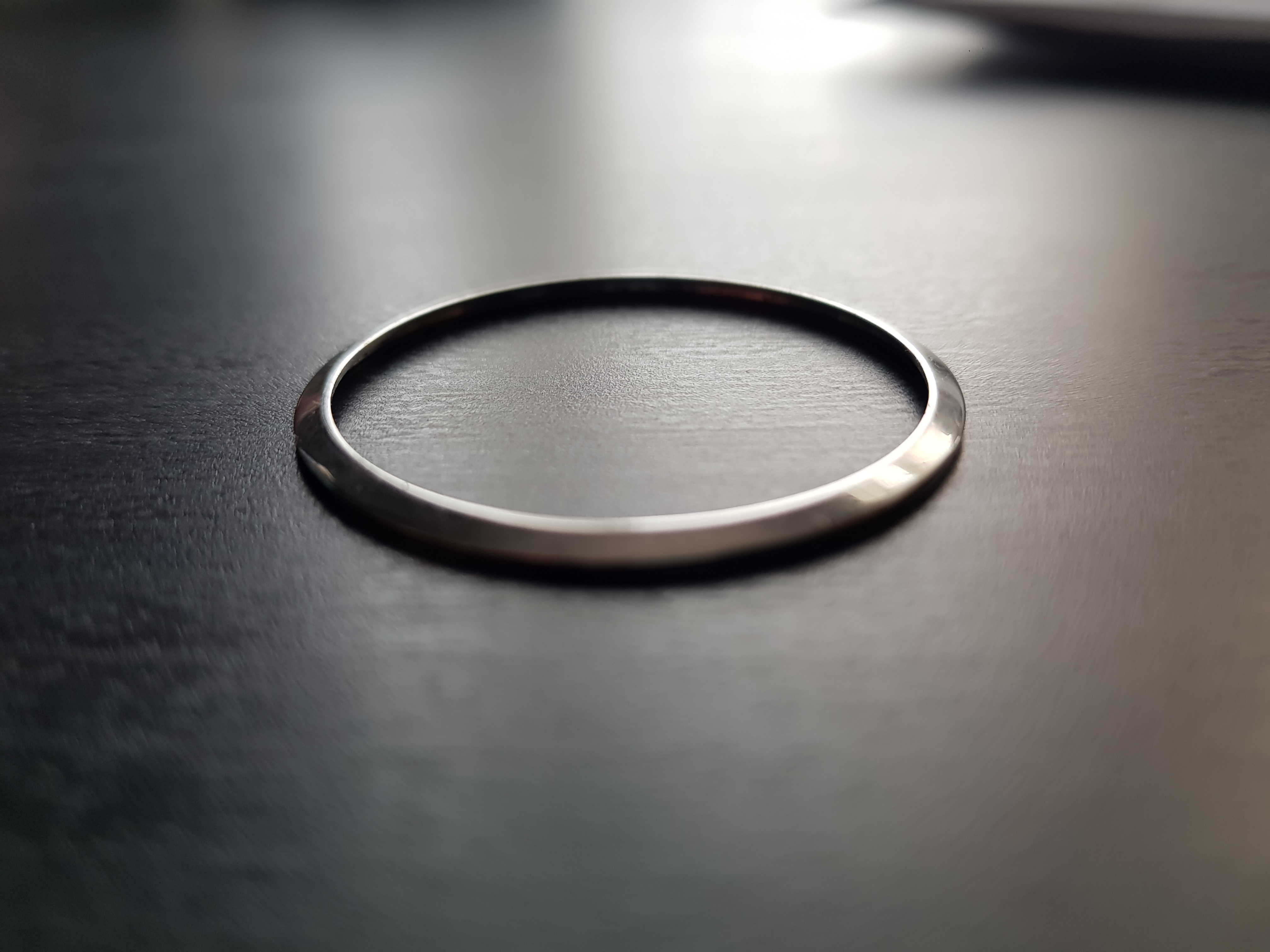

Thankfully I was able to find the bezel but have found that the bezel keeps popping of. Is there a knack to getting the bezel to remain in place? I not sure if the bezel may have distorted since cleaning.

These usually need to be attached with a press providing the case and bezel are in good condition.

Hi @X350 XJR would the press be something I'd be able to purchase or would you recommend giving to a watchmaker to do?

I would just take it to a watchmaker, they should know if it "feels" right when they put it on, in good condition it should have a fairly distinct click or snap when it goes on.
