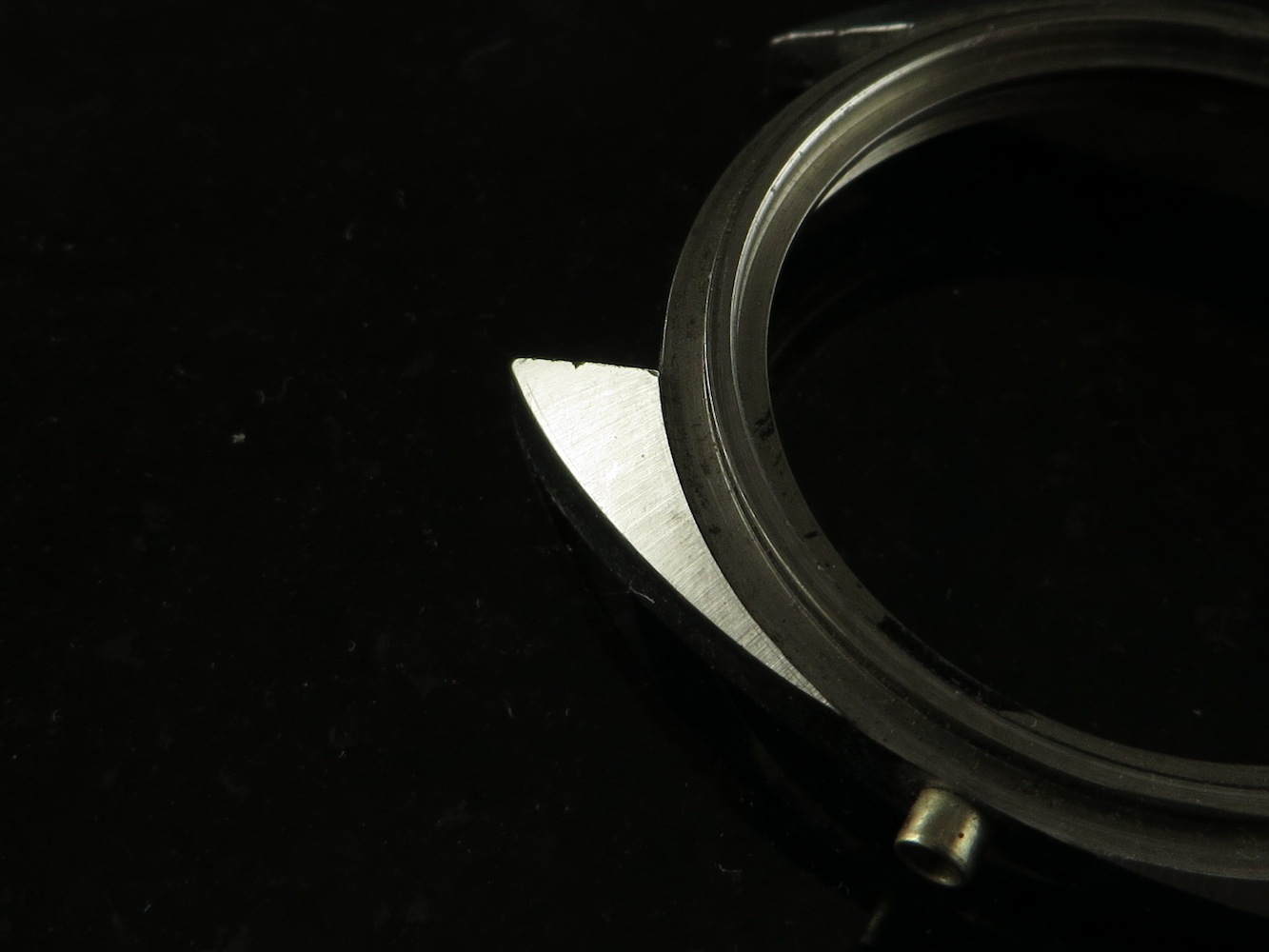

Looks great.
Case finish on these is the typical sunburst brush with polished sides.

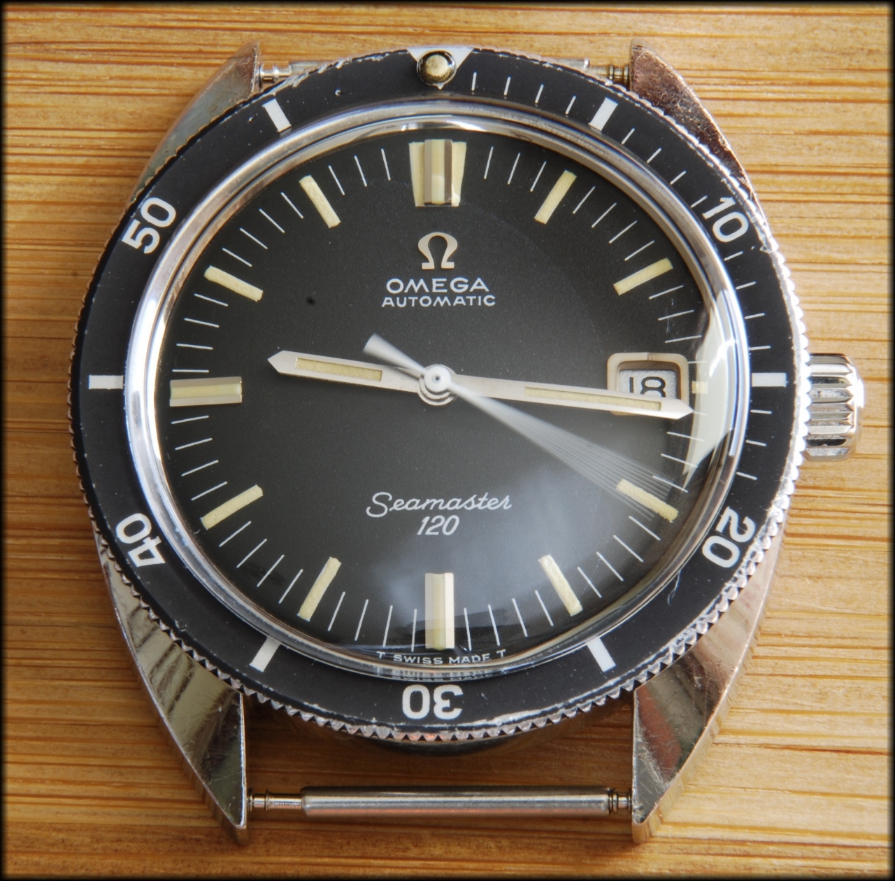

Thanks Norman. I knew I would not be lucky enough to get one with an original finish. Mine is a polished finish on both top and sides but, I think I will keep it like that as the bezel is not 100%. However, it has come together nicely and the bezel is now mounted.
Overall, I am quite pleased with it and with the many positive comments and interest here.馃榾 Still a few things to do...

Amazing to watch as you have transformed this watch back to its former glory and whilst the bezel may not be 100% it's still very nice for a vintage piece but unlike you I would definitely look into getting the case refinished back to the original. I do know of a couple of firms that do this in the UK although not sure how long the wait or the cost if you don't have it serviced at the same time if you want further details just PM me.

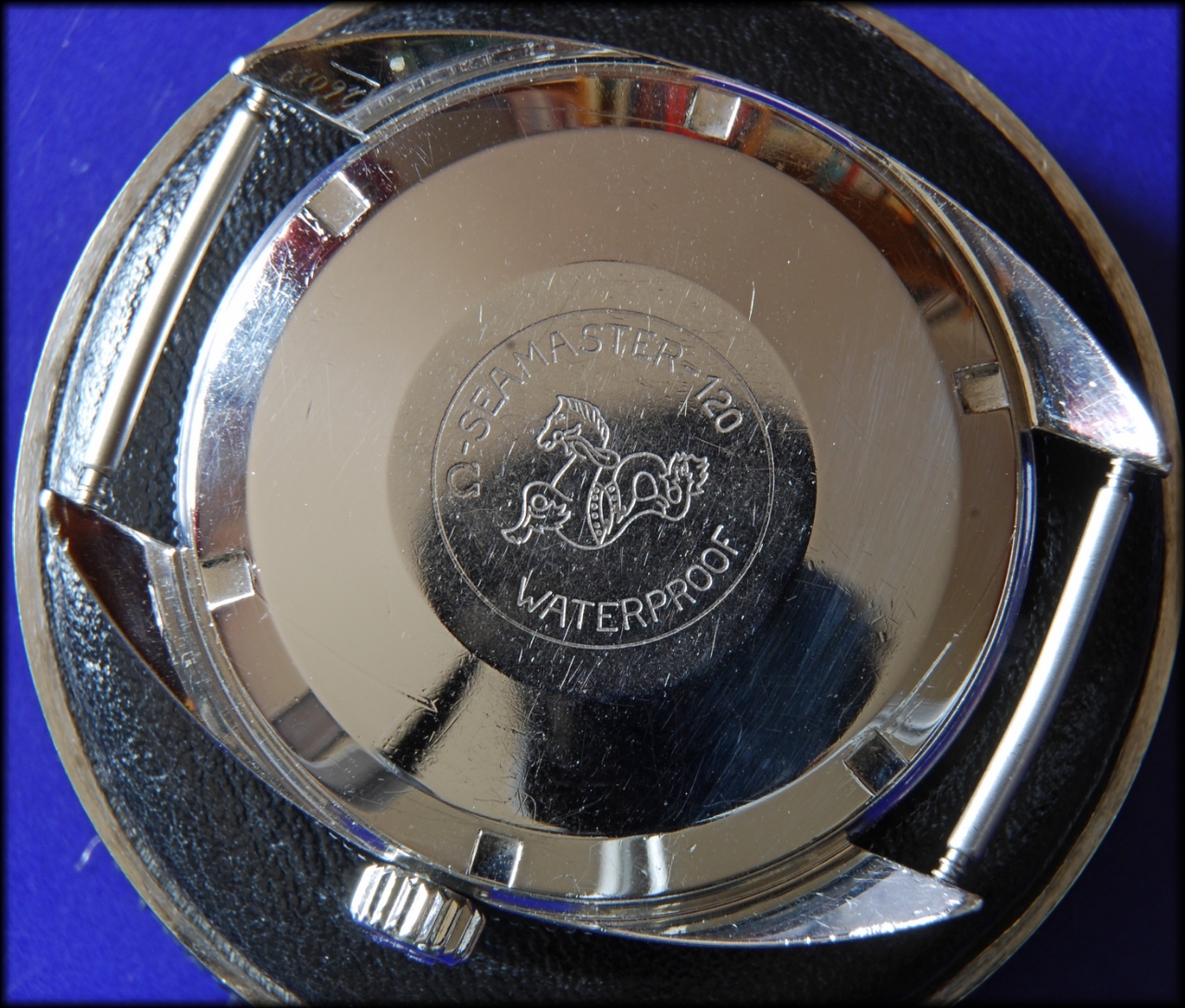

Picture of the caseback:

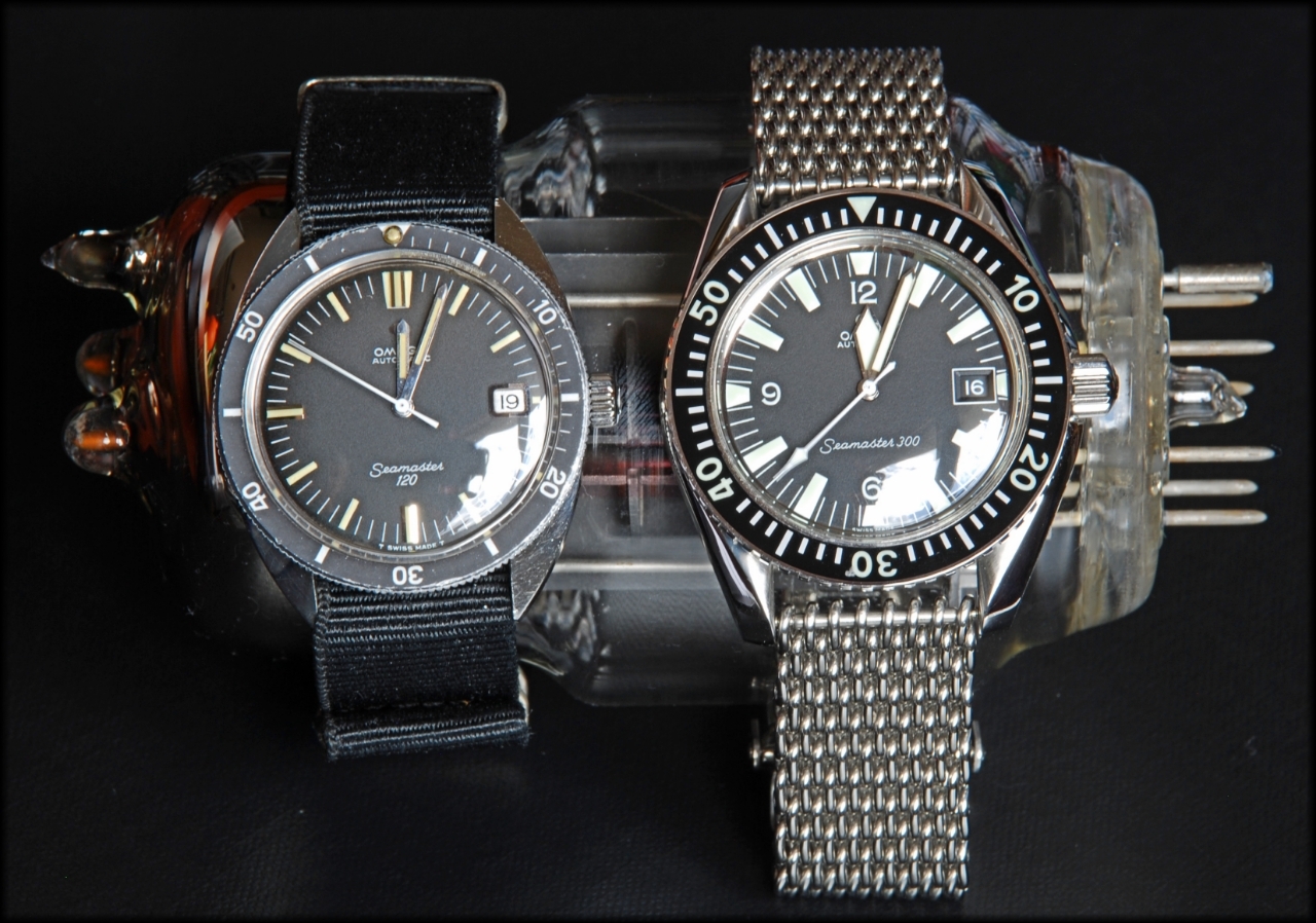

Picture with big sister SM300 'continuation' mounted on a 6C-33C MIG-25 radio valve (http://www.tubetvr.com/favtube.html). I'm using the word 'continuation' in the same way as Jaguar do here馃槈 :
http://www.telegraph.co.uk/motoring/11032018/Jaguars-lightweight-E-Type-in-pictures.html
The SM300 was the first movement I worked on in earnest with a logic that even if I screwed it up, it was just a couple of hundred dollars at risk. Hard to screw up the case etc and that is where the big expense is here:
Thanks for all the positive comments and will let you know how the next project goes (anyone have a cheap SM300 available? I think not馃檨 ).

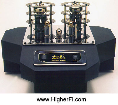

Am I sensing original Quad IIs? I have KT66s in my Marshall 2266 but my hi-fi uses these little known monoblocks from Kora in France. Sadly, Kora went out of business a few years ago. Setting these up correctly with new valves (mine are 20 years old now) is akin to watch regulation. The power valves are not cheap (four as well for me) but hardly in GEC KT66 territory.
Perhaps a thread divergence here!
Picture from the web:
34,264
