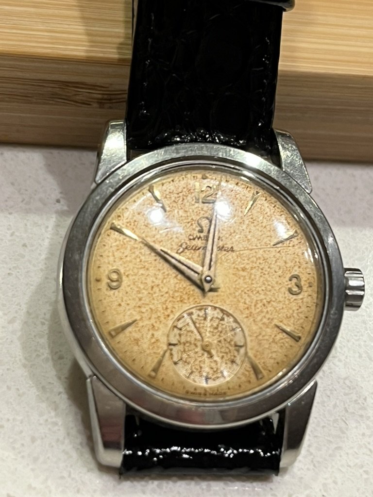

Hey all - Long-time lurker, first-time poster. I'm a bit lost on a Seamaster that I've been offered, and I'm trying to figure out if it's a Ranchero one of the many Seamaster variants. An estate company I've worked with for a few years is prepping a sale, and found a box of watches in storage, and this was in there.
Initially, the dial looks like the 2990-1s I'm finding online. However, there are two things that are kind of throwing me off. The first is that the lugs look thicker than the other 2990-1s I'm seeing, and they look like soldered lugs rather than one smooth line.

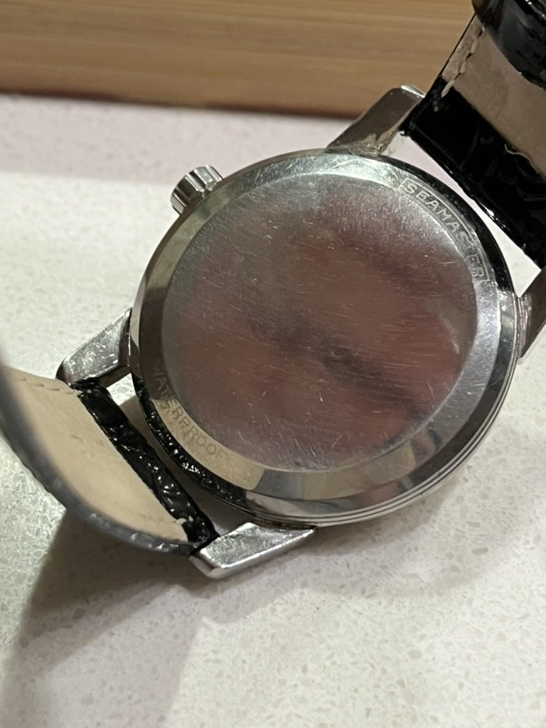

Second is the caseback. Most 2990-1 casebacks I've seen only have Waterproof stamped on, but this one has Seamaster also stamped on.
Finally, the crown looks a bit out of the norm. I have found some that have a similar crown, but I'm kind of assuming this was a replacement. Perhaps not, but I know next to nothing about Seamasters, Rancheros, and Seacheros.
The seller is going to take it to a watchmaker to open the case back and take photos, but they're not sure when they are going to get to that, and I'm looking to get my research in now. I would love and appreciate the collective wisdom and encyclopedic knowledge of this crowd. Thanks!

Nothing ranchero about it. It’s a 2759 ref manual wind Seamaster with it’s quite rare original crown (only 2759 and 2761 had this crown).
3
Aah! That's why I love this forum. I know a bit about speedy's and other sport watches, but nothing about Seamasters. Thank you!

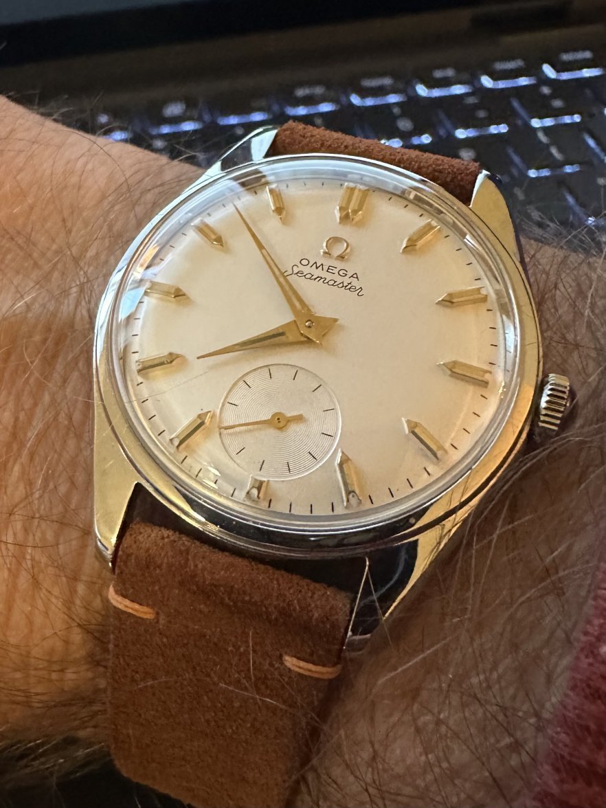

seekingseaquest has it exactly right. Seacheros come with several different styles of dials and hands, but they will all have a Ranchero 2990/2996 case. Here’s an example from my collection.
3
That's a good looking watch!
