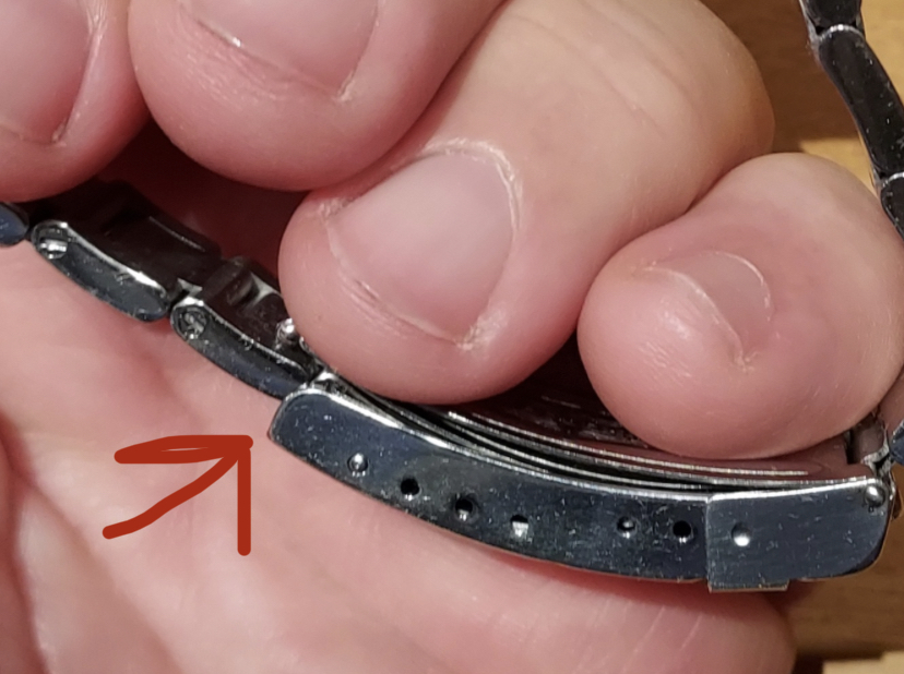

good morning,
i am an omega fan, mostly flightmaster, but I have inherited the sea dweller watch from my father, and i am also more than happy
it's a 1995 model (will post pictures)
my concern is that at this moment the bracelet is a little tight for me, it is tight, and summer is being an intense thing, now it is at the maximum of the possible regulation, i will not need a lot of extra size, but
that is, I must add a link to the bracelet
the question is that now the clasp is very well centered in my wrist, so question is to know where I should add it so that the clasp remains centered,
this is in which of the two sides of the bracelet should I add the link, if i am not mistaken the possibility of adding a link on both sides is present
any help will be very welcome
some images of the new old friend...
6,609
26,776
I think you’ll want to add the link on this side of the bracelet:
This way, the extra length added will be taken in under the clasp when you fine tune the fit via micro adjustments. That should help you keep the clasp in the center 👍

thank you very much, it is a good advice,
I will give it a try

Generally the 12 o'clock side should be longer than the 6. Often considerably longer.

So did it as you said, all worked well, used a microdab of loctite medium to Block the screws, now I can set the bracelet lenght for summer/winter
