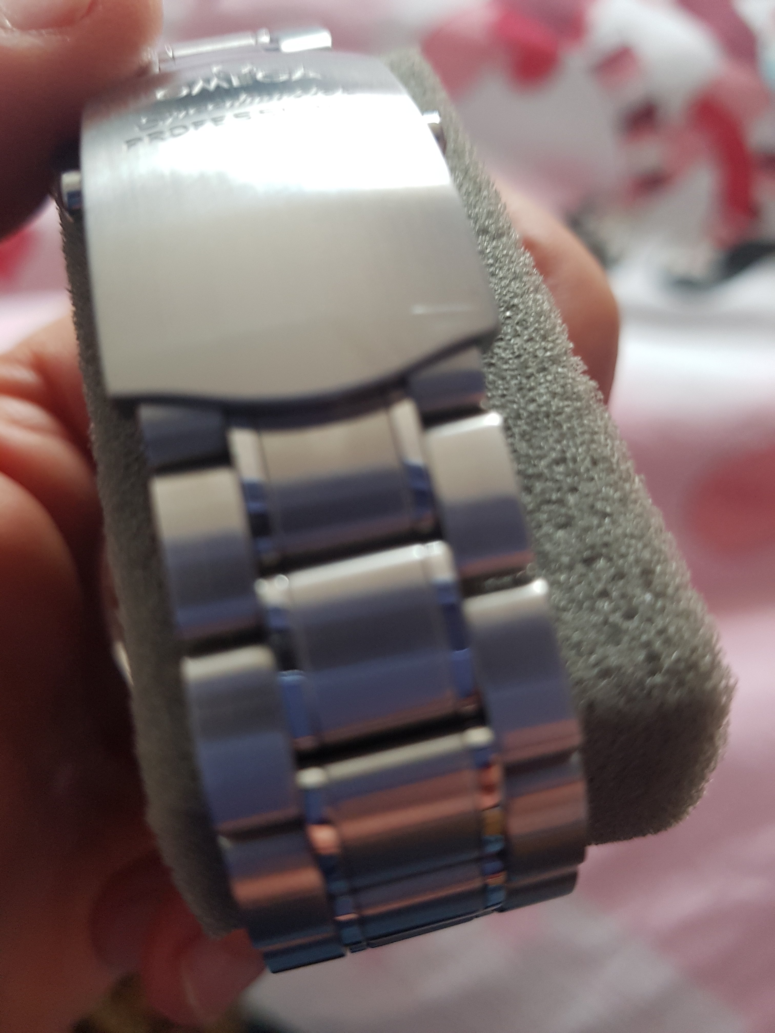

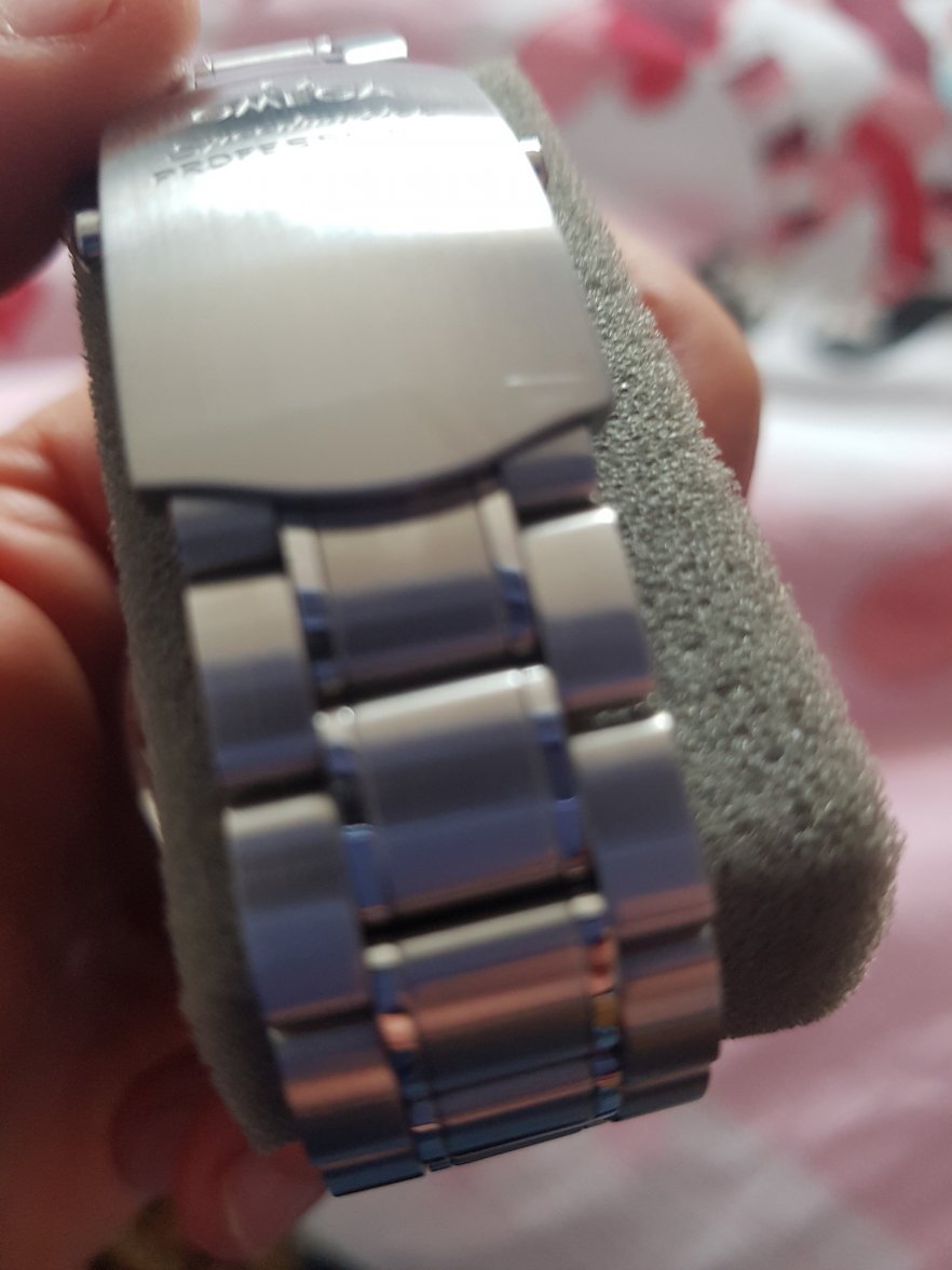

I brought my Speedmaster to a boutique a couple years after buying it to try the sizing with one link removed.
I even asked beforehand if the guy was experienced or will I get a new scratch.
I got my watch back and mentioned this scratch on the clasp is new. He doubted that it was him. I can't say for sure, but it wasn't there a week ago, and the scratch lines up exactly with the pin hole.
So I have a new scratch IMO, and no responsibility taken by the boutique.
In the end, I liked the bigger sizing better, so rather than risk another scratch, I adjusted it back myself, in my basement on a thick towel on top of my clothes dryer. That says something about how I view the level of care by the boutique..I'd rather do it myself on a friggin clothes dryer!
