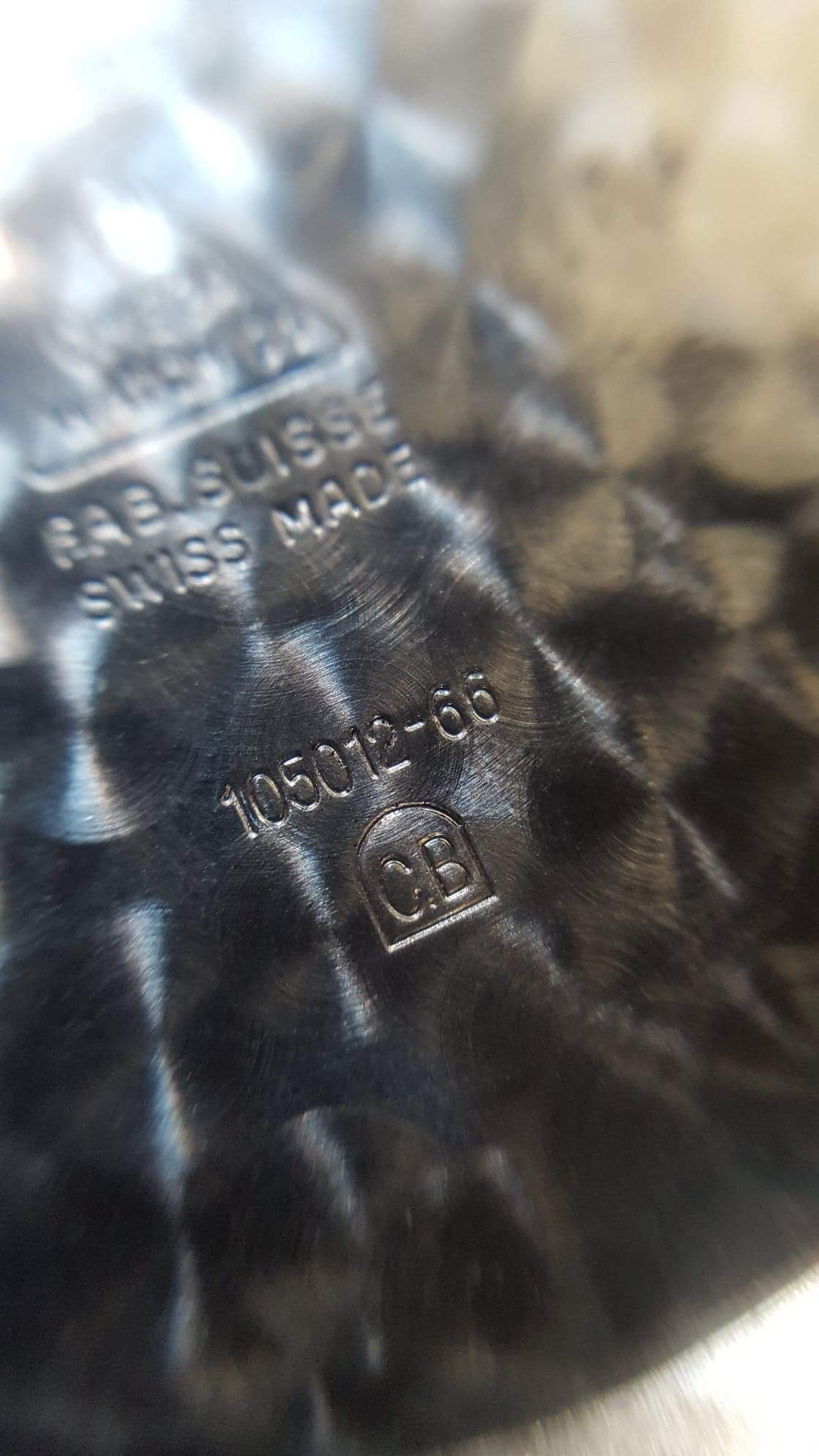

Hello OF,
Being the fortunate owner of a 105.012-66 CB, I am on the lookout for a correct set of pushers fitting the case.
The pusher type I am looking for are screw-in type, fat and short.
Hope this fantastic community can help finding such a pair.
Thanks for the space.

I hope I’m proved wrong but I don’t think fat and short 105.012 pushers exist in screw-in form.

Then I might have another issue, as the watchmaker who tended to the watch clearly told me specifically to source these.
Would anyone else be able to confirm this?

If I am not wrong? CB cases came with push fit pushers.
Some one might have converted the case to screw in.

Meaning my problem is possibly bigger than initially expected...

My experience is somewhat limited, but consistent with what has been mentioned above.
582
1,905
There are converted 105.012 watches. A friend have one which was converted to screw in pushers. The case back has an additional "SP" stamp below the Ref. number.

So probably you need the pushers for 145.012.
These would be same dimensions, but screw-in? I do not have my MWO with me...

This is interesting. So Omega converted some older references (105.003/105.012) to ‘SP’, threaded the pusher holes in the case, and installed 145.012 pushers...
no, they are slightly larger (not as flat).

Screw in yes. Same dimensions no.

This seems likely.

No SP marking inside my case, unless I am looking at the wrong place.

It would be in the inside of case back along with the reference number. I’m not saying yours would be marked SP.

Picture, because we like sharing pictures.

Still on the look-out for this type of pusher if there should be anything out there.

Which type of pushers? Have you decided to go for the 145.012 pushers? I think these are the closest that will fit.

I Am actually thinking if it would be an idea to try sourcing both types, hand it all in to a watchmaker, then see what the outcome will be.
