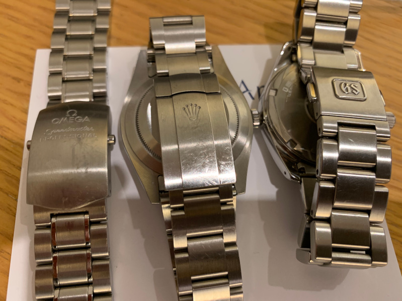

Scratches...how many of you have a...
259
331
Just like cars are meant to be driven, watches are meant to be worn.
So you will have scratches on both your cars and your watches.
If you don't want this to happen, leave the car in the garage, and the watch in a safe.
Of course, i also don't like to see a scracth in the first days or weeks i bought the watch, but after a few months ... hey, that's how life is ...

...scratch or two on the inside surfaces of your lugs?
I just picked a brand new moonwatch and despite my best effort, painters tape and slow tempo picked up some small scratches when I swapped the bracelet for a sailcloth strap.
Granted, they’re tiny and on the downward facing side of the lugs, but it’s still bugging me since the watch is brand new.
Make me feel better and tell me how many of you have something similar on your pieces. Is there any foolproof way to avoid picking these up when using a sharp, metal spring bar tool?
If you do not want scratches on the insides of your lugs, you better not change your strap. Coming out of it without a scratch requires utmost care and a really really really really passionate watchmaker. Will you keep visiting this guy everytime you want to change the strap? Or become one? Nobody got the time, mate. Accept the fact that you end up leaving some scratches everytime you change the strap and try to minimise it with each try. One way to minimise is by using dental floss while removing the strap, but putting it back inescapably leaves some until the spring bar catches the hole.
