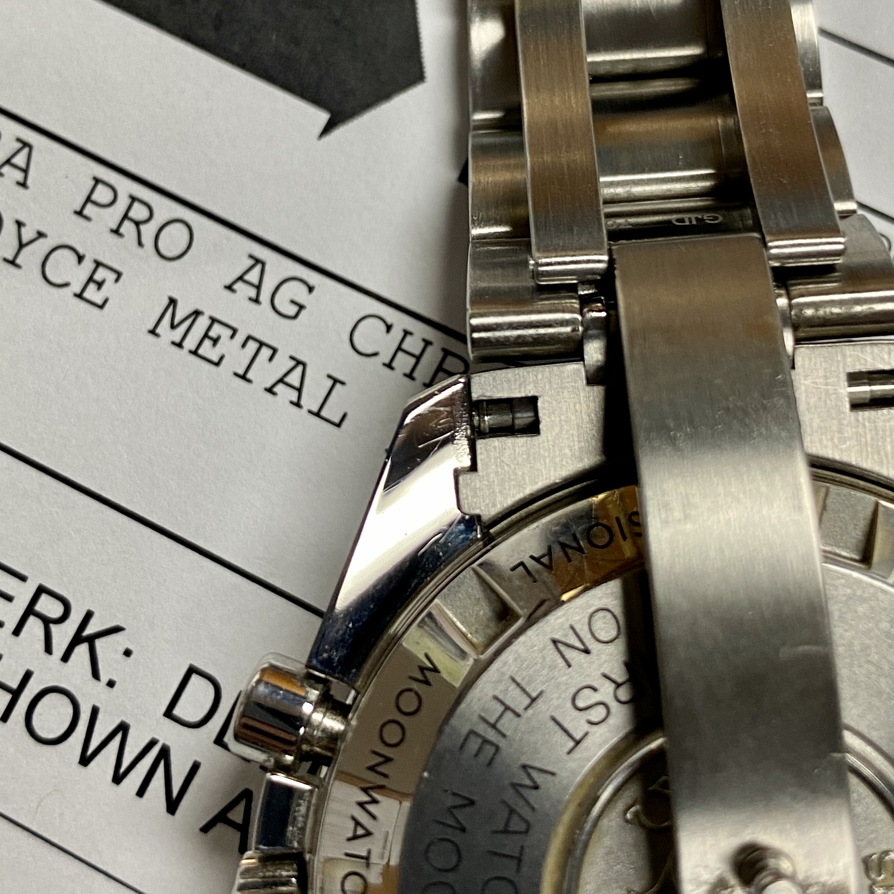

I just picked a brand new moonwatch and despite my best effort, painters tape and slow tempo picked up some small scratches when I swapped the bracelet for a sailcloth strap.
Granted, they’re tiny and on the downward facing side of the lugs, but it’s still bugging me since the watch is brand new.
Make me feel better and tell me how many of you have something similar on your pieces. Is there any foolproof way to avoid picking these up when using a sharp, metal spring bar tool?

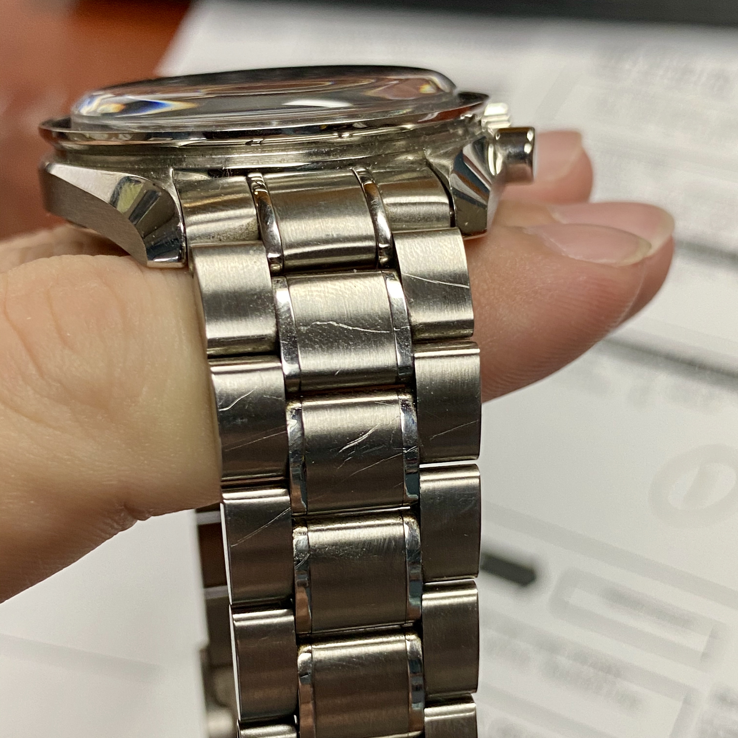

Inside of the lug? My AP Royal Oak has scratches all over the face and bracelet. I used it as my daily wearer from when I first got it in March 2017 to the time Corona virus hit.

I never worry about these marks, it's pretty much expected wear and tear. Even the best watchmakers can scratch a lug or caseback from time to time. As it bothers you however, in the future you could try something thicker like those clear decals used on watch case backs which would provide a bit more protection than the easier-to-tear tape. You can also buy a small piece of 3M paint protection film, like a set made for car door mirrors, and cut off what you need each time. Even that small size would last you a lifetime.

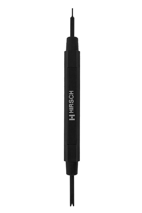

Google plastic spring bar tool 😉

I have scratches... same as you, tiny and on the backside of the lugs. I found a recommendation somewhere to use gaffers tape rather than painters tape. I picked some of this up - it sticks better than the painters tape and hasn't left any residue (that I can tell) after peeling it off. I still get the random springbar that goes under it though and leaves a scratch. Maybe one day after enough practice I'll be good enough to do away with the tape but I'm not there yet.

I ordered one of those plastic spring bar tools and will see if that helps things.
