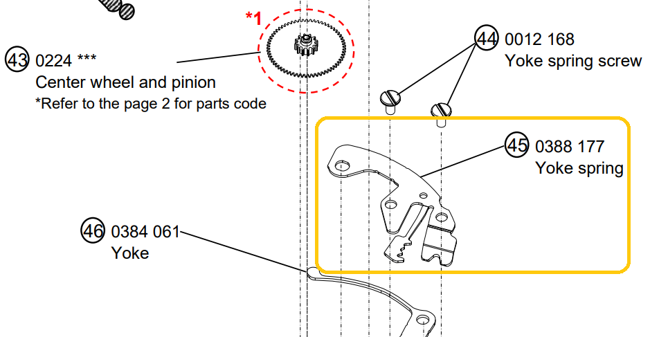

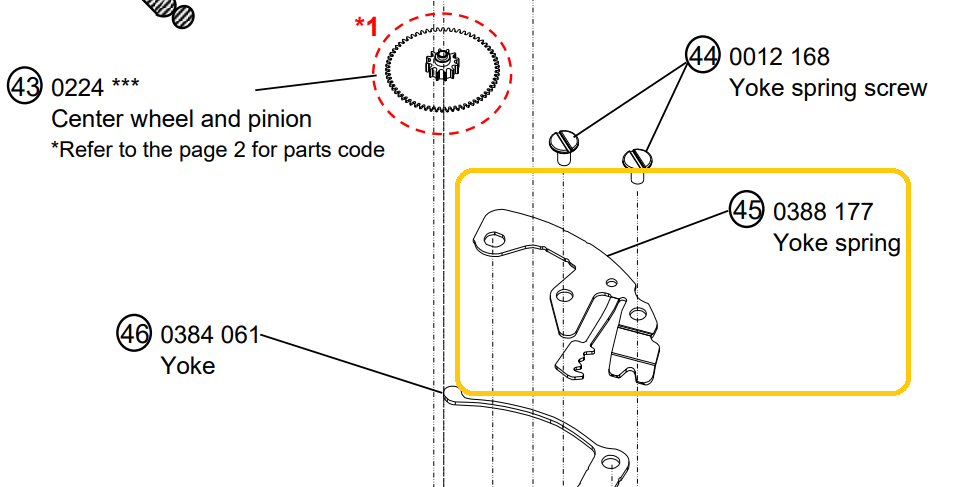

And what I'm calling the "setting lever spring" Seiko (more correctly) refers to as the "yolk spring"...
