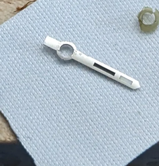

Hello experts!

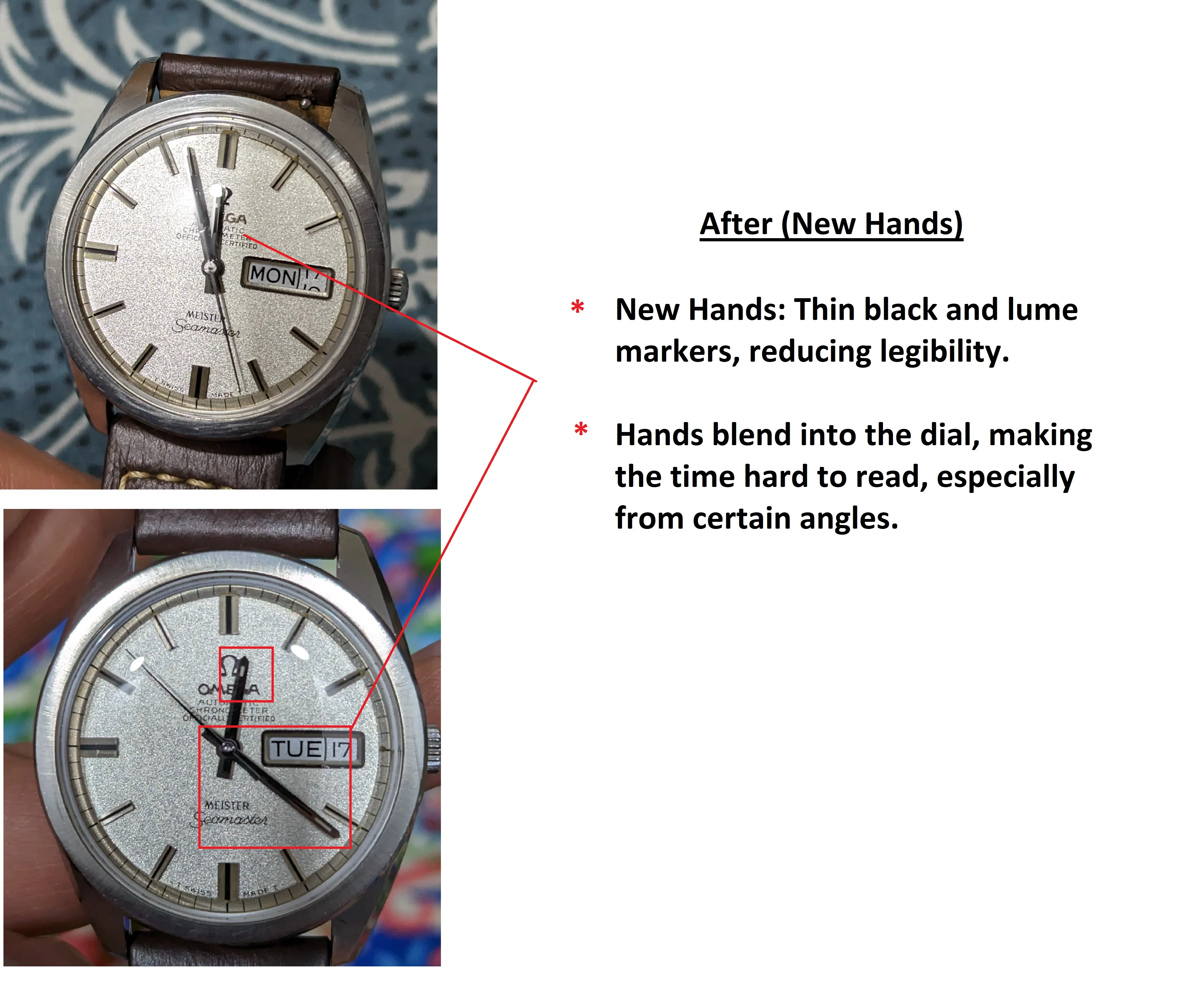

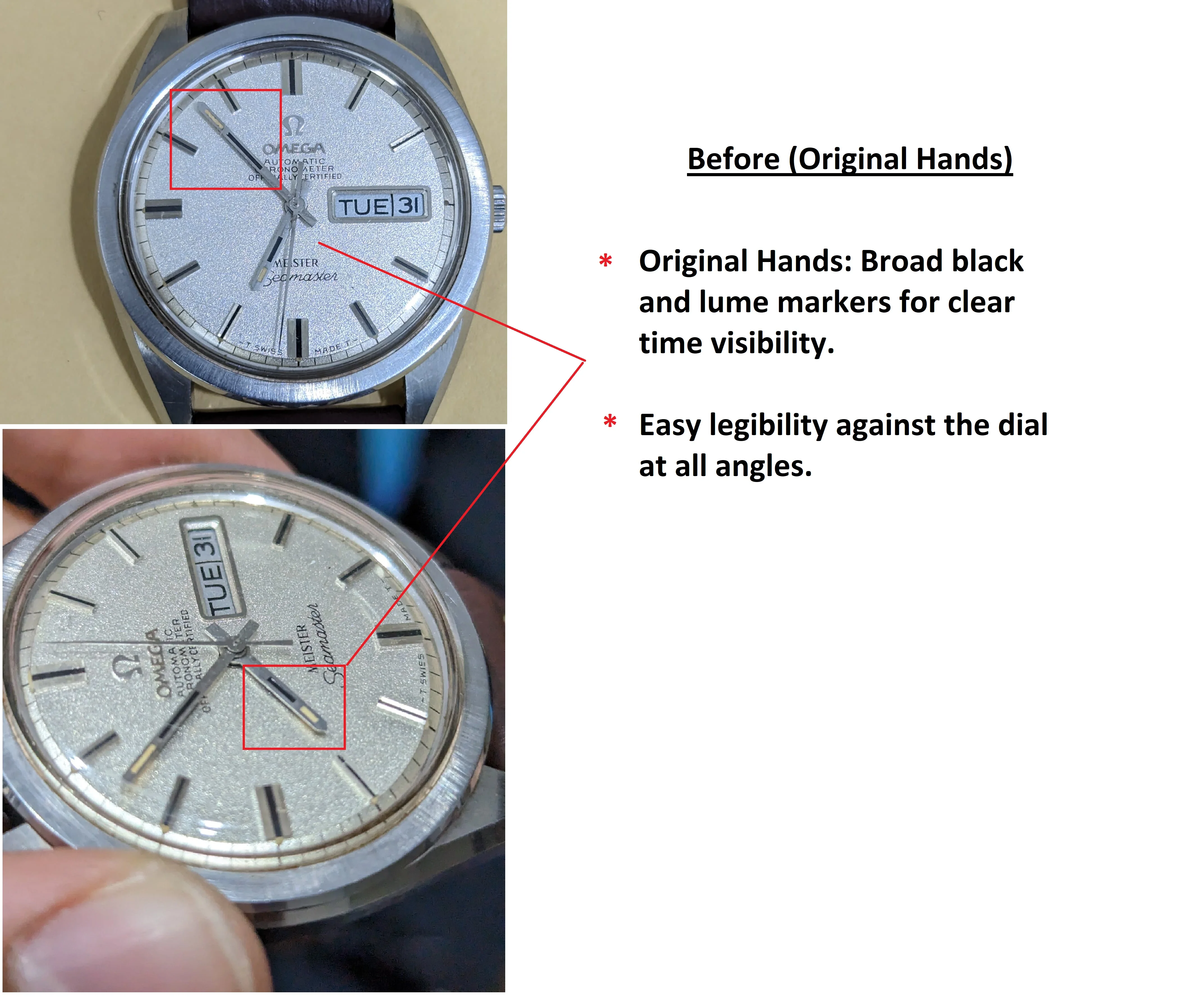

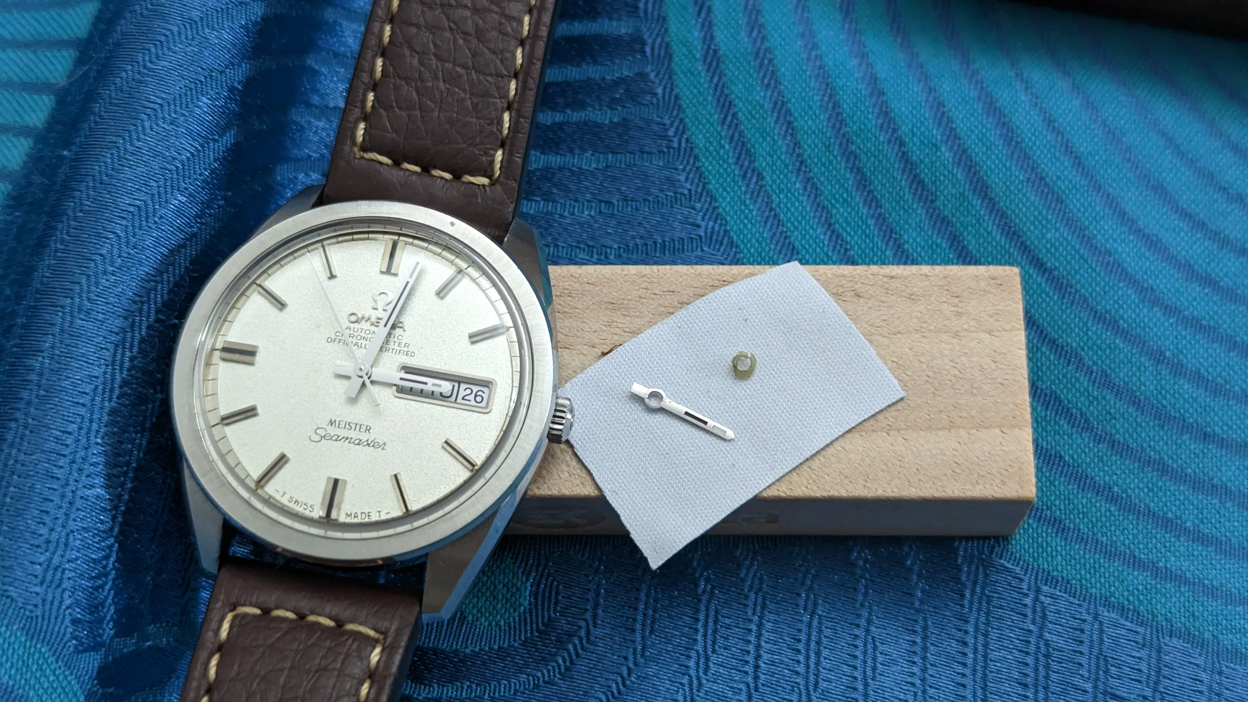

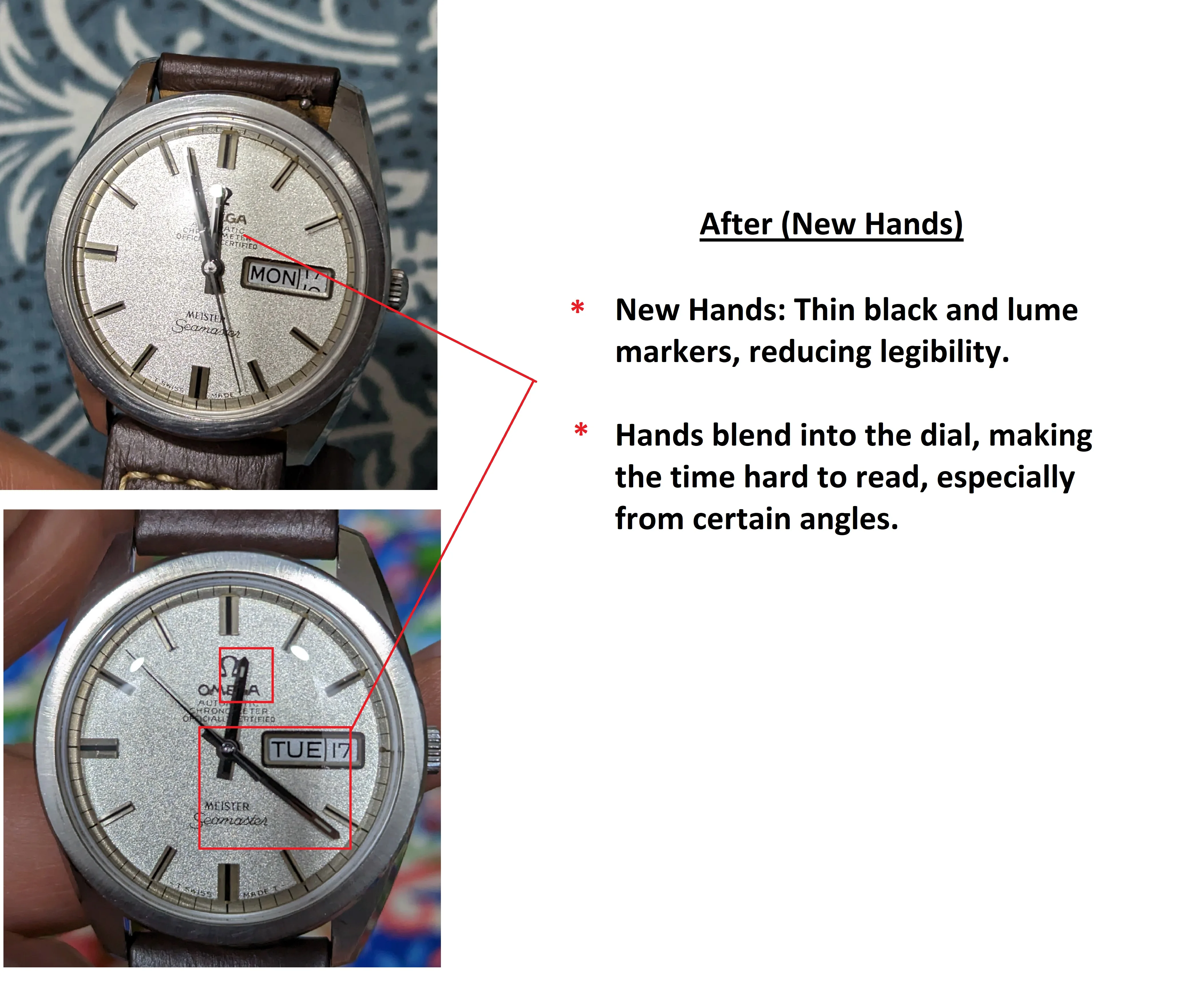

I recently had my grandfather's old Seamaster serviced at Omega AD, reference 168.023.
They unfortunately changed the hands.
I have requested them to change them back to the original, and in the meanwhile I've successfully relumed the flaking lume hands.

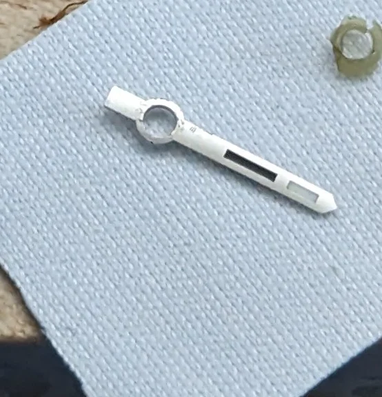

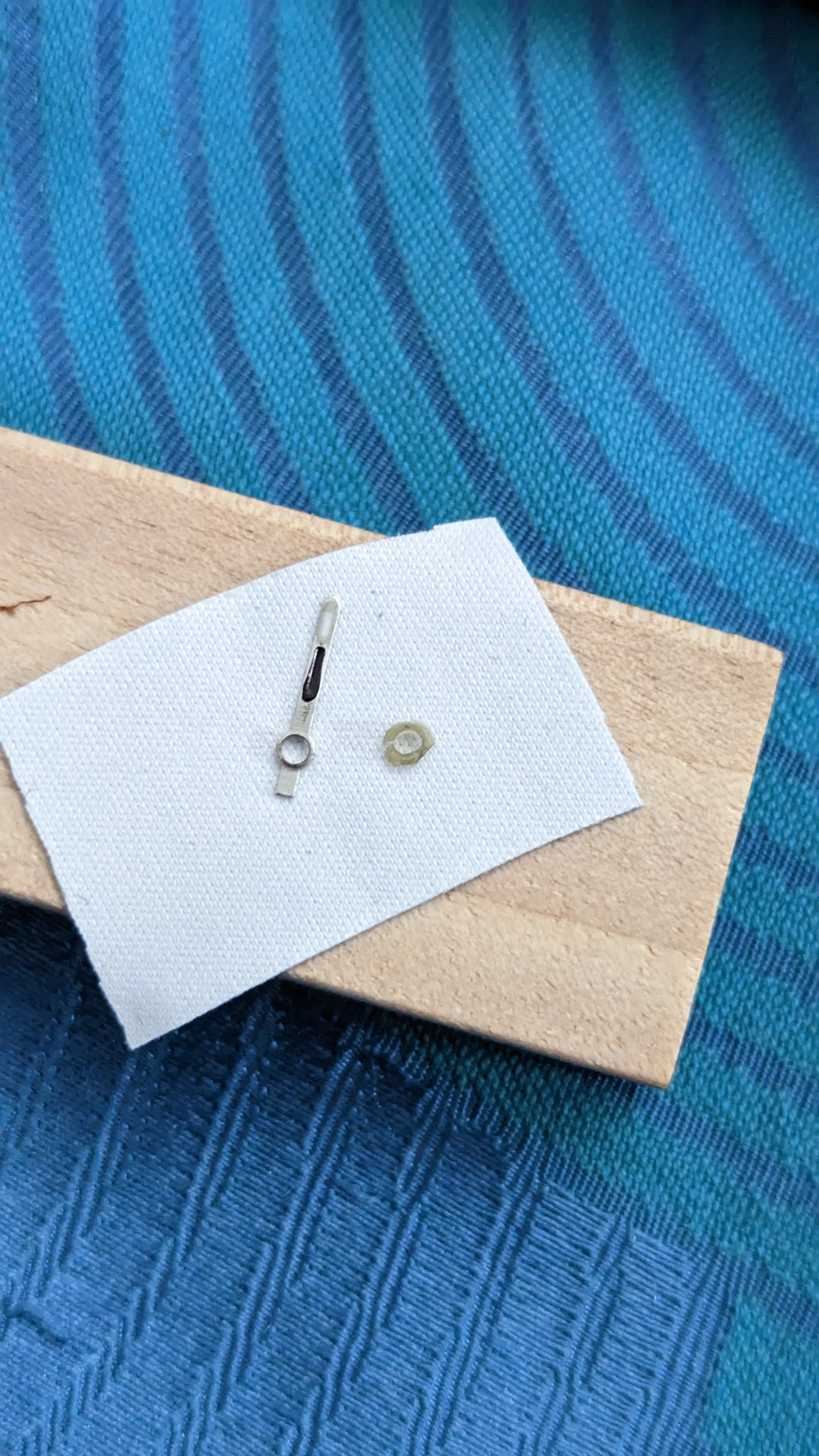

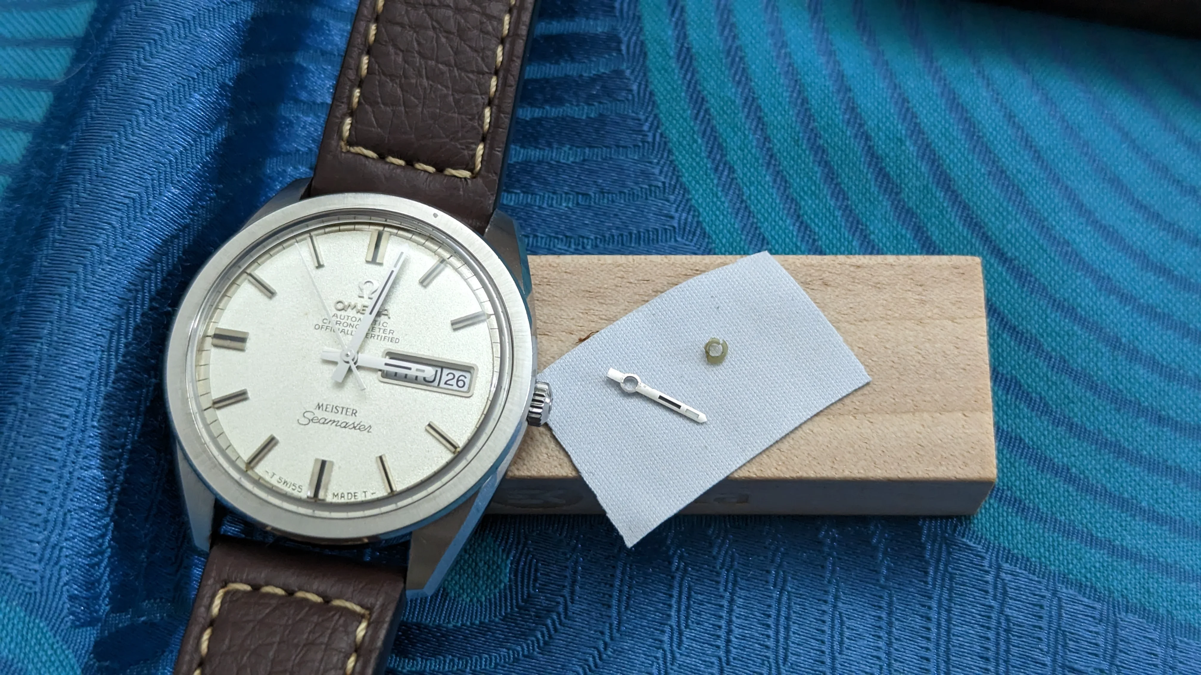

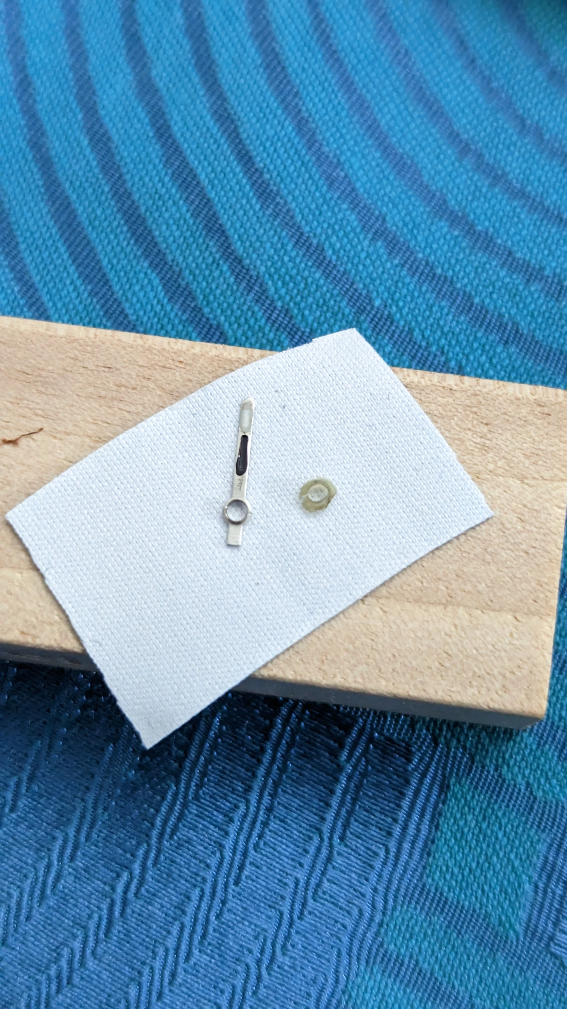

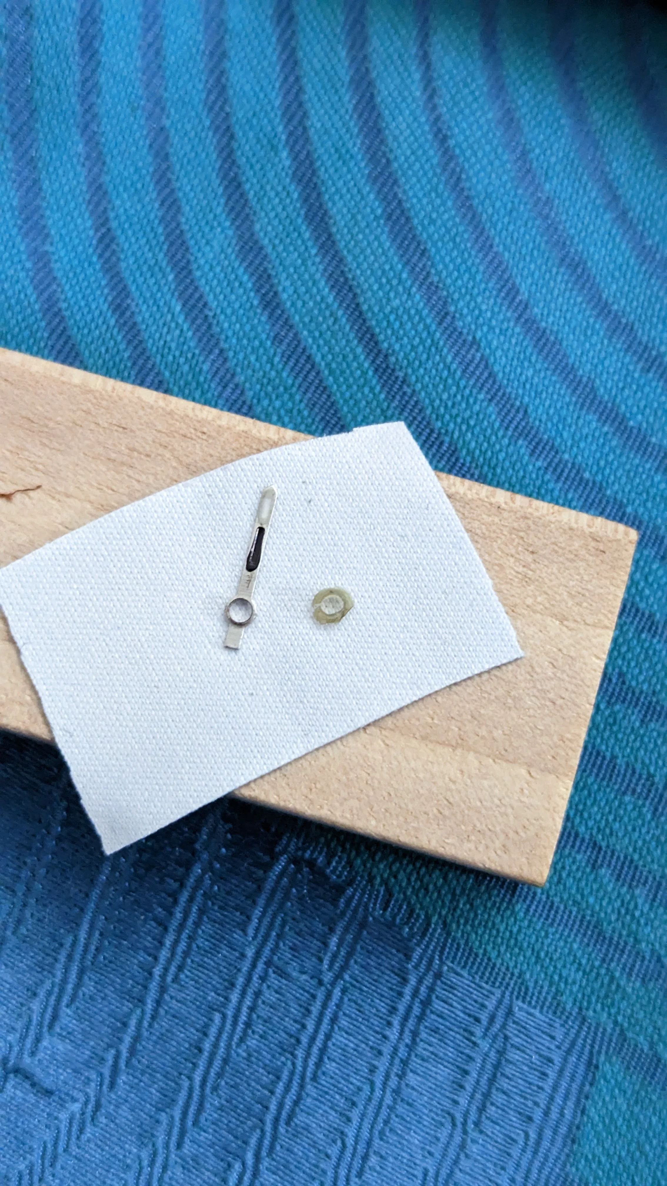

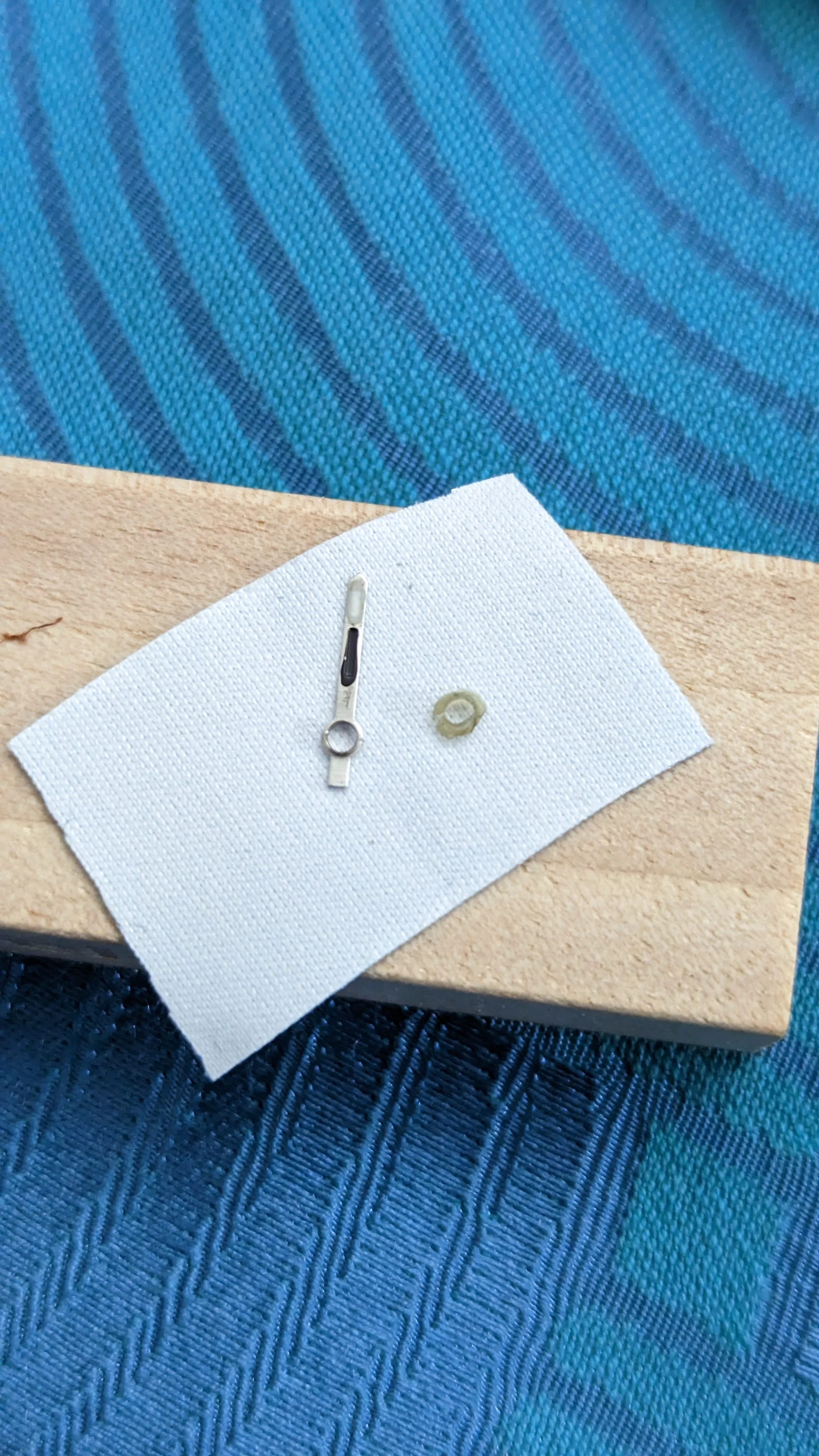

But i found this rubber bit, which seems to have come out of the hour hand hole.
Is this a necessary part of the watch? Chat-gpt is exacerbating my fears, and saying this rubber bit might be a necessity to stop friction during movement of hands, or even for stopping the hands to slip by mistake.
Given this information, should I now get the hands replaced back, or is this now risky?
Thank you for your expertise! 🙂

That is not part of either the watch or the hand. Discard that “bit” and put the hands back on.

It was a ring, that's now torn after I was trying to put it "back". What do you think it is, if not part of the hands?

It's part of a previous bodge job where whoever did it couldn't use the correct tool to shrink the pipe so they glued the hand to the hour wheel with bathroom sealer.

I would also leave the hands alone, the ones fitted by Omega will be covered by warranty. Once you remove them that warranty is dead.
The originals are worn beyond limits, re-using them would be a waste of time.

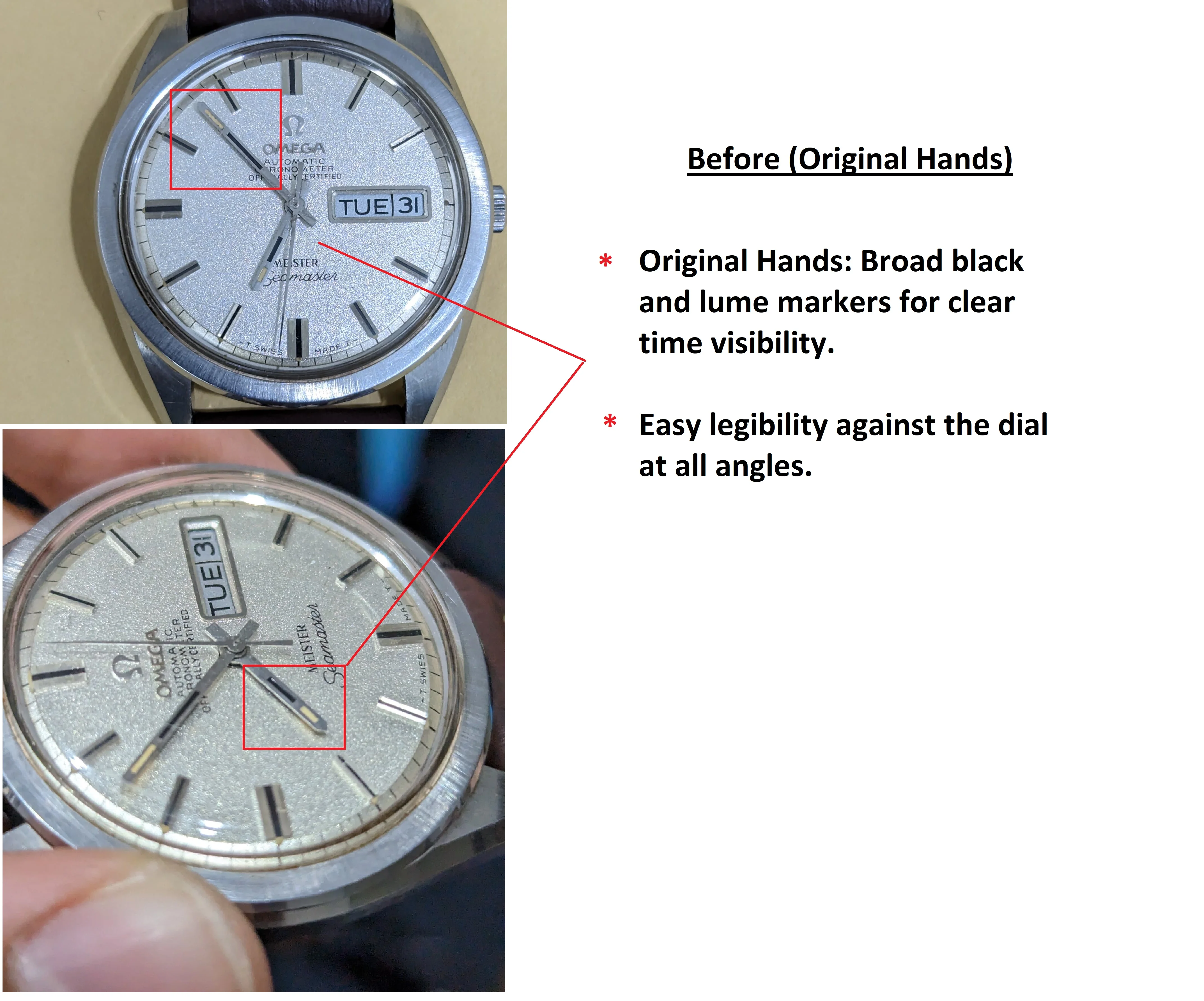

Omega themselves offered to place them back. Do you think they're in too bad a shape to be put back? I thought it was better to preserve vintage parts (dial, hands, polish)

An official Omega service centre would not offer to replace them as they would not be able to provide a warranty on the work.
The hands on the watch are identical so there is no benefit in replacing them with the old ones.
If it was a rare vintage watch and equivalent replacement hands were not available anywhere, I would try to restore the originals, but this is not one of those watches, nice though it is.

I appreciate the advice, bud! 😀 It is an official sevice centre. They offered to replace it back, after I sent these images to them and Omega HQ

My apologies. The hands in the original photo appeared identical to the old ones.
I would not change the new ones but it's your call.

Any suggestion on what this rubber bit falling out from the hour hand means?
I just would'nt want there to be an issue with the watch after re-installing the old hands. Otherwise I'd go back with the original.
