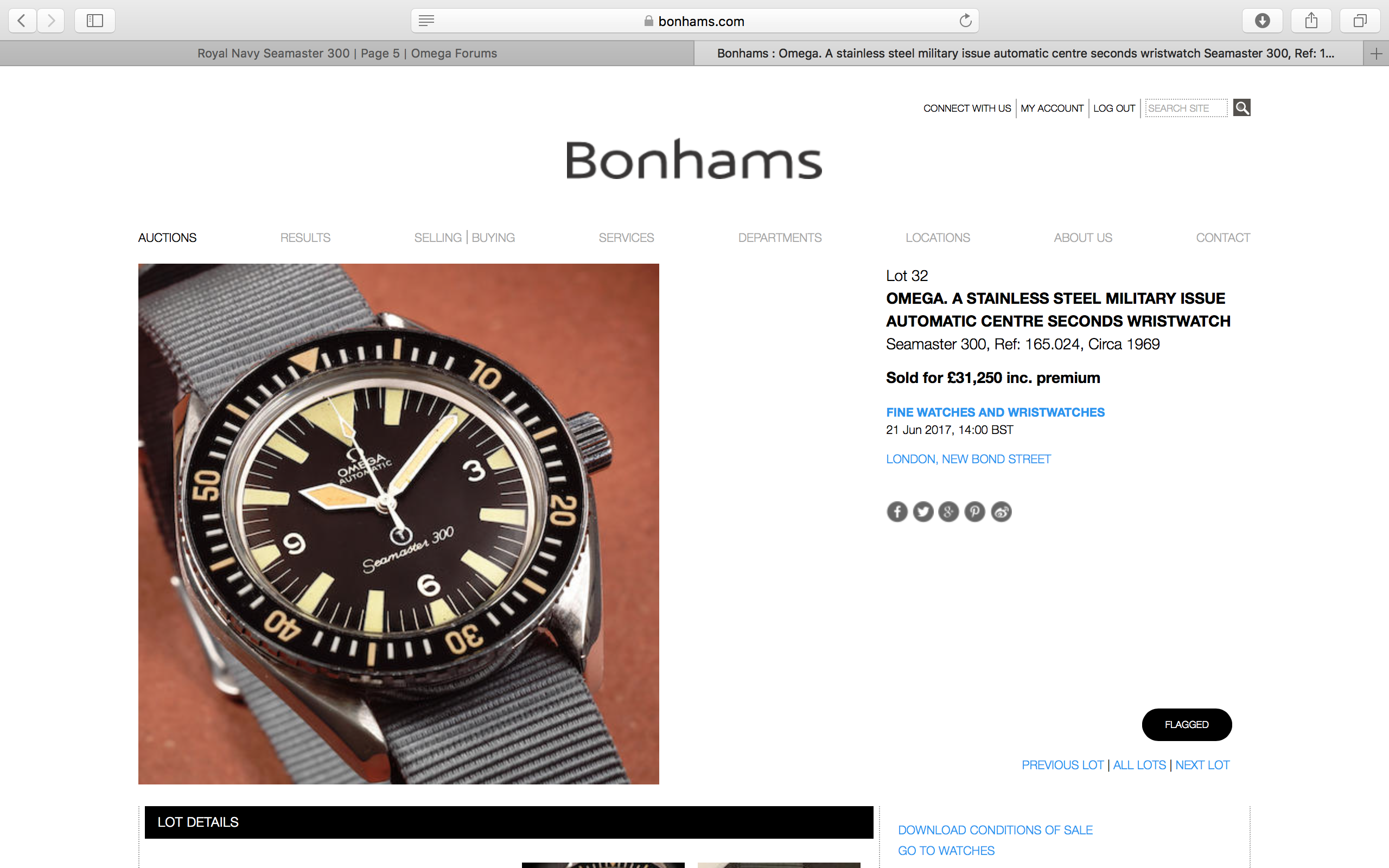

A little disappointing I think?
I have to admit, I was a bit disappointed, the other non BT didn't even meet reserve. I have a suspicion that after some sky high prices, the market has been relatively speaking, flooded with other people hoping to cash in? On the flip side, if we had sold it about 5 years ago, we'd have got a fraction of that price so it's not all bad.
1,818
2,579
I wonder if Christies auction took all the bidders?
Overall a disappointing day for Bonhams imo.

Hmm... I'm not wondering Lot128 didn't meet the reserve... but Lot50? Only issue are the baton hands... extract showed delivered to the Btritish Military... and a reserve of 25K wasn't that much actually.
63
58
The whole bonhams sale did fairly poorly. Even the several good watches went cheap - for example, one heuer rindt was a real steal. A lot of attention was on chrisities and the bonhams photos were pretty bad (some improvement last minute). Lot 32 went cheap - there are other examples of that dial and it looks like a nice watch. Lot 50 was also nice but suffered from the same problems as the rest of the bonhams sale.
157
463
Definitely - I was expecting to see that go much higher. I do agree, this auction fell under the radar for some, including me!
