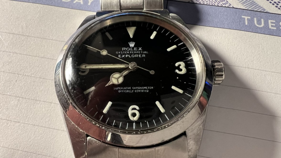

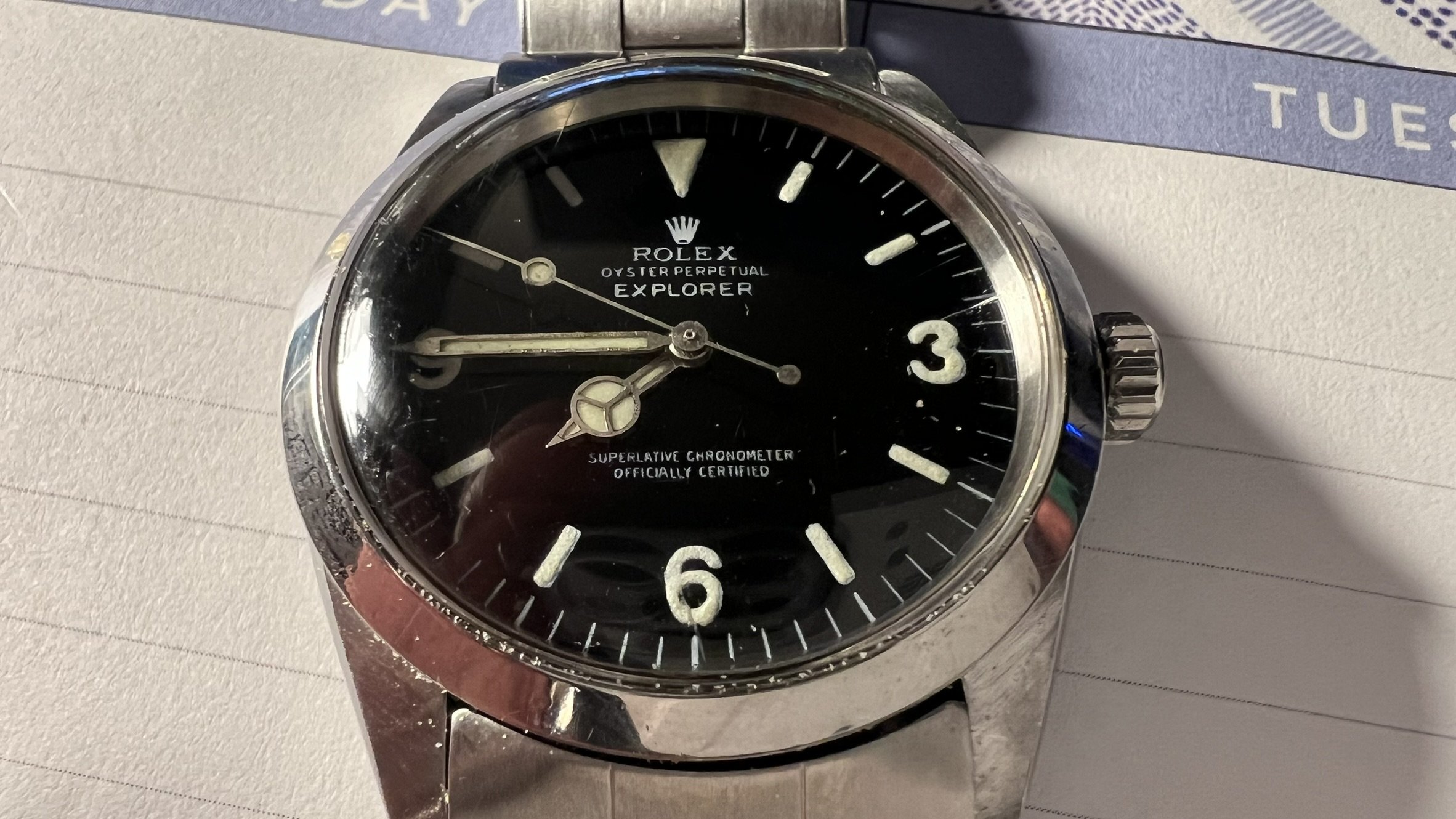

I'm new here and I have a question. I had a relative pass away recently and gifted me a few watches, one is a Cartier Tank, and the other is a Vintage Rolex Explorer 1016. I had a reputable Jewler tell me the watch is authentic. My question is most if not all Explorers say Swiss or Swiss Made at the 6 O'clock position, this one has nothing in that spot. Any Ideas? Thanks in Advance.

Either your photo is suffering from really extreme compression artifacts, or the dial is poorly repainted. I suggest you compare the printing to other examples that you find online.

It looks better in person and with a loop but that was going to be my second question.

Yup - a redial. Good for you for asking for advice from this Forum.

Just look at the coronet.

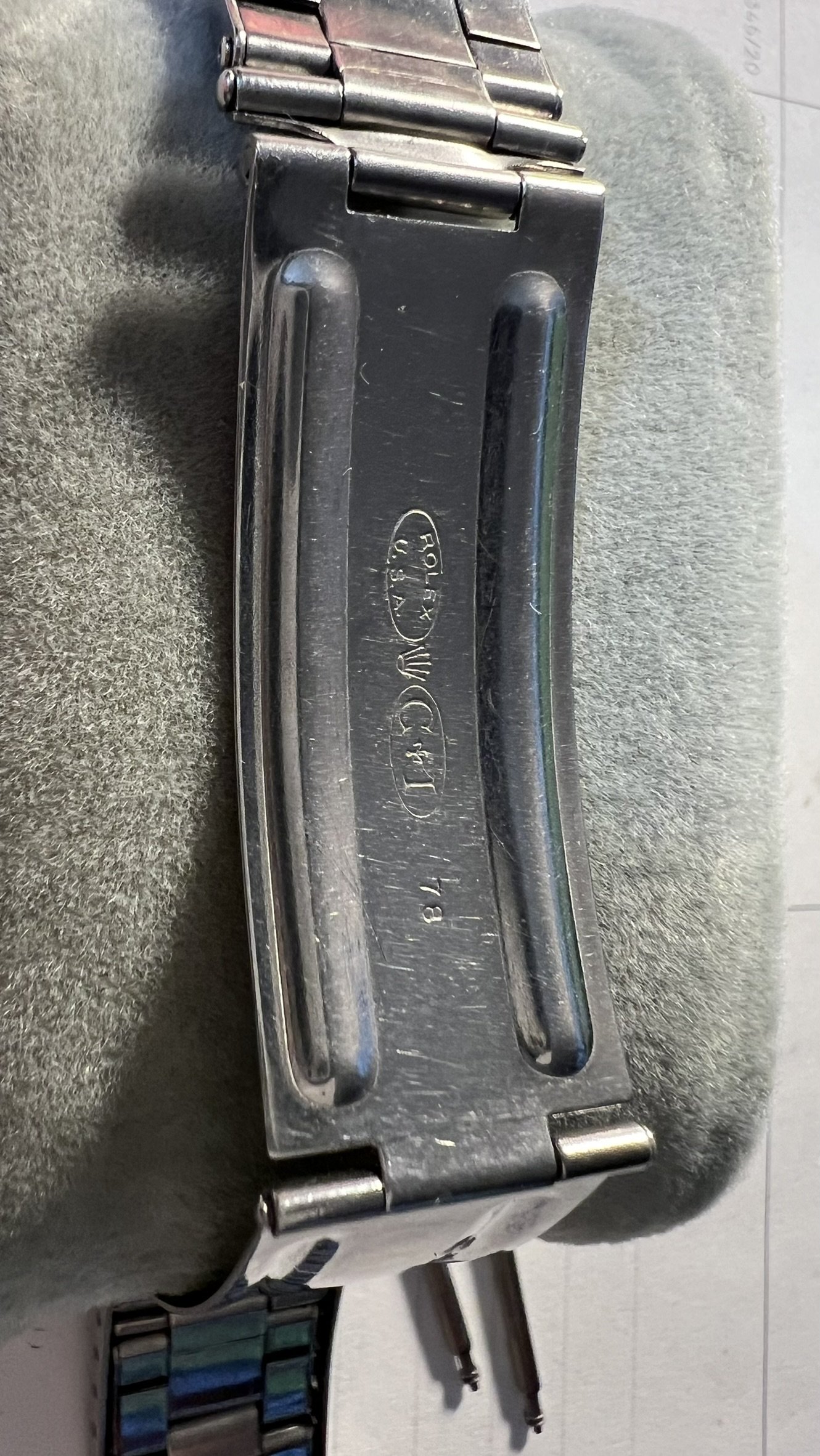

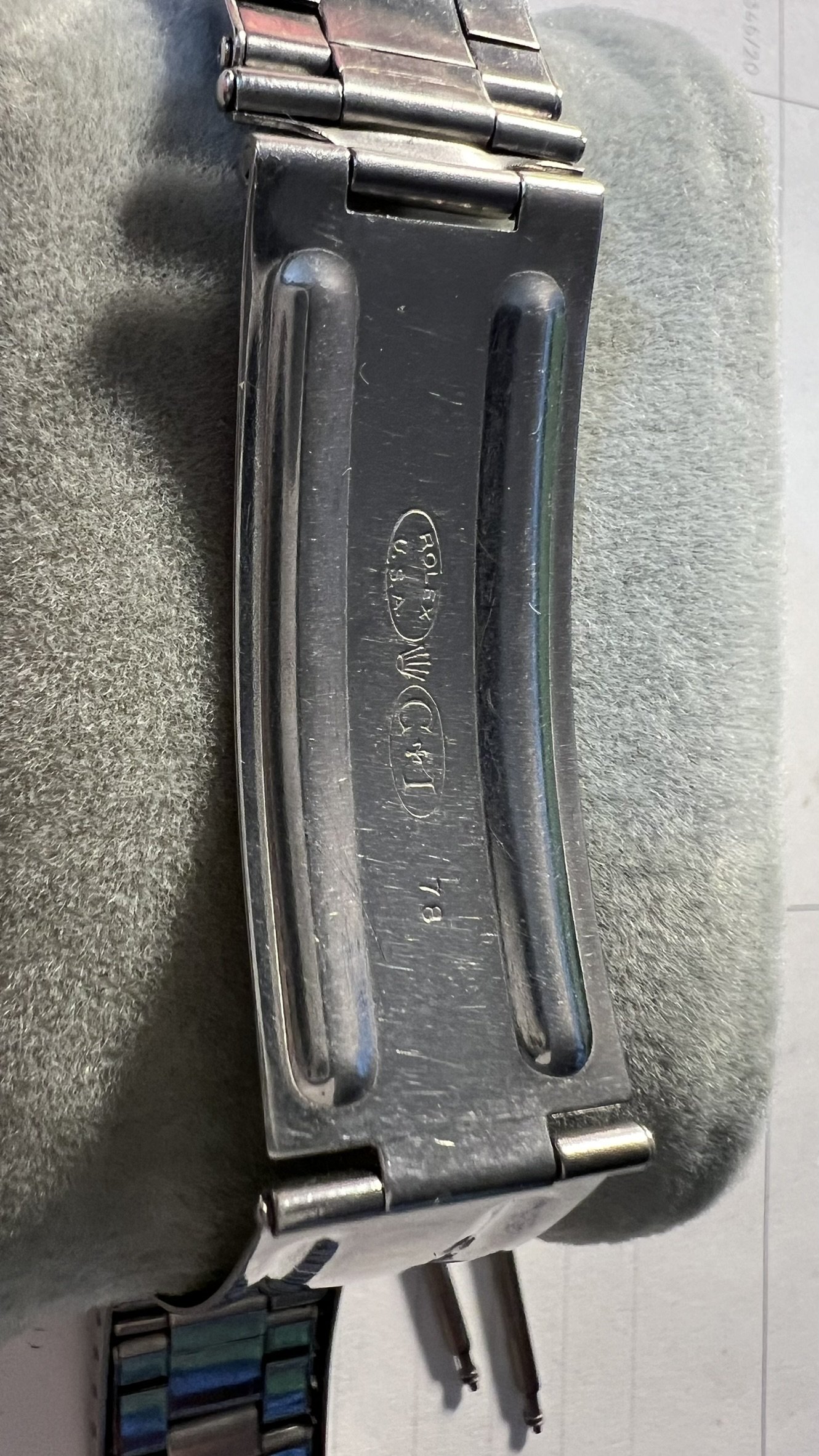

Got more info on the watch and bracelet. I removed the bracelet, and one side has the numbers 1433952 and the other side has REGISTERED DESIGN with 1016 under it. Too had to photograph right now. I do have a photo here of the bracelet.

C&I rivet bracelet. The end-links aren't always the best fit, but they were often supplied with watches sold in the US.

I'm curious, what does the "78" stand for?
