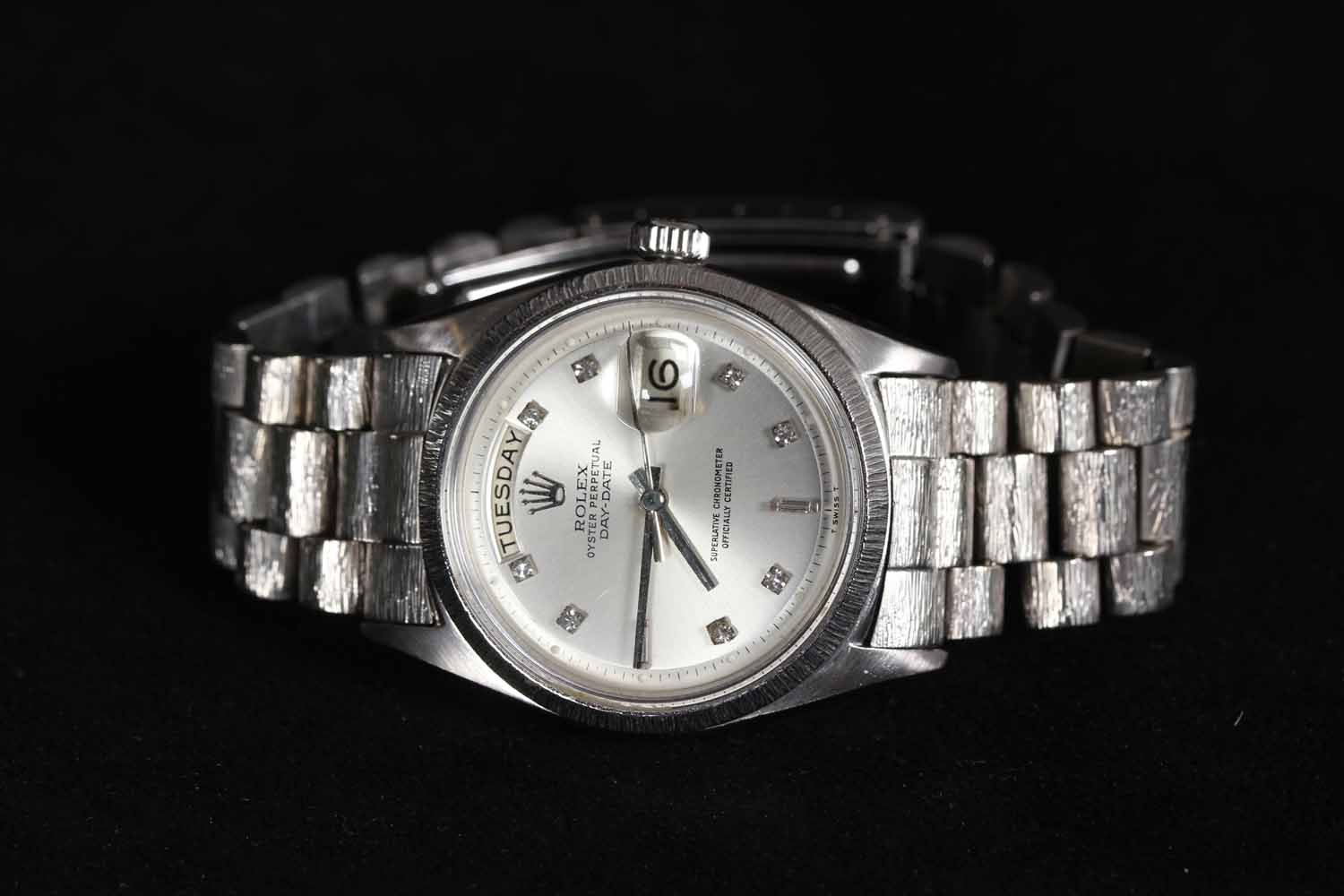

Dear all.

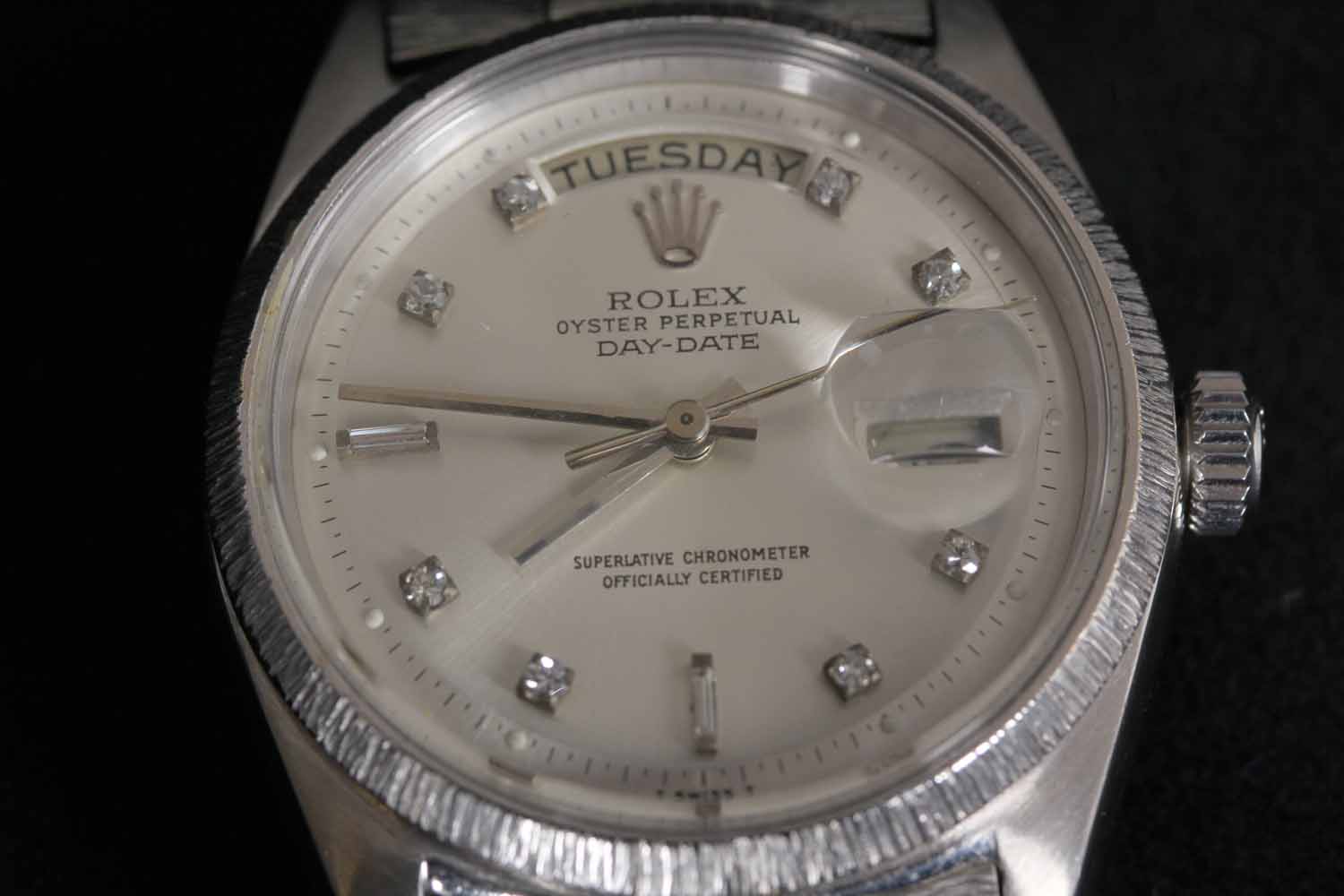

An auction house near me have put up a diamond dialed white gold Day Date 1803. While I am not interested in buying this, I am curious as to what experts on here think of the dial/hands? It strikes me as being quite odd that the hands have no lume while the dial has... Also, the lume seems quite bright for the age of the piece.
Now, this might be very normal for the reference, but I find it pretty odd.
Any comments? Replaced dial? Genuine Rolex dial? Replaced hands?!?

Need better pics, but that first pic tells me that the diamonds were added later (notice how the diamond at 11 doesn’t line up with the window like the diamond at 1 does). Also that is an 1807 “bark” finish, not an 1803.
Edit to add: or its an 1803 which had the bracelet refinished and a different bezel added. That look was popular down here in Texas in the 80’s. The “Texas Timex”.

My ex had yellow Gold bark bezel on bark bracelet she had inherited, lovely watch.
The endlinks on this one worry me. What’s up with those gaps? Crown looks off as well.

Mind you, I know extremely little about Rolex, so am I correct in saying, @southtexas, that it is only the 1807 that has a bark finish bezel? And that would be the defining feature setting it apart from the 1803? Also, is it correct that the bark finish should only be present on the center links on the bracelet?
@Foo2rama - good call about those gaps! I didn't notice before now, but once you see it..! That being said, when I google image the reference, I see a lot of ill-fitting end links; is this due to them being wrong for the ref. too? This holds true with the 1 and 11 o'clock diamond alignment too - when I did a search on 1803s with diamond dials, the same odd alignment were present.

After review the bracelet looks wrong. Look at the watch on Fratello right now from the week on the wrist segment from 2 days ago. It should have a hidden clasp. This watch looks like a regular clasp. The one my GF had was an older reference with no quickset on day or date, and it had a hidden clasp.
https://www.fratellowatches.com/rolex-day-date-18c-white-gold-52mondayz-week-51/
Why the Hell didn't I notice that to begin with...
The description states that the end links are stamped "53" - it seems to me that this is the ref. for a plain end link?

There are some early President bracelets with “plain” clasp. I don’t know what serial this one is.

Mind you, I know extremely little about Rolex, so am I correct in saying, @southtexas, that it is only the 1807 that has a bark finish bezel? And that would be the defining feature setting it apart from the 1803? Yes and yes
Also, is it correct that the bark finish should only be present on the center links on the bracelet? I believe so, but back then a Rolex store would do virtually whatever a customer wanted mod-wise, so it could’ve left the store in that condition, or done later.
