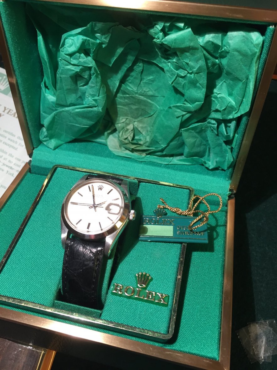

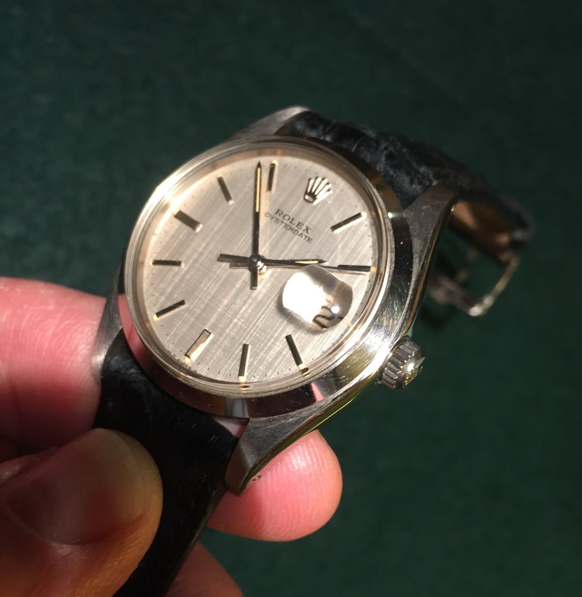

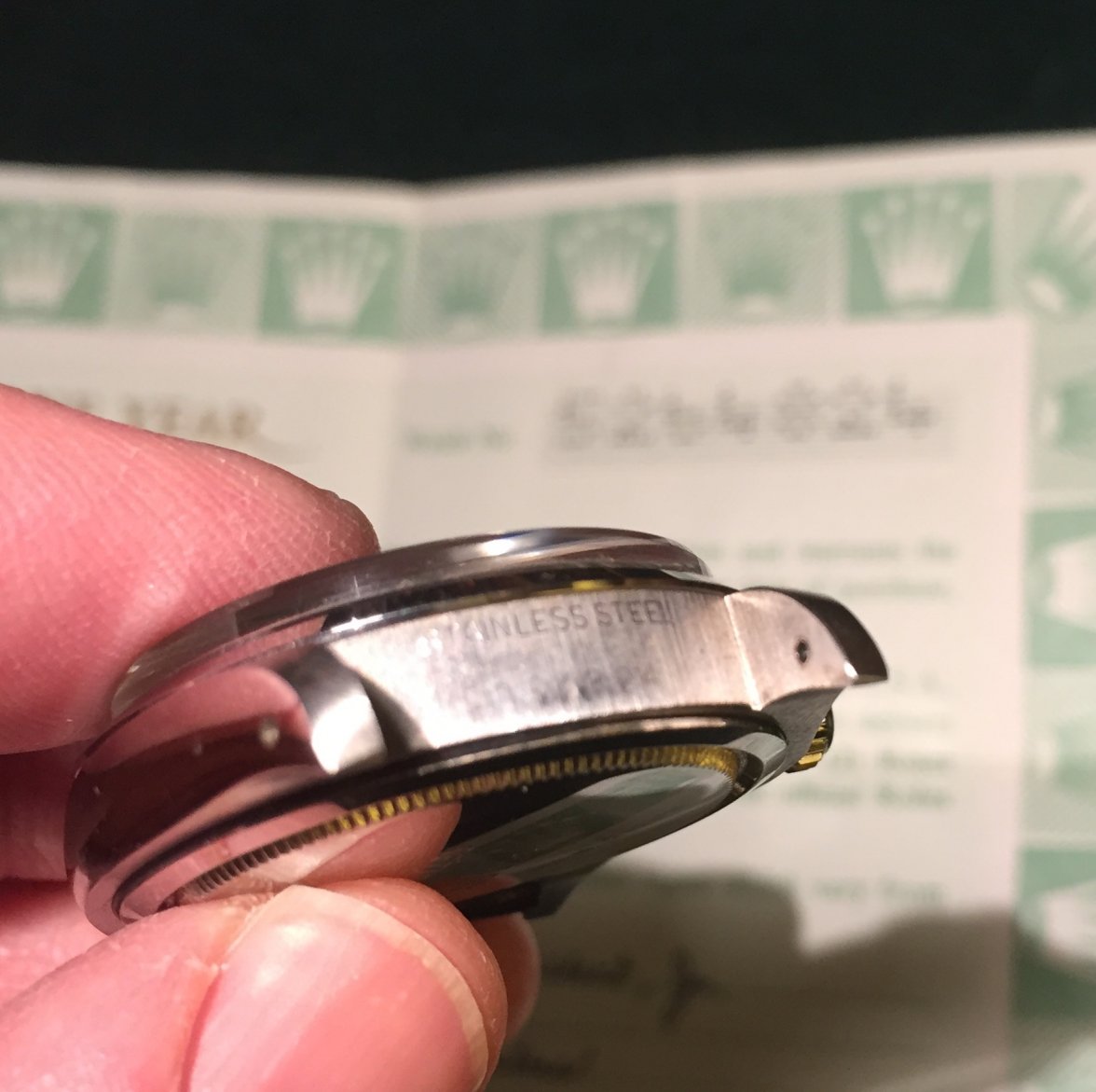

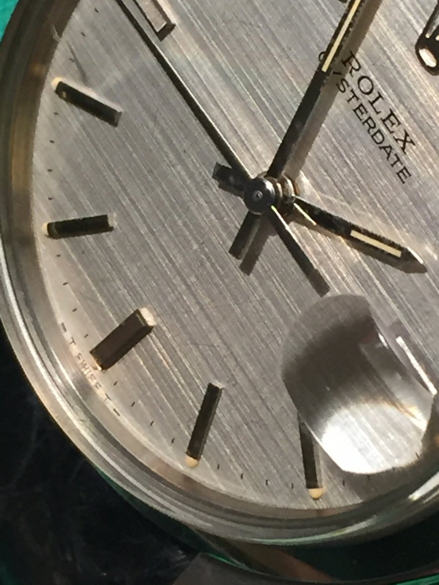

    Hey Folks.
    I came across a fantastic Rolex 6694 but am concerned about its authenticity as it's dial lacks the word "precision".
    Does this dial look original?
    Thanks!
    Brian
  2. 77deluxe Feb 10, 2018
    2,058
    4,613
    I’m by no means an expert on the 6694, but I believe they came without the percision text on the dial. It looks legit to me.

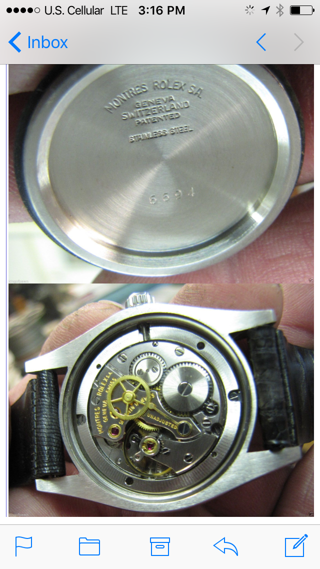

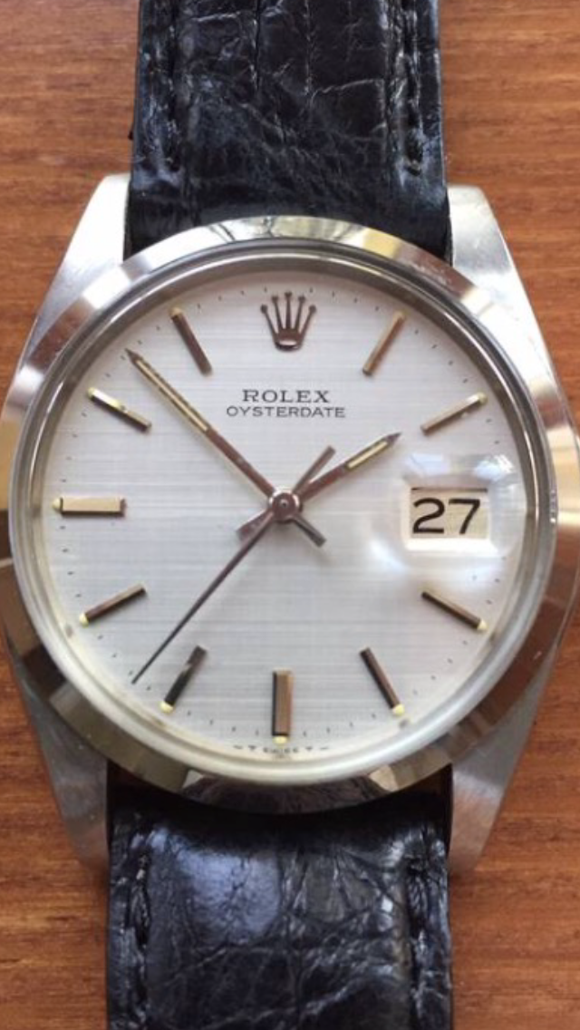

    I came across this similar watch for sale:
    The seller just sent another couple photos:
    -Brian
  4. Canuck Feb 10, 2018
    13,478
    38,029
    Looks like yours is based on the caliber 1210 (1215 or 1225) which was made with numerous levels of adjustment, up to 6-positions. The subject watch is marked unuadjusted which may have something to do with the lack of the word precision on the dial. Looks like a good one! My source indicates introduction circa 1954, but I have a Rolex Royalite model with this movement from circa early 1940s. The Royalite has a 6-position movement in it. The dial on mine is marked Observatory. Yours has the KIF shock protection system on the balance staff. Mine is not shock resistant.
    Brianstoops and 77deluxe like this.
  5. 77deluxe Feb 10, 2018
    2,058
    4,613
    Canuck knows his stuff. I agree that it’s a good example. Obviously make sure the price is fair and the seller is reputable.
    Brianstoops likes this.
