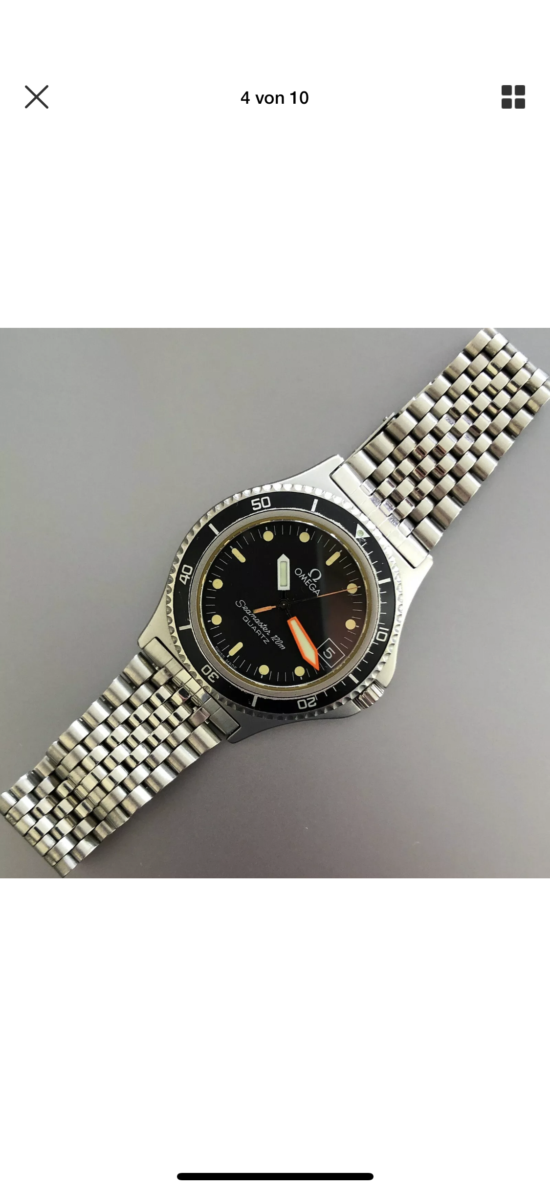

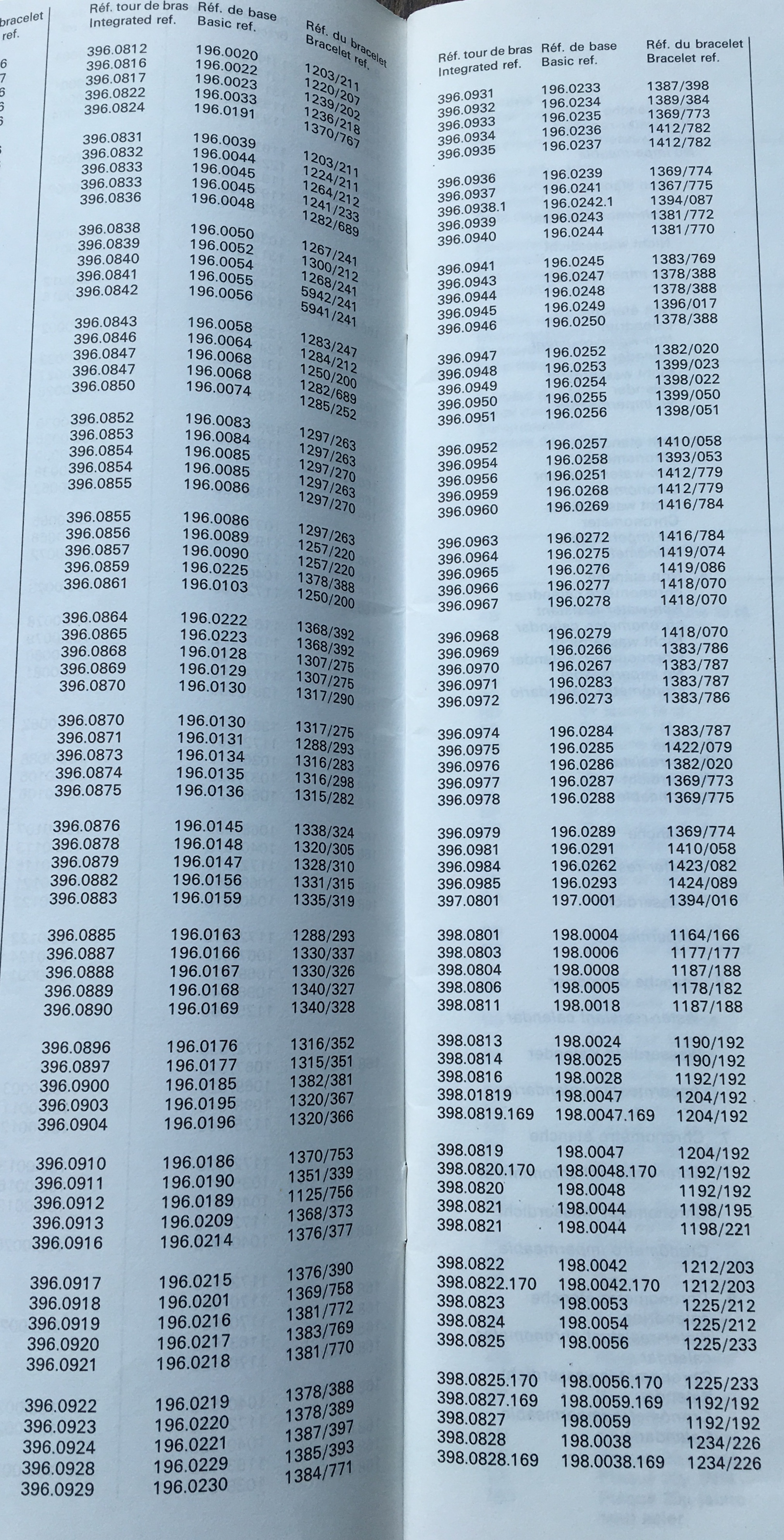

Unfortunety there isn’t the right bracelet on the watch. So I did some google research and it came up that I’ve found two different (?) bracelets for this watch - 1384 and 1389. Does anybody know which one is the right for this model?

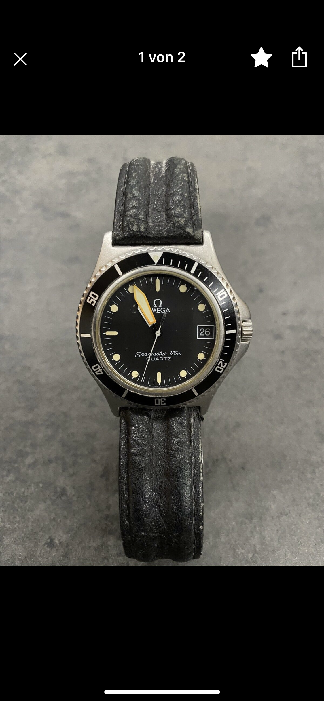

Here is a pic of my model:

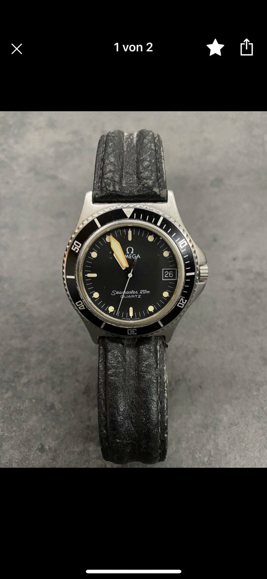

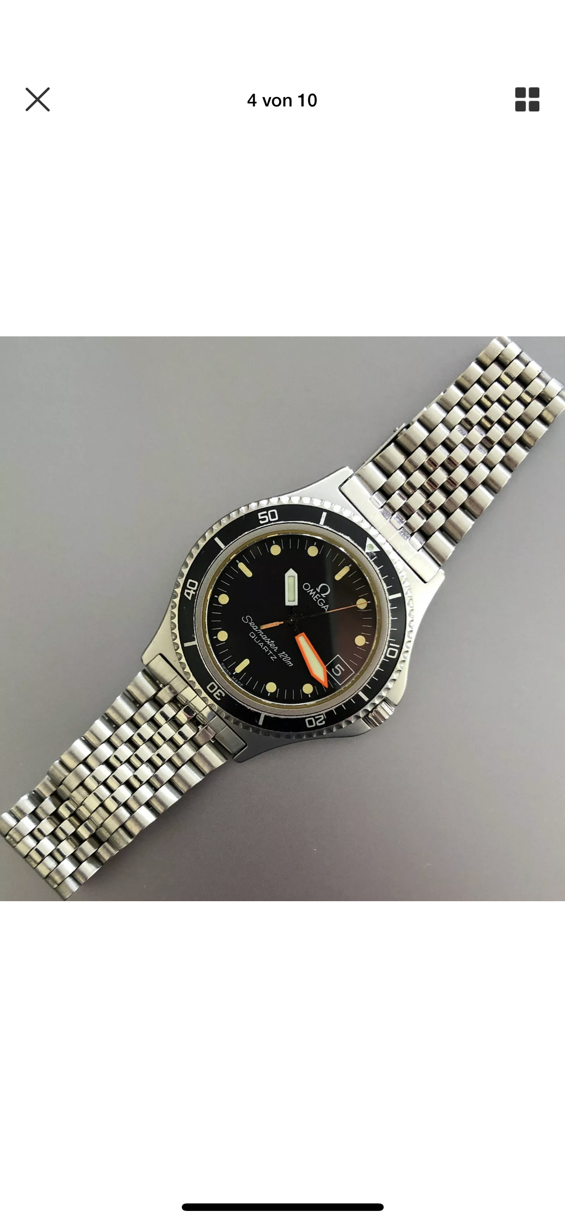

And here how it should look like in the future 😉

Hi Concer,
Given that the Calypso is reference 396.0929 then due to my records the bracelet should be ref 1384/771.
But please don't ask where I got this information from. Just can't recall that 😵‍💫😀

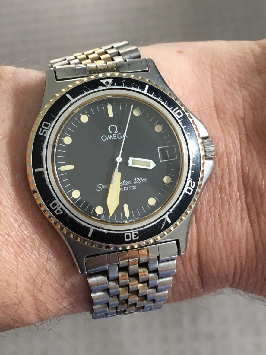

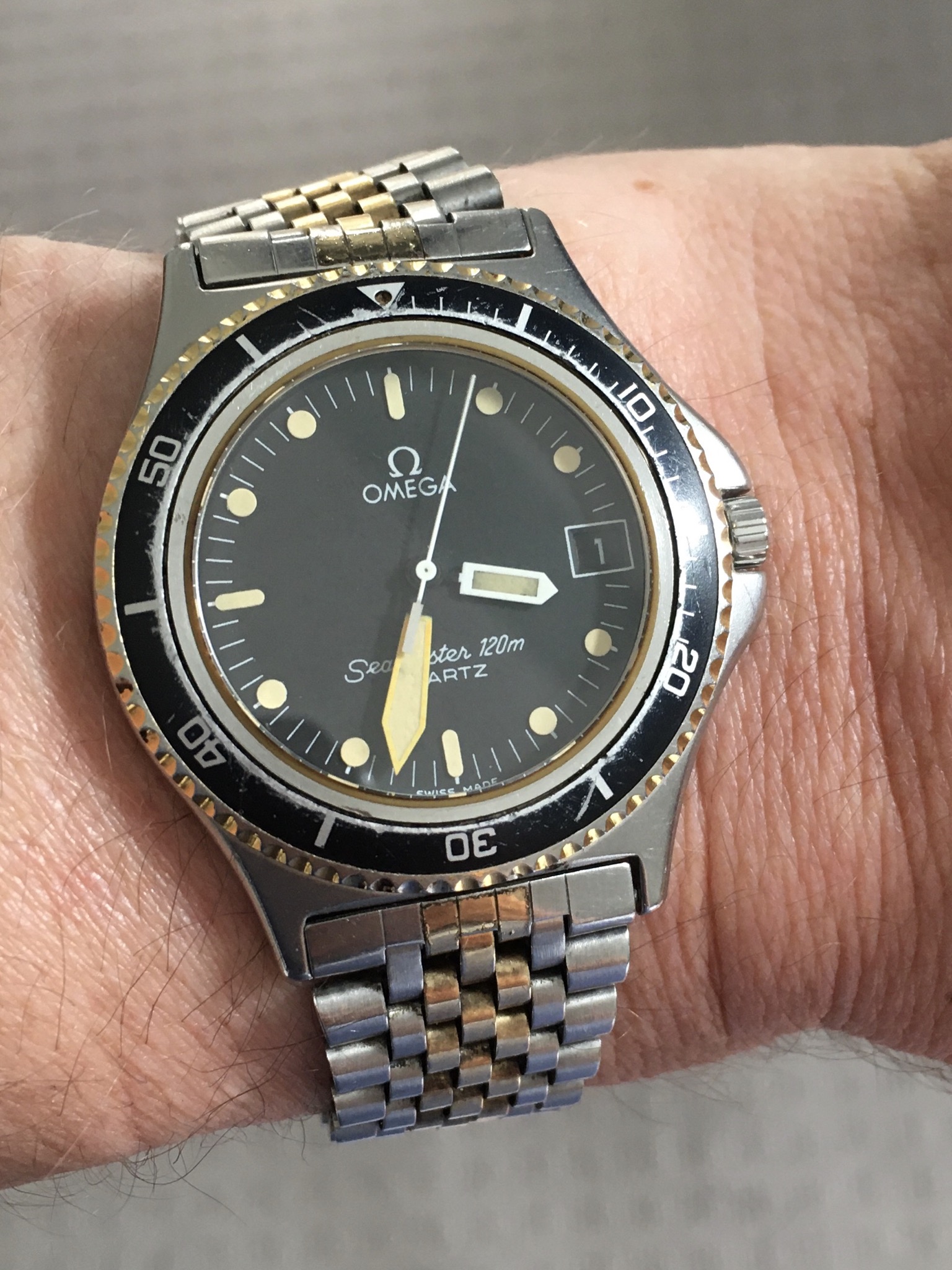

This model also comes in two tone. Perhaps the two bracelet codes refer to the steel and two tone bracelets. Here is my two-tone.
the code on the clasp is 1384, with 771 on the end links.
1,344
1,971
They were also sold on a Ploprof style mesh. Ref 1380/237

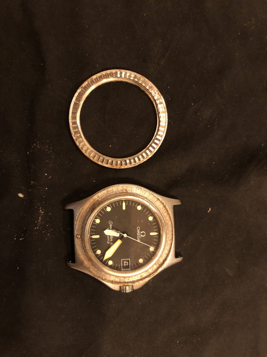

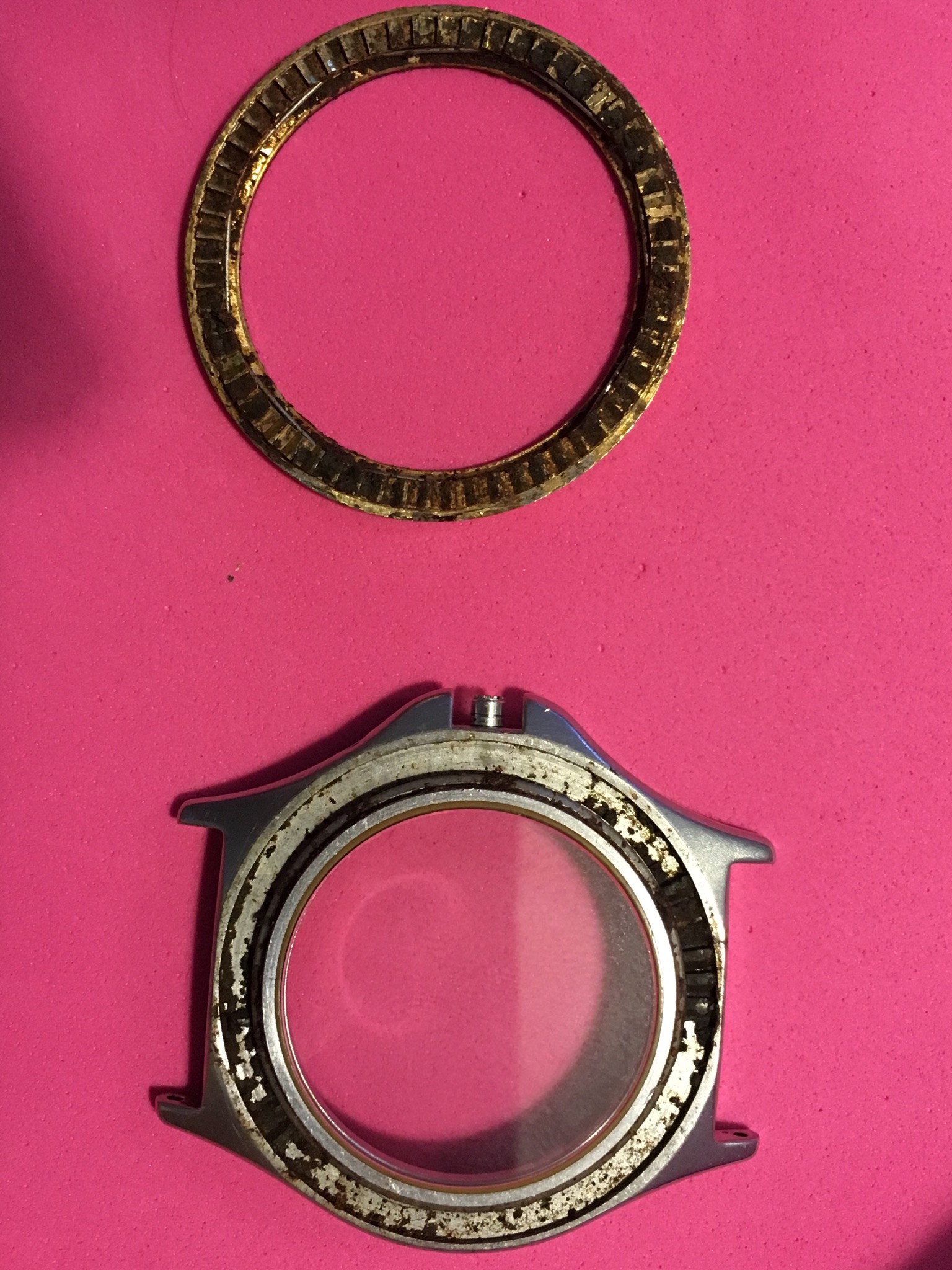

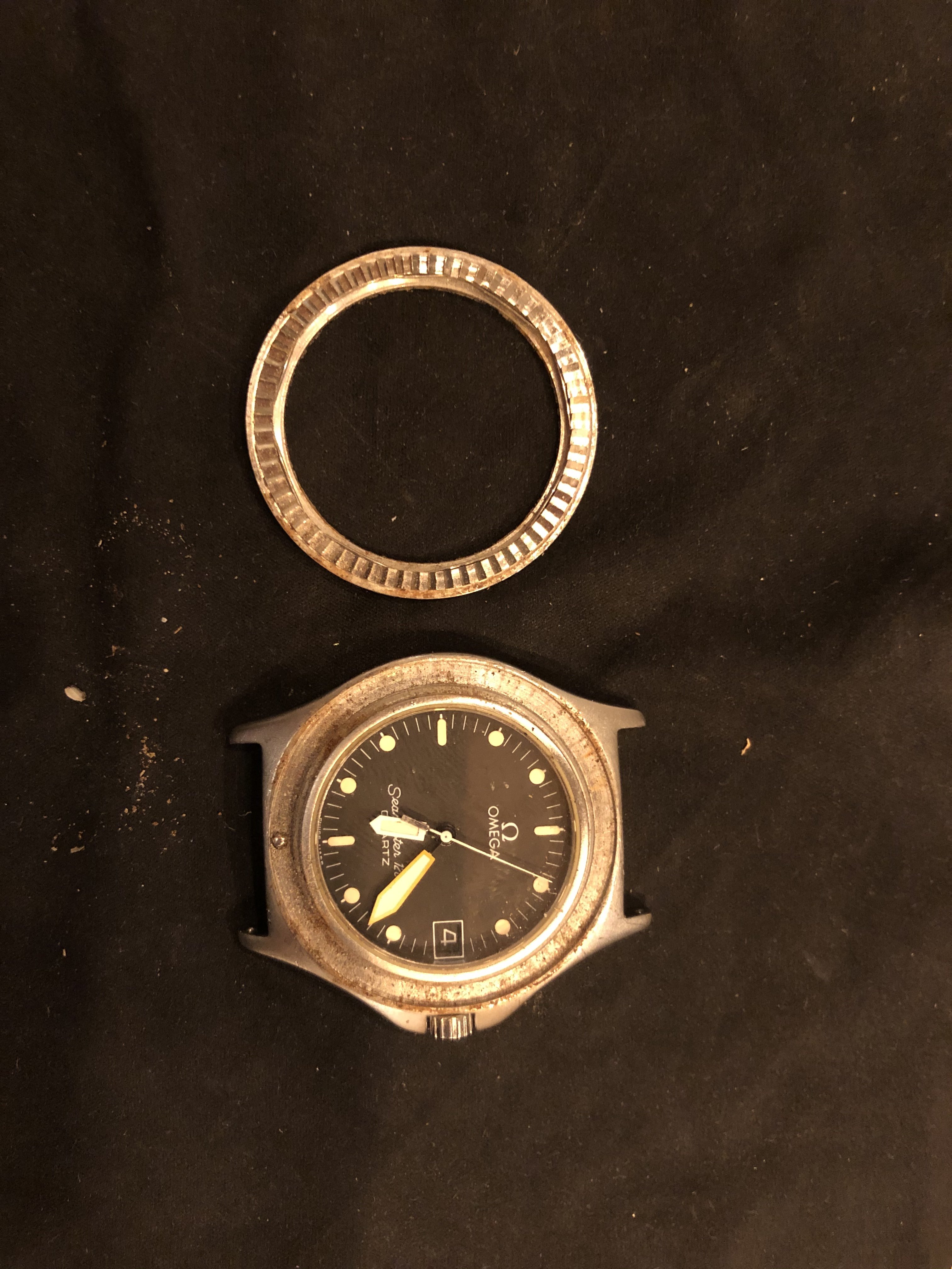

My bezel wouldn't move when I got mine either. I had to work away carefully with a razor blade around the edge until I could finally lift it off. be very careful not to damage the edge of the bezel.
There was a lot of dirt underneath. Now I've cleaned it out it operates as it should, but it's not the easiest bezel to get a grip on.

Now I think about it, I stripped down the case and put it in the ultrasonic with soapy water for a few rounds before I could get the bezel off.

So, got it off and cleaned it.
But even now it fits so tight I can’t move it. Suggestions? 🙁

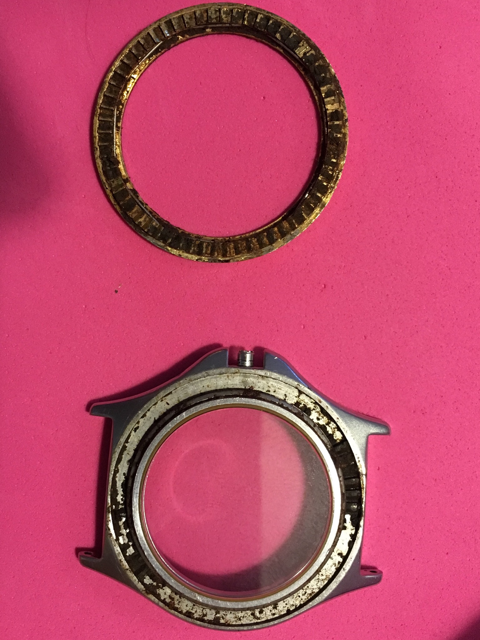

30,205
77,993
The amount that the spring flats protrude will affect how tight it is. I would make a point of removing the spring from the bezel and cleaning the groove in the bezel if you haven’t already done so. Some silicone grease in the drove where the spring sits can help also.
