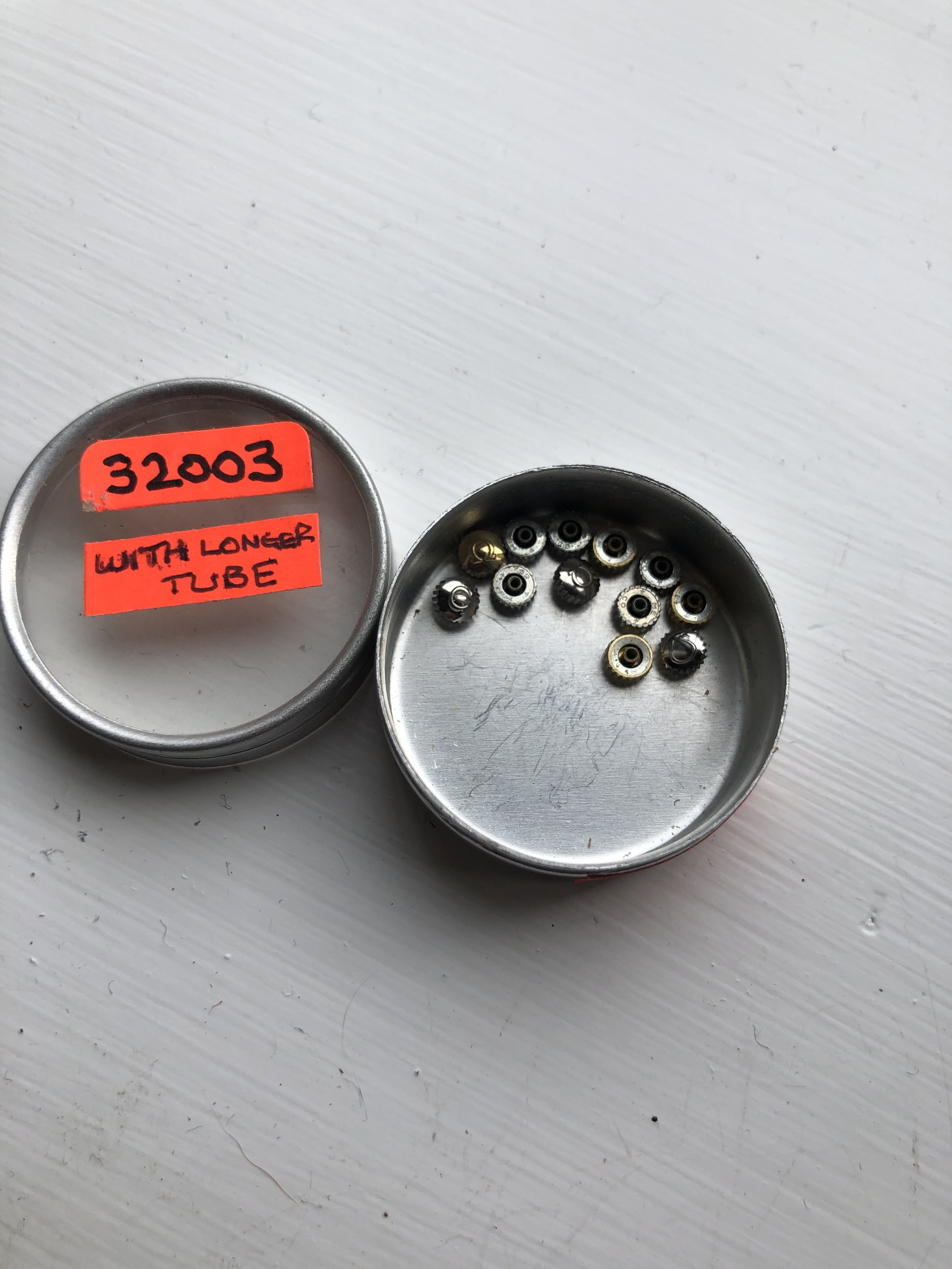

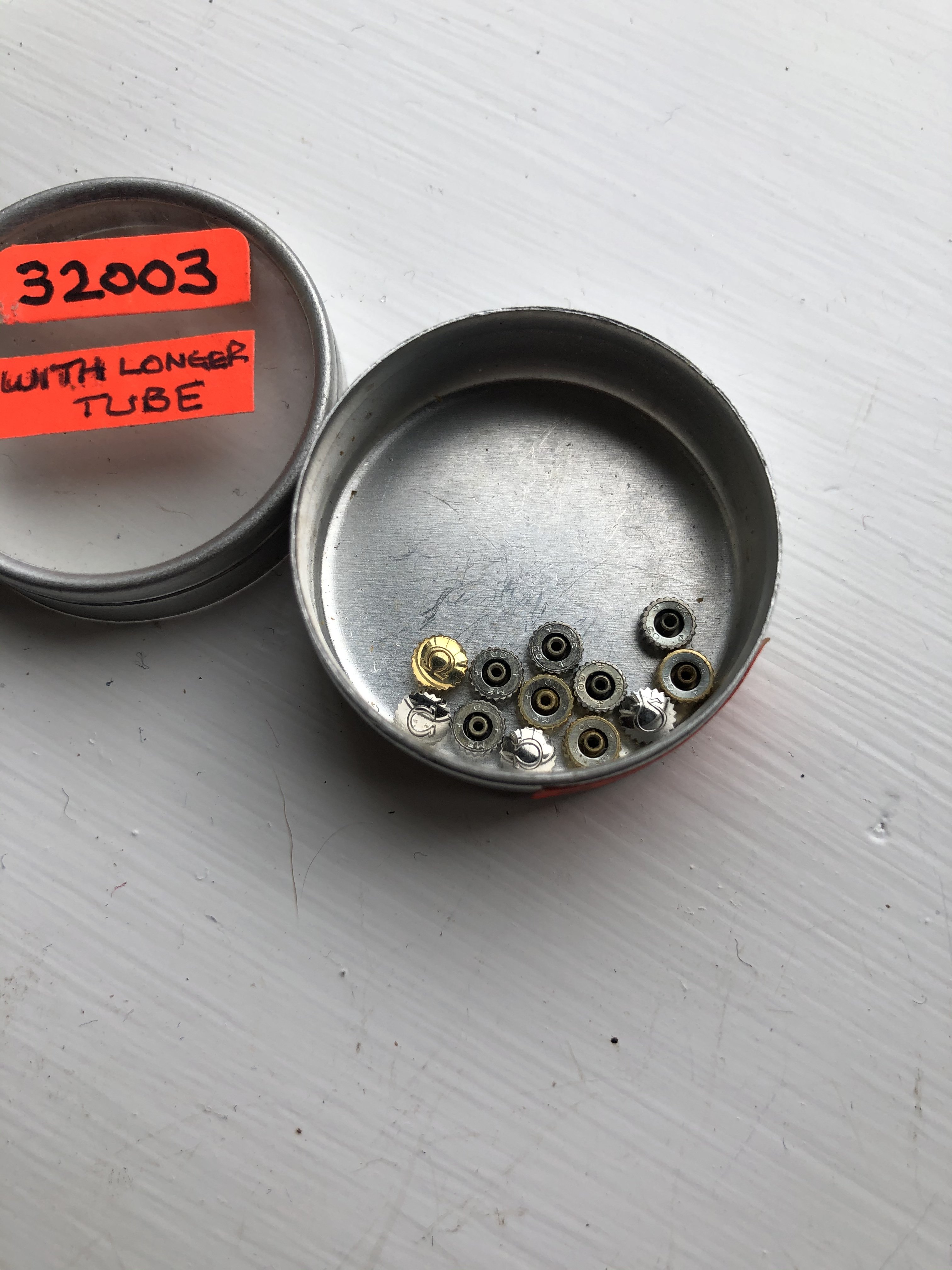

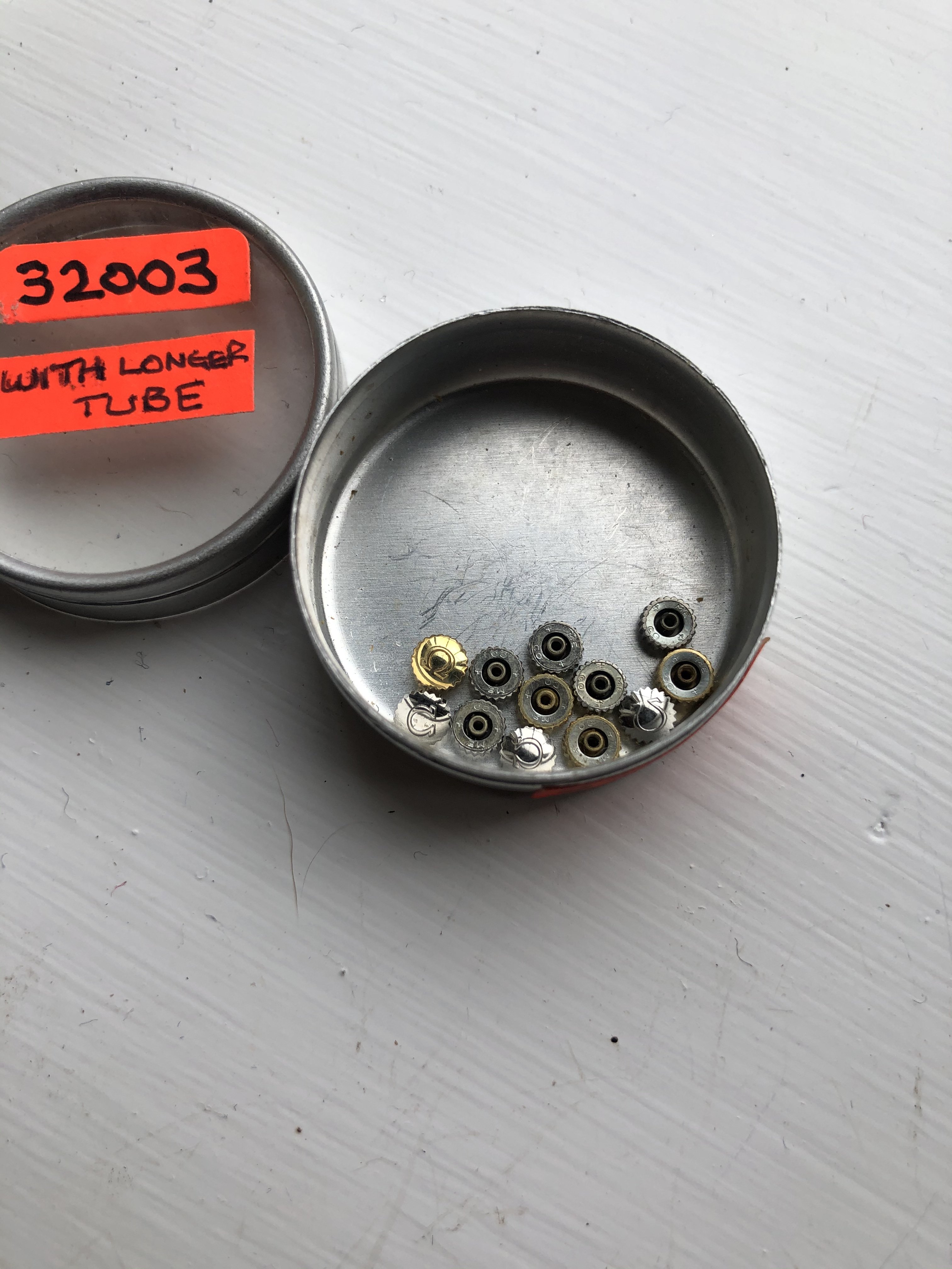

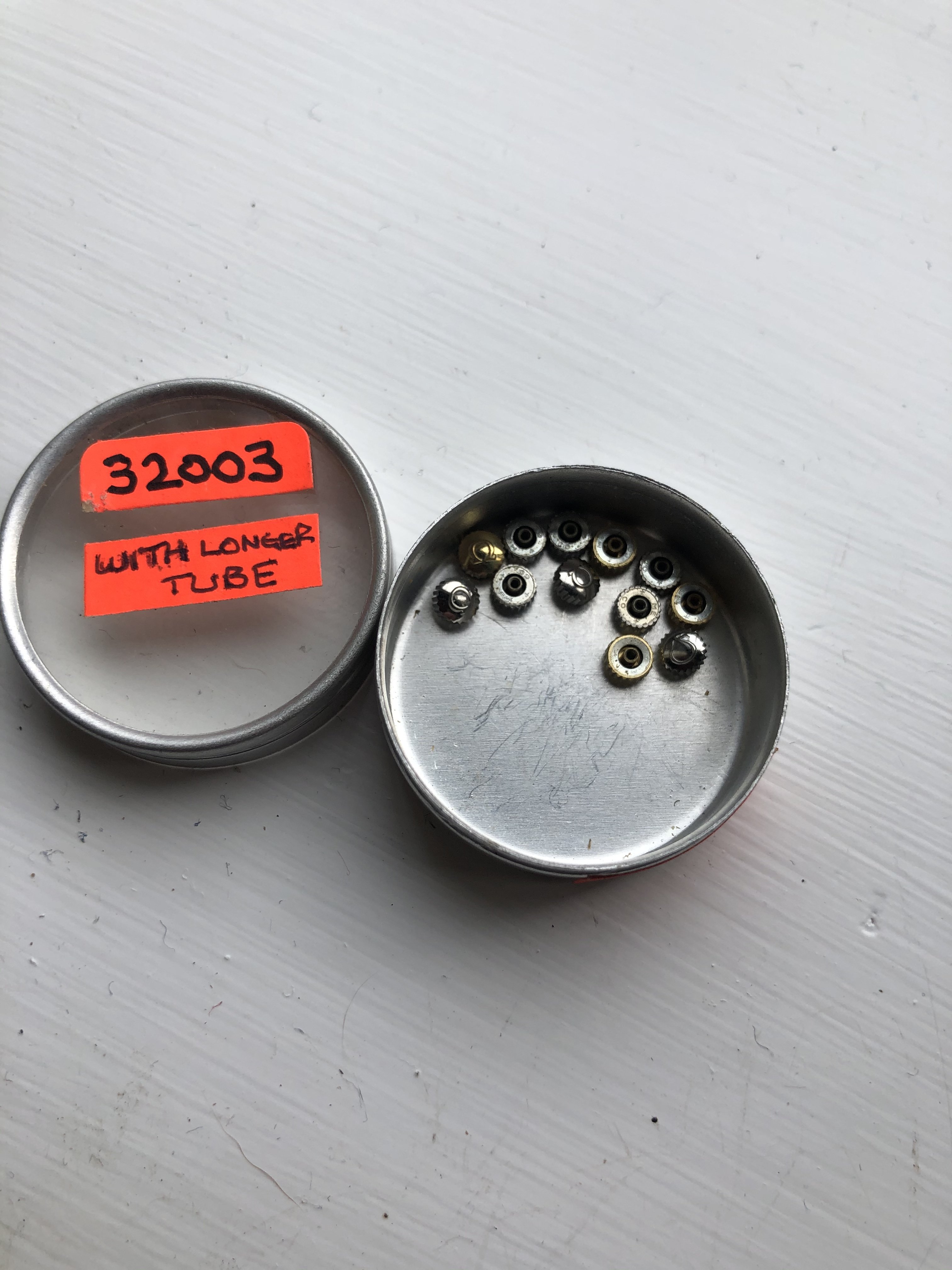

I’ve got loads of NOS crowns. Send me a DM with what need and I’ll have a look for you
Just saw this after my post - thank you. Have DMd you.
