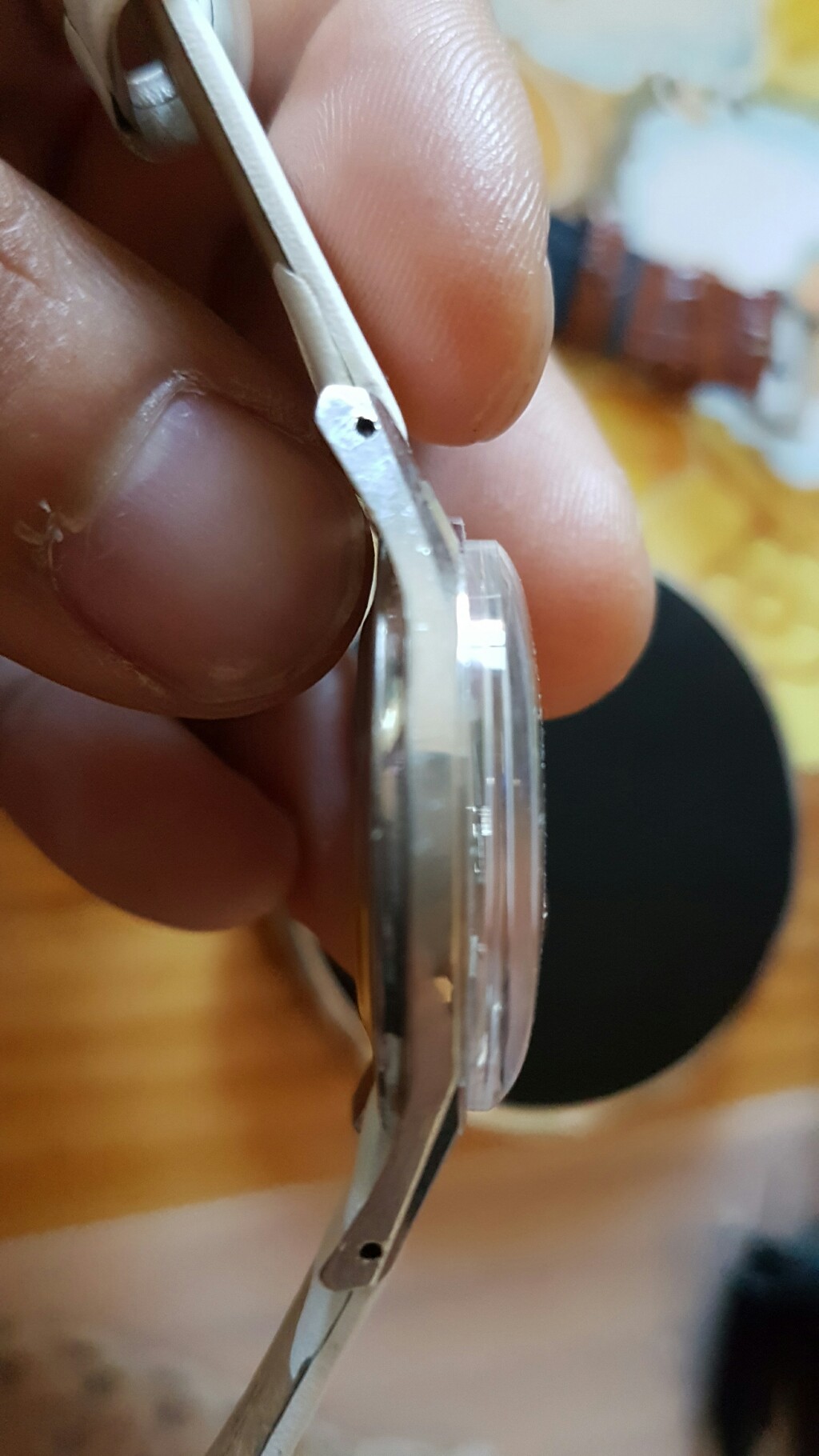

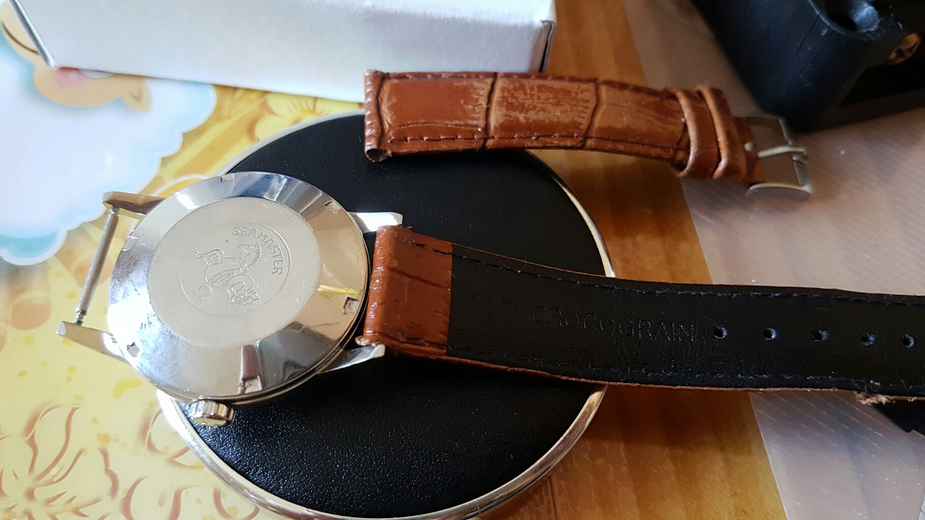

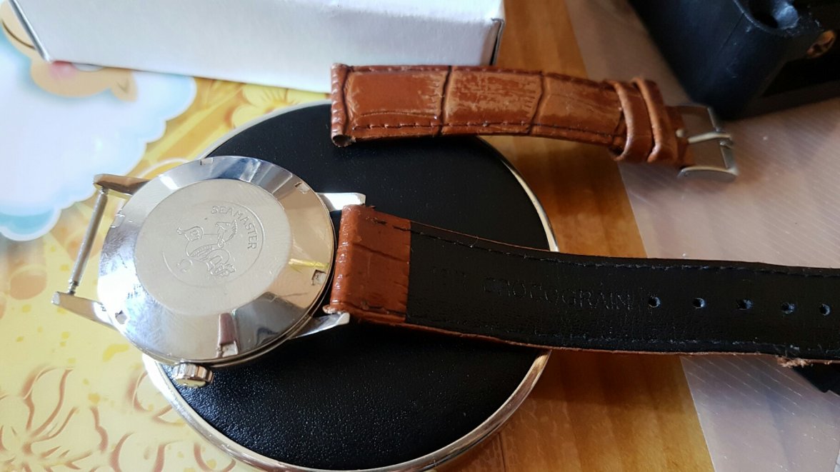

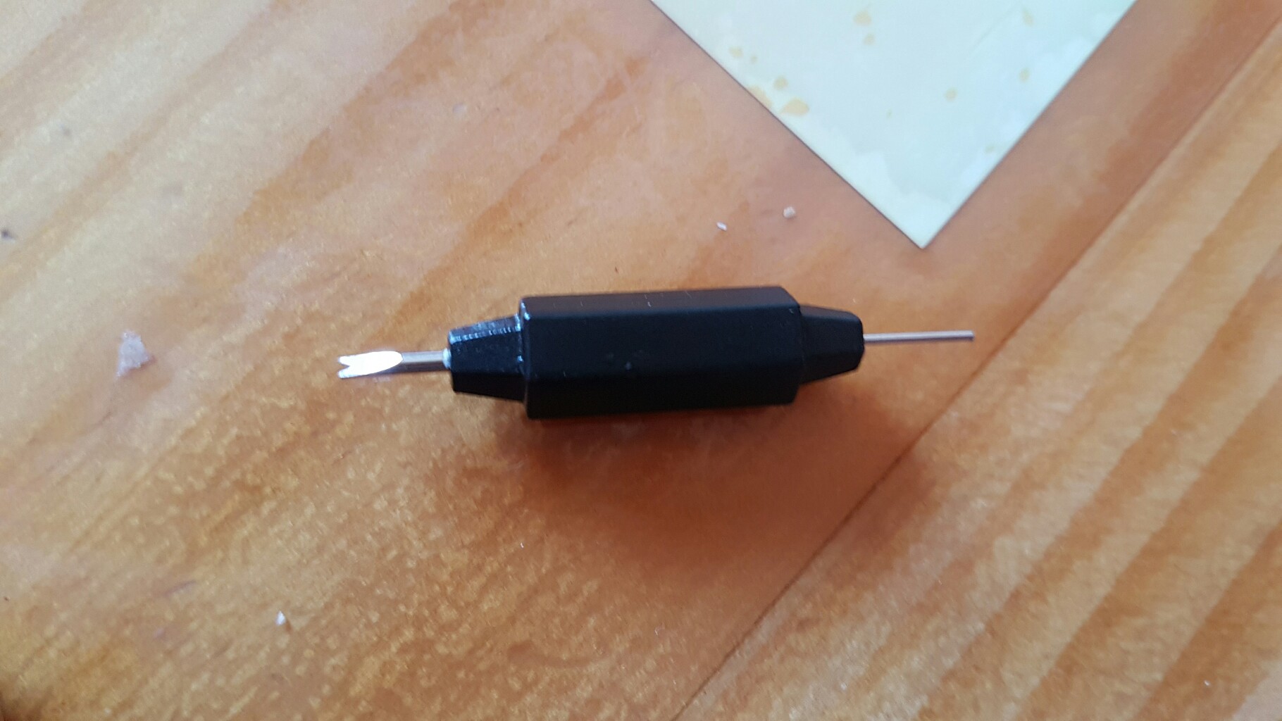

Jokes aside, all watches have lugs which are the end pointy bits the strap/bracelet/band go between. For your Constellation (and for most watches) you have a springbar that goes in between these drilled holes in the lugs. To remove the springbar, you can start with a tool like this:

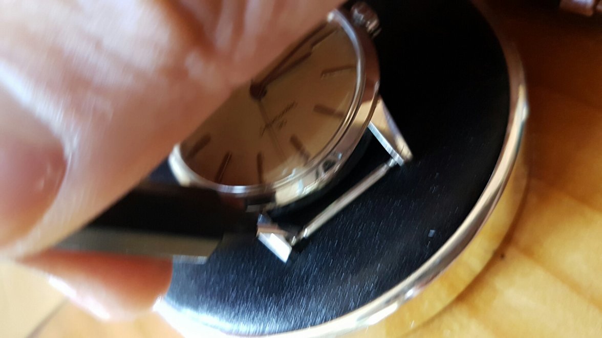

One side has a prong that 'fits' into the end of the springbar. The other end is for pushing springbars out if your watch has a hole on the other side of the lug:
To take the springbar out, you gently put the prong side of the tool into the curved slot of the springbar and push down. Do this slowly on a protected surface area. Release the springbar gently so that it drops down onto your work surface. Otherwise it will fly away and you'll spend quite some time looking for it...

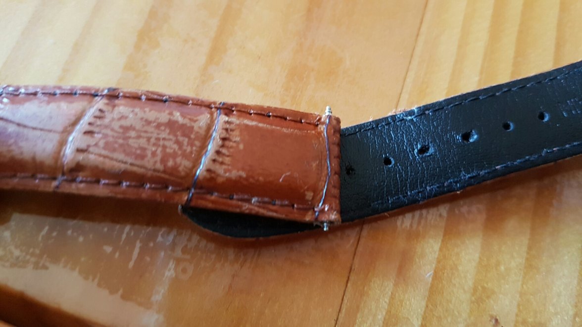

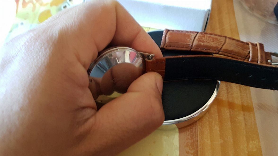

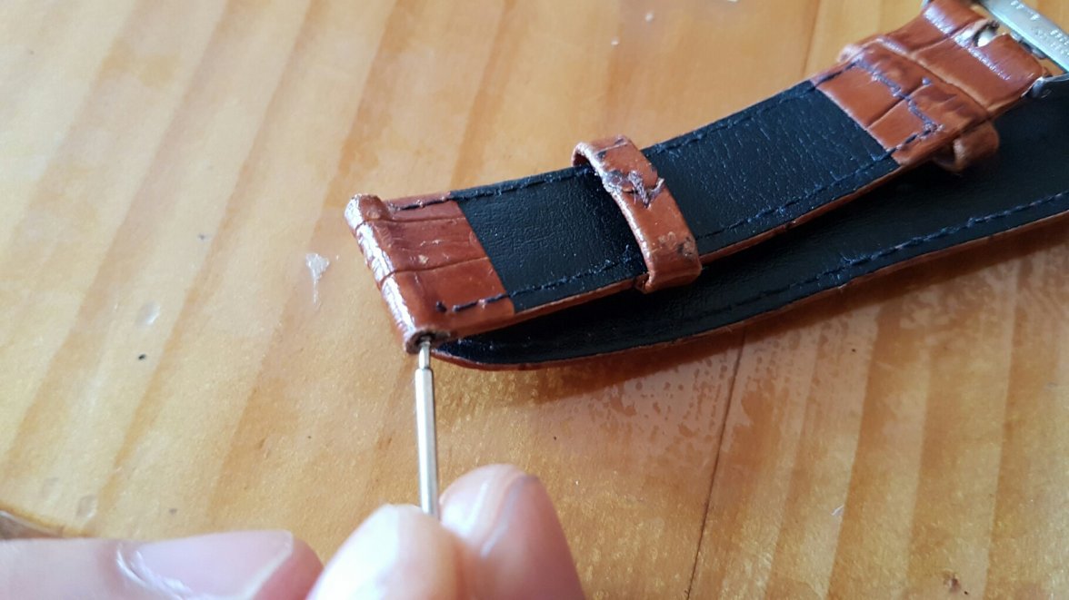

Put the springbar into your band. There should be a loop at one end of both pieces of the band. Insert the bar through here. Most of the time the springbar should fit snugly through; if it doesn't, it may be too big or the strap loop is too small. If this is the case, you will need to find slimmer springbars or a bigger strap.
Making sure that both ends of the springbar protrude out of the band, first place one end into a hole on one lug. You then want to use the prong side of the tool and push gently down on the springbar. This will squeeze it down so you can fit it and the band. Once you have the pin inside the lug gently move it from side to side until you hear it 'click' into place.
Then all you need to do is put the other side of the band on!
Practice makes perfect with these - however, there are also people who prefer just asking a watchmaker to do it for them. It is an useful skill to learn though!

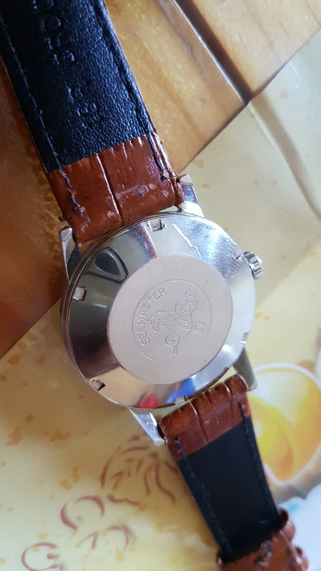

Well, on the back, I can see that it is written 18K 0.750. This means that it is 75% solid gold.

If we are talking about the watch in your origional post @GeorgeBailey2 then the inside of the case back tells us it is 18K solid gold. The 18K and 0.750 stamped inside the case back confirm this with no doubt!馃憤

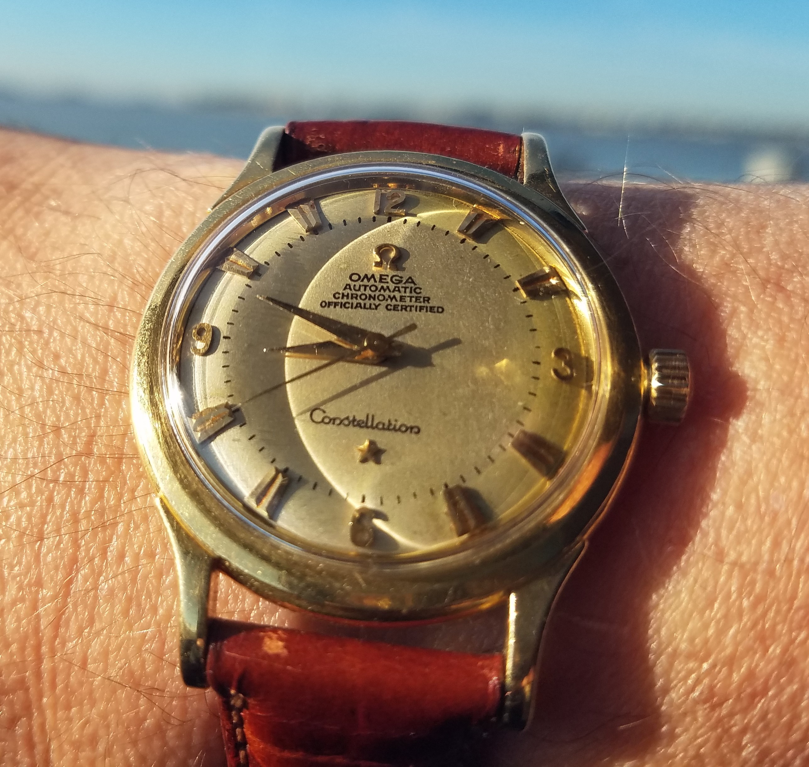

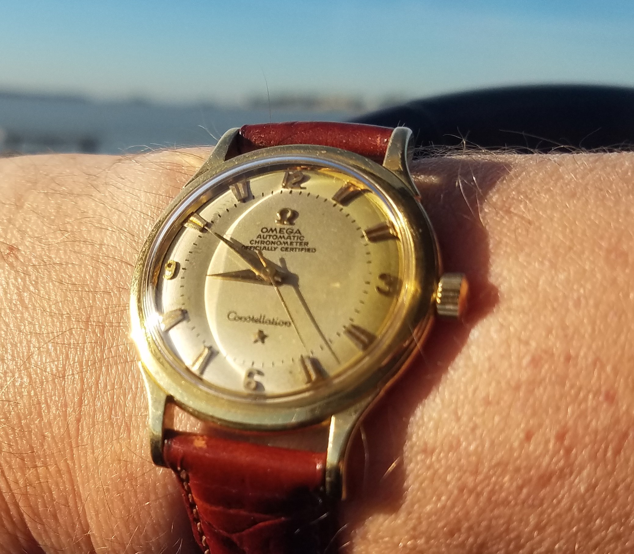

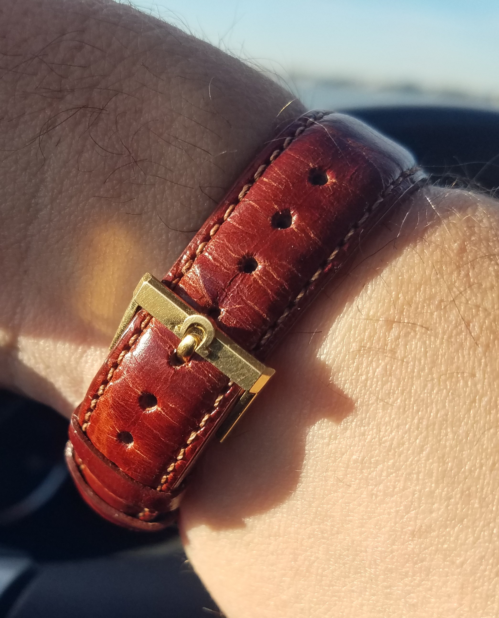

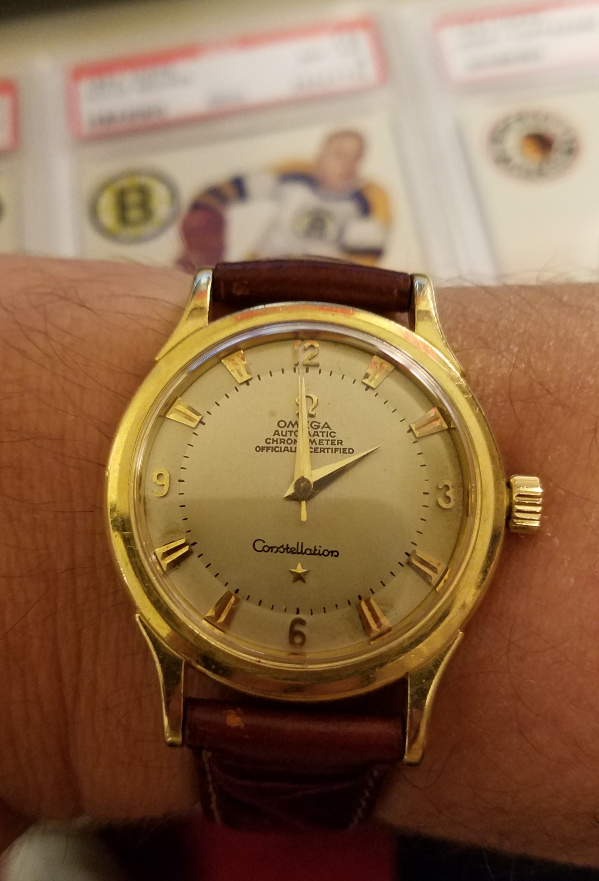

I went into the city (Manhattan) finally and picked up my father's watch. They serviced the watch, replaced the crystal and sourced a crown. No polishing was done. Let me know if the crown looks correct. I added a relatively inexpensive strap and they put on the 18K buckle I scored on Ebay. They were not interested in the gold plated vintage buckle as trade on the strap (hello Ebay). I am glad to finally have it on my wrist. Of course, having been on this site for a few months, I also find myself longing for a Speedmaster or a Seamaster. Here are the pics:

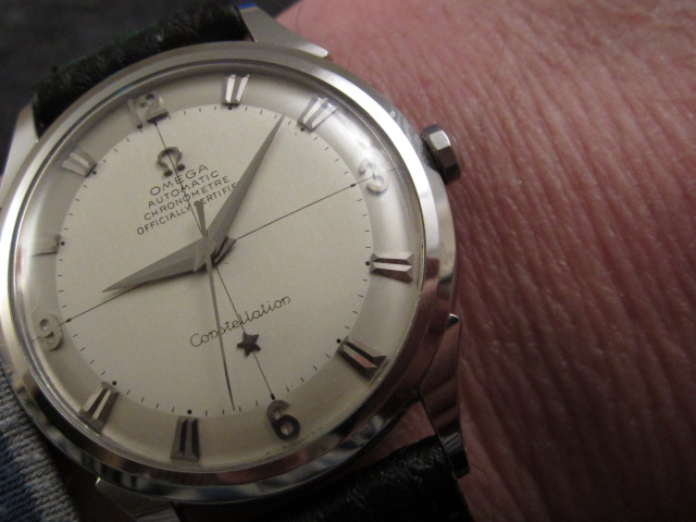

here is my Connie Ref.2648-1-SC in Stainless Steel with the original, never refinished dial馃グ.
Please take a close look at the points near the hour markers and the stripes near the arabic numerals!
Those are characteristic for the original dial!
Best regards, Reiner

Right. When I initially reached out to Desmond on his site, he quickly established that it had been redialed (hour hash marks v. dots, no cross-hairs, no Swiss Made under the 6), as was the custom, at some point when it was serviced. Since my dad wore this (pretty much) daily from 1953 until pretty recently (probably when he cracked the crystal, say 2008), my guess it was redialed anywhere from 1967 to 1980. I am hoping we are able to find an Omega file in his file cabinet that includes a service history.
The dial on yours is amazing. It looks as though it was tucked away in a drawer from the moment it was purchased.
With mine, ultimately, I may have an internal debate regarding the redial. Yes, the redial has its own 30 to 40 year history, but it is a redial. How much of the sentimental value should I assign to the dial as opposed to the case, markers, and hands? Is there anyone out there that can accurately re-redail (is that a word?) it? What would Omega do to it if I explicitly requested no polishing?

They might refuse to work on it. However, that's kind of a moot point now, since you've already had the movement serviced. Note that Omega uses an outside firm in Switzerland to do any dial refinishing work. Those costs are added on to any factory service bill and it isn't cheap.
The correct crown is still available from Jules Borel:
