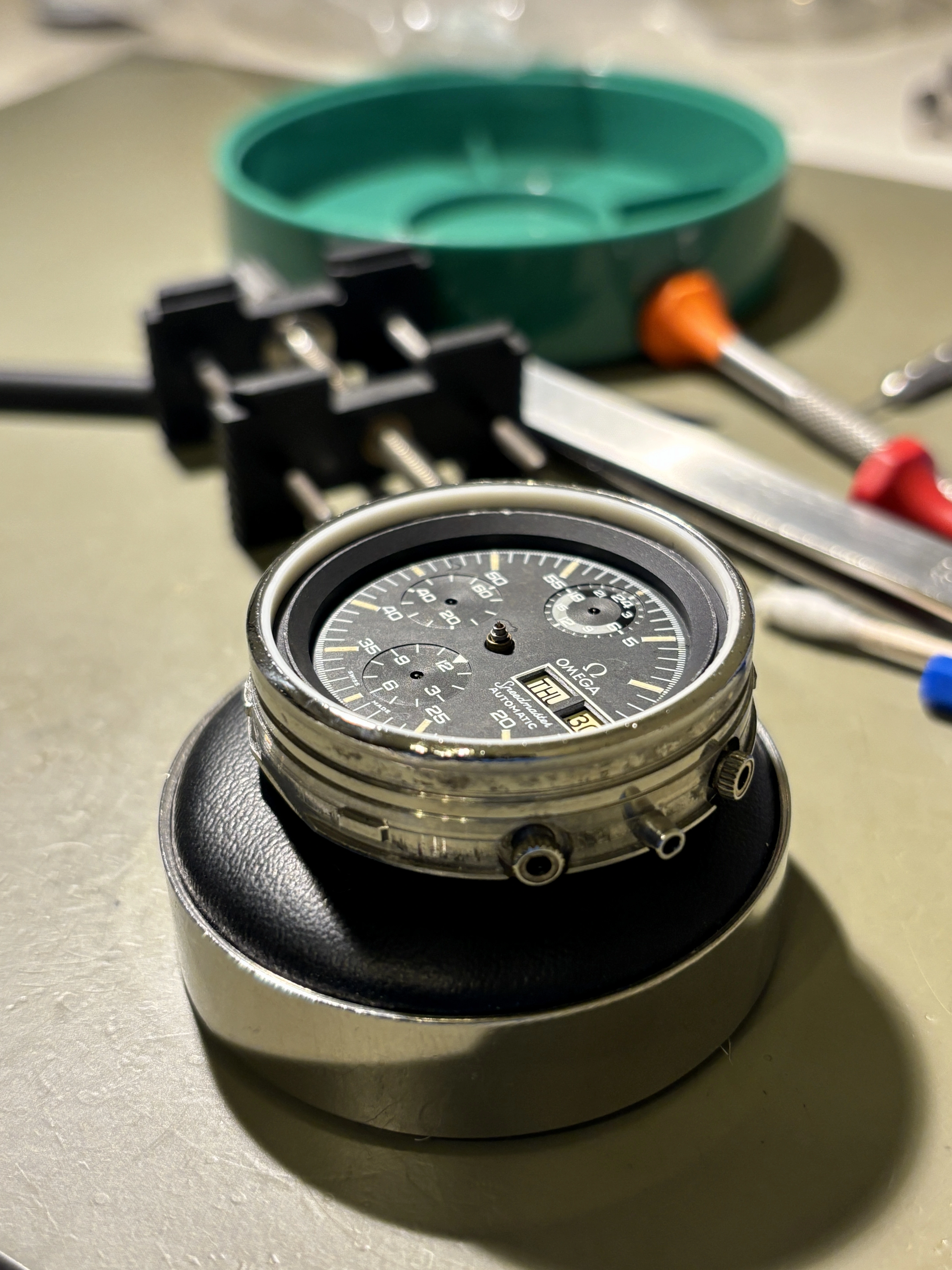

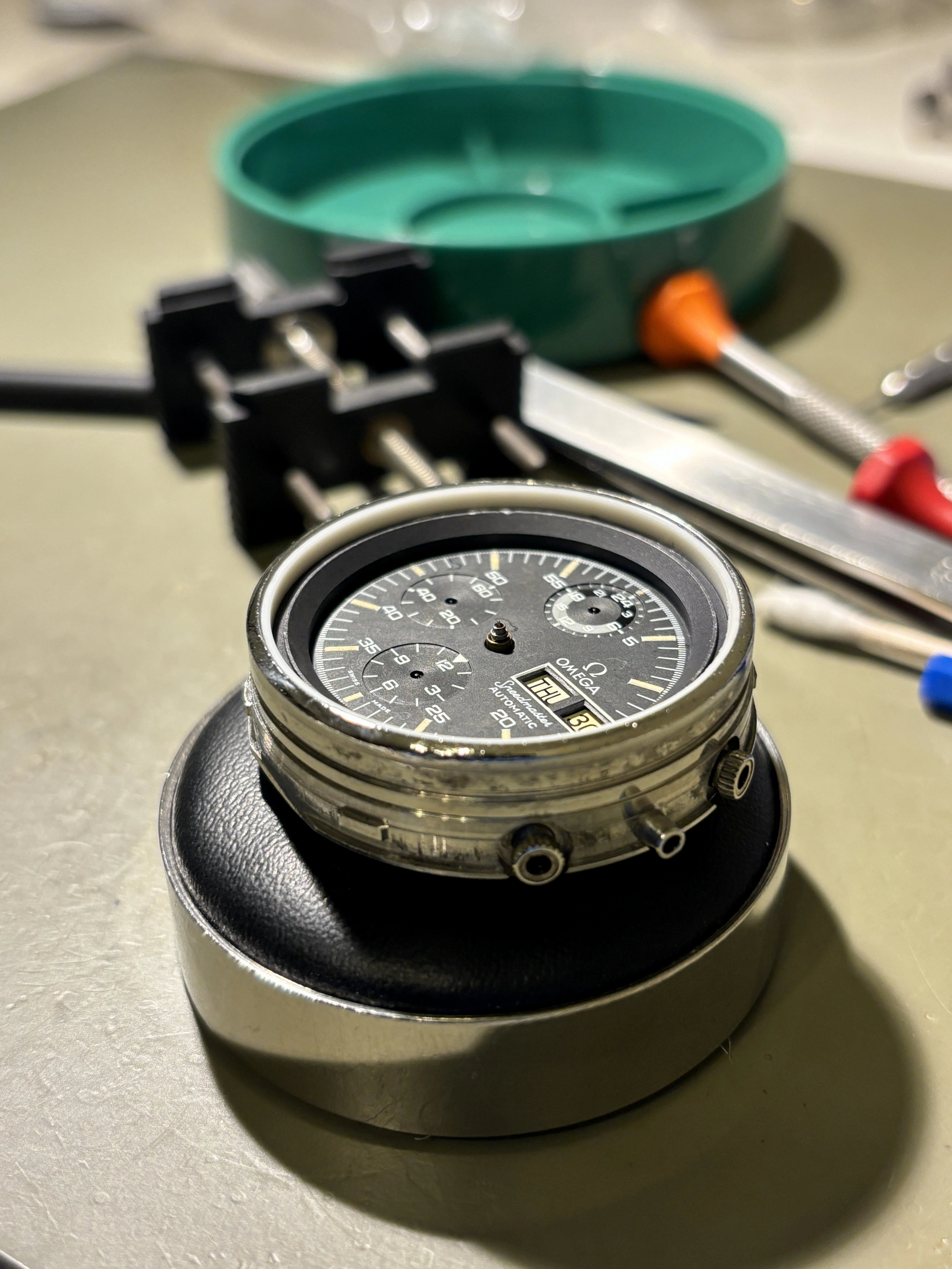

I am currently restoring a 176.0012 and in the need for a couple parts , i was unable to identify the parts no' myself so i would appreciate the forum's help
1. case back seal
2. Middle case seal ? not sure whats the correct name for it .
3 . pusher spring .

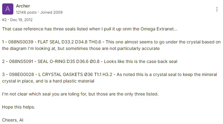

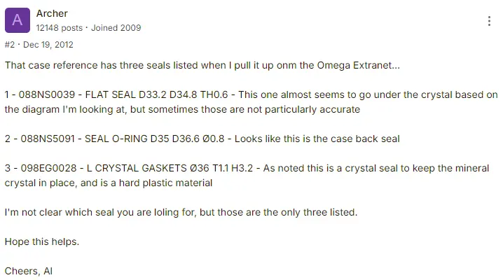

Reposting Al's response from 12 years ago on another forum:
I think Omega sells the pushers as one piece, so I don't think there is a part number for the springs.

Thanks ,
But I get weird results with those numbers ,
thats should be the middle case gasket but it says on the listing its a crystal gasket .
https://www.ebay.co.uk/itm/27592168...8MH3DB&hash=item403e36d2b4:g:vmYAAOSw-nZdZRsB
and this should be the case back gasket but 176.0012 doesn’t show up with the list of ref's .
https://perrinwatchparts.com/produc...088ns0807-see-all-case-numbers-in-description
and if thats the case with the pusher then its a real bummer 😕

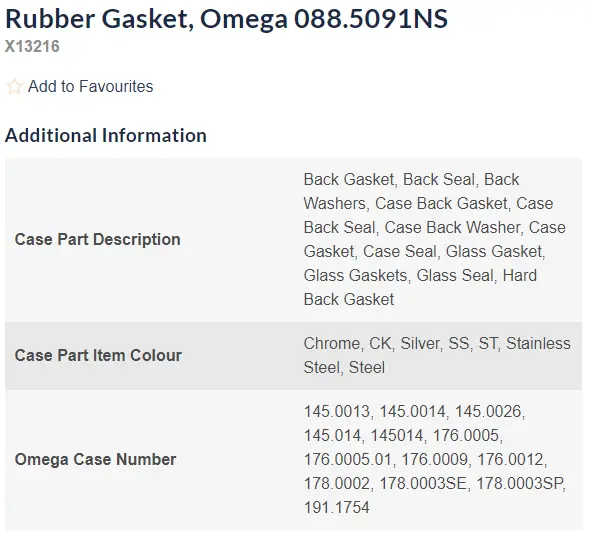

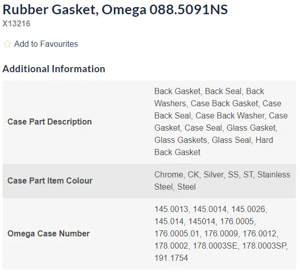

I wouldn't trust eBay in this case. Who knows what the seller's description is based off of?

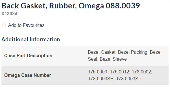

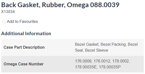

My guess is 088NS0039 is the middle gasket. Cousins shows it is for 176.0012 here and calls it the bezel gasket:
Here is the 088NS5091 on Cousins for the case back:

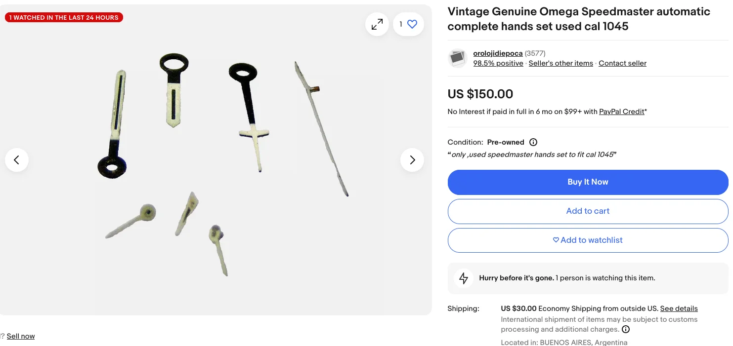

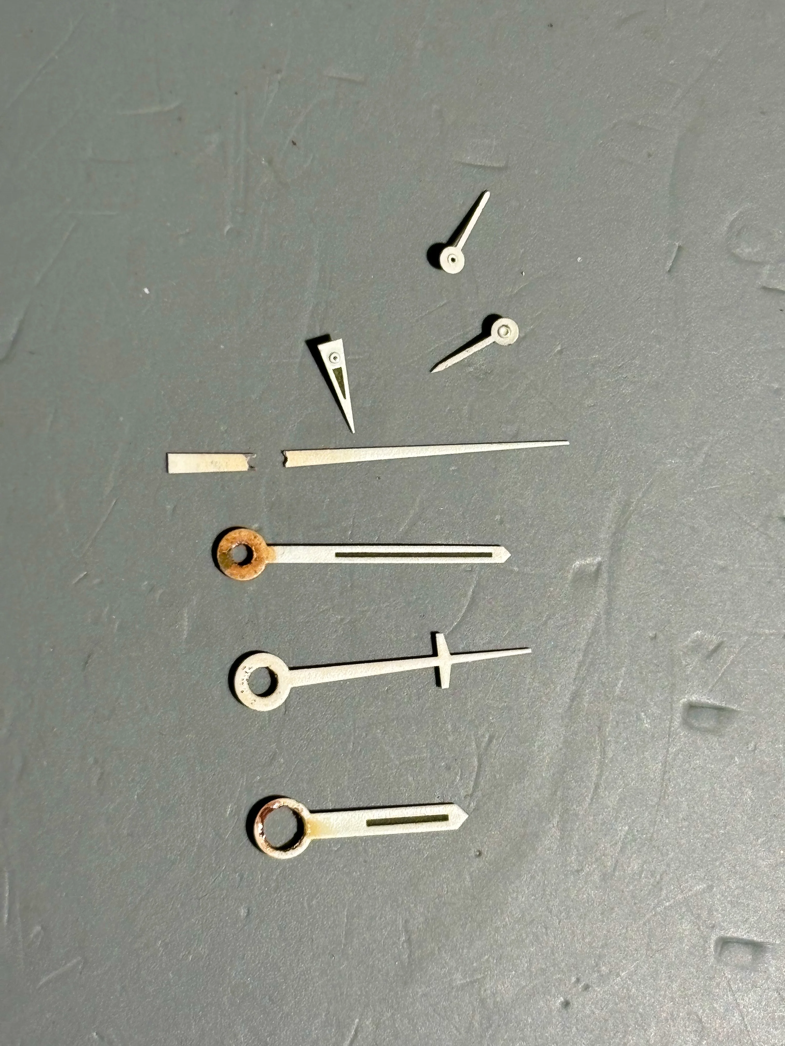

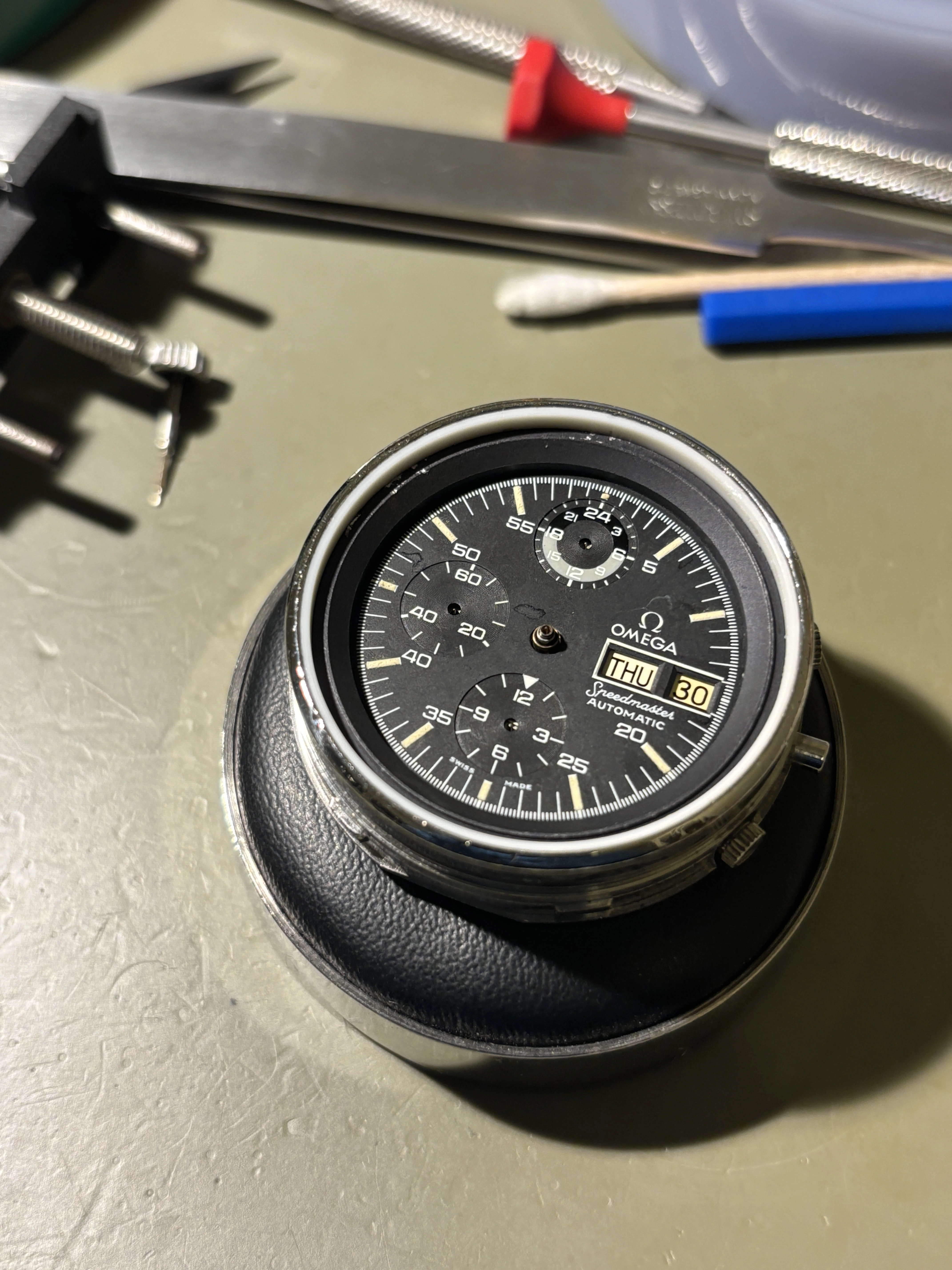

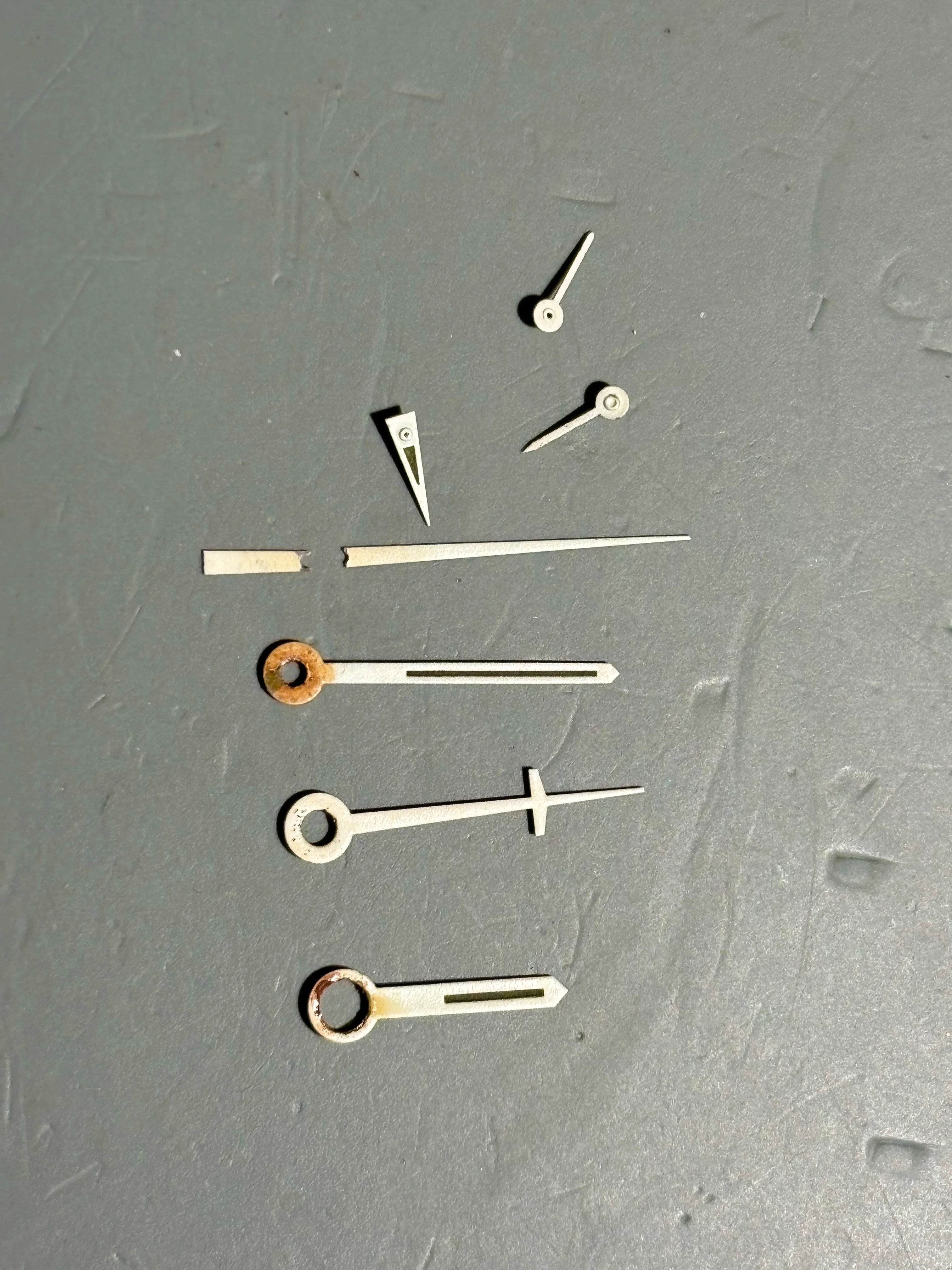

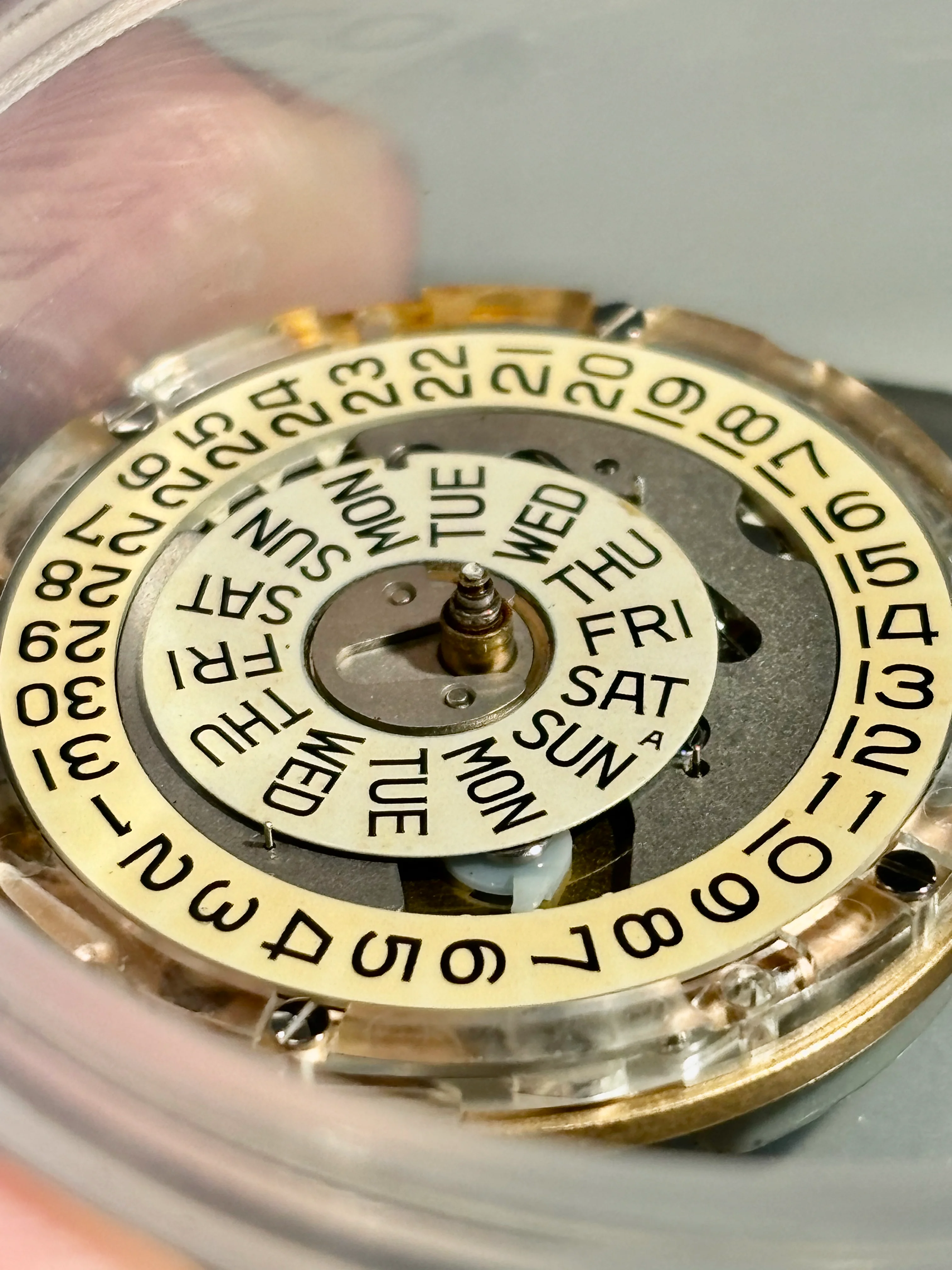

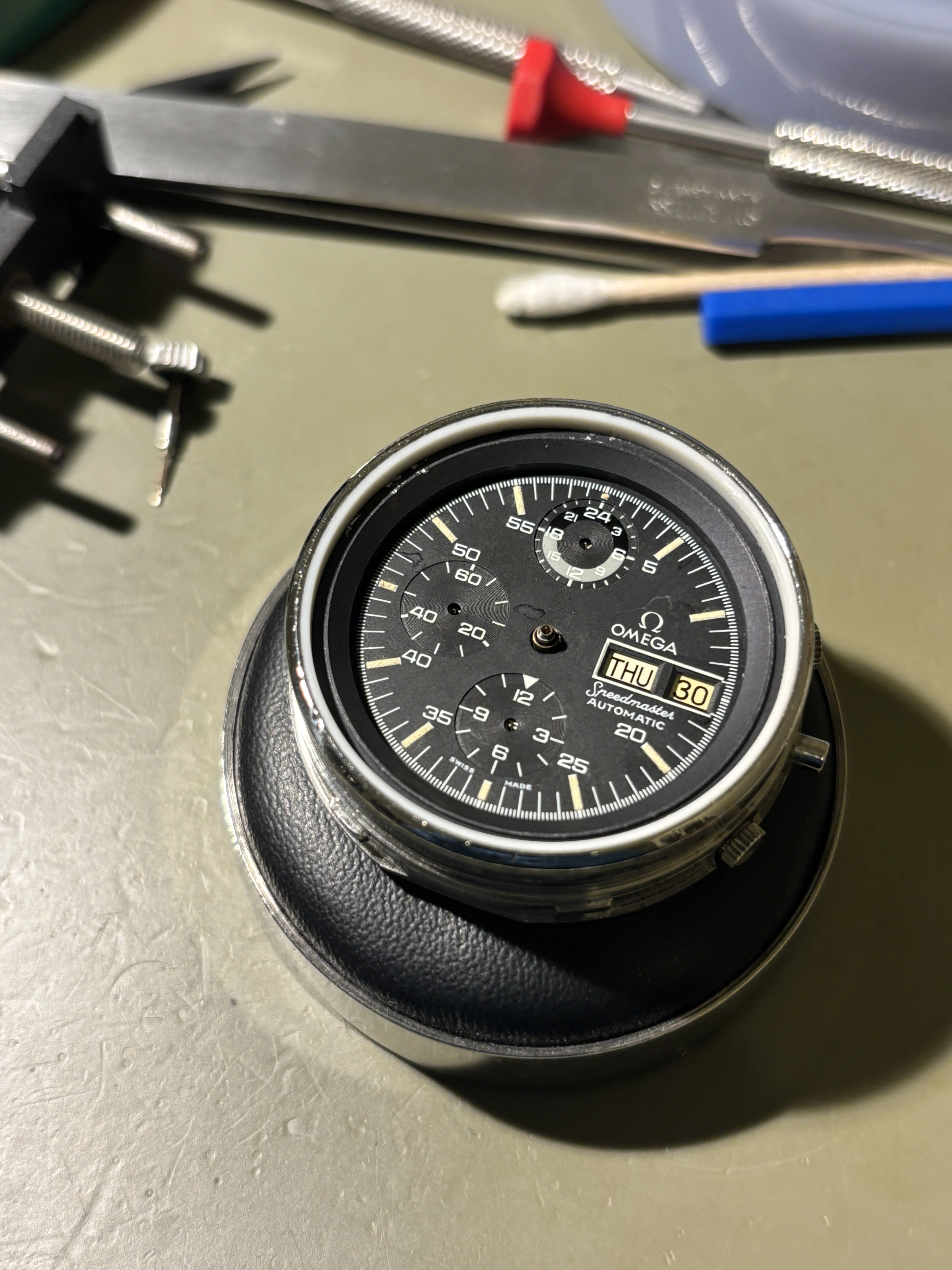

Thank you for the thorough answer , at first i thought i could save the original hands by either cleaning or completely repaint them .
but removing them ended with a broken chrono second hand which was rusted into place .
maybe the time hour and minutes can be saved with a lot of work . the rest are ok .

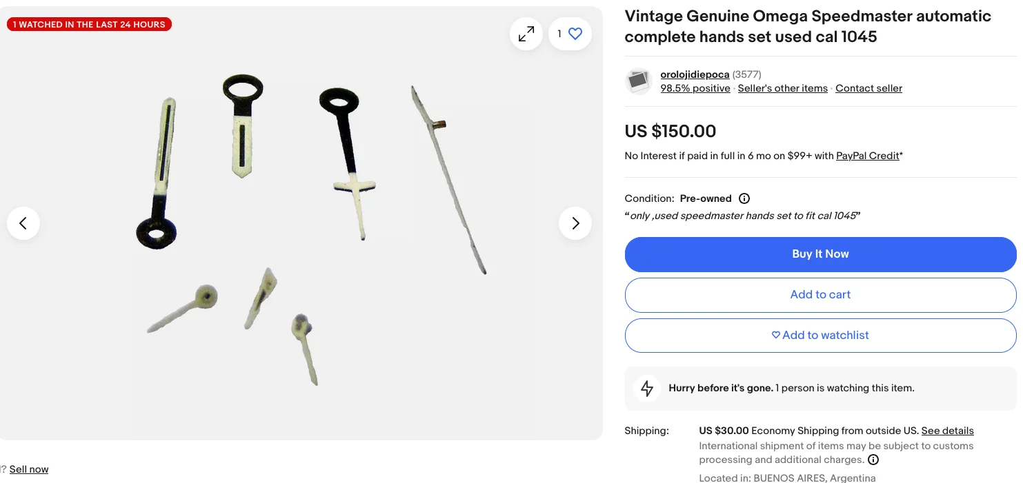

Minute and hour hand aren’t that expensive but there isn’t a second hand for sale other then buying a set .
saw a new set for 350 + shipping which sound a bit high but i could be wrong .
theres a incomplete set of used hands in bad shape for 100+ shipping which could be restored .

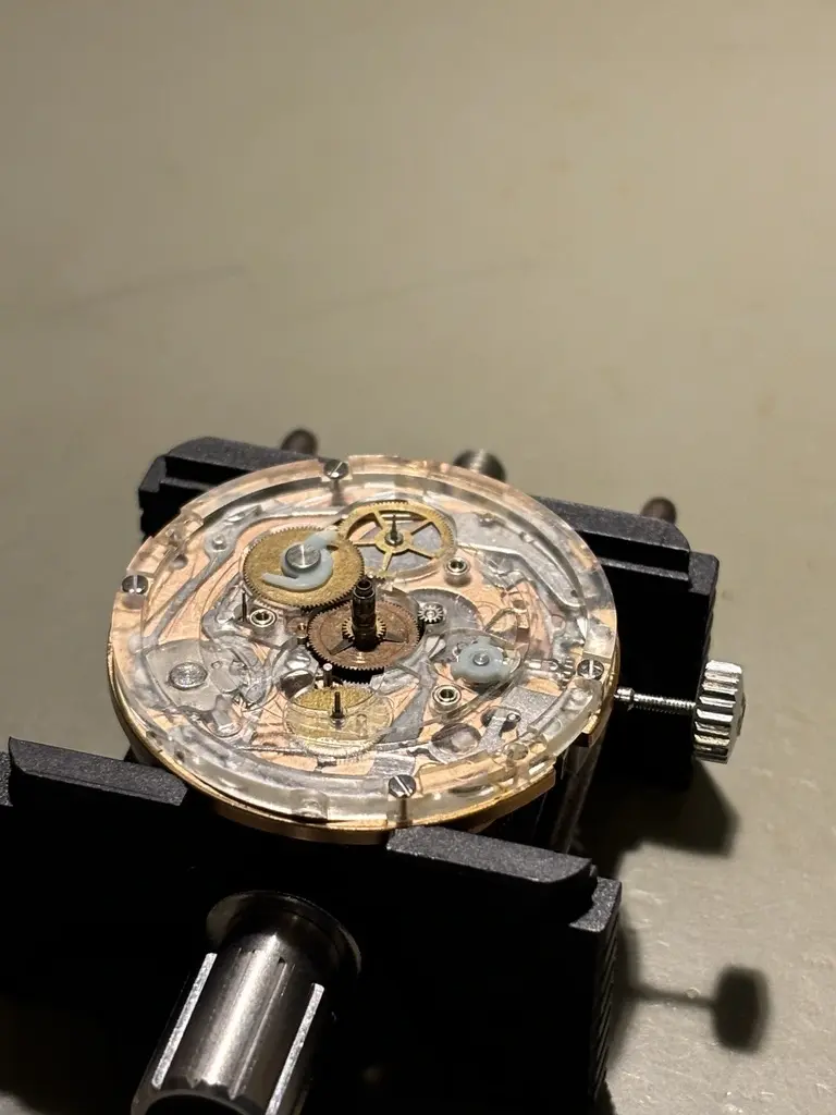

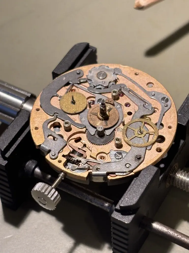

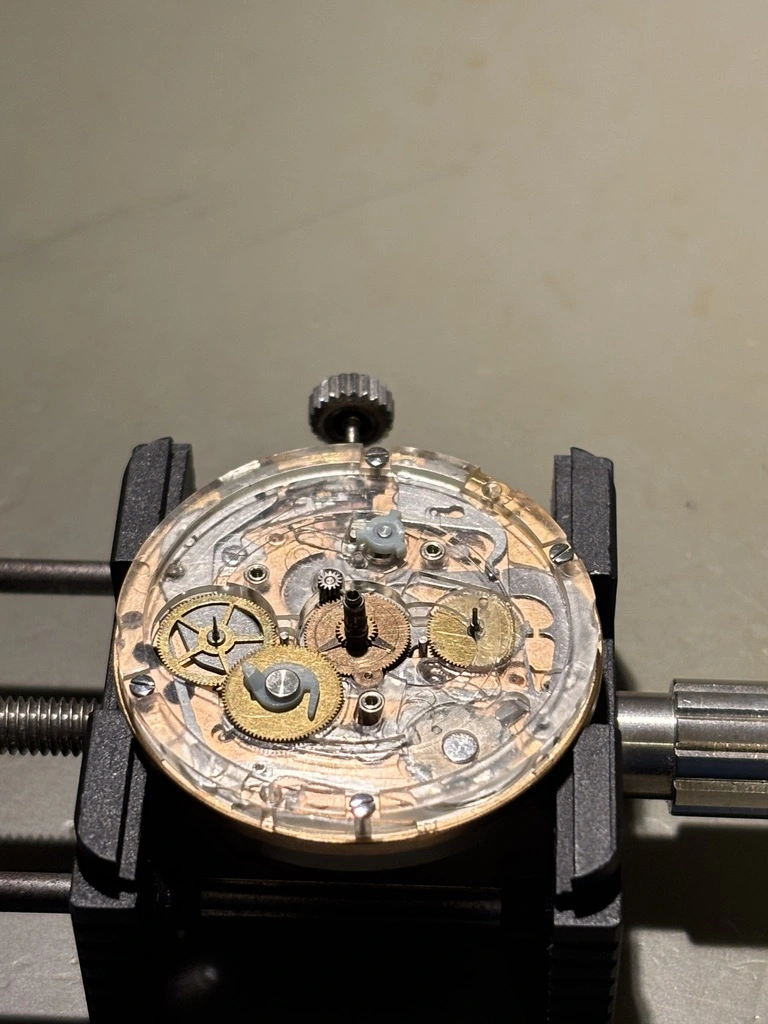

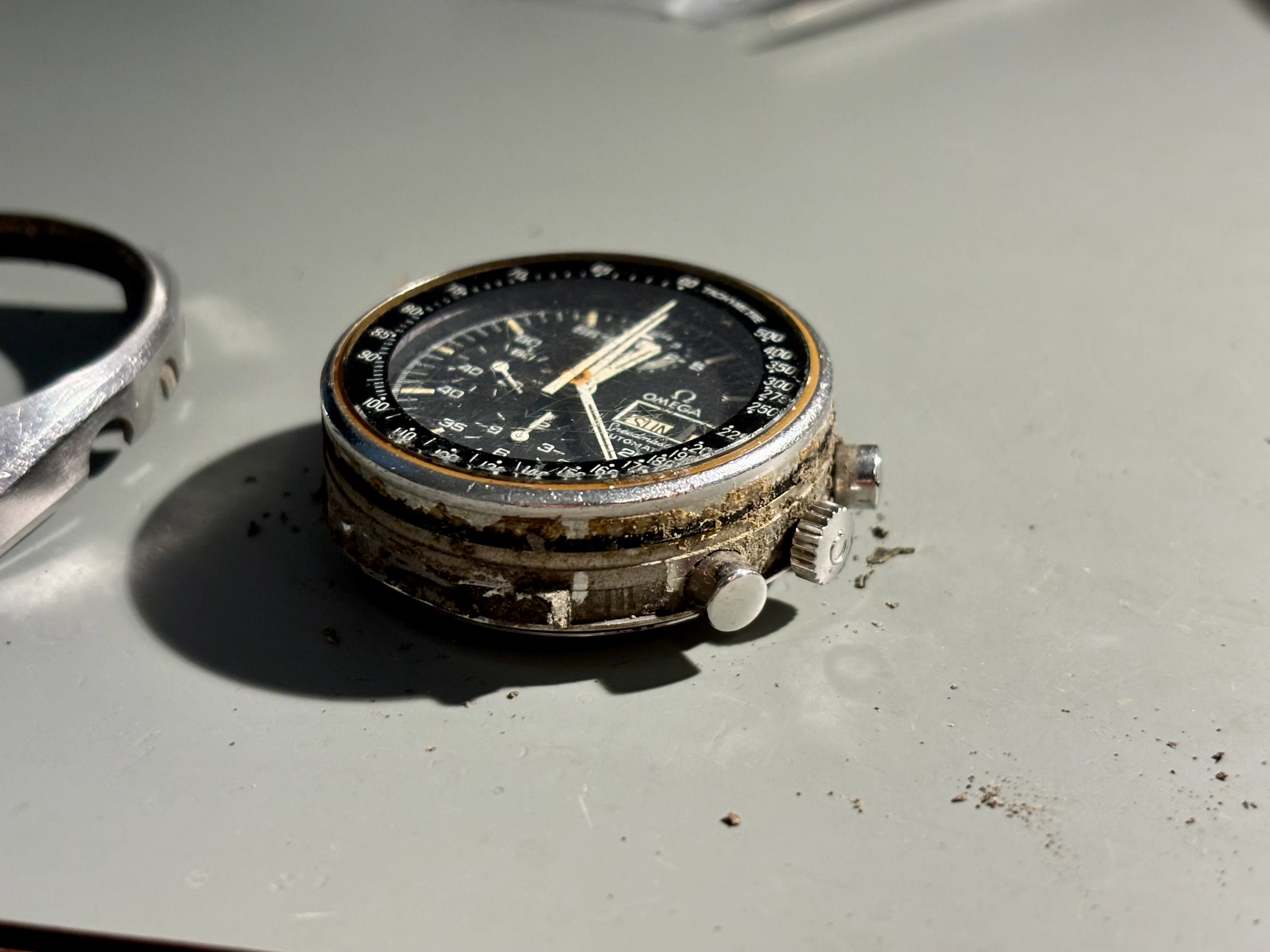

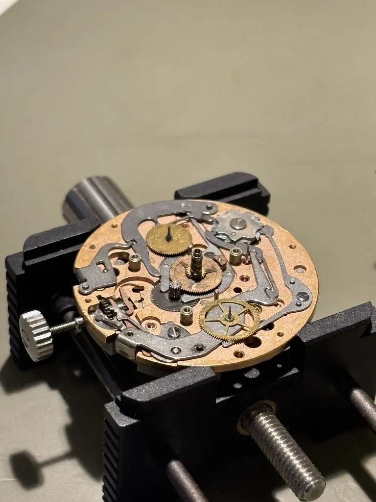

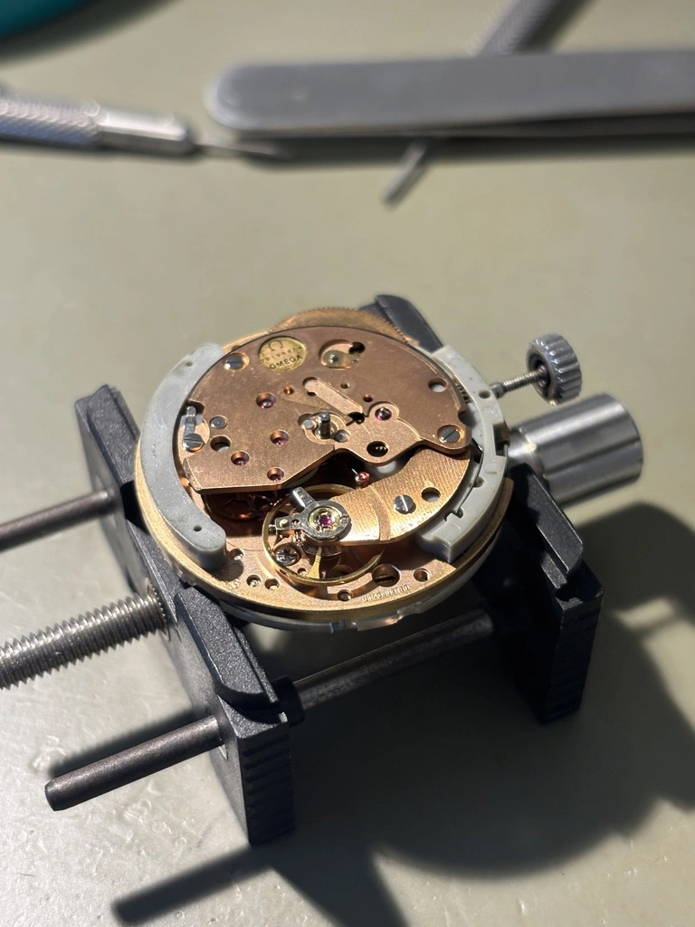

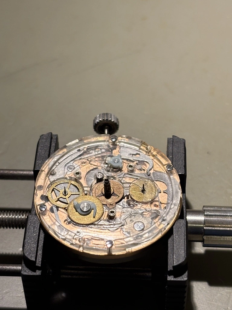

those are my watch hands:
and the movement , where you can see the center of the hand still in place :
(looks like there is some rust on the motion side but hopefully not to much , this as far as i got by now )
254
401
What happened to that poor bloody watch to get it in that sorry state?
it definitely have seen a lot of action , I bought it from a guy who’s grandfather was the owner of the watch and he told me it was on his grandfather wrist for over 30 years !

I agree that 350 is reasonable , but it is a large amount of money . buying a full set of hands wasn’t a part of my plan .
i'm not in a rush , so i will check all of my opinions .
in the original hand , is the tube welded on ? the shape reminds a rivet process .

Please note that the numbers I’ve provided for these parts come directly from Omega. If some third party vendor has them identified differently, we’ll personally I trust Omega to know their own products more than a third party...
254
401
I didn’t question the numbers you provided ..
just wanted to share the weird results i got .
Sorry if it was misinterpreted .

for future search results for 4.5 restoration purposes I ordered the same gaskets, crystal, etc using Archer's numbers from 12 years ago (which Rendo dug up and shared), Cousins, and TMWatchCo (which I'll post back on after I install).

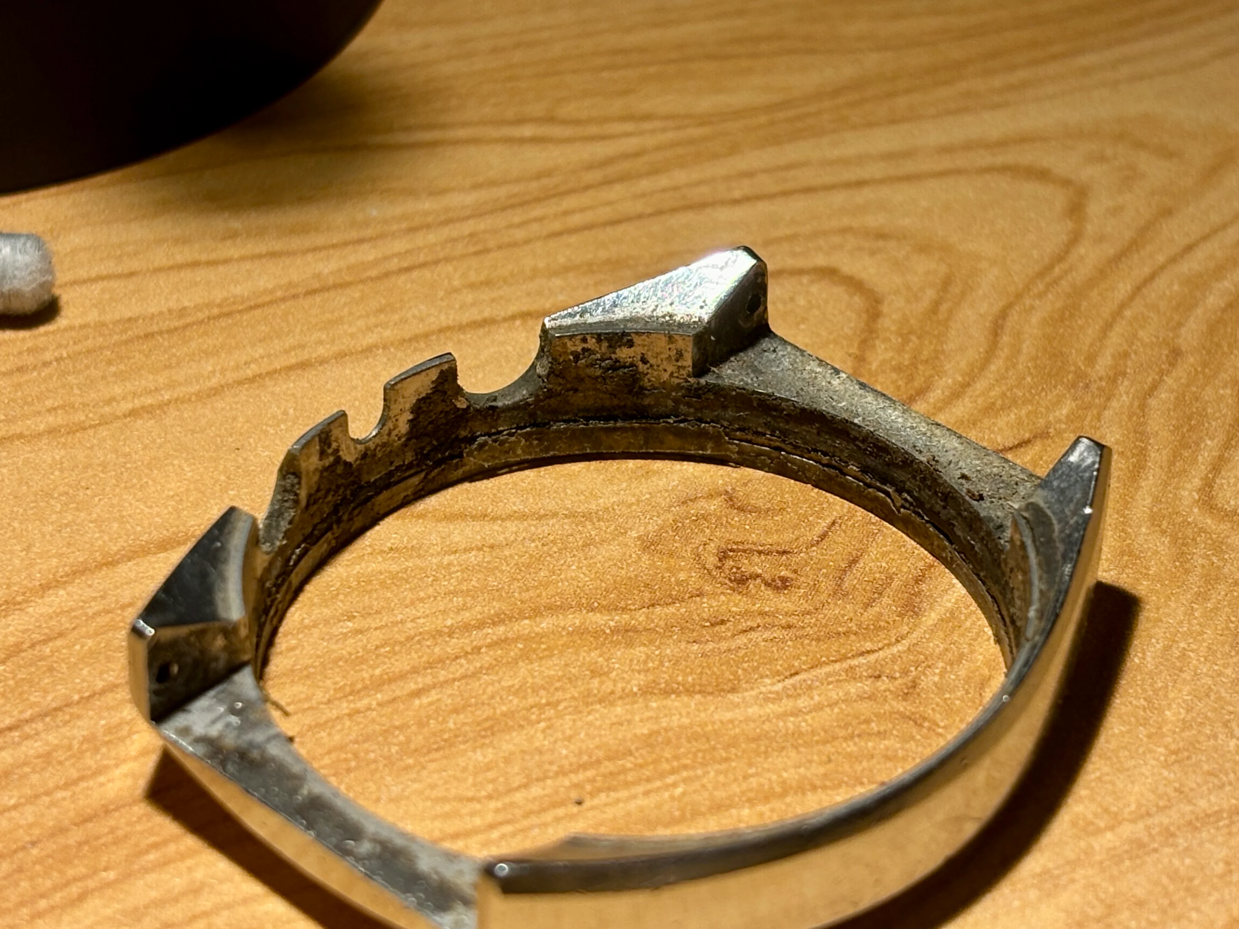

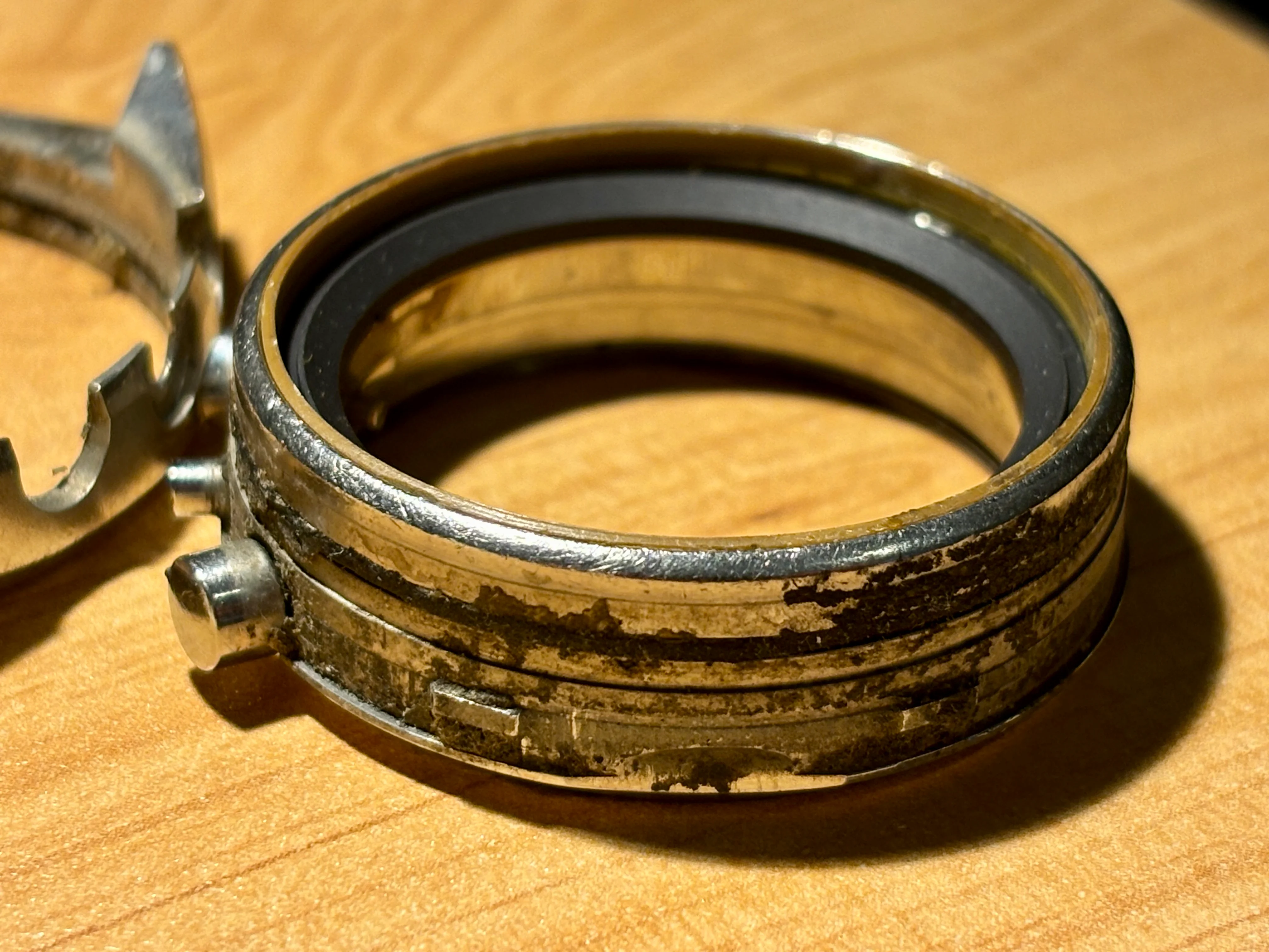

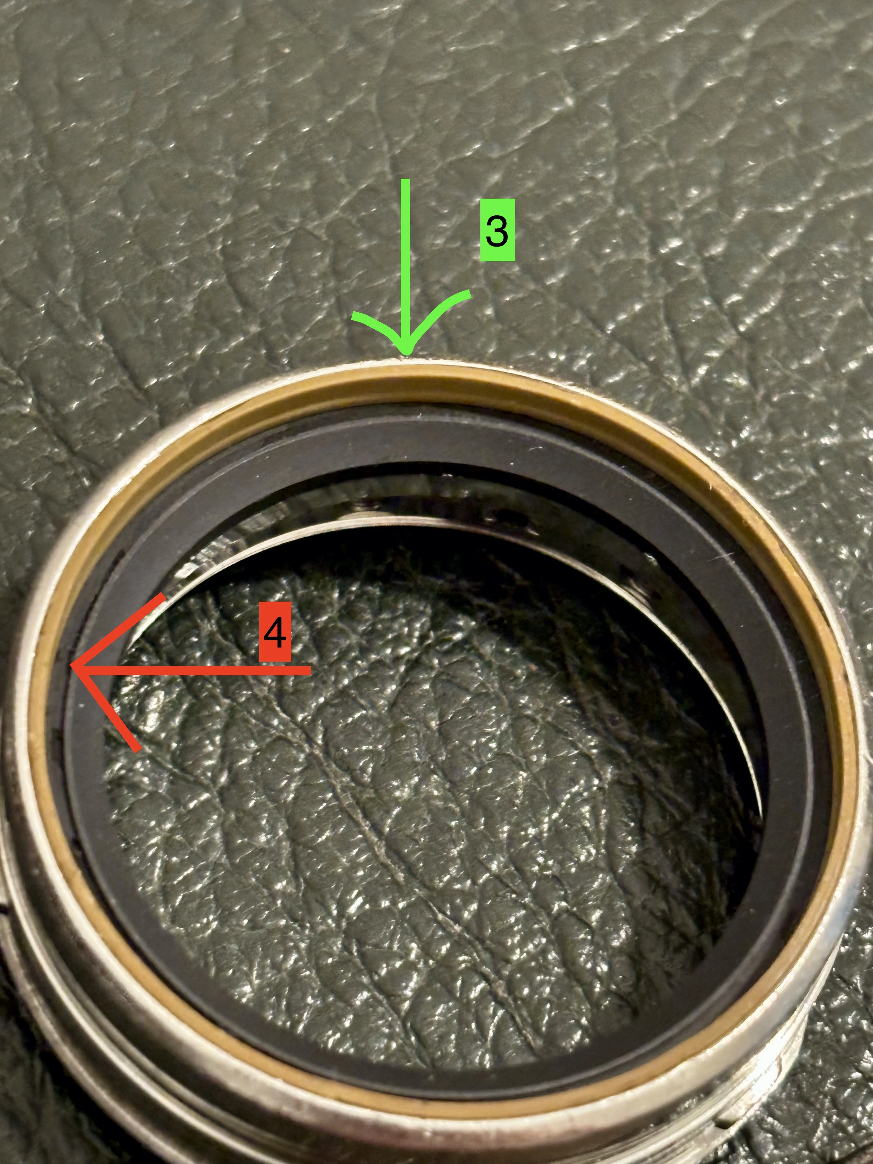

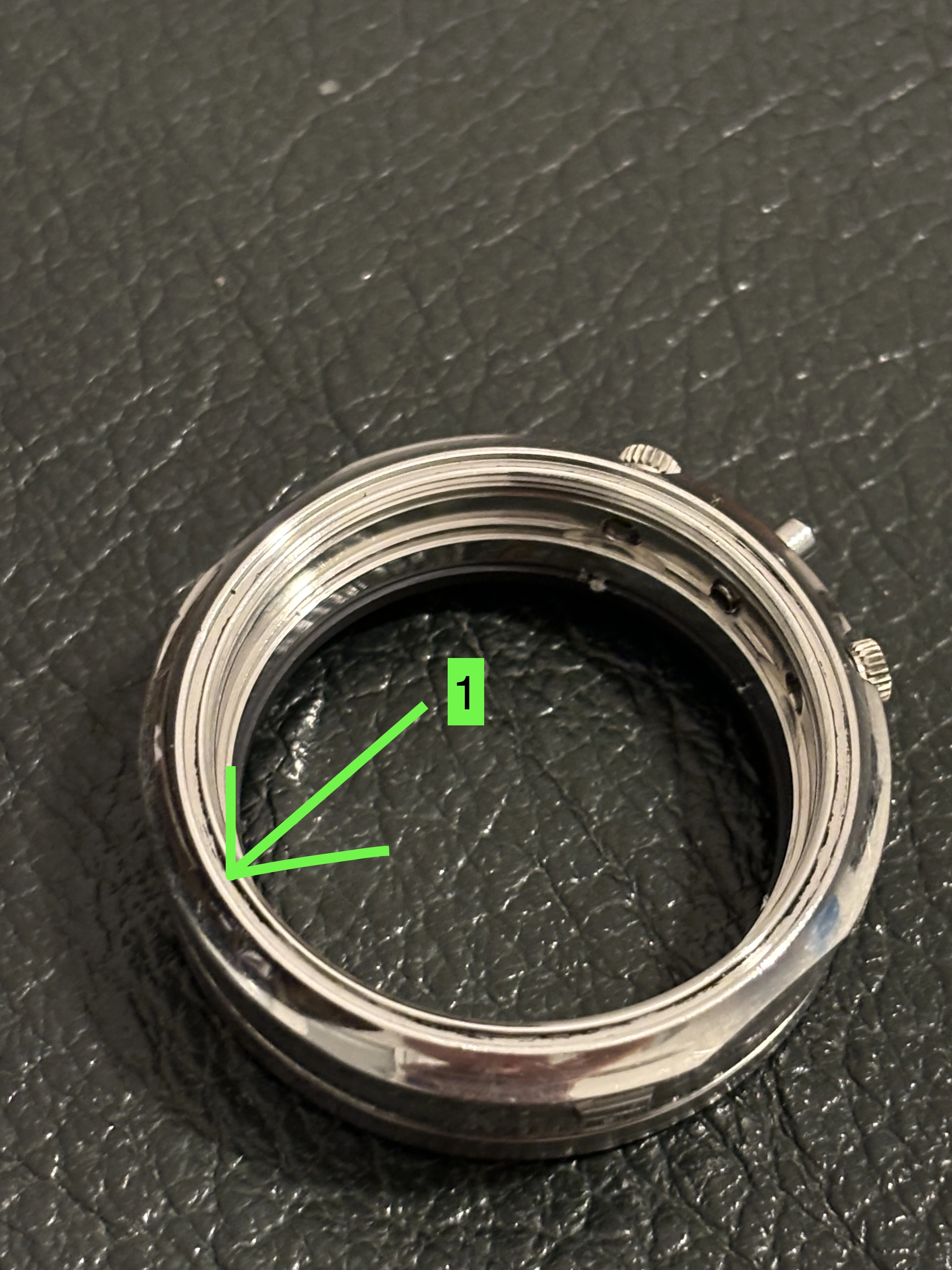

also bought the crystal and the L shaped gasket from TMWatchCo , haven’t used them yet but looks good .

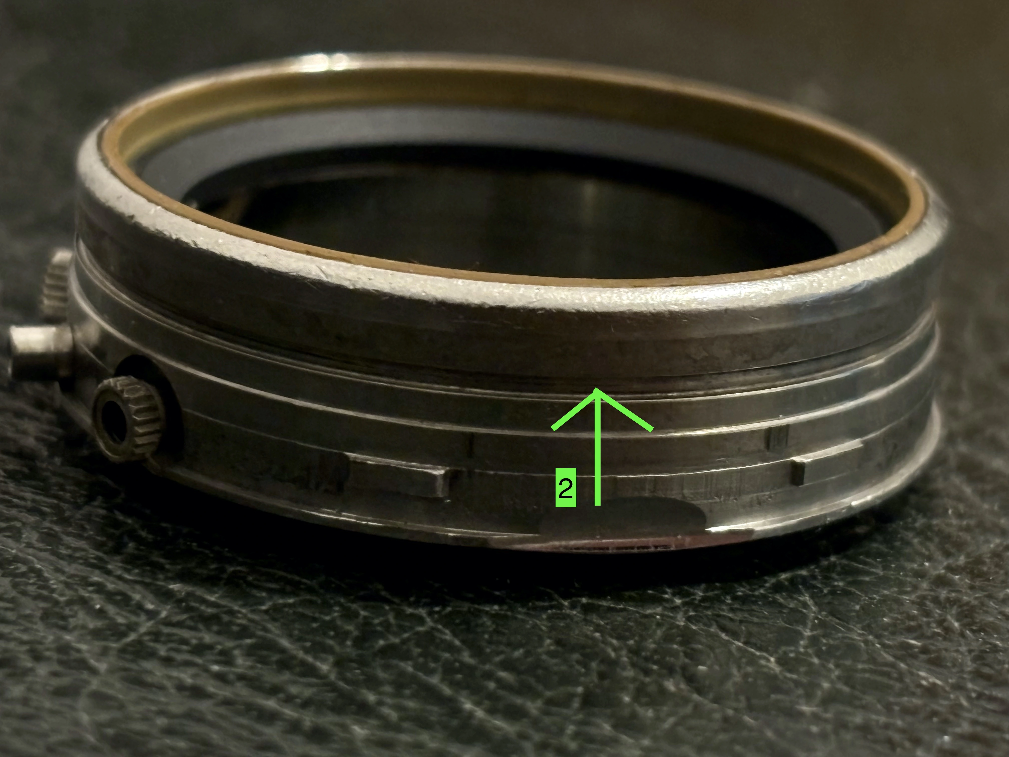

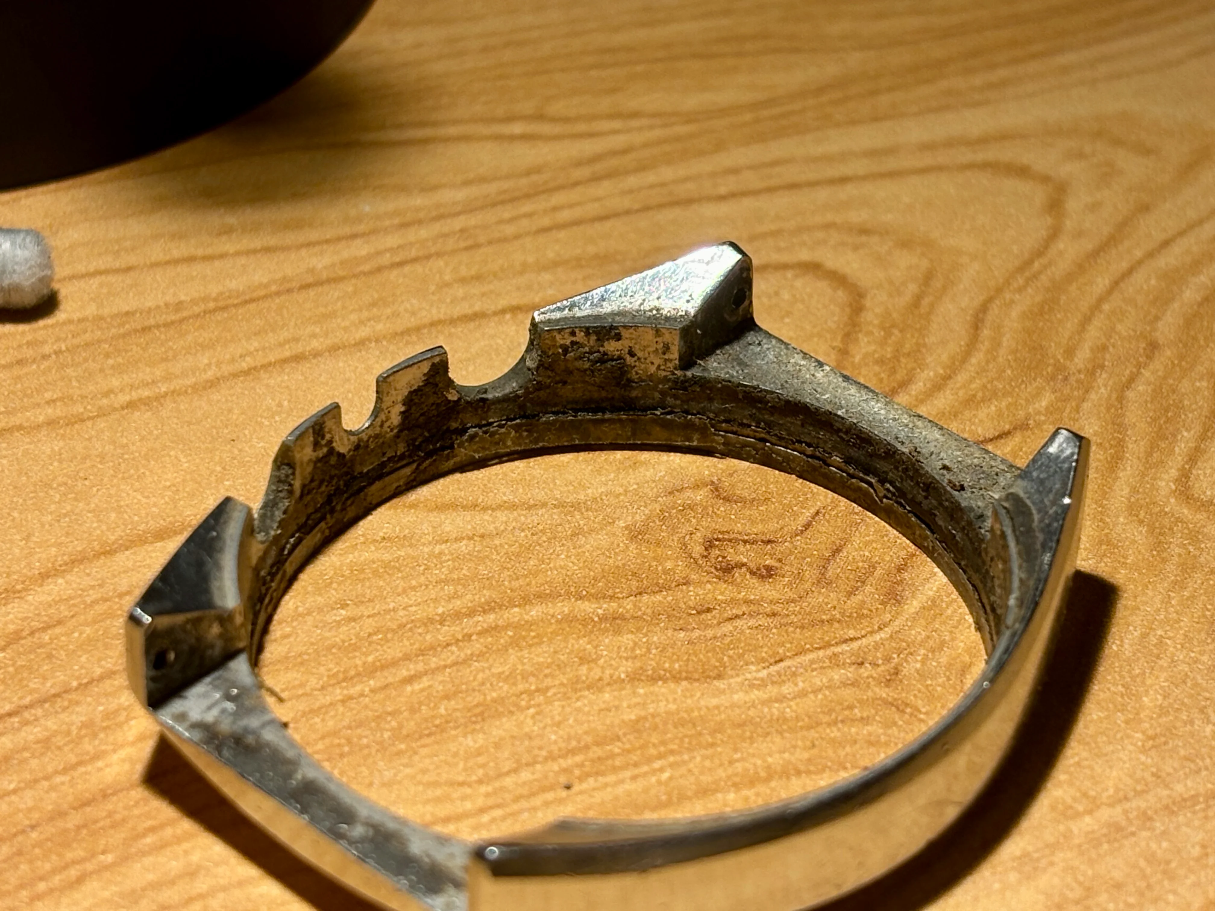

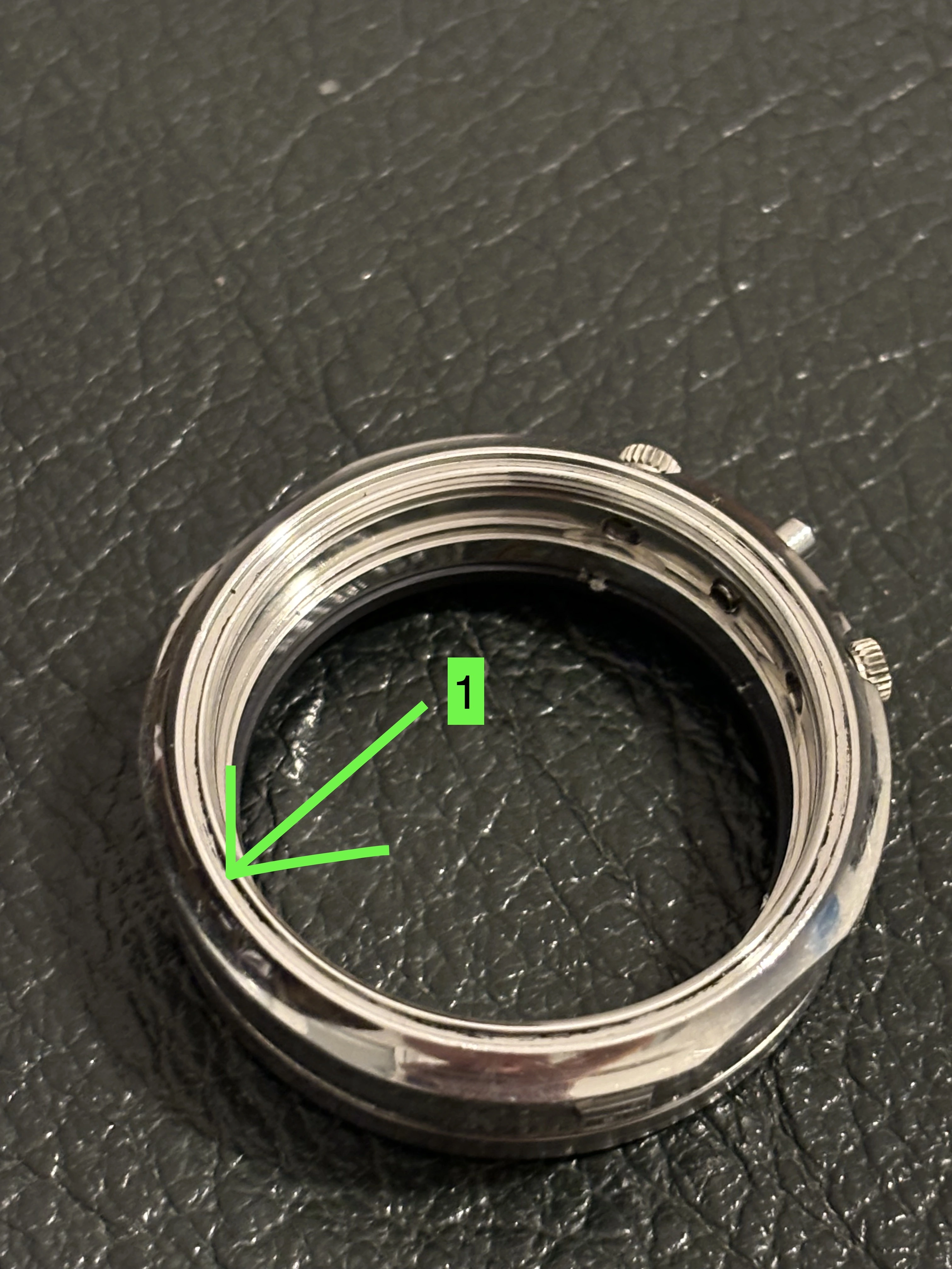

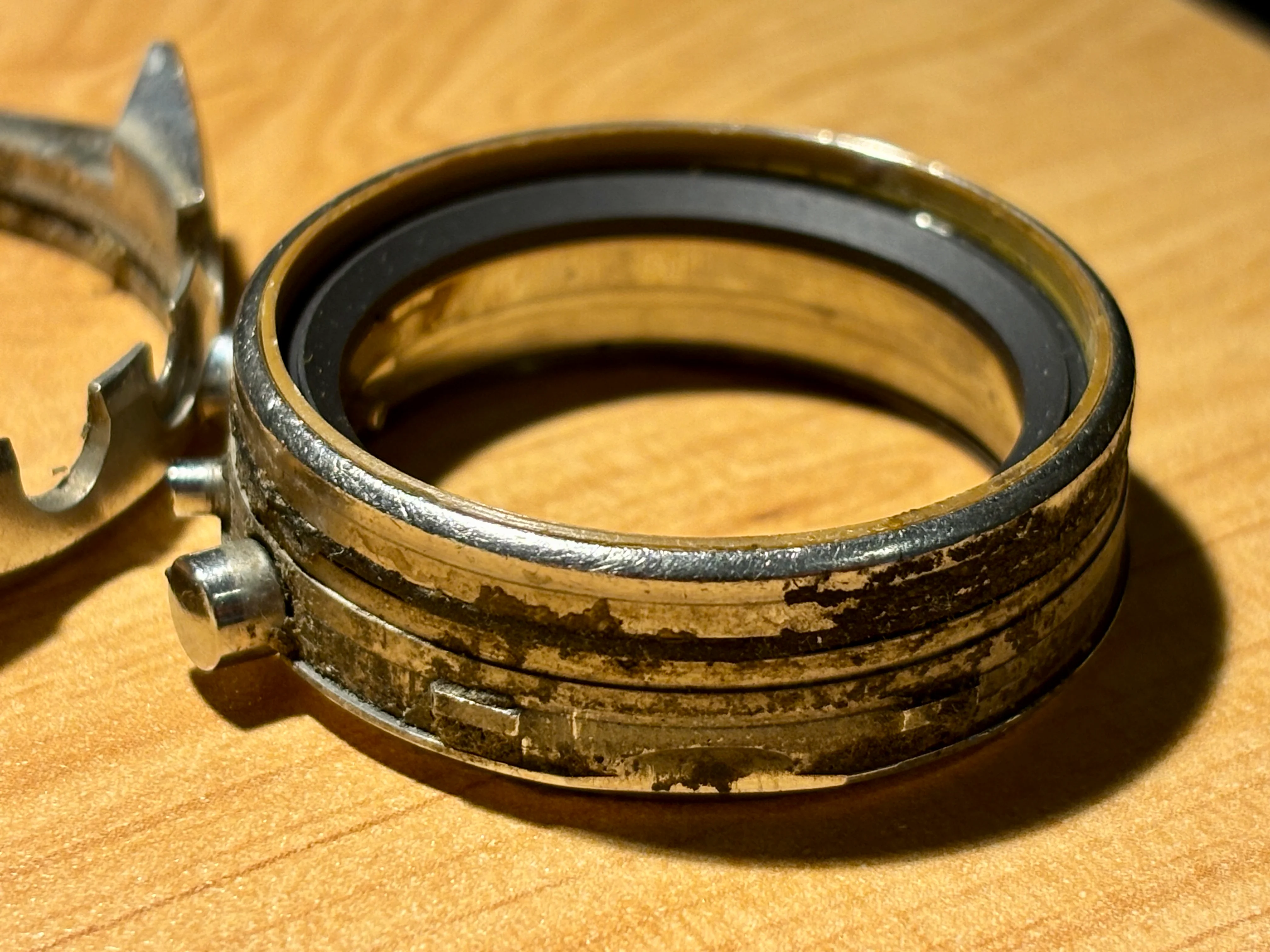

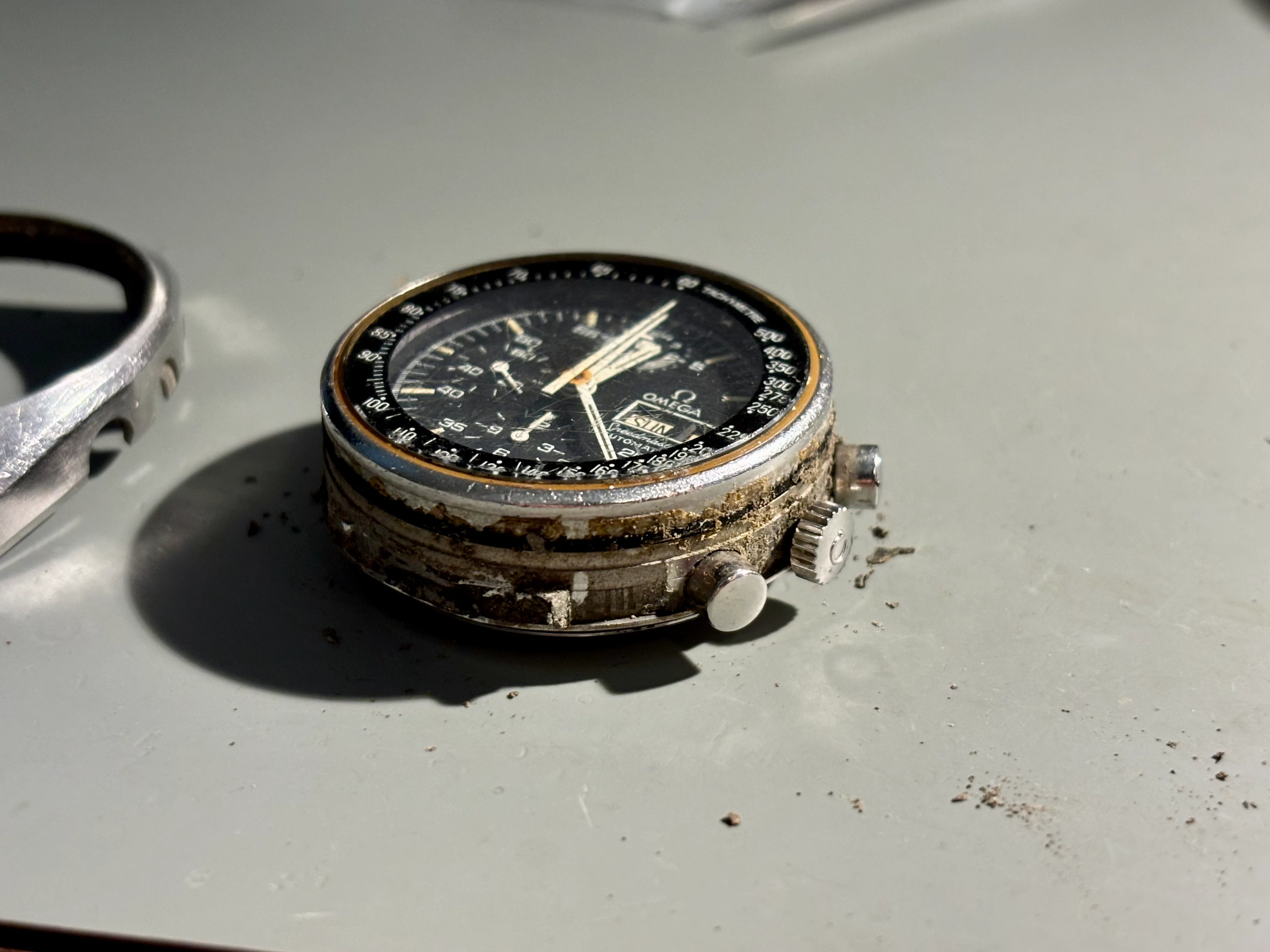

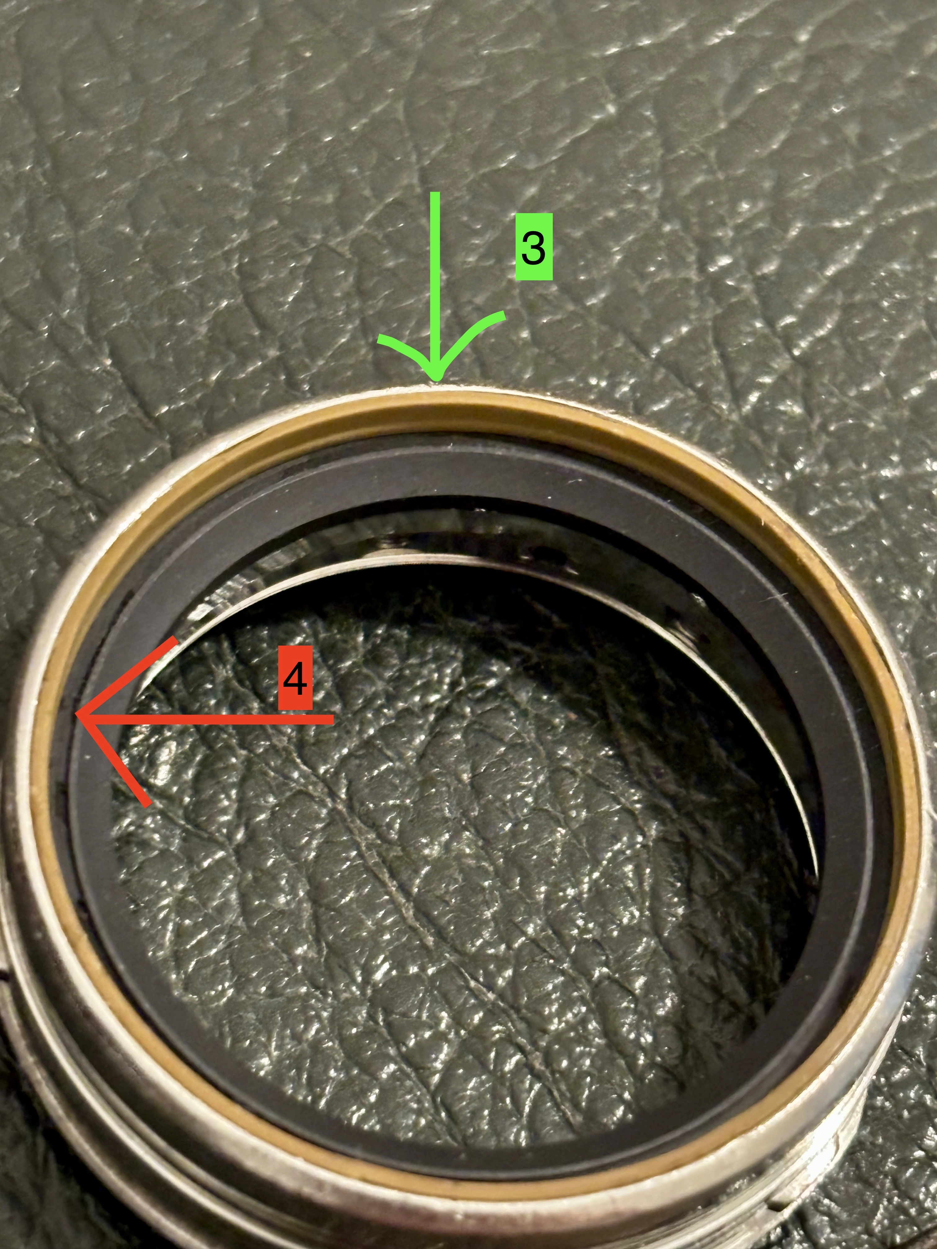

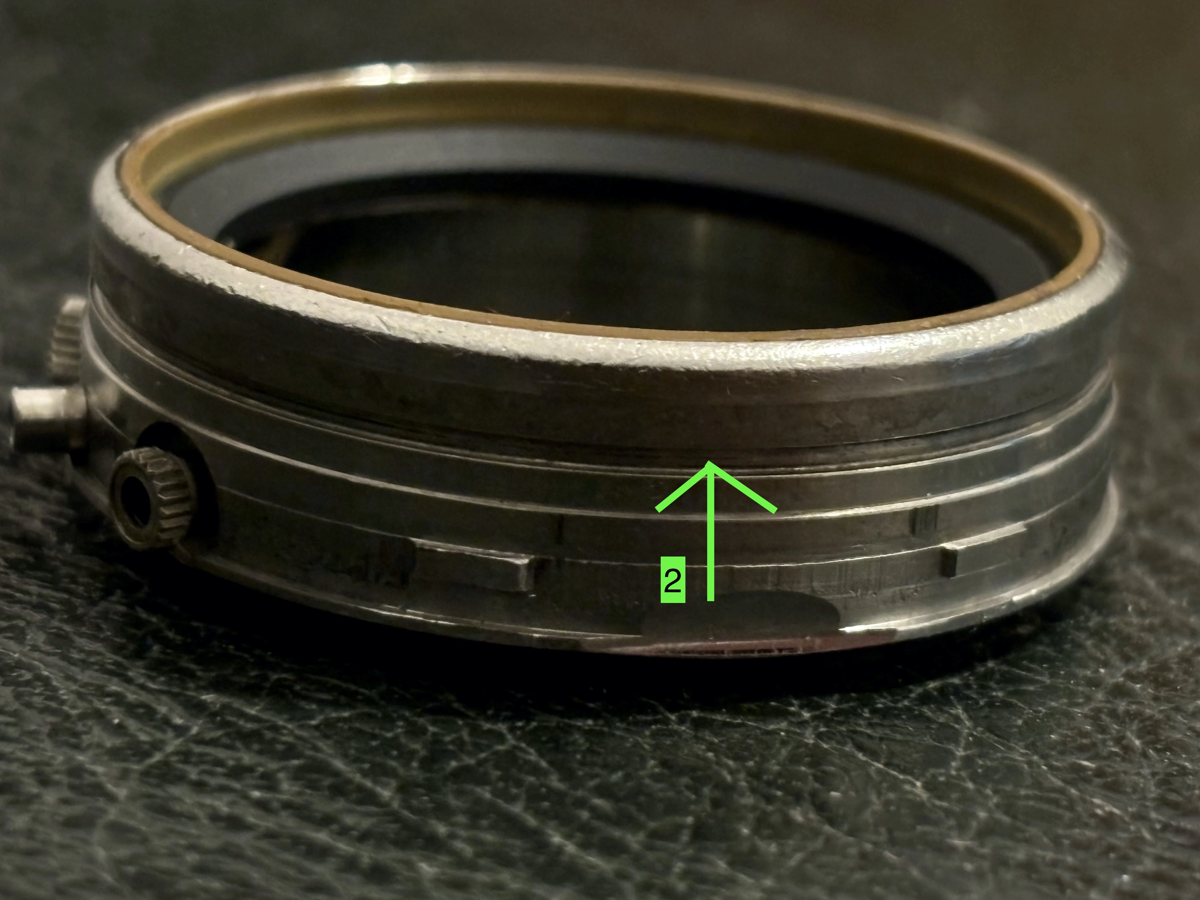

TBH I think theres might be another gasket not mentioned above , while dismantling my watch I found 4 gaskets .
1. case back gasket.
2. Middle case gasket ( i think it is used to hold the 2 case parts together )
3. L shaped crystal gasket .
4. on the black metal ring that holds the L shape in place i took out another gasket .
and when reading the old @Archer post ,on the first gasket he mentioned that on the diagram it looks like it is placed under the crystal .
and that could make sense with the fact the gasket on eBay was listed as a crystal gasket .

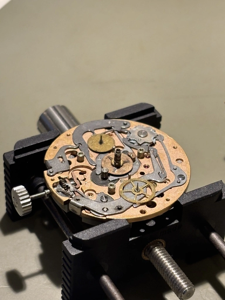

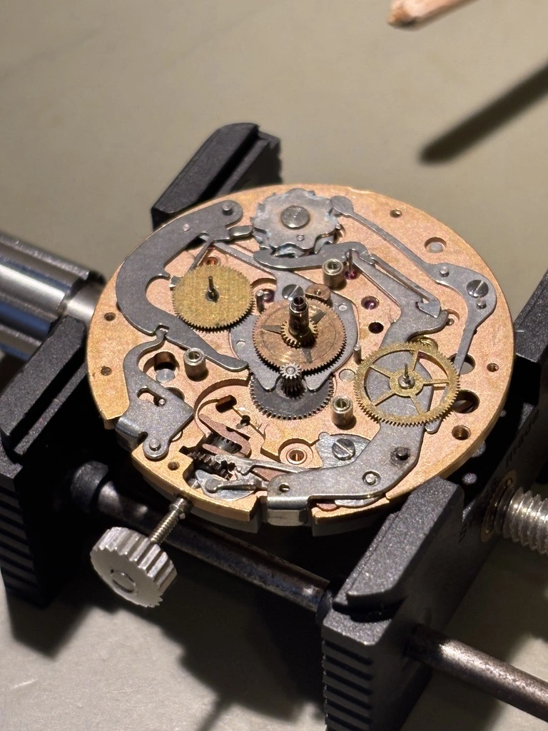

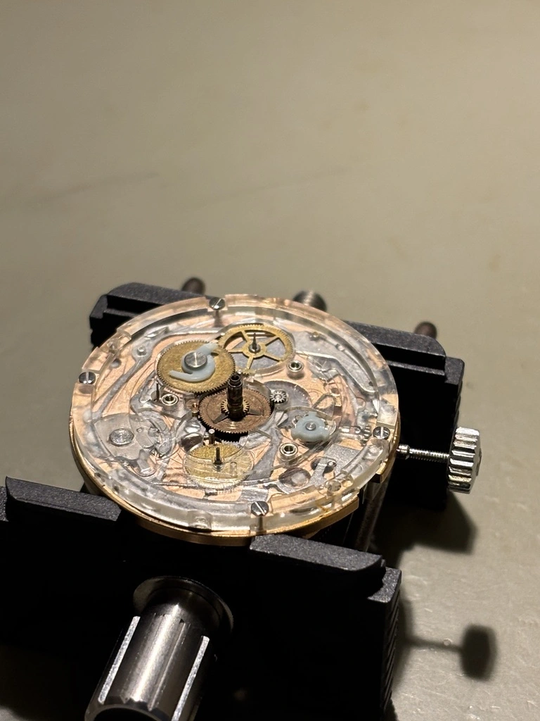

added some photos :

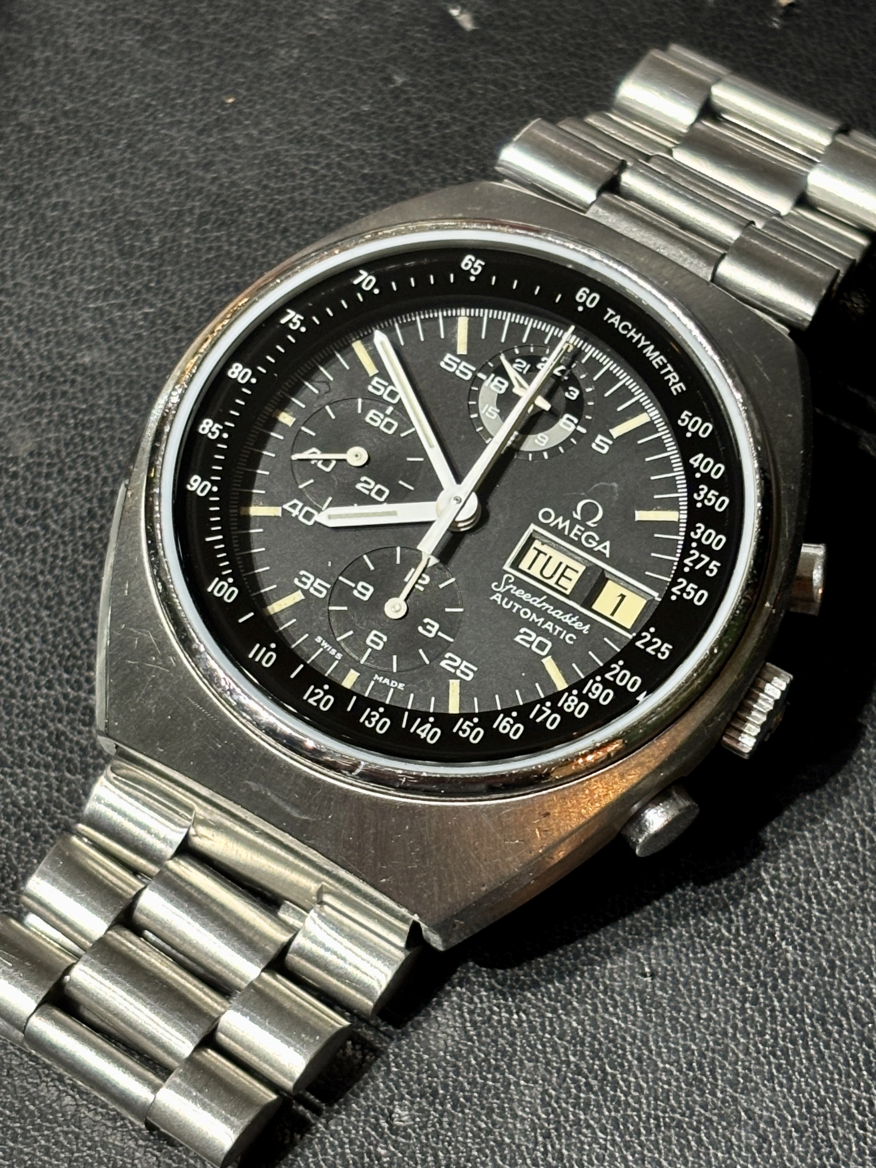

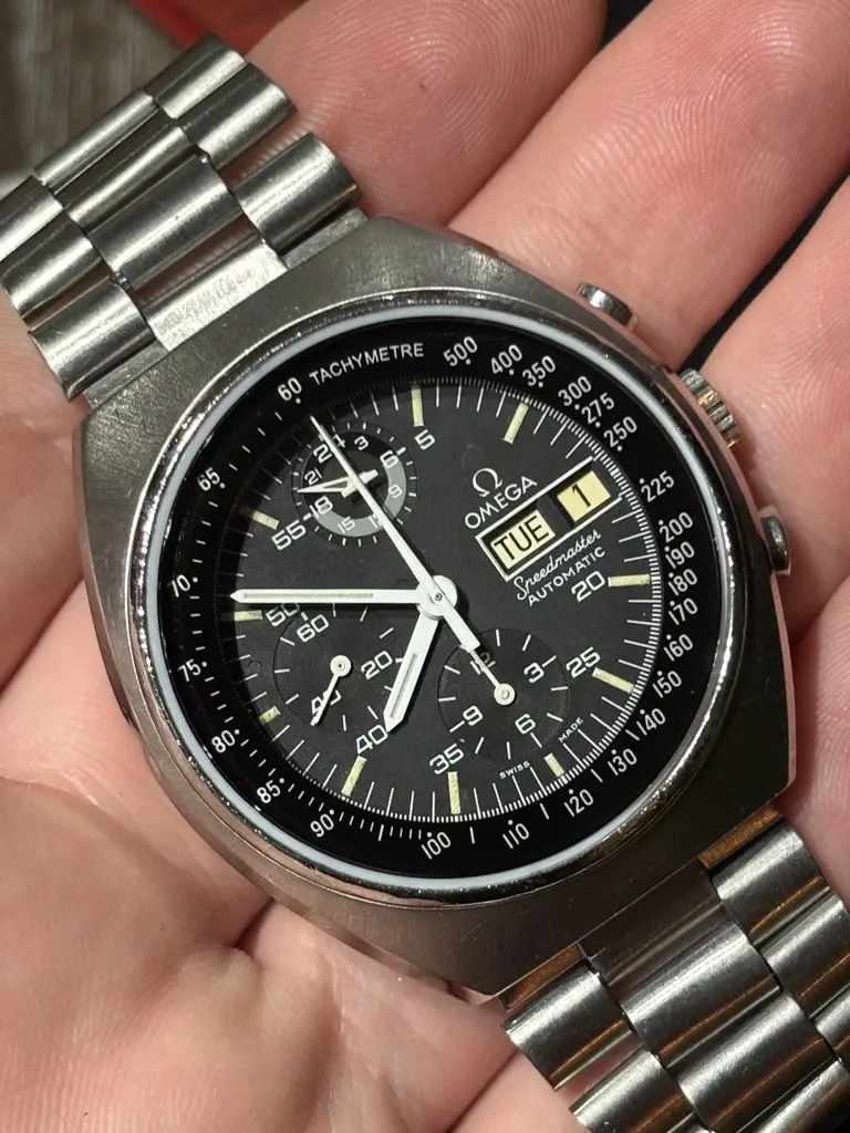

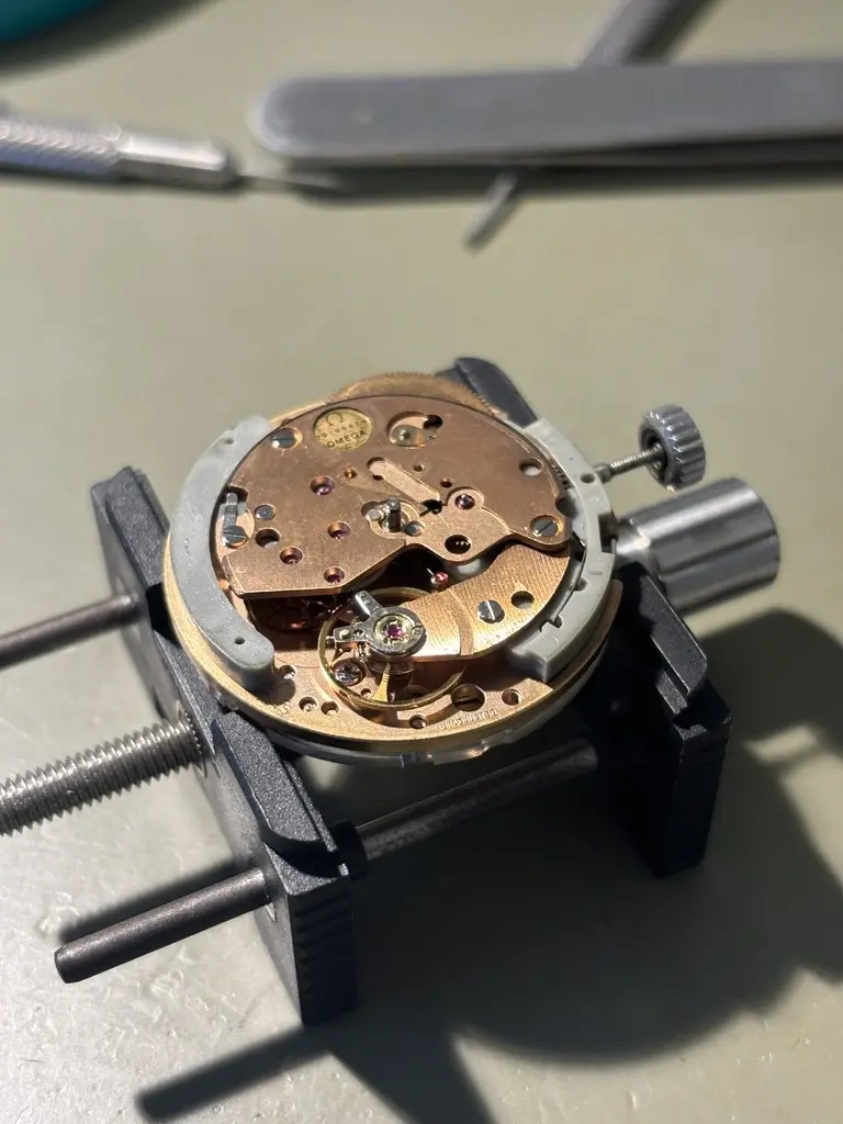

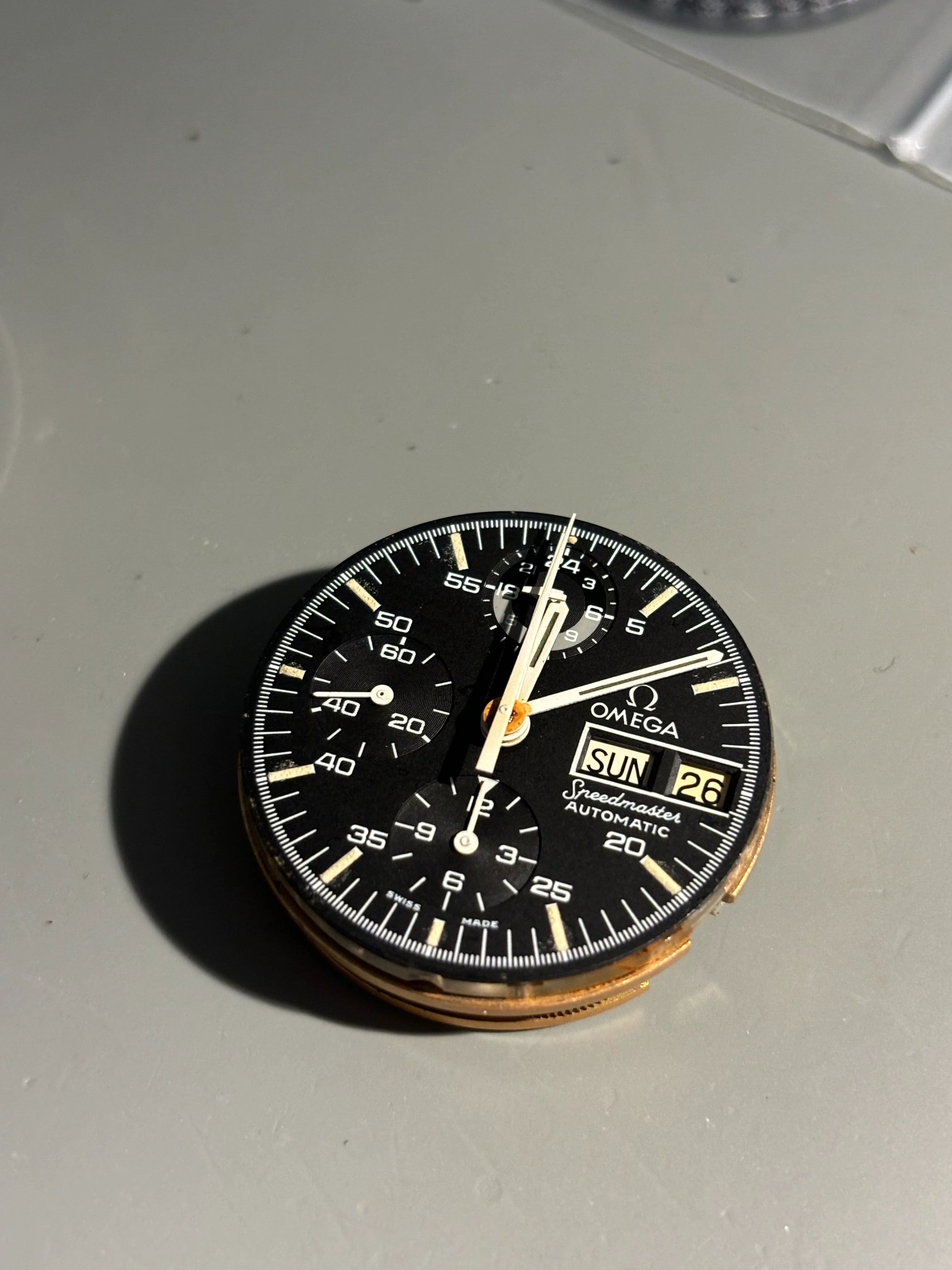

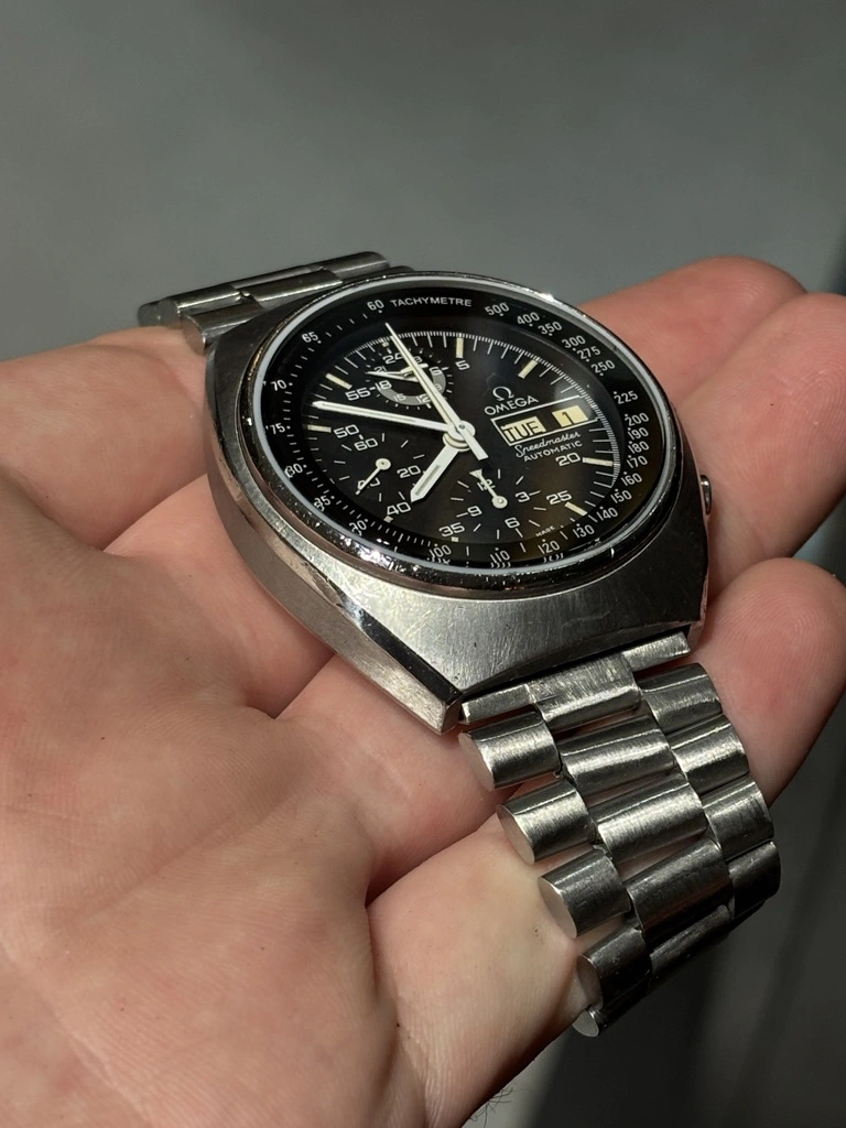

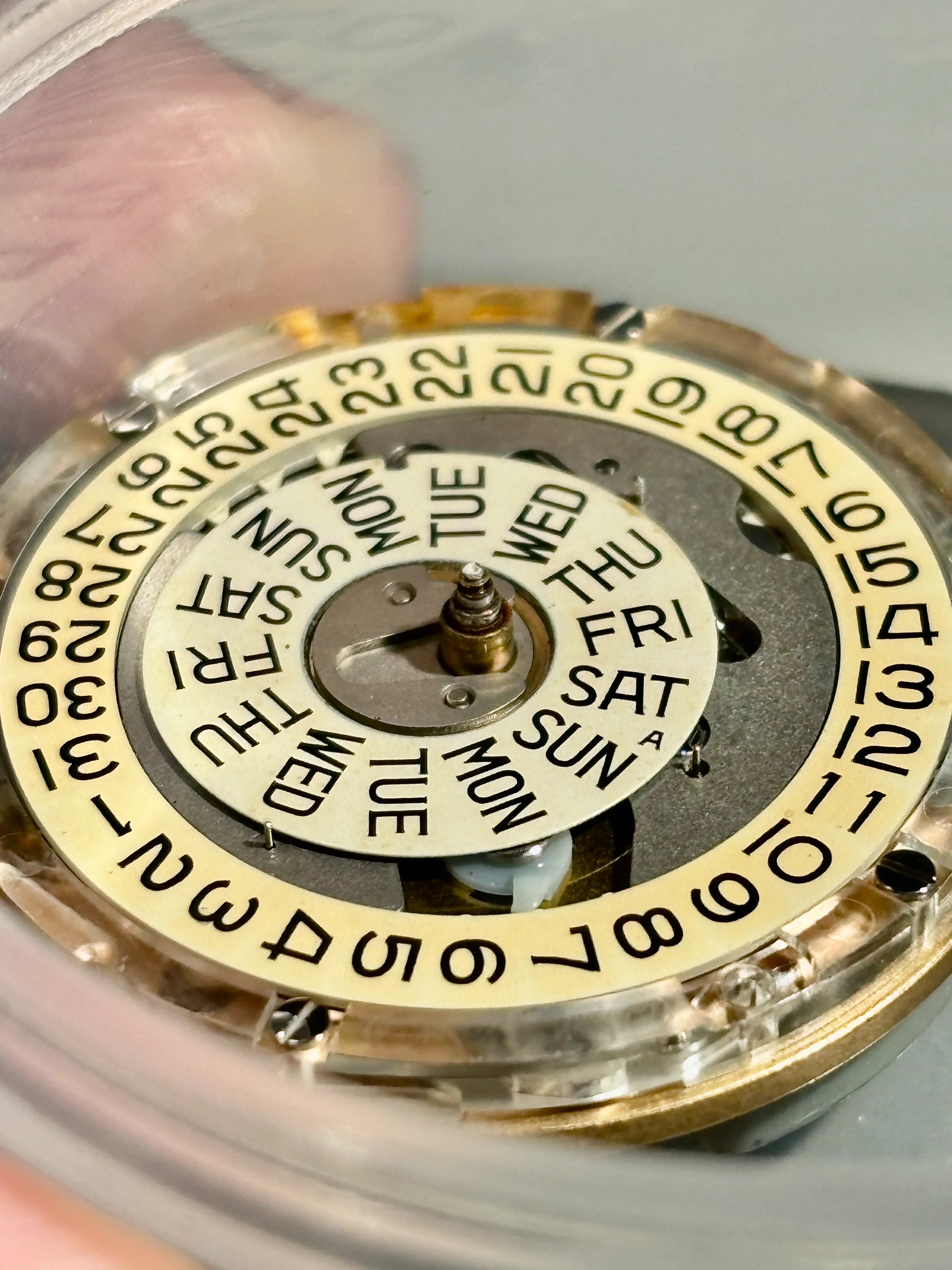

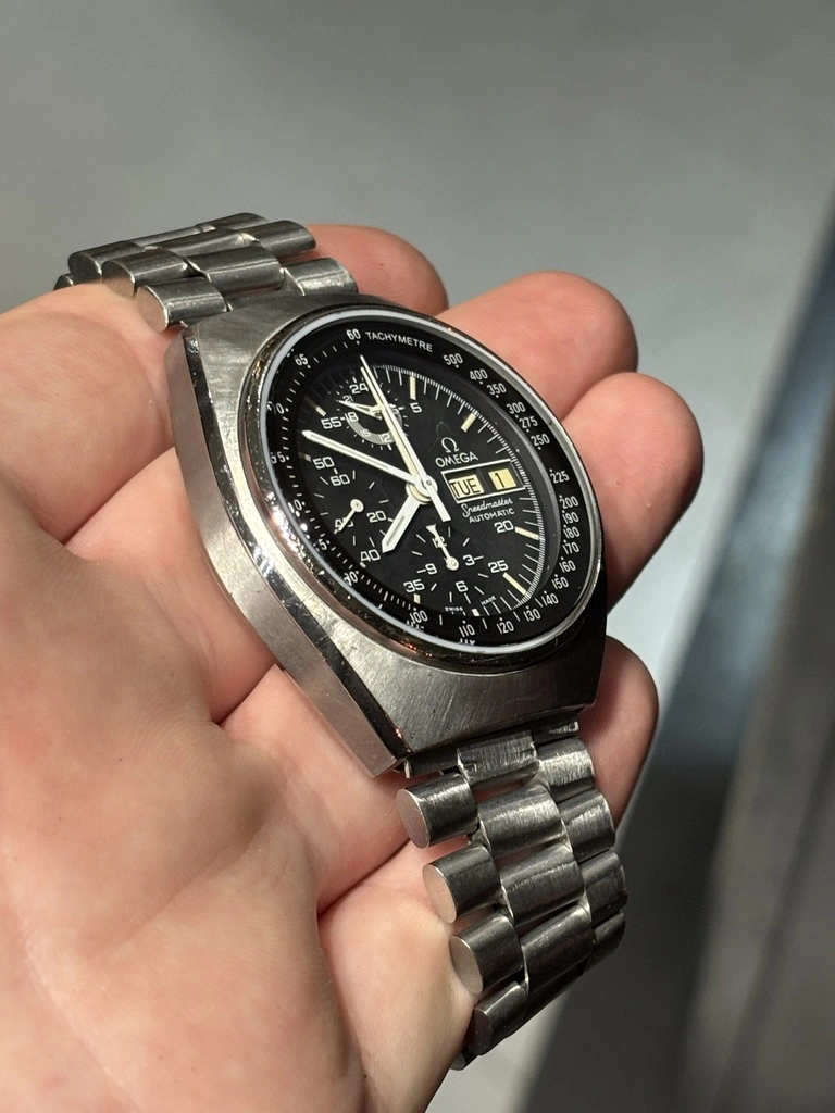

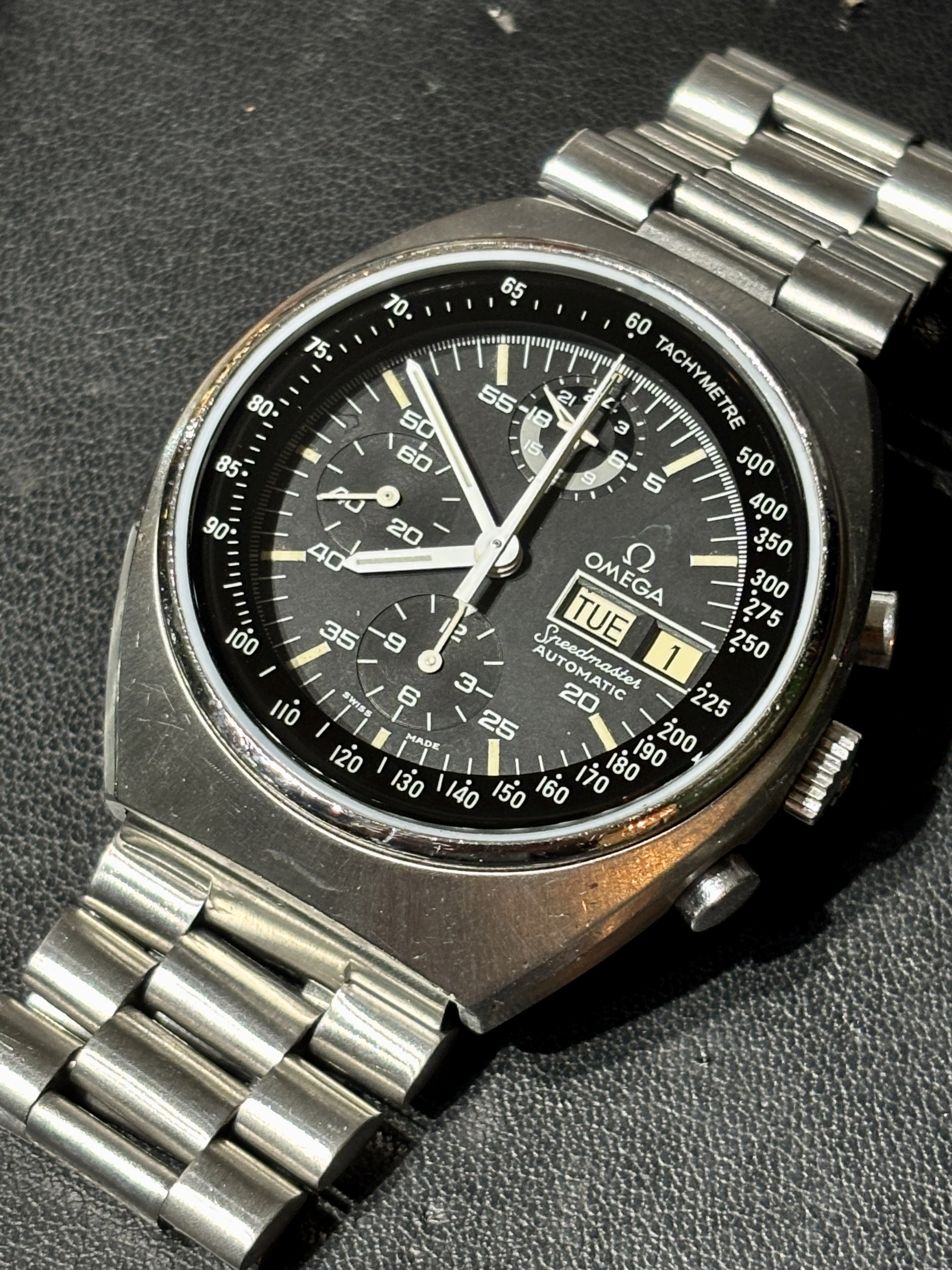

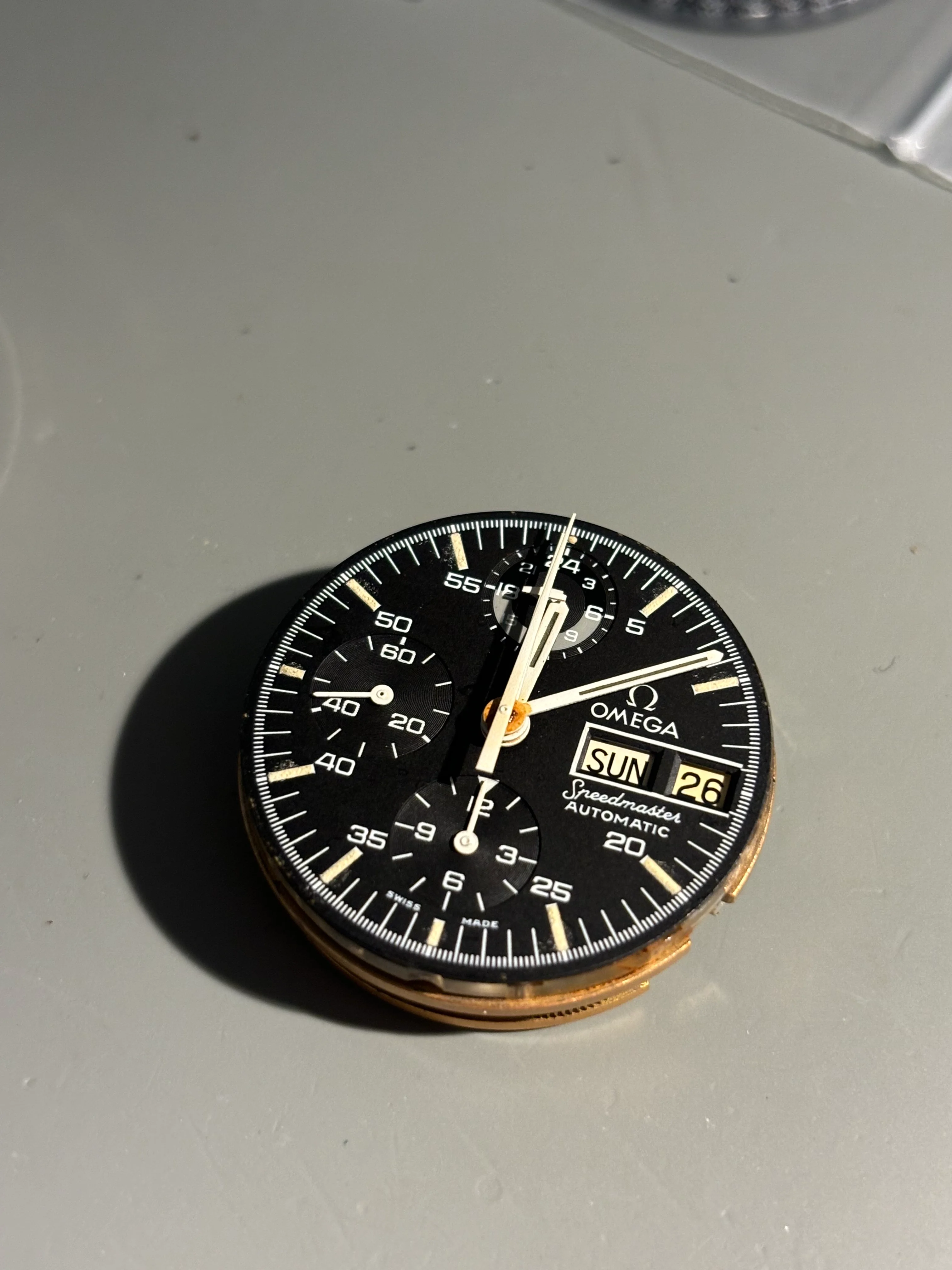

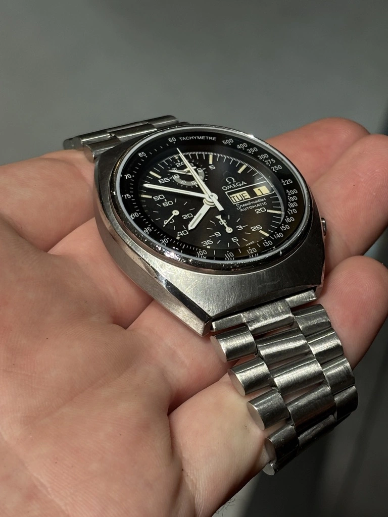

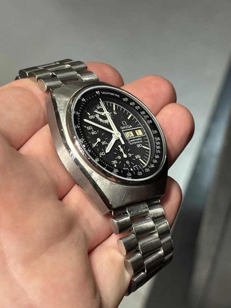

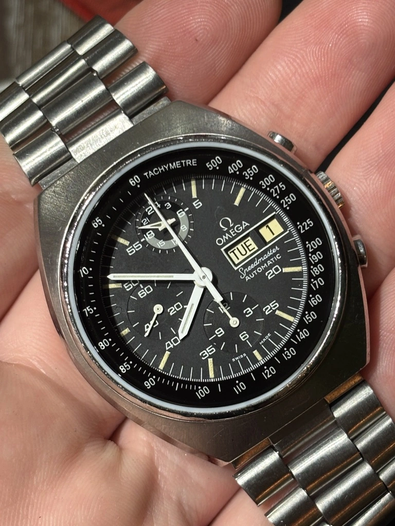

Hi guys
After a long time I finally got to finish restoring the watch and thought to share some pictures with you.
This watch was in real rough condition and required a lot of work on pretty much every part , some i was able to save and some replaced.
Usually I’m against case polishing, but the case was in real pitiful condition.
So I gave it a go and tried my best to polish it, I don’t have any good polish equipment, only sand paper and a handheld Dremel.
but I am very happy with the result, it looks much better now.
254
401
I did notice that this movement has a very inefficient automatic mechanism so the power reserve is bad. (when manually winded to max it worked for at least 2 days )
