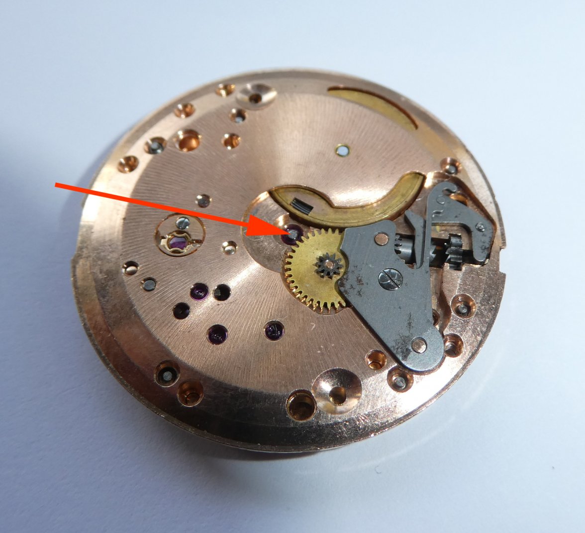

I've got a 267 movement that came in a project watch I need to have serviced/fixed and before sending it off I've been collecting parts as my regular servicer won't have an Omega parts account.
Before I can send it off there's one part I need that's clearly broken that I'm looking for help in identifying.
You should be able to see the severed end of it arrowed below, with hour wheel removed for clarity. No wonder the movement was dead. Is this the end of the cannon pinion #1224 (#1218) or something else?
Thanks in advance for any specifics!
(please try to ignore the general dirt/state of the movement otherwise!)
2,346
1,475
Its the center wheel and you can find it in 5 different movements
265, 266, 267, 268 and 269
If you need a new canon pinion. Can find one in the same movements
