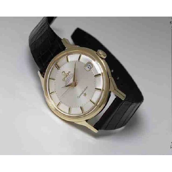

Hello I picked this one up at an auction recently to wear as a beater. I knew about the probable redial and the wrong hands and crown. I also knew it "doesn't keep accurate time". None of those issues bothered me as I always figure on a service so most of these things would be addressed then. My question here is if someone can tell me how close the minute hand is to the crystal. The watch loses hours per day but in a very inconsistent pattern and when timed against my Cal. 5100 chrono it loses about 5 sec/hr very consistently. My question here is if the tip of the minute hand extends virtually to the edge of the dial could it be binding on the slope of the crystal?

Yes it certainly could considering the correct minute hand would only extend to the inside edge of the applied hour markers.
5,631
5,815
Those are likely the wrong hands. But yes, an offhand remark by my watchmaker when he put a classic profile crystal on my KO 2627, he said the amplitude didn't change, therefore the hands weren't rubbing.
Since the hands are wildly wrong, the crystal itself might be fine and you just need the right hands.

I pulled the movement today and sure enough the minute hand was bent to the contour of the crystal/dial and was even just touching the indexes. the hour and minute hands seem loose on the "shaft", not enough to spin when shaken but do move at the slightest touch. Is it likely there is damage to the movement or are the hands made of soft enough metal that they would have worn instead of the shaft?

On the bright side those hands look like Globemaster hands, a model inspired by this model, dial looks like a redial as the 8'o clock print is way off
On eBay you sometimes can see dial/hands combinations for sale, I think you could use such a set
They are usually around $200 but always with an extreme patina
