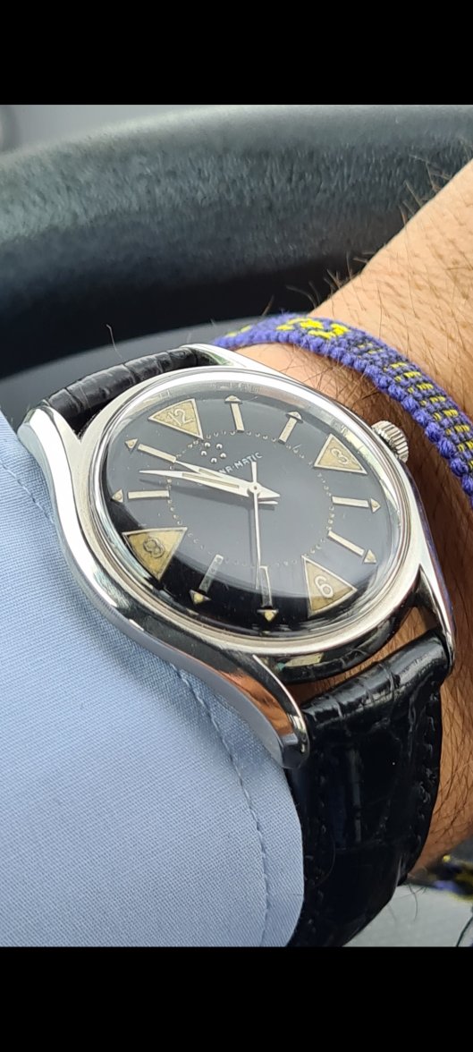

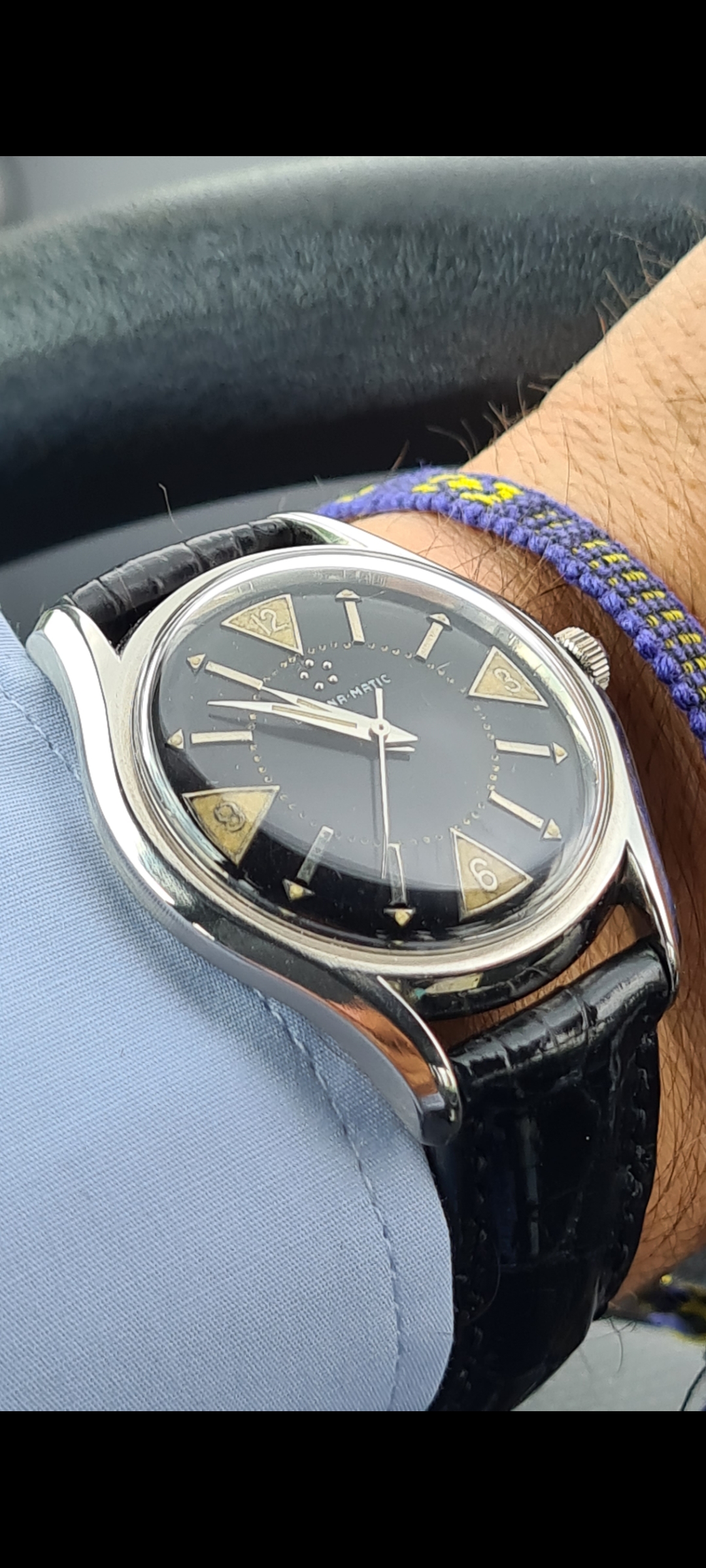

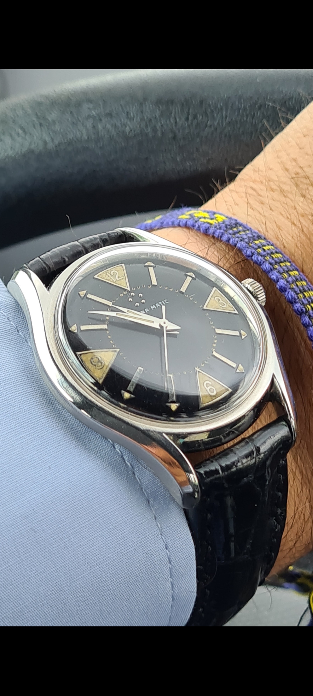

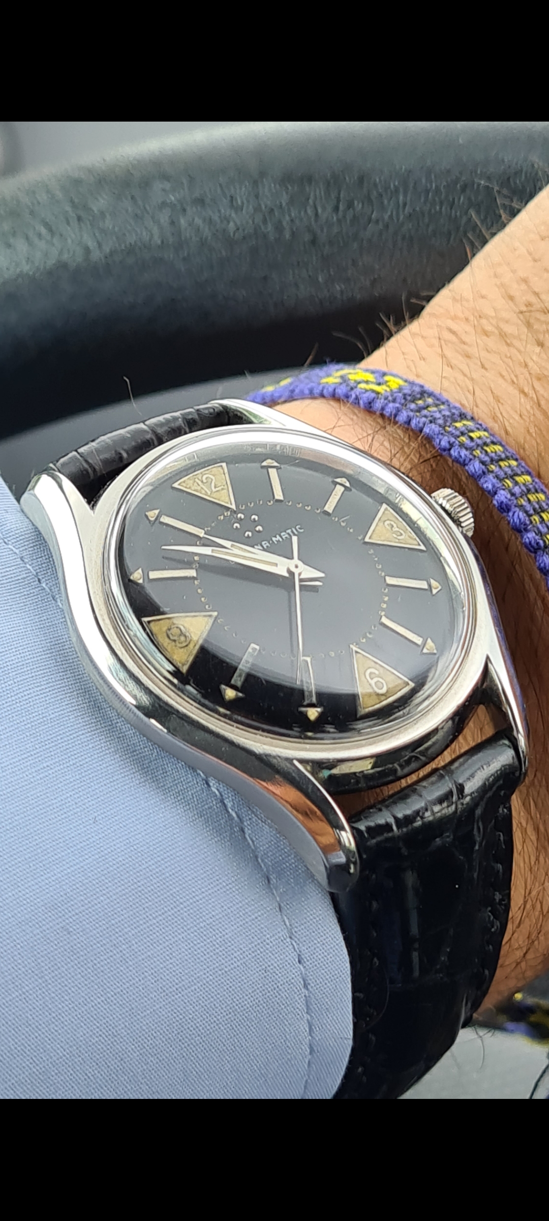

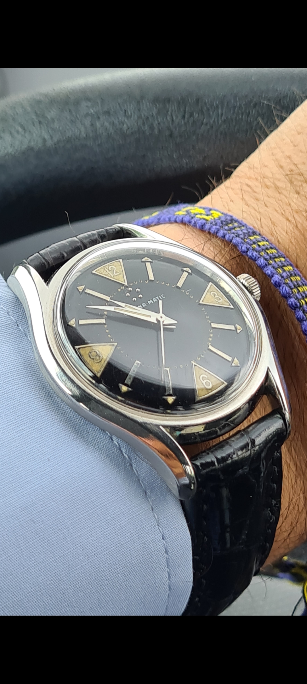

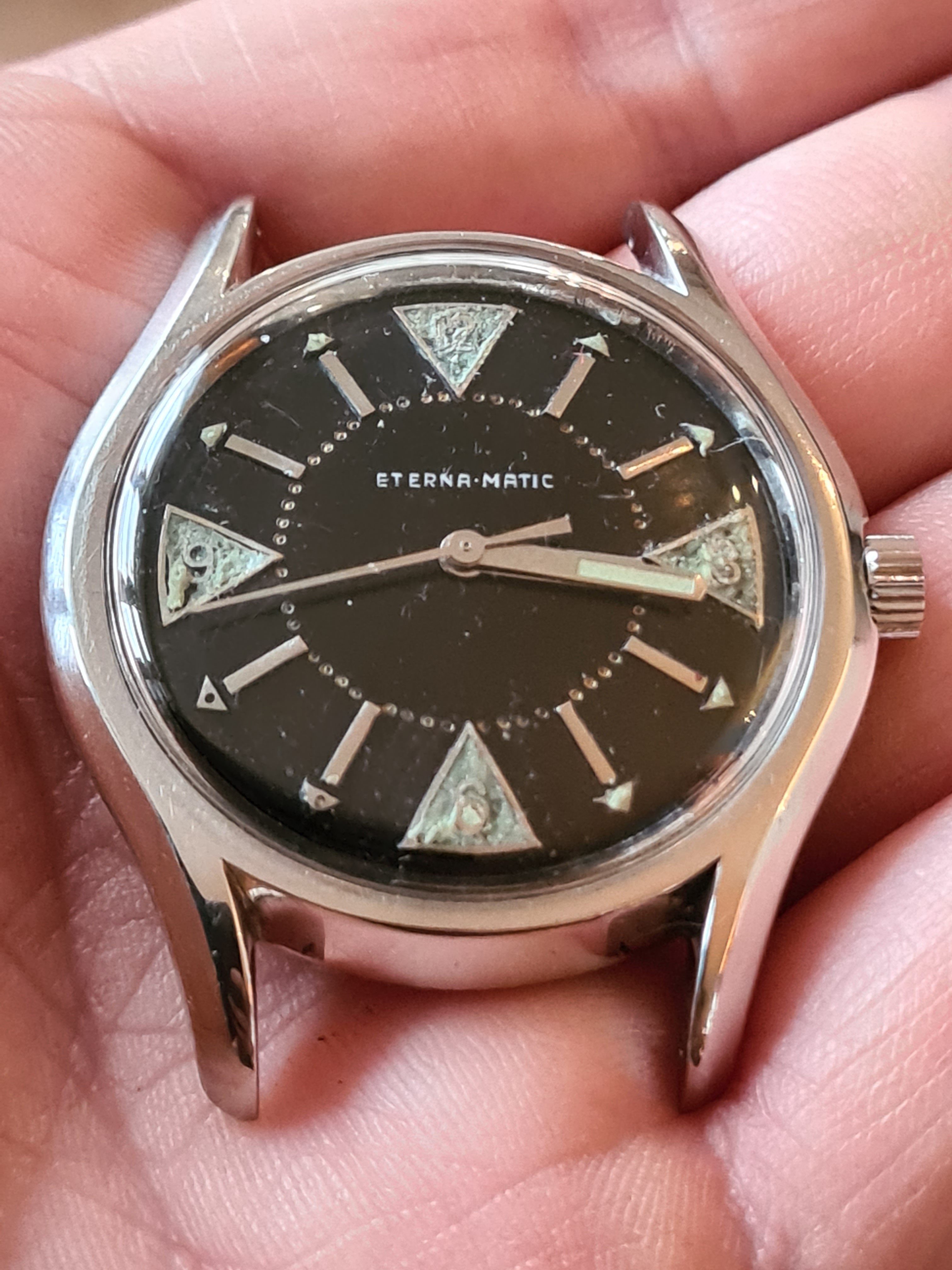

To give a summary. We've replaced the hands and crown. We used donor dials for the metal balls. The dial and hands were relumed and the movement got a service.

I think it’s a very sympathetic conservation/restoration and I hope you love it on the wrist!
5,026
18,608
Thnx!

You are a proper mad fanatic to do this, but hat’s off to you!

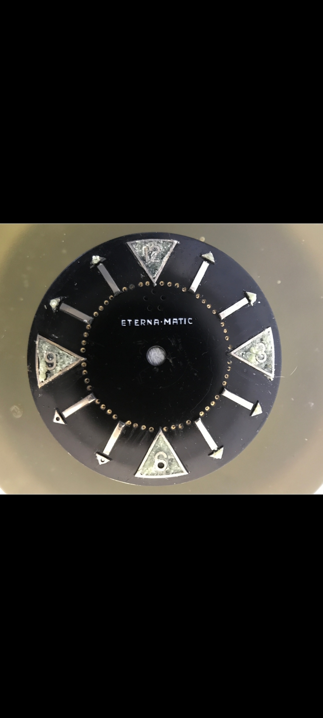

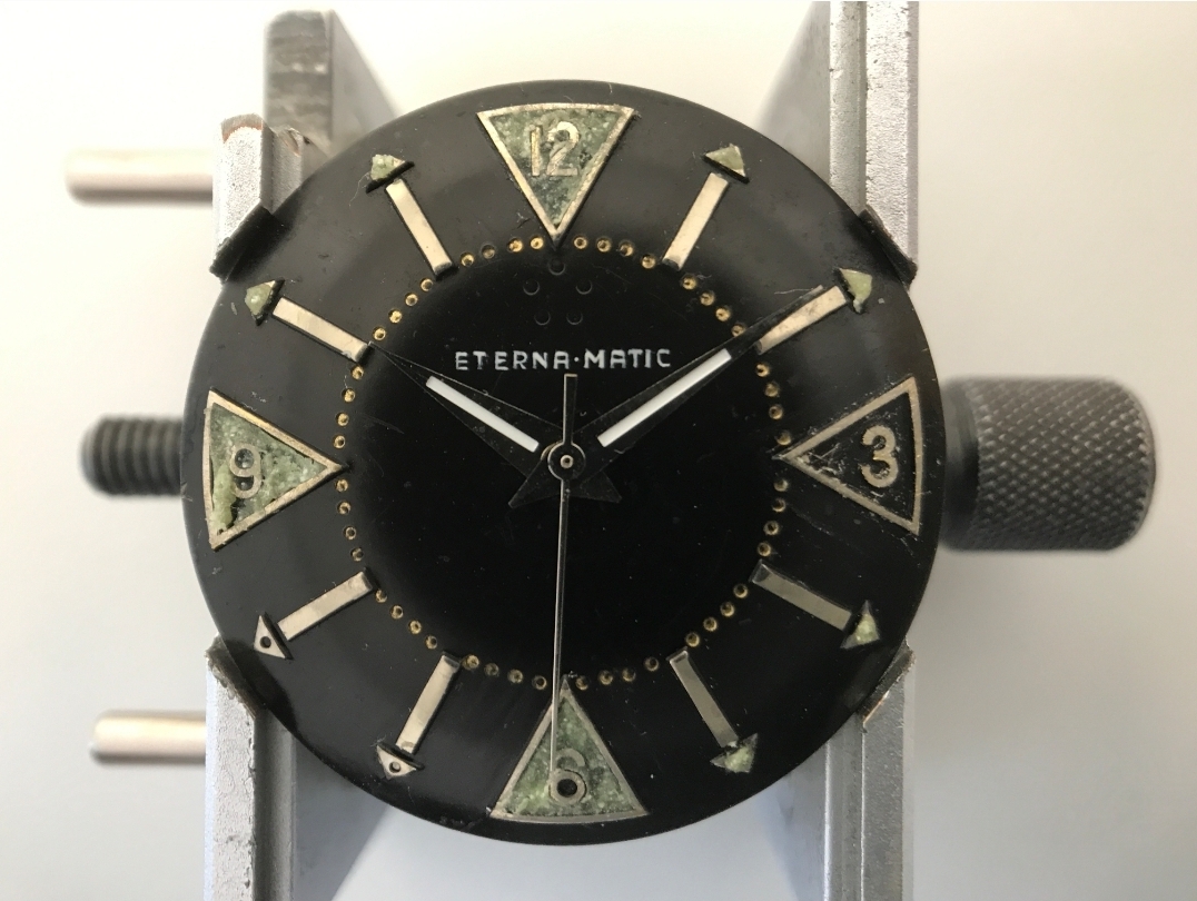

Sorry to be critical and I am sure I will be corrected but the font for the E s of Eterna might not be the standard for 1958 is it?. Although it matches the replacement other dials I am afraid it maybe should be the more rounded style. I think 1958 may be a crossover year for the fonts so maybe ok.
5,026
18,608

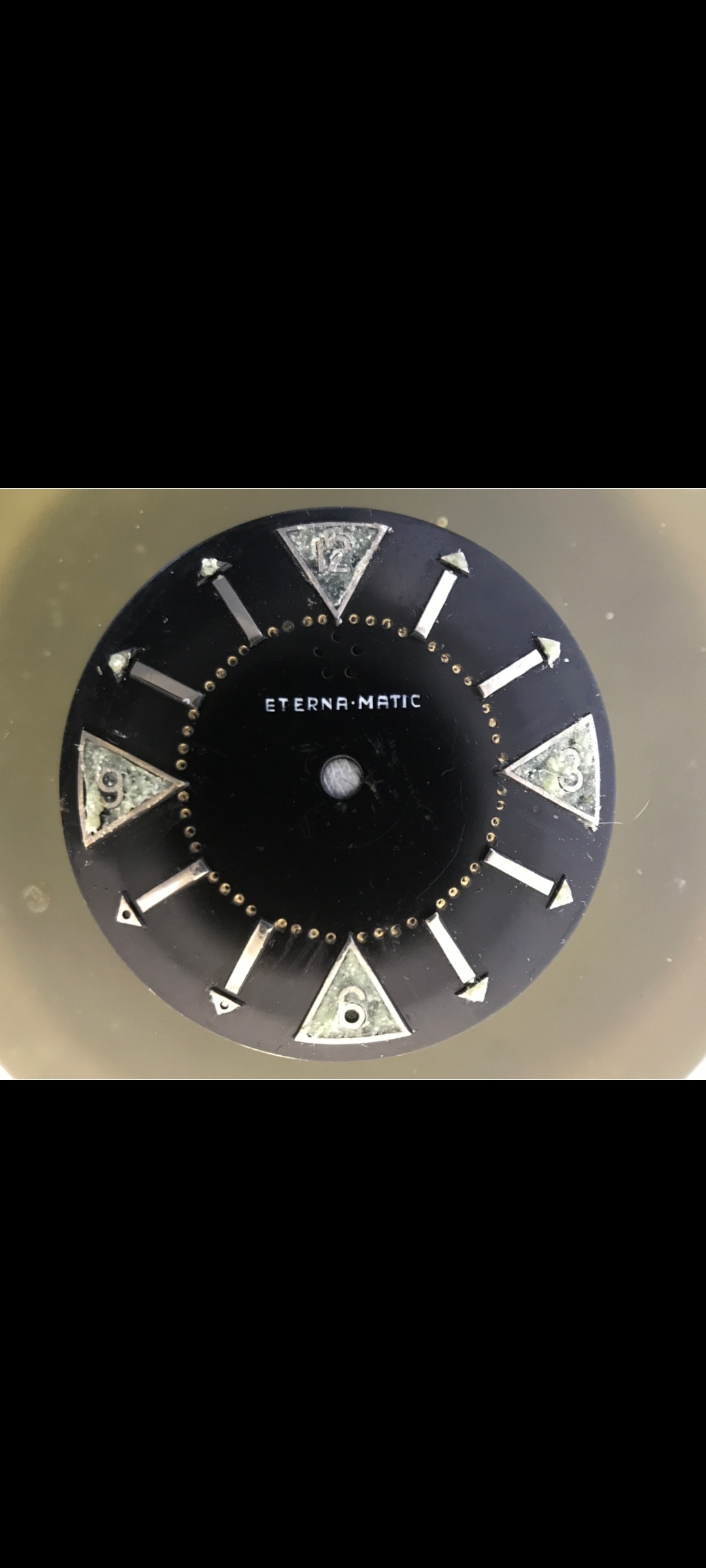

I assume it's a older redial. So it's not surprising the font raises questions. We left it because there were no proper clichés.

Thr watch looks great, looking forward to the wrist shot
5,026
18,608
Well guys. Before I get to the wrist shot I think it's important to give a summary of the whole project. For people like me, who did'nt had any experience with these kind of projects, it was very interesting. I think this thread could help other collectors to determine if they will do a restoration or not. I will give also a summary of the total costs. Just to give people a idea what they can expect. I had no idea.

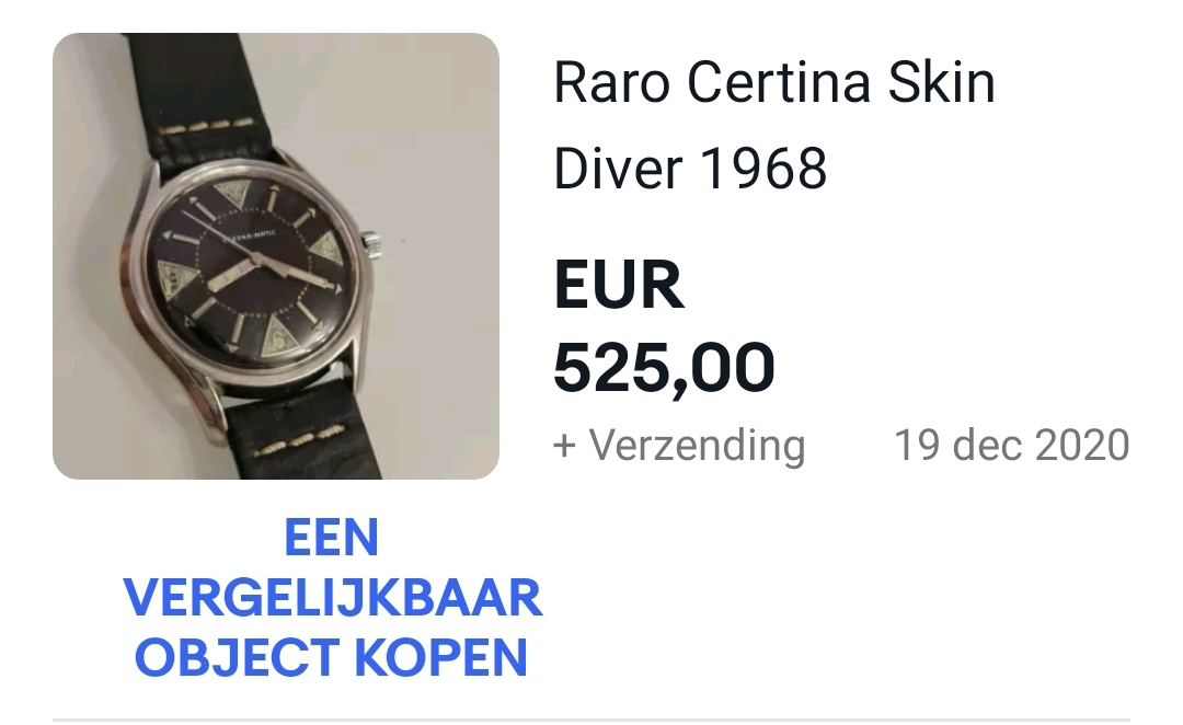

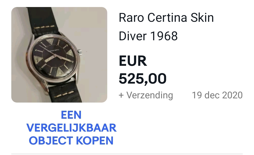

It all started when Troels (@ConElPueblo) pointed me (in December 2020) at a certina diver, which was in fact the very first kontiki ever made (1958).

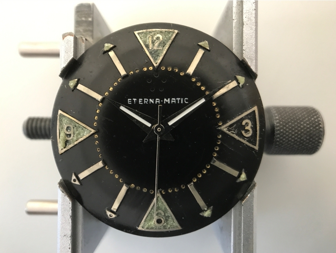

Powered by the Eterna-Matic caliber 1414UD, the first KonTiki from Eterna featured a deep gloss black dial with large radium lume triangles at 12,3,6, and 9 containing hour numerals inside the plot— this feature has come to be a calling card of sorts in the product line. The KonTiki was housed in a 36.5mm stainless-steel waterproof case.They are very rare and not a lot survived.

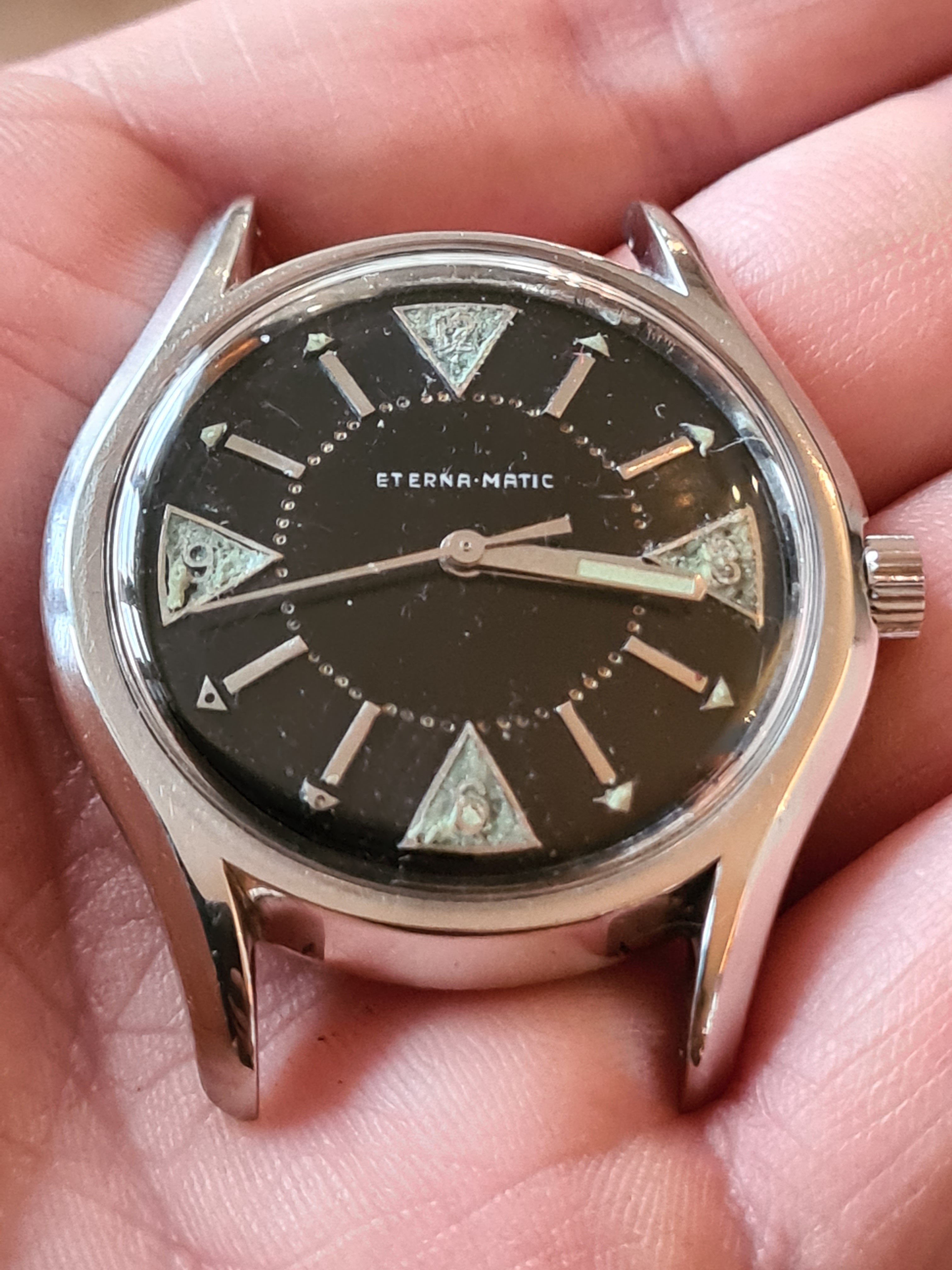

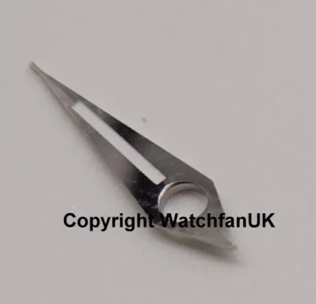

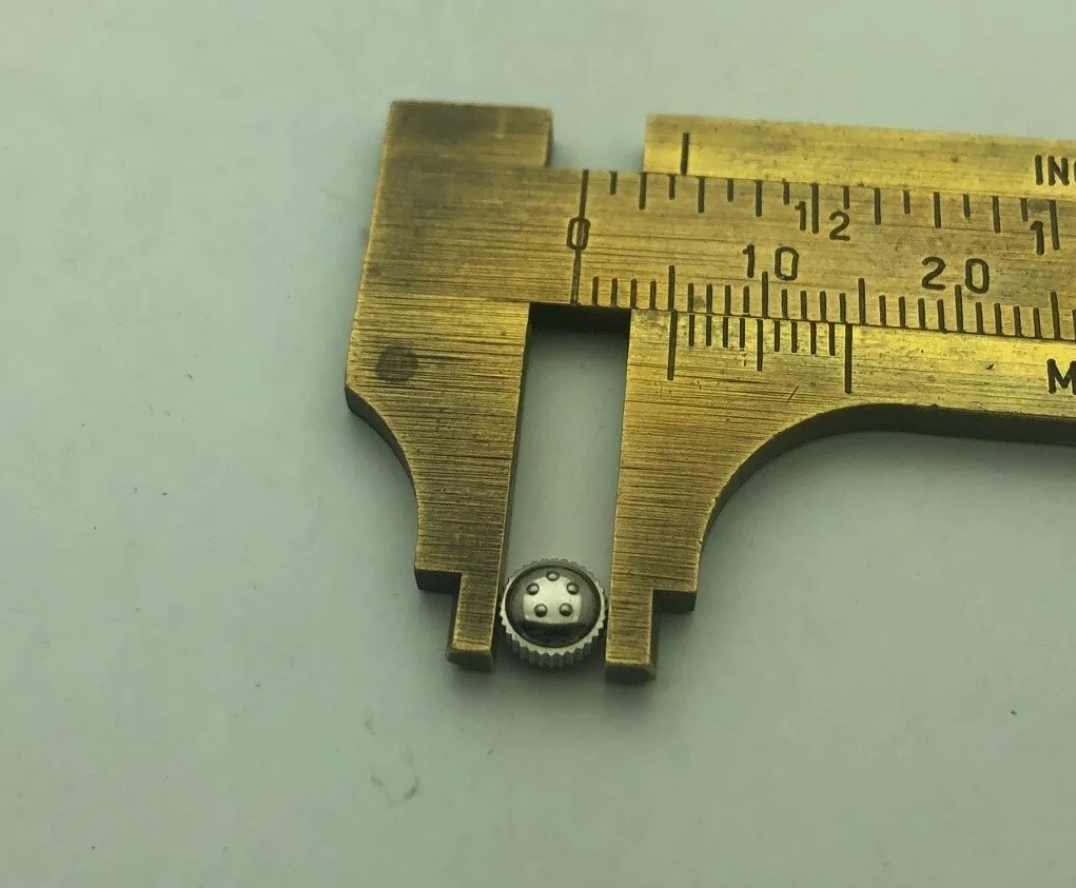

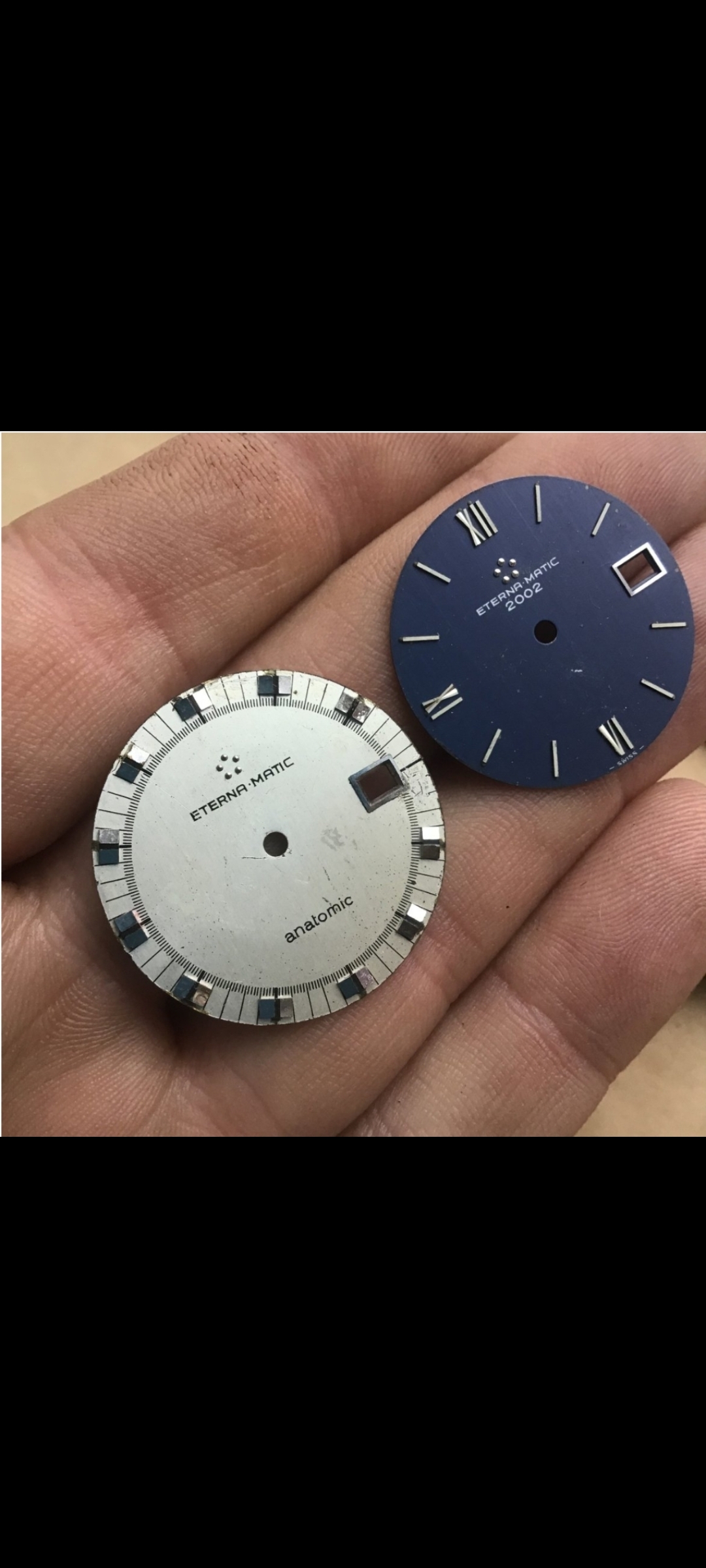

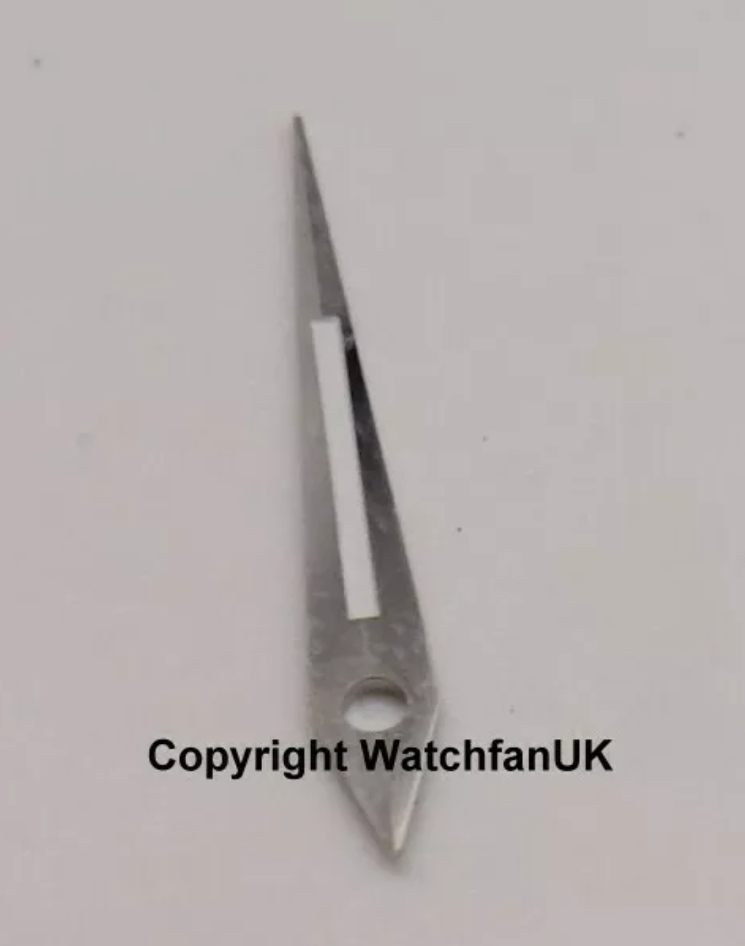

However, this kontiki had a lot of issues. The hands and crown were all wrong, the radium was shot to death, the dial was probably refinished and the metal balls were'nt there.

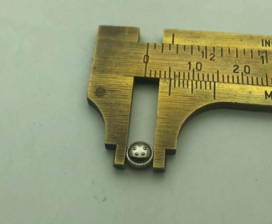

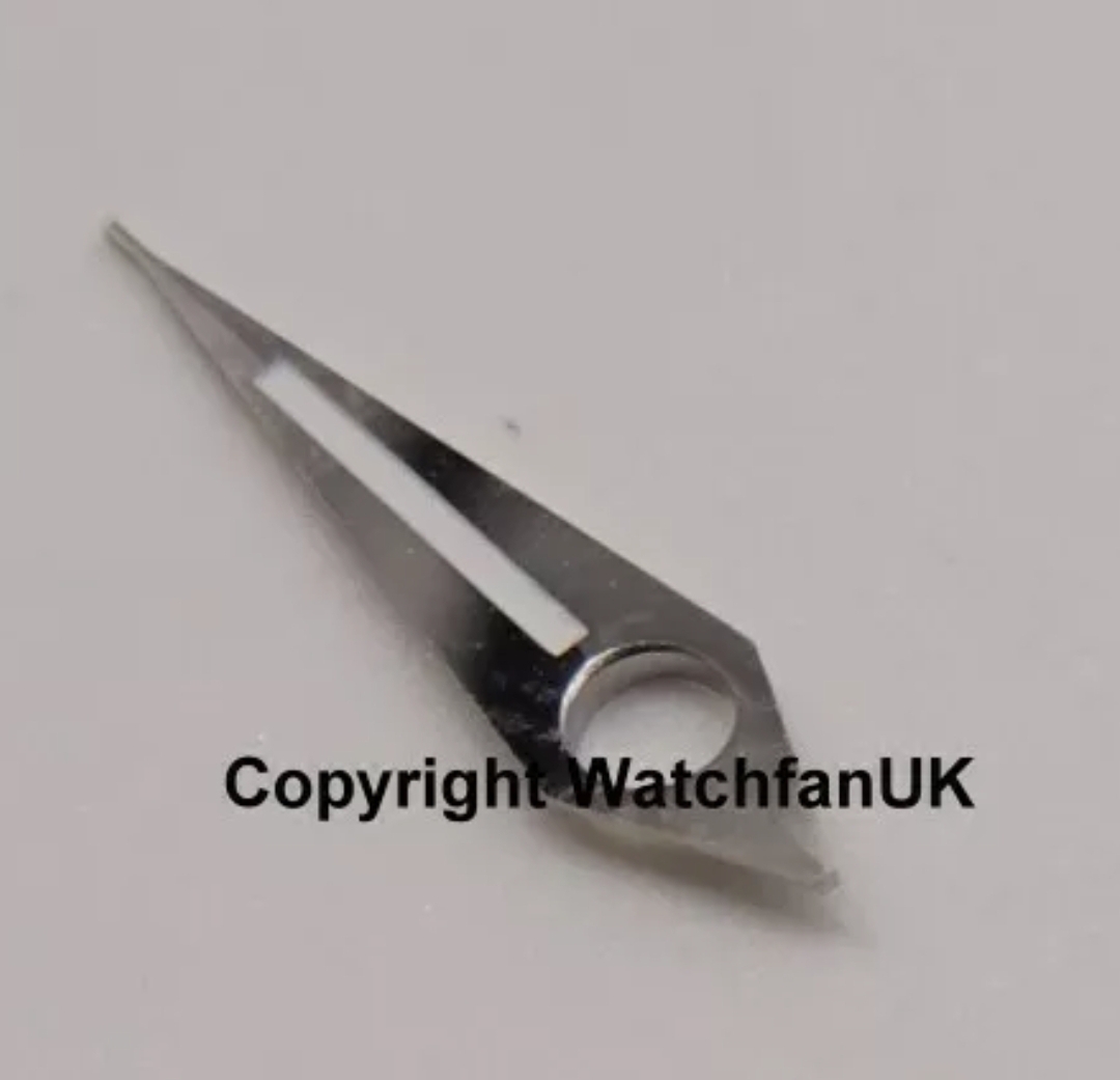

So this thread was started in February 2021 because it was time to save this poor old thing. It took me a couole of months to find a crown, hands (original ones were unobtainable) and donor dials (thnx to @Radiumpassion). And off it went to the watchmaker. He installed the crown, hands and metal balls, he applied new lume and he gave the watch a service.
Costs:
1. Watch EUR 525
2. Hands EUR 25
3. Crown EUR 55
4. Donor dials EUR 40
5. Lume and metal ball job EUR 120
6. Service EUR 245
Total EUR 1.010
So for the average collector who is unexperienced with resorations, I hope I have contributed a bit with some knowledge.
If you can save a old watch, it's worth doing so. I really feel a bit better about myself... 😁 And this kontiki will live for 50 years more. At least...
What is the Certina connection? I wasn't aware of that.
5,026
18,608
There's none. The seller made a mistake. 😁
