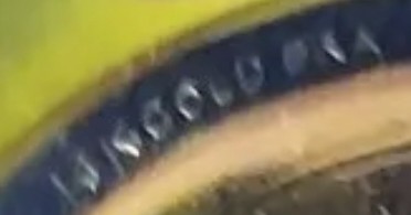

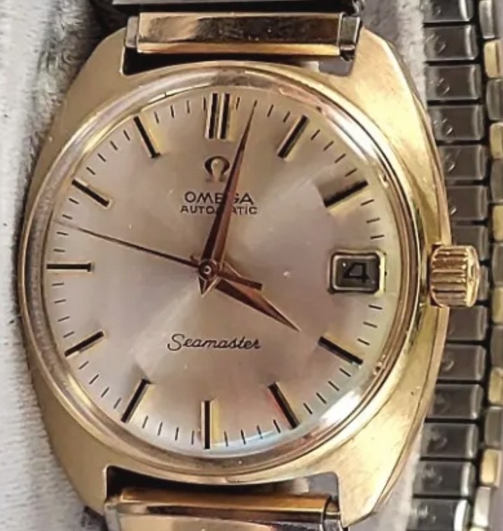

I was considering sharing this eBay listing in the "Recommended" thread, but I can't figure out what the reference is. A Google image search didn't bring up any good match. I also wonder what the three letters are that follow "14k gold" on the case back. It's a presentation watch, so the case back is flat and engraved. Can anyone help with either of these? Thanks!

I thought it may have been a Seamaster Cosmic (166.023) but the shape between the lugs is wrong.
It looks like a C case from a Connie with a Seamaster dial. I would have expected baton hands as well.
The crown notch in the case is also unusual.
Do you still have a link to the watch?
Perhaps filled or something like that. Which means it is a steel case with gold cover.

Here it is. Unfortunately the photos aren't great but maybe there is a clue. https://www.ebay.com/itm/3741378300...CsRVpgvTba&var=&widget_ver=artemis&media=COPY
I was thinking the same thing about it looking like a Constellation.

Looks to be a US case made by DiVincenzo & Arienti who were based in Brooklyn, NY. Thus "14K GOLD D&A"
The case would have been made for Norman Morris Corp, the US Omega agency at the time.
Maybe one of our US based Omega gurus can offer further info.
I suspect the case is 14 carat solid gold as there is no "GF" marking.

Ahh, interesting! Thanks for the information. If so, someone may get a good deal on it since it's advertised as gold plated.

Thats not like any c-case ive ever seen, bezel is nothing like i've ever encountered on a constellation c-case anyway.
Shape makes me want to say cosmic, but the screw back says no...
