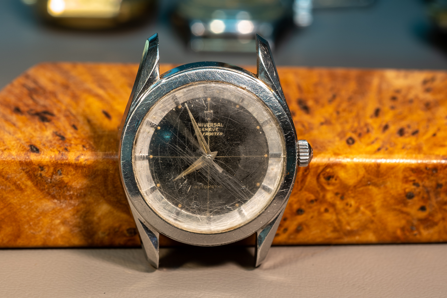

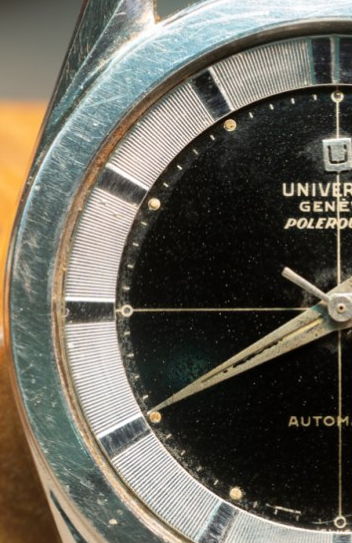

Anybody here tried to replace a glass by pushing it in from the front?And is it possible to replace the missing lume dots?
Experiences?

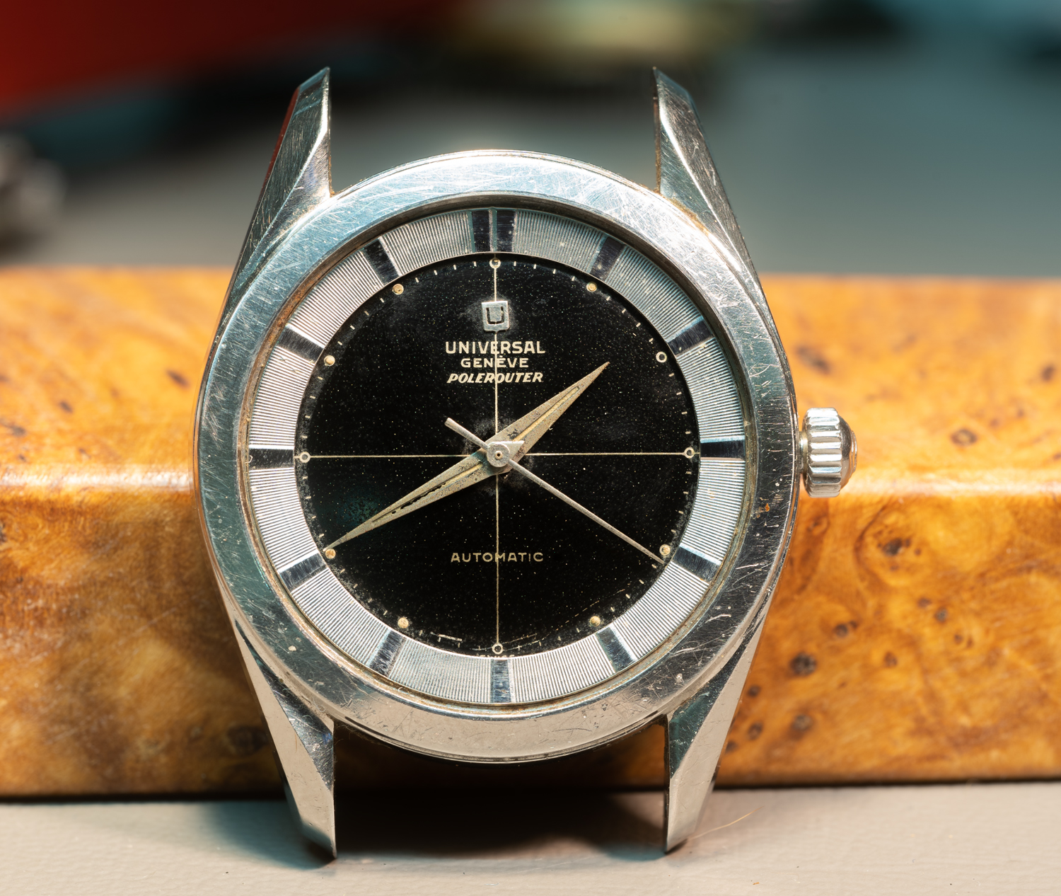

The reason I asked was because these glasses normally are mounted from behind to front and I needed to know if it is possible to munt a glass without the outer flange and mount it from the front with good result.

The "glass" is called the crystal. It is definitely not advisable to do any work on your own watch unless you are a trained watchmaker, or the watch has no value. Your watch has value! Take the advice given by others above, and take it to a professional watchmaker who understands vintage watches. I would not touch the missing lume dots, or any part of that dial. Don't touch it! It is beautiful!

I delivered the watch to a watchmaker but after one week, he mailed me back and said he wasn´t able to find the missing parts, but if I managed to find them, he could mount them for me. Are there any places I can buy a crystal to this watch?

I have ordered a crystal press from ebay, but my watchmaker said that a regular crystal without the edge wouldn´t be possible to mount on that watch. Is he right about that?
4,518
11,126
This crystal is installed from the top. You will want a watchmaker to do it if it is your first attempt at replacing a crystal. The watchmaker will remove the movement and clean up the junk around the edge of the bezel.
If you put a crystal on top of this, it will not be a proper mechanical fit and be quite unsightly.
Find a replacement crystal on line and take everything to a watchmaker. They will know what to do. 😀

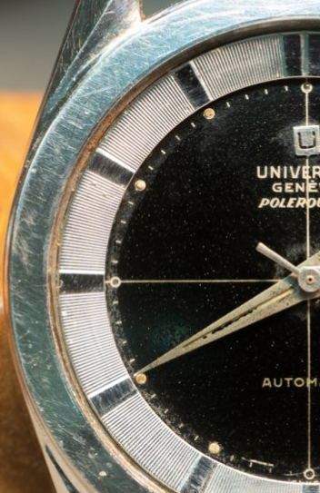

TBH, I don't think you need a new crystal, the crystal look good to me, just buy a Polywatch (crystal polisher) rub it circularly with micro fiber cloth for 10 to 15 minutes, your crystal will be good like new.
And your watchmaker is right, original signed crystal's design is unique and extremely hard to find. Just polish the crystal, it will save you from a lot of troubles.
Not that because you have a watch press, you would be successfully pressing in the crystal, it require skill and experience, a slightly misplace or unbalance will led to breaking your crystal

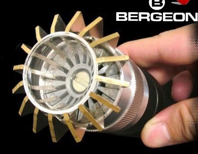

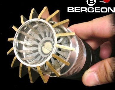

The watch hasn´t any crystal at all. You look stright into the dial. It´s not an ordinary watch press I´ve ordered but something like the picture here:
No wonder it looked pretty see through, and get me wonder why you'd need a new crystal. Lol
Okay, for my polerouter, it needs 29.6mm crystal and a decent tension ring to keep the crystal intact and keep out the moisture.
Hope it helps and good luck trying

The old crystal is removed because it was heavily scratched both inside and outside and it couldn be polished into a decent shape again.
