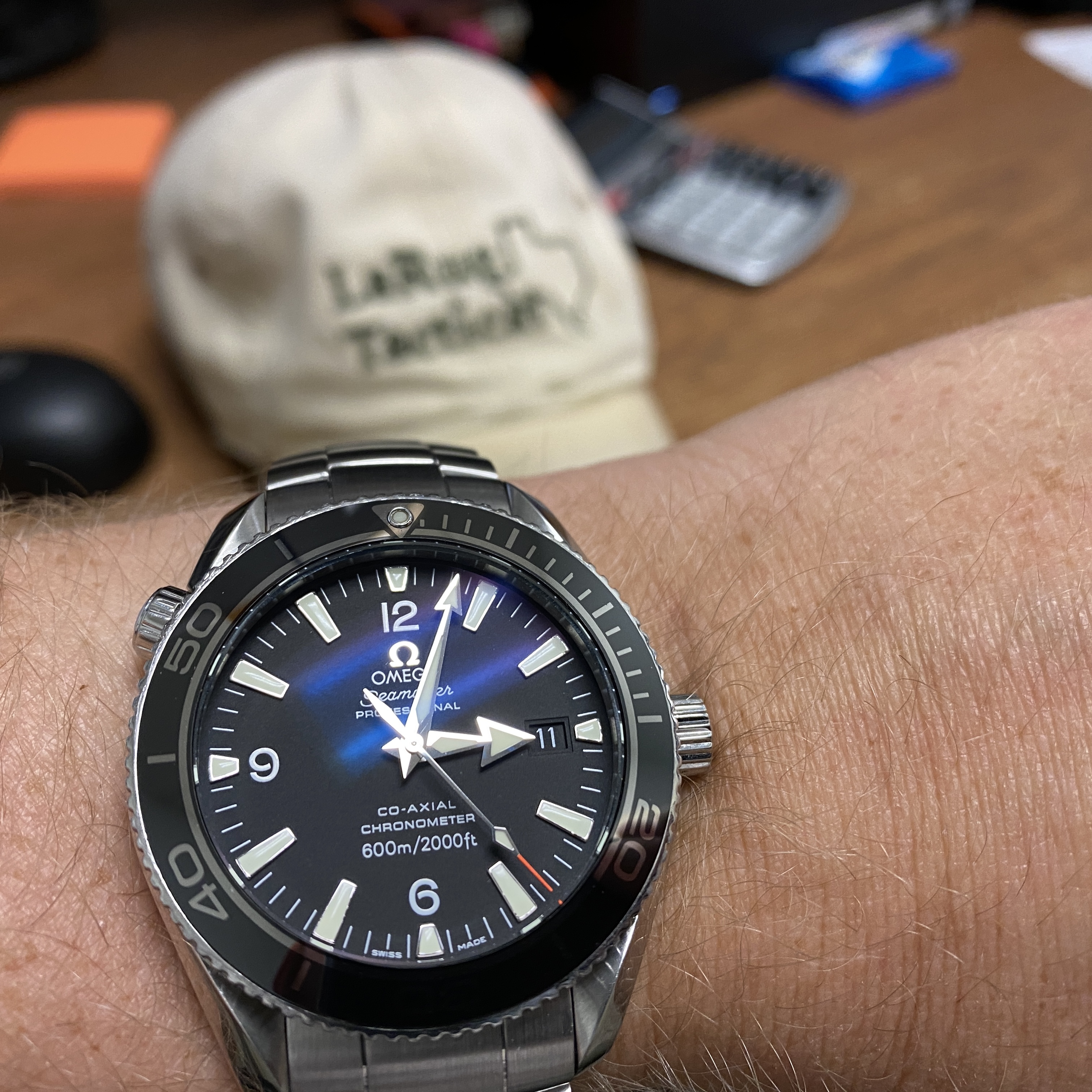

So long story short, I have a PO that was purchased second hand and has the LiquidMetal bezel installed. The watch was just serviced by Omega last year so it doesn’t need a full service but I would like the original aluminum bezel put on. How would I go about doing this? Is it a part I can order and have a local guy do?

I guess that bezel was changed after Omega has serviced it.
OP, you can order a new bezel kit (bezel+insert) from AD. You have to order a kit as Omega does not sell these aluminium inserts solo.
Sales section here on the OF, ebay or chrono24 are other ideas to find pre-owned bezels, those should be more cost friendly options.

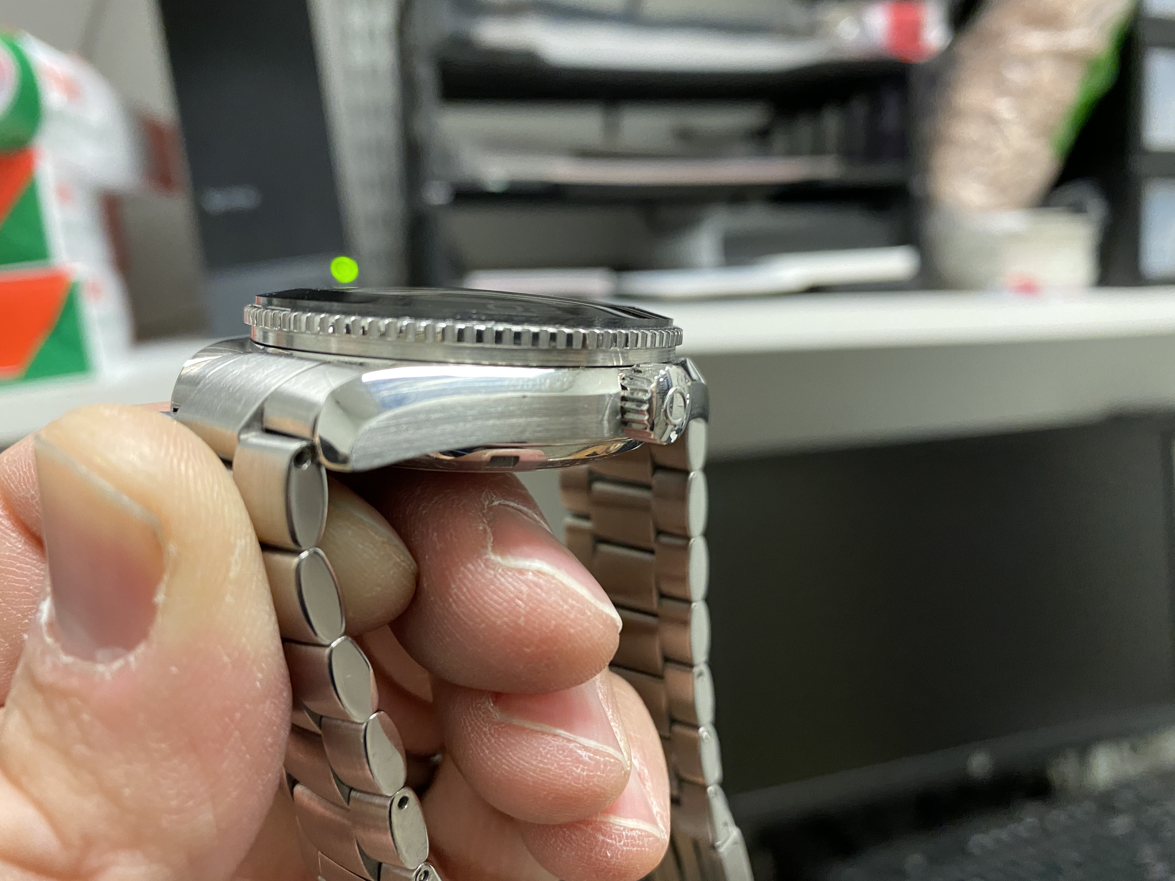

Here’s a photo from the side. As you can see it’s much thicker than aluminum. It also sits just a hair above the crystal, you can’t notice it unless you’re really trying to see it but you can feel it with your finger.

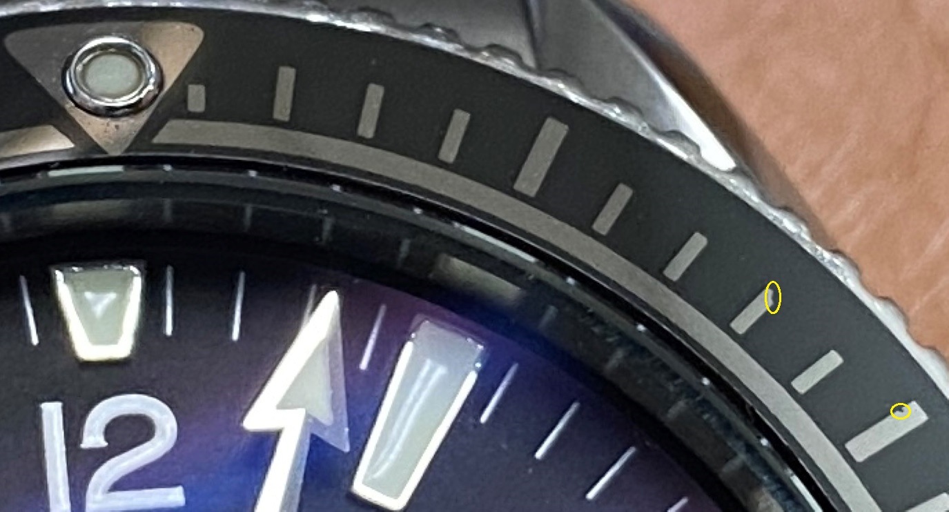

@VickMacky I wasn't referring to the smoothness, my point was - 1-15 markers are rectangular cavities cut out by the laser, on yours insert 8 and 10 marker are not "regular rectangular", hence my guess this is lacquer applied on the ceramic.
Neither I wasn't questioning ceramic/aluminium, yours clearly is ceramic, I just doubt it was made by the Omega.

Something with that pip looks wrong. I doubt your bezel is authentic to be honest.

I would be extremely surprised if it was genuine. The minute hashes and the shape of the triangle are different from those you normally see. And the pip seems slightly offset.
Also, the ceramic part doesn't come separately from the steel bezel. Someone ordered an aftermarket inlay and crammed it into the steel bezel 🤦
