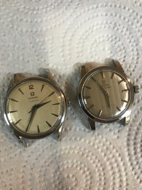

I recently purchased this 2910-SC with the calibre 284 movement that dates back to 1956. I would like to replace the crystal but have not been able to find the correct part number or information on the crystal diameter online. Might anyone have any information on this? Thank you in advance!

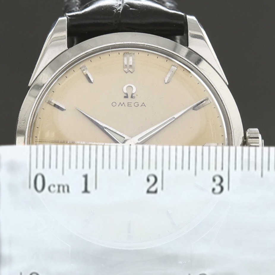

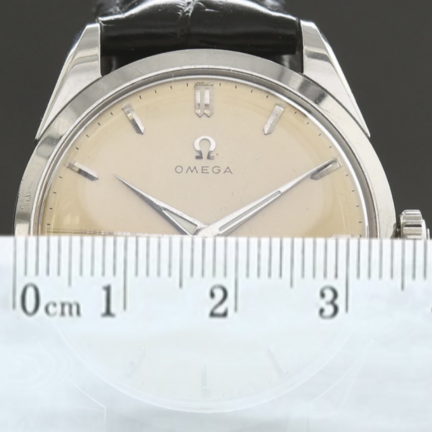

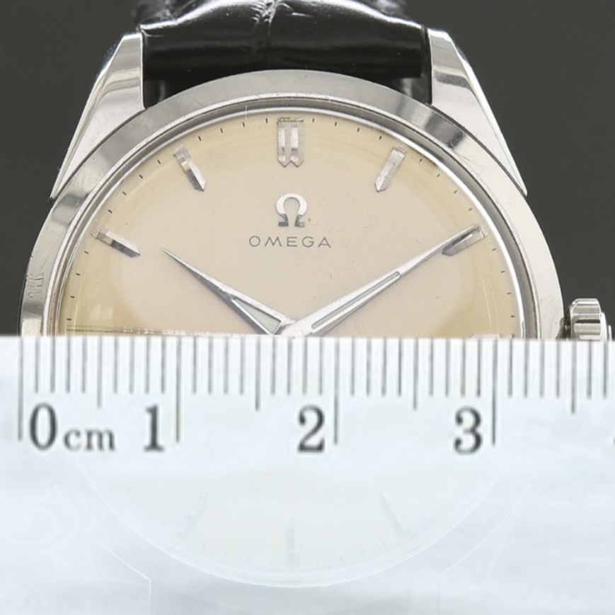

I did some “measurements” with a 2910 image I found online and my amateurish guess for the correct crystal size is… 30.6mm! Let’s see what the experts say. 😁

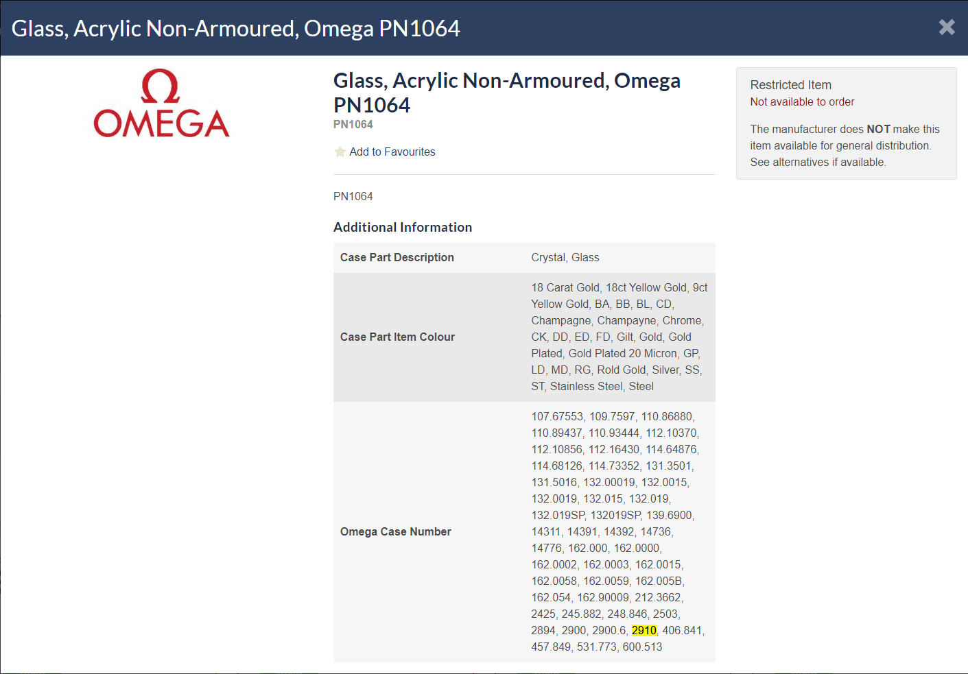

I think this is it according to cousinsuk, which has a 31.1mm diameter:
I'm not one of those experts by the way, so it would be great if someone can confirm
Thank you! If it is indeed PN1064, then its size would be D31.1 H3.5. 👍
