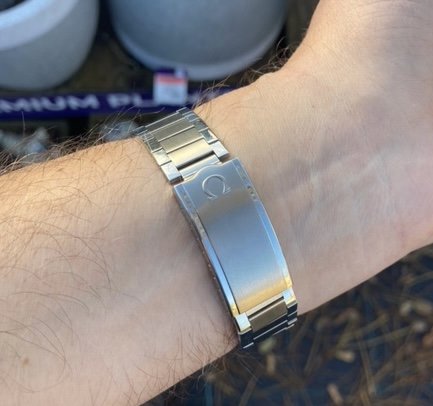

They recommended a 020ST1998849 (which looks way more modern than the 1171)

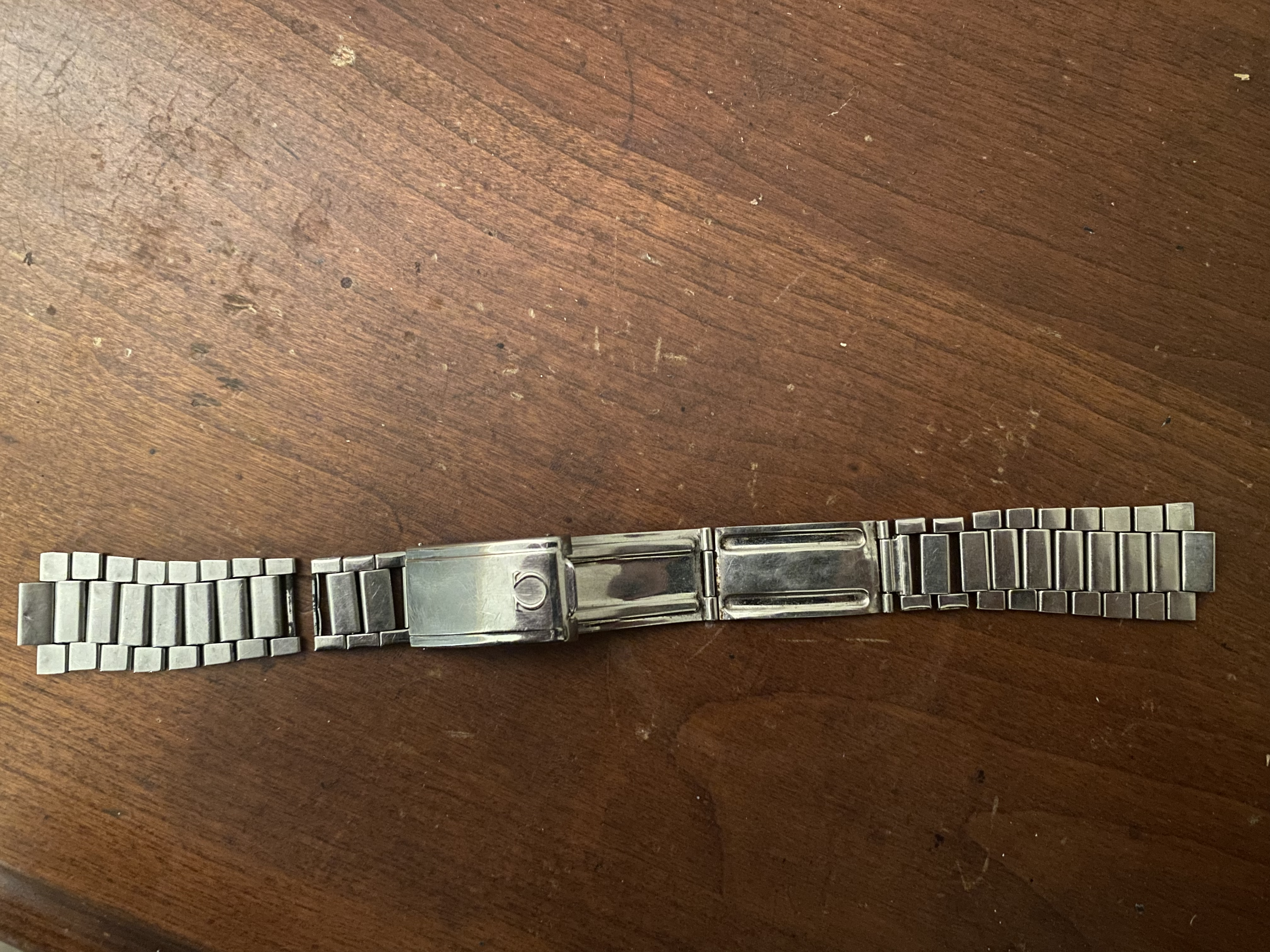

Can you show some photos of the broken links.
Looks like I have all 8 regular links on each side. Plus 3 caterpillar links total (one on one side and 2 on the other?

That doesn’t look too bad from the angle. Restoration may be viable.

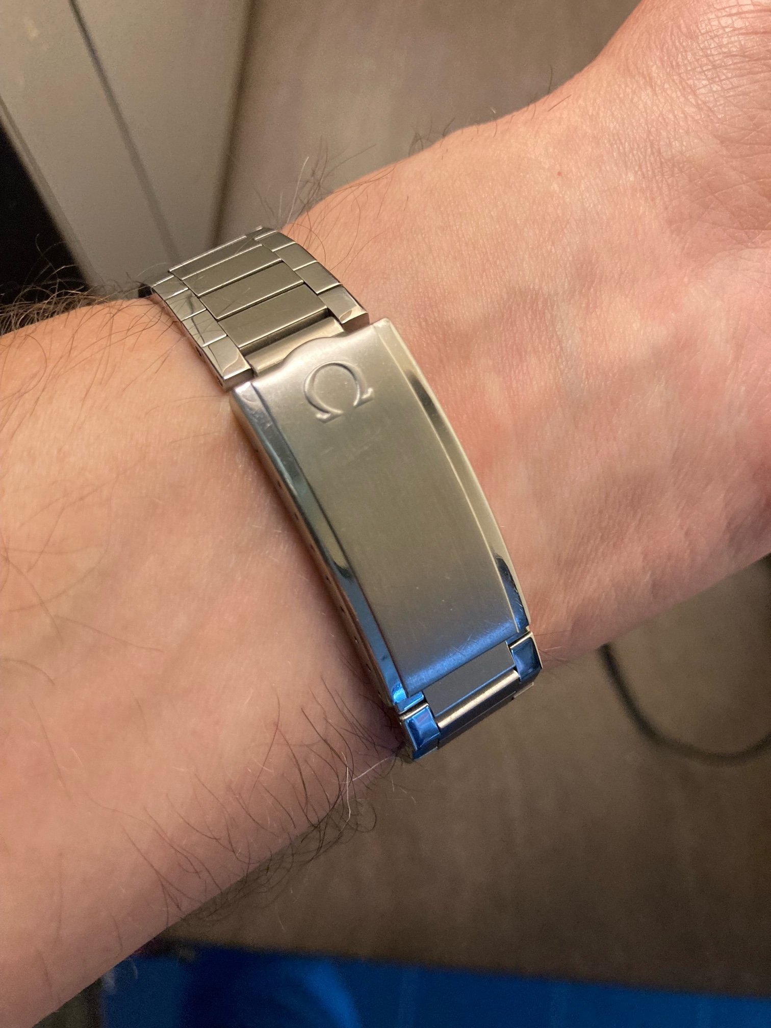

Omega can certainly sell you a bracelet to fit your Speedmaster, but it won't be a flat link bracelet. Most likely they will recommend a 1171 bracelet with 633 end links. If you Google Forstner Flat Link and Uncle Seiko flat link you will find two sellers of replica flat link bracelets. By all accounts they're good products and you might like the look better than the 1171 bracelet at a more affordable price.
I wear an Uncle Seiko with my original 516 ends on my 165.024. I put my 1039 in the safe, it’s full links and too long for me. The uncle seiko wears great, as good or better than the original.
