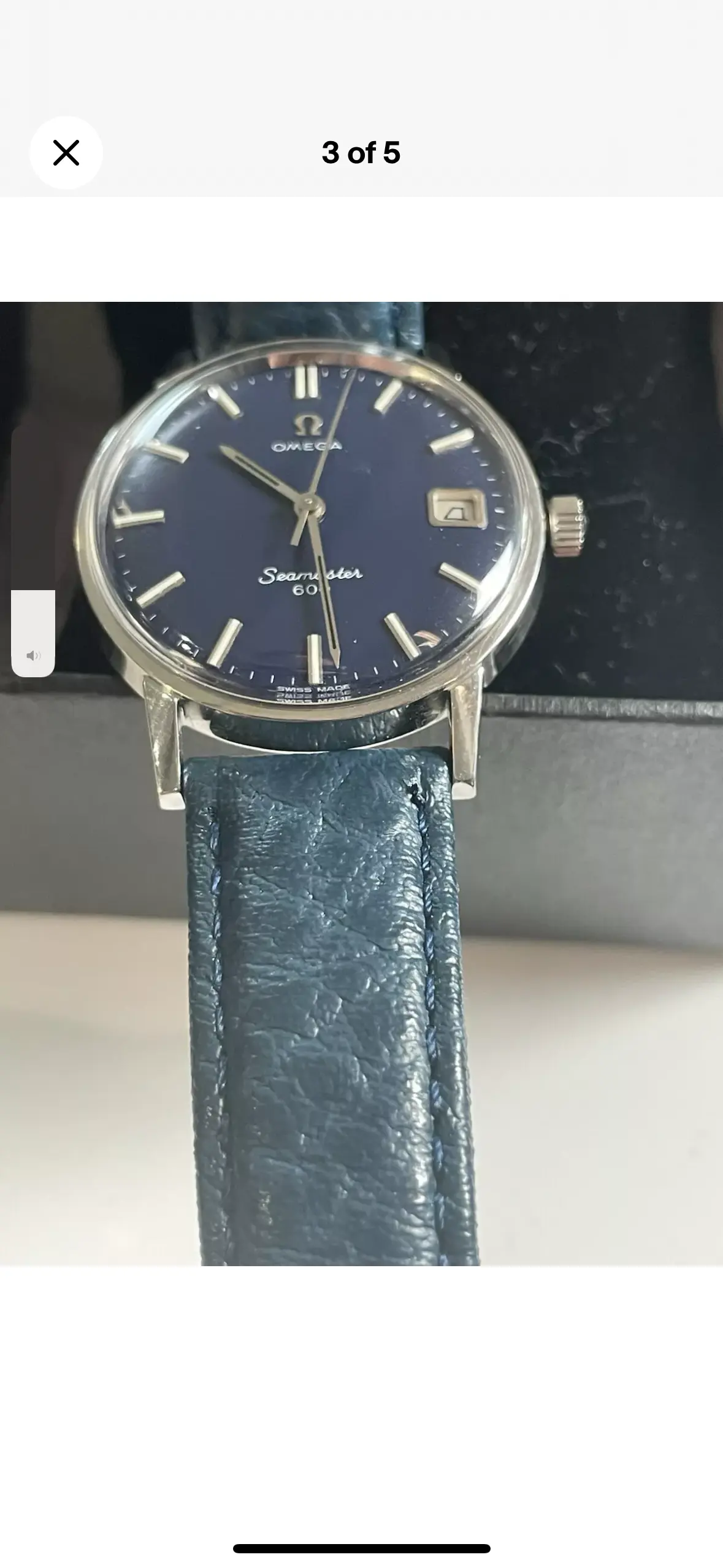

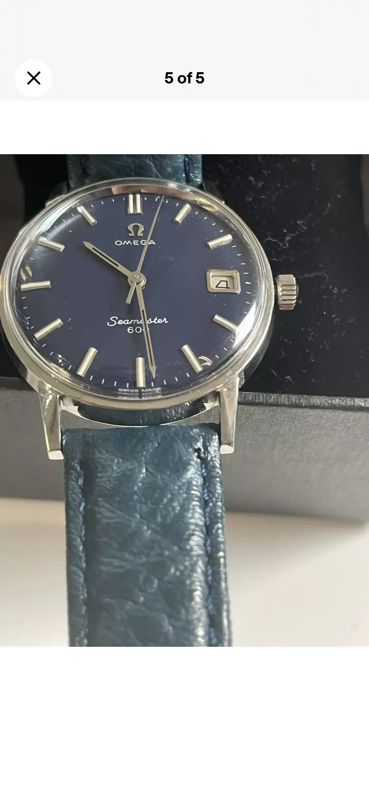

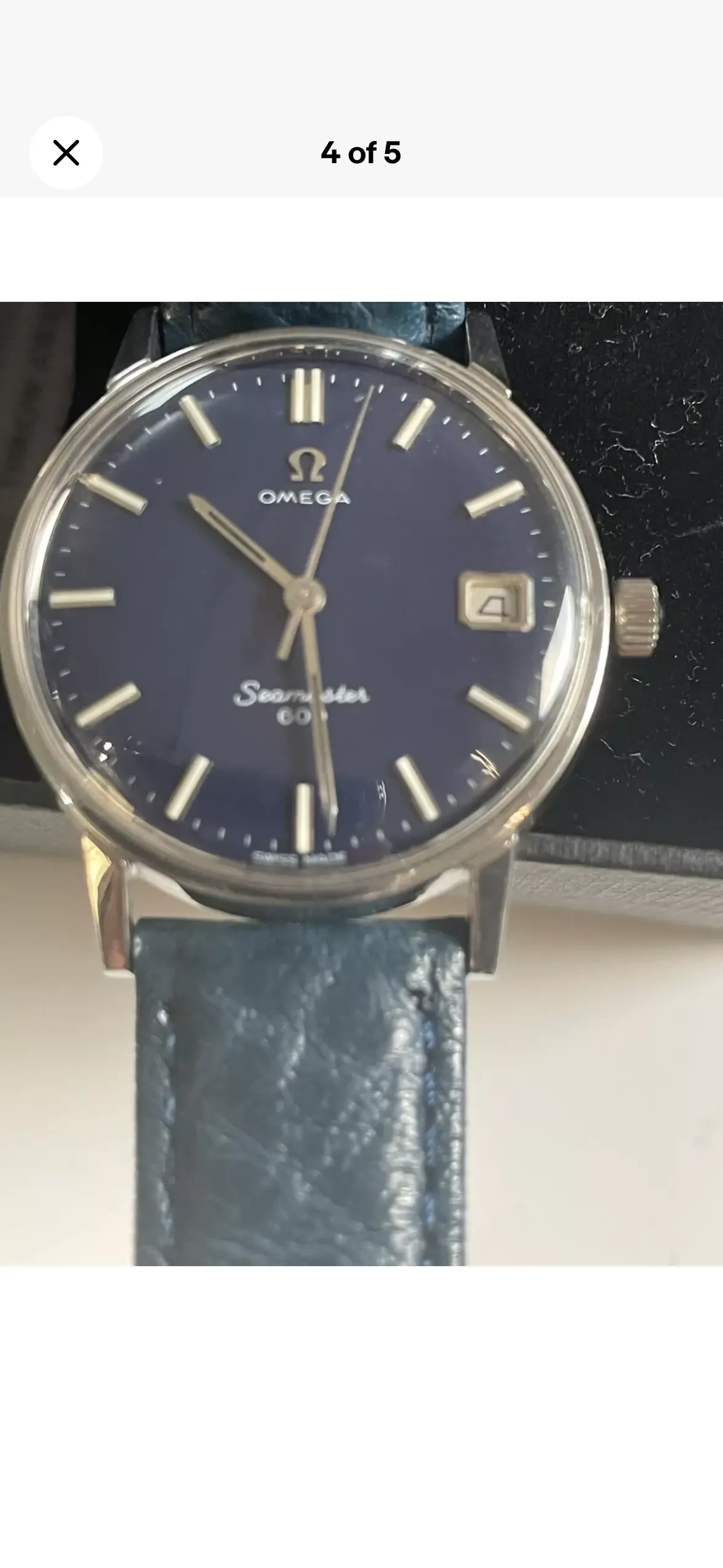

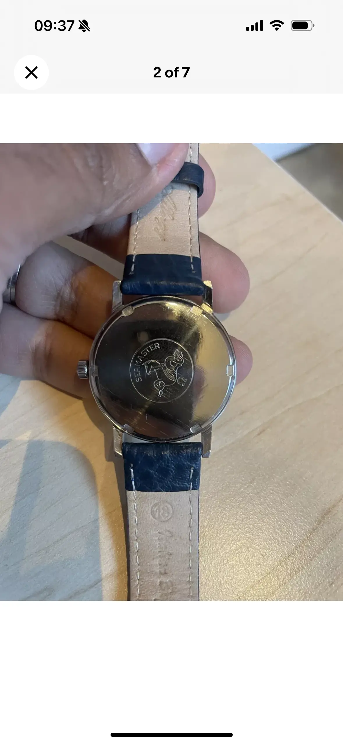

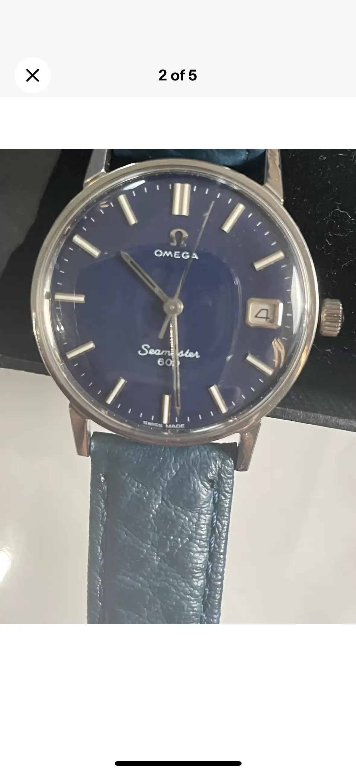

This looks pretty good, seems the Swiss made seems in the right place and from all the research on this forum and the right pages - looks ok? Would welcome your thoughts

I'm still learning, so I could be wrong, but I don't recall ever seeing a Seamaster 600 with an original blue dial. And the black onyx hands don't match the white applied indices. So it wouldn't be "ok" for me. But if you like the watch, don't have a problem with refurbished dials and non-original hands, and you're willing to pay whatever price you can negotiate (presumably not much), I guess it's "ok" for you.

Yes, I agree that it's a better than average re-dial. If that was your question.

Are you saying it’s a redial and asking opinions on how good it is or asking if it’s a redial (it is)?
I thought it was a redial - just don’t want to get ripped off - doing as much research as I am and learning a lot! This looks good? Thoughts?

I just wouldn’t buy the blue dial one. Why buy a redial when there are so many nice SM600’s out there with original dials??

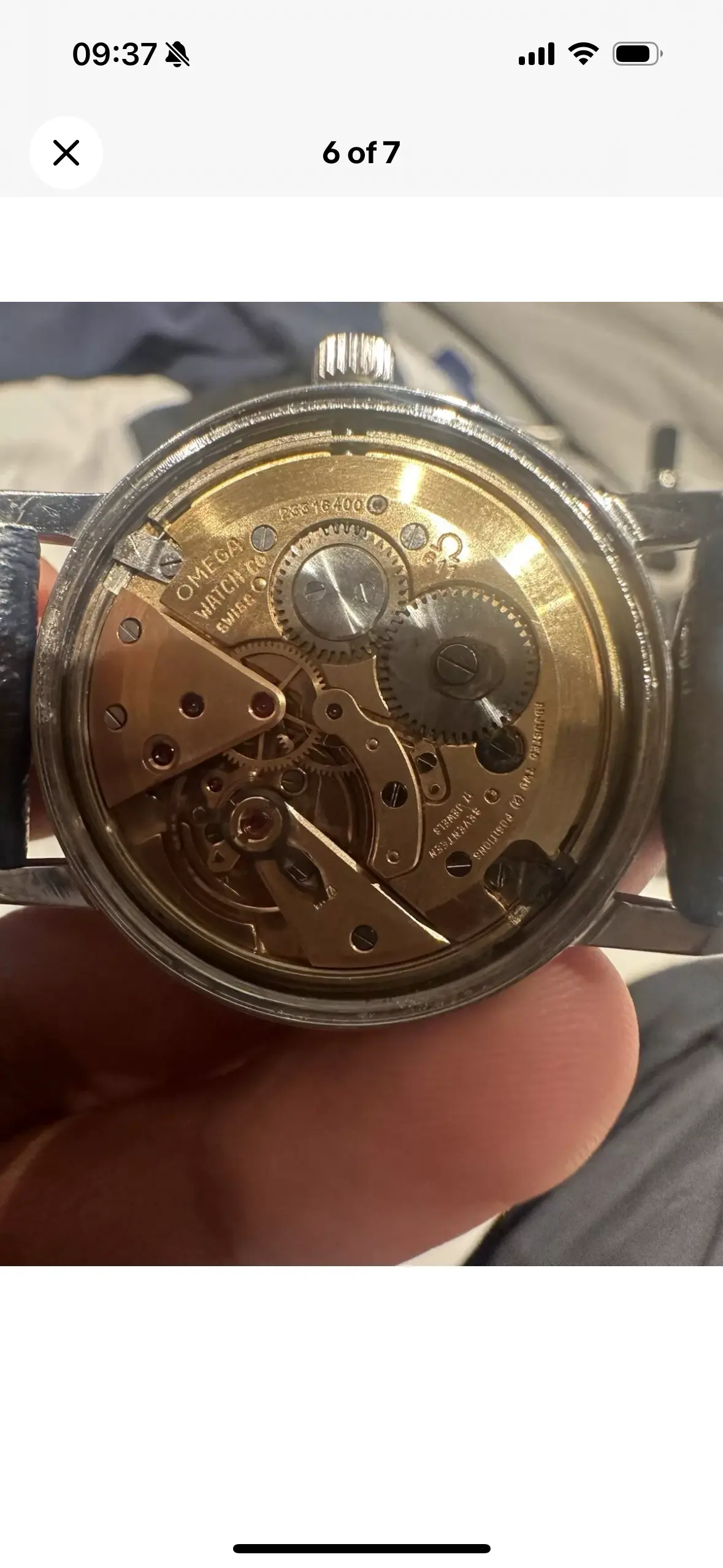

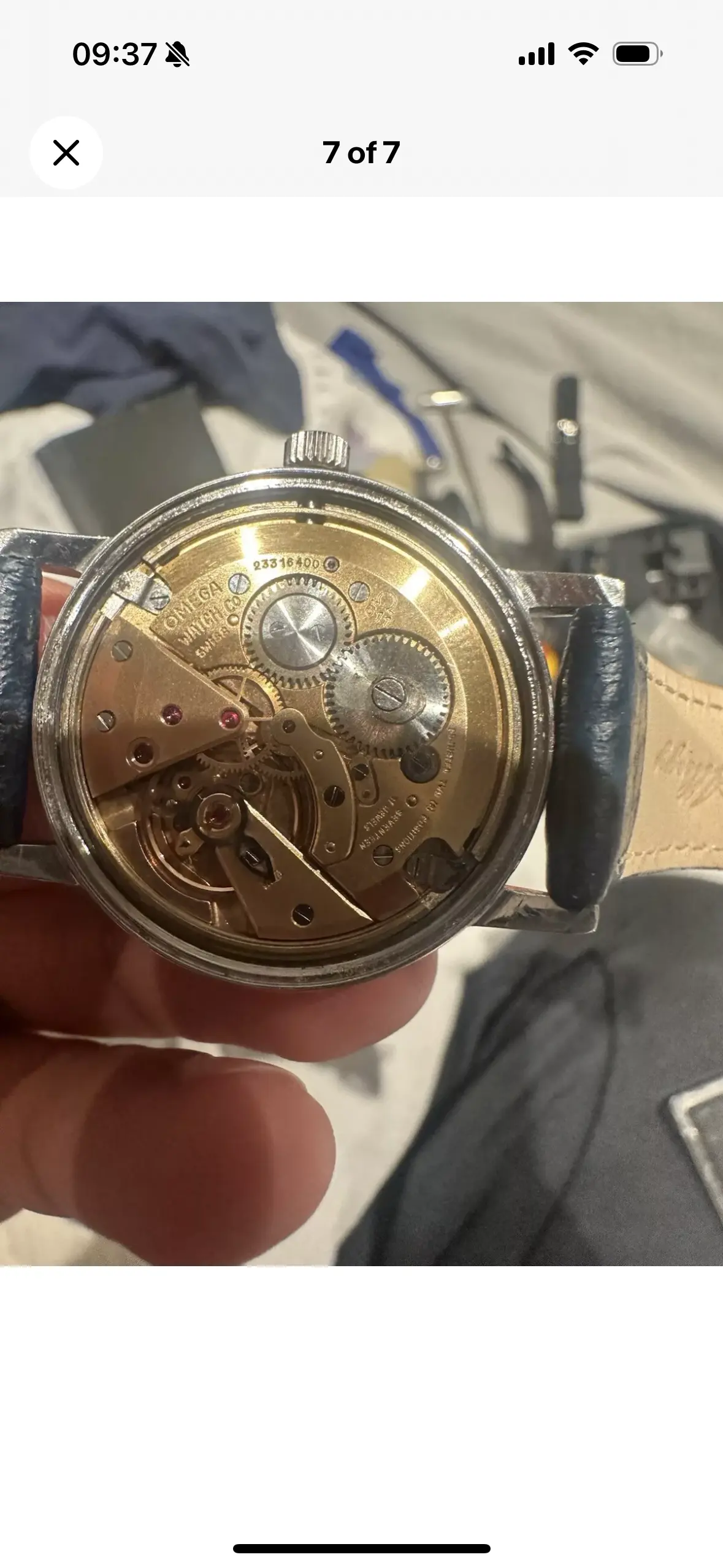

What are your thoughts/concerns on it?

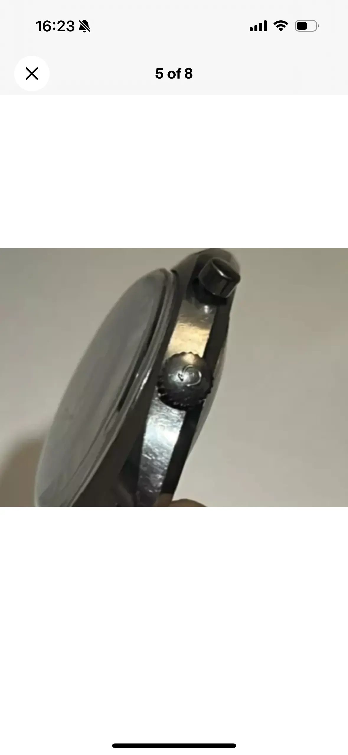

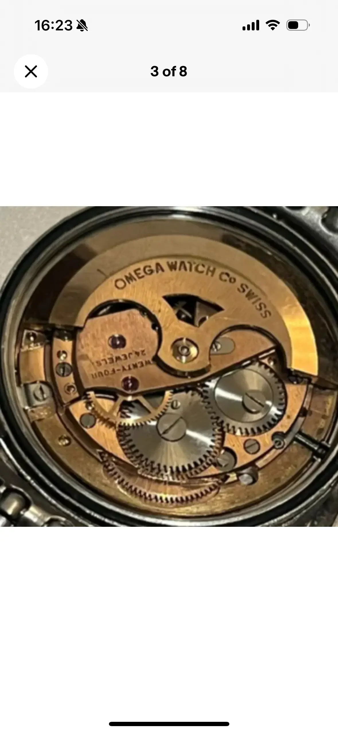

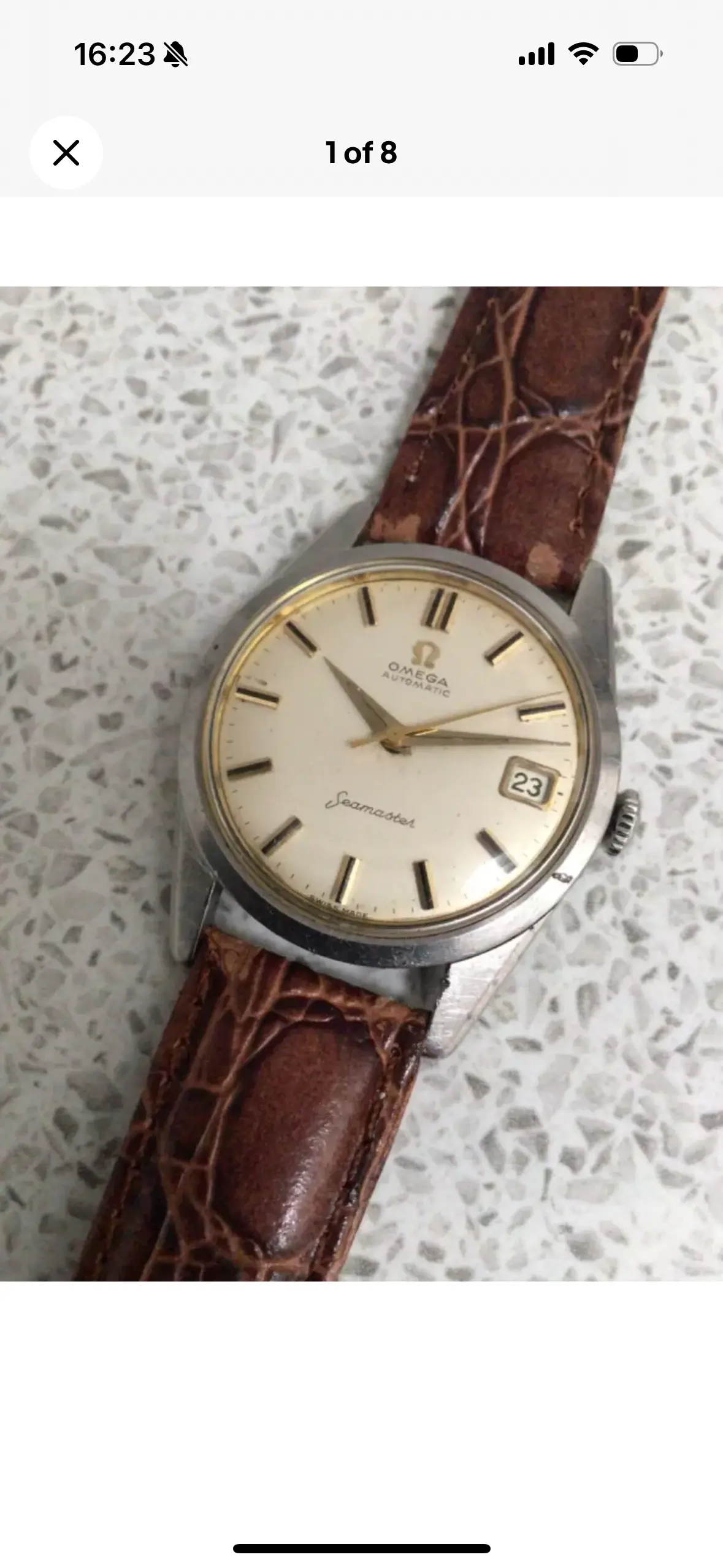

There’s definitely two different watches in the second listing they shared. One of the pics looks like a chronostop.
