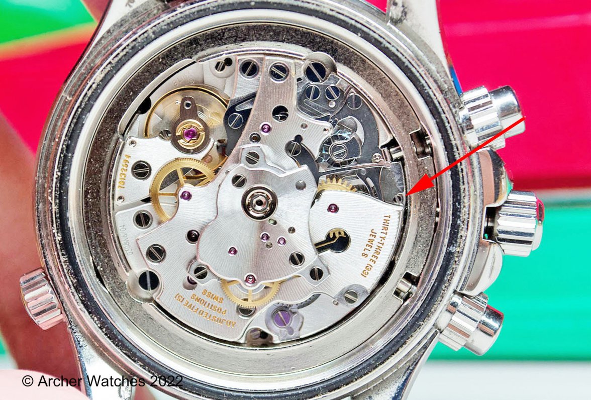

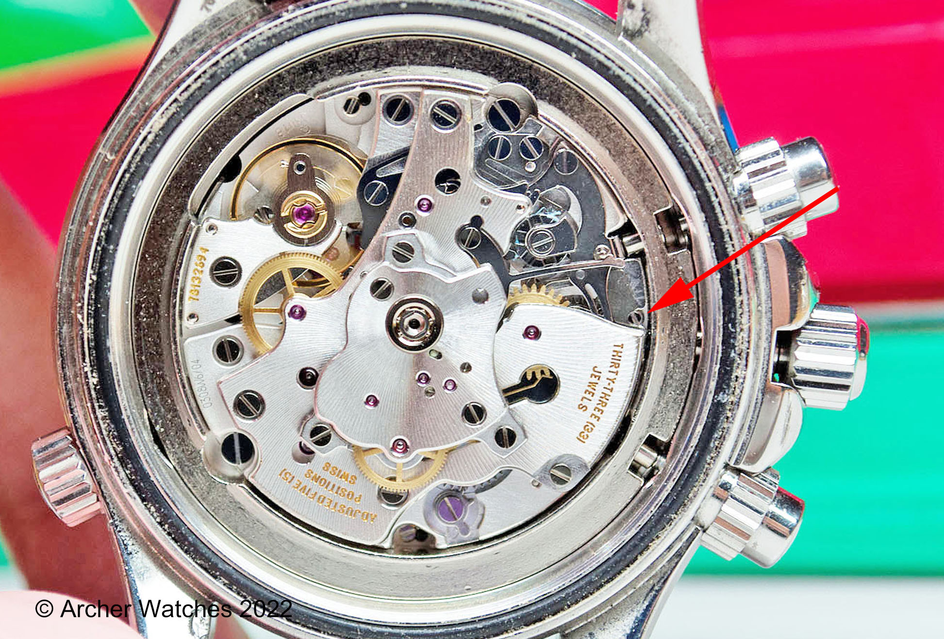

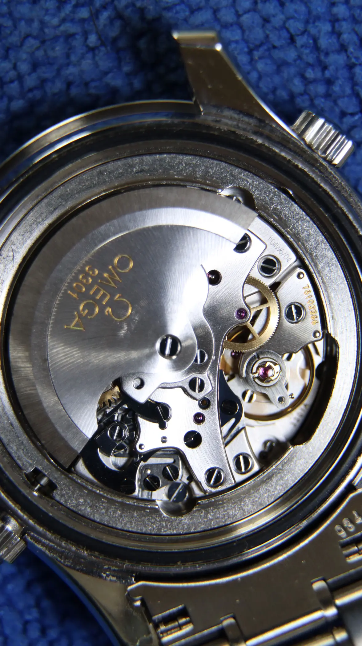

No need to remove anything to release the stem. It's a very standard screw as you would find on many vintage watches...right at the red arrow:
The rotor has been removed so you can see the screw easily in the photo, but it doesn't have to be removed - it can just be rotated to one side to access the screw. Like any watch with a screw for the detent, don't unscrew it any further than is needed to release the stem, or you will have a much bigger repair on your hands.

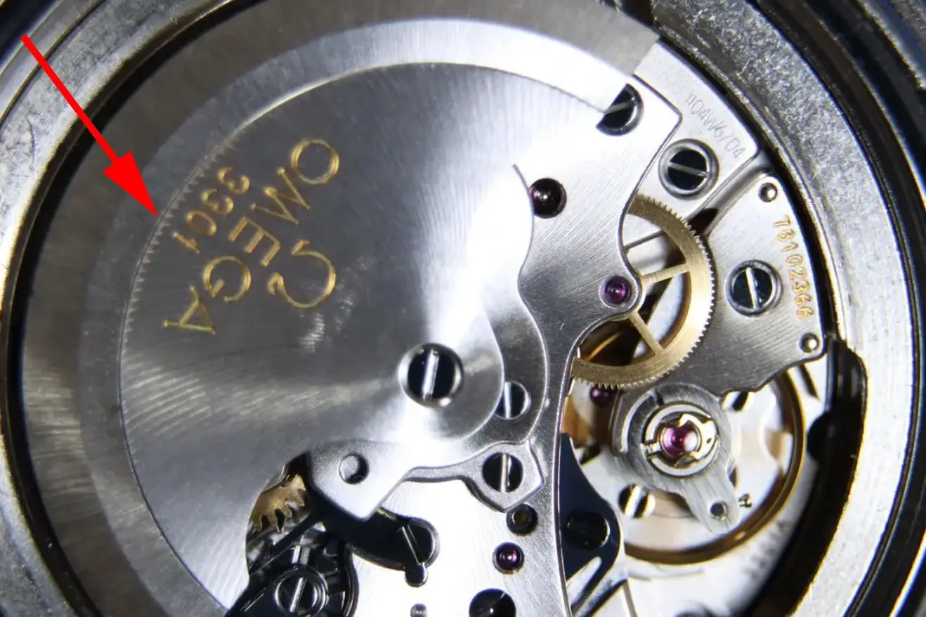

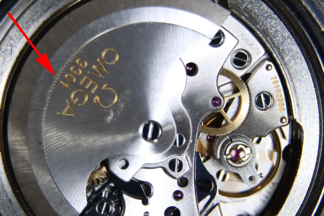

Thanks for the photo - so this is a 25945200 Seamaster chrono. Just one thing that you should ask your watchmaker about...

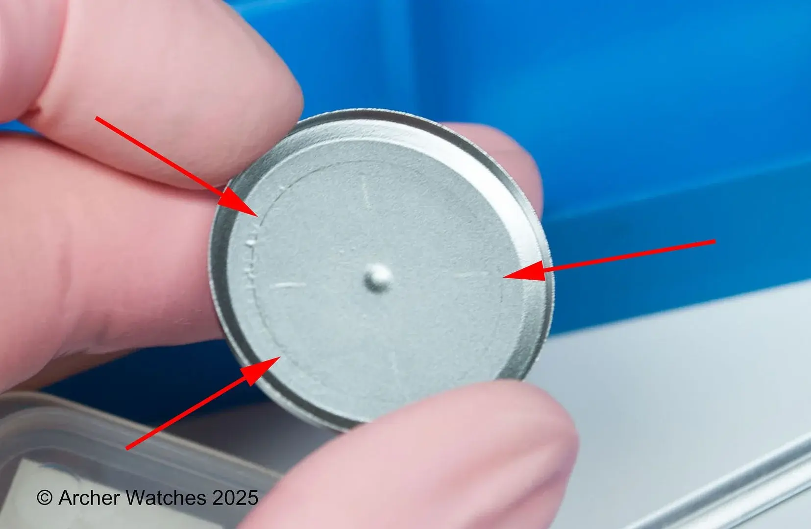

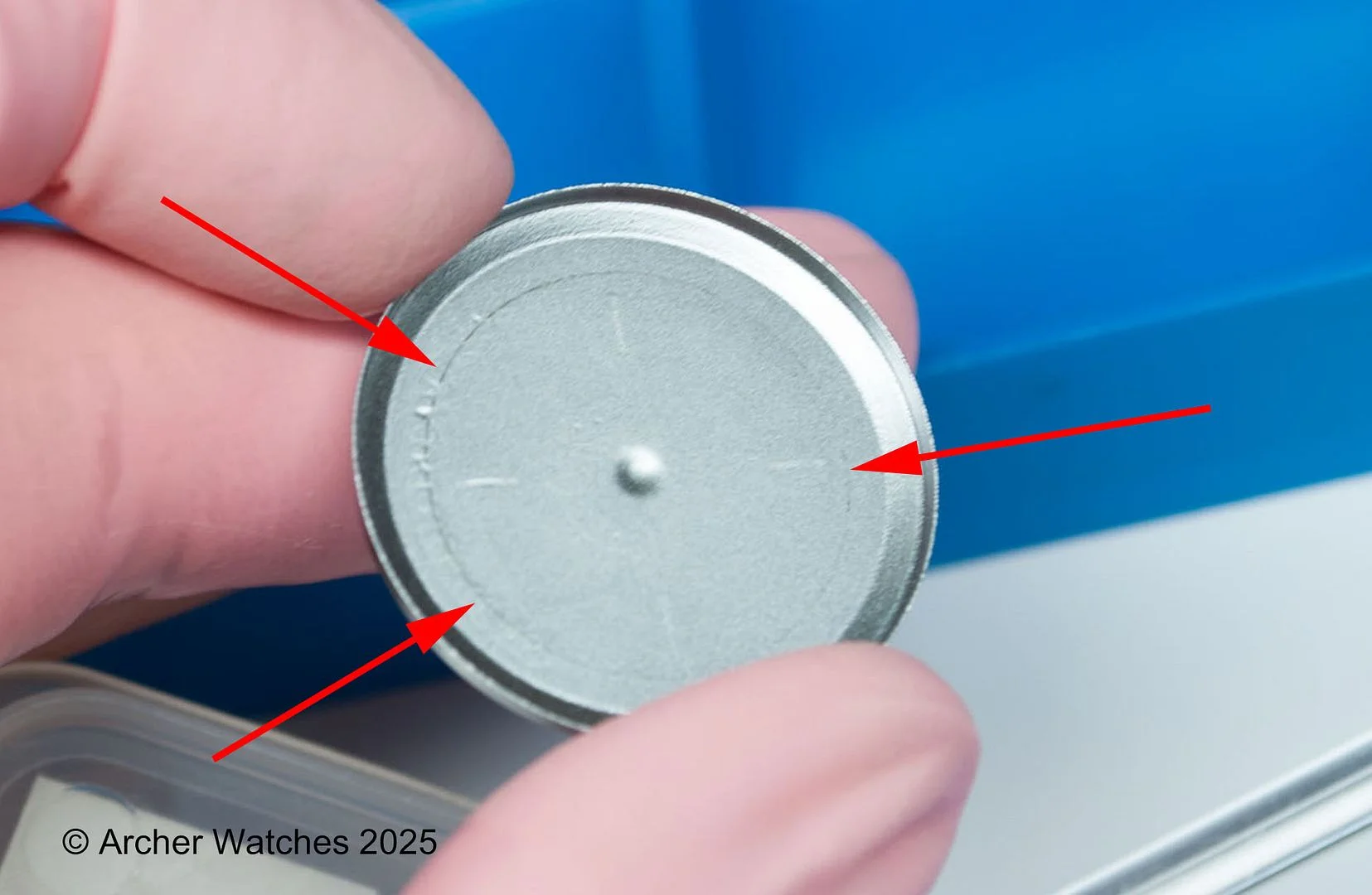

The red arrow points to wear on the rotor. This means that the rotor is contacting something - in this case it would be the inner antimagnetic cover, and there is very likely a corresponding circular mark on the underside of the cover - it would look something like this:

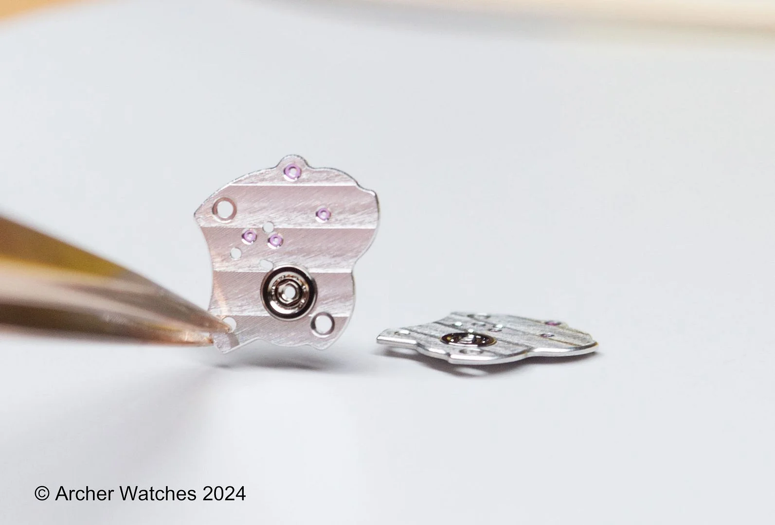

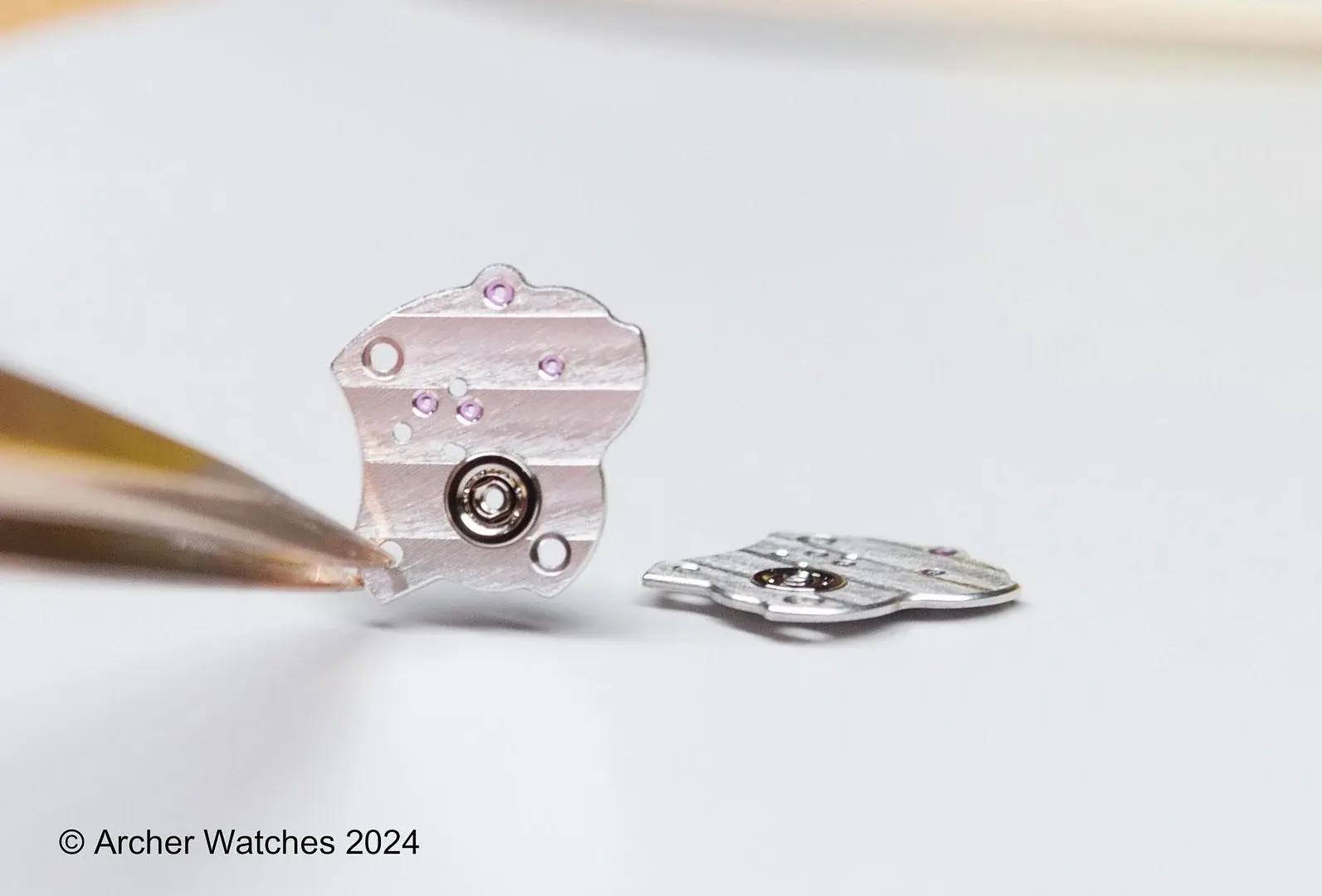

This is a result of the bearing for the rotor being worn out. It allows too much lateral play and the rotor ends up scraping the inner cover - this can affect automatic winding performance, and also create debris inside the watch. Unfortunately due to the design of this family of movements, the only solution is to replace the part that the bearing is located in, which is the automatic winding bridge - this one is from a Cal. 3303 but gives you an idea:
He should get a new bridge from Omega for this to ensure a proper repair. Part number is 722330312050.
