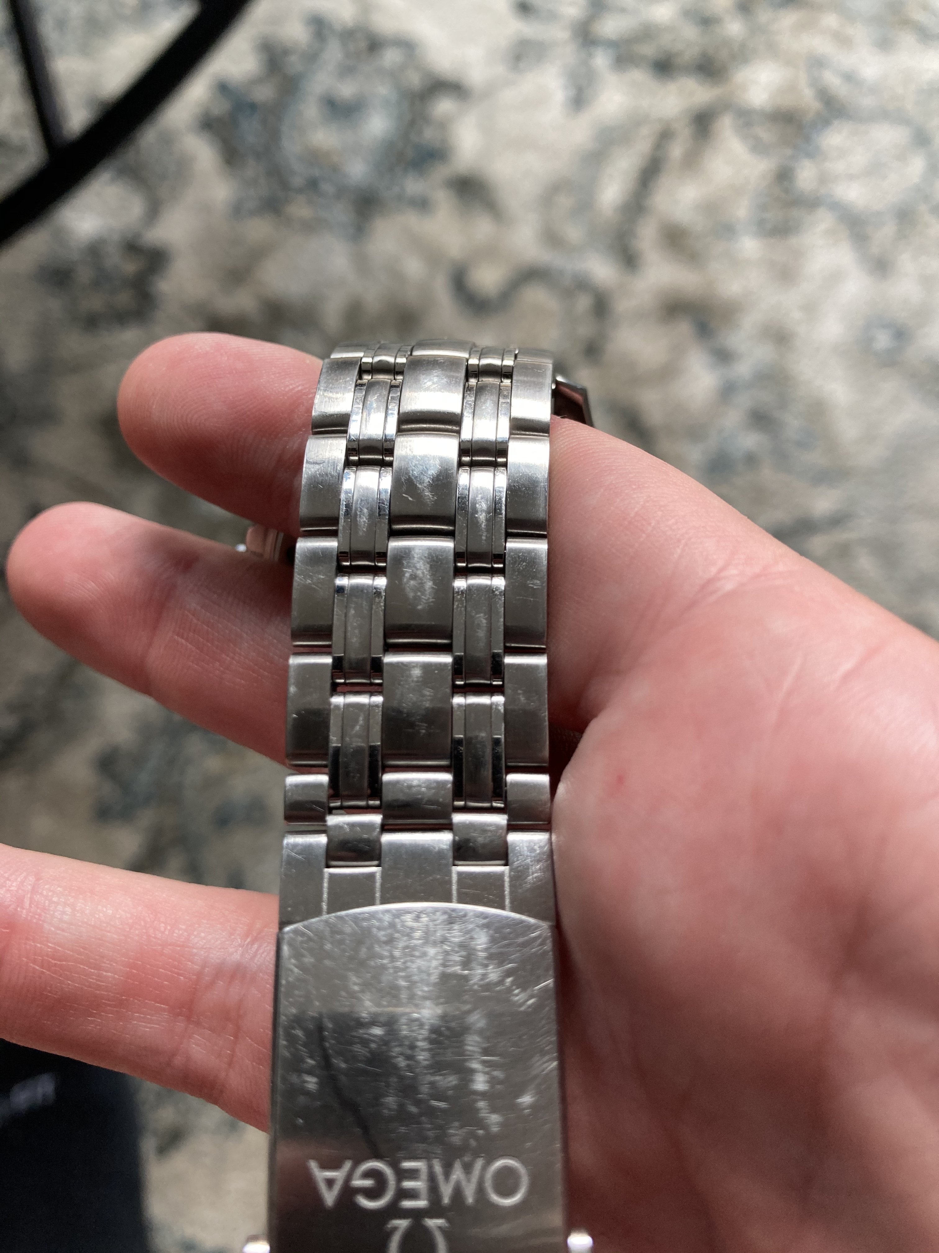

I don't touch the polished finish parts of the bracelet or the watch case, but I was given a soft dark grey material by a watchmaker years ago that absolutely works wonders on matte finishes on both bracelets and watch cases. I'm sorry I wish I knew the name, but, from the post I did regarding refinishing my 1039 bracelet, a few people had some ideas.
Link: https://omegaforums.net/threads/aft...estored-original-finish-1039-bracelet.118275/
this I found to be the best. Not going to take out scratches but will brighten up the metals.

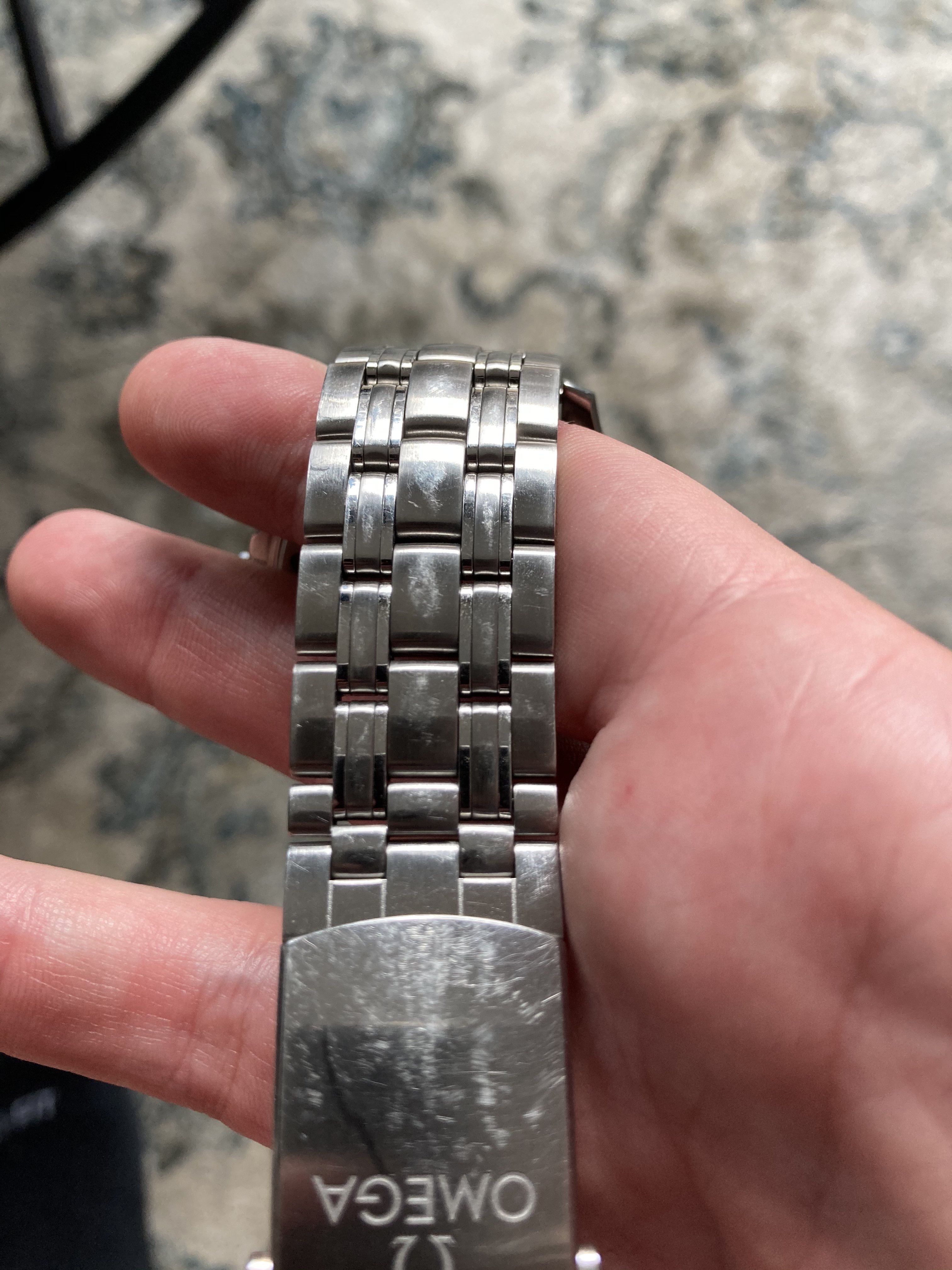

247

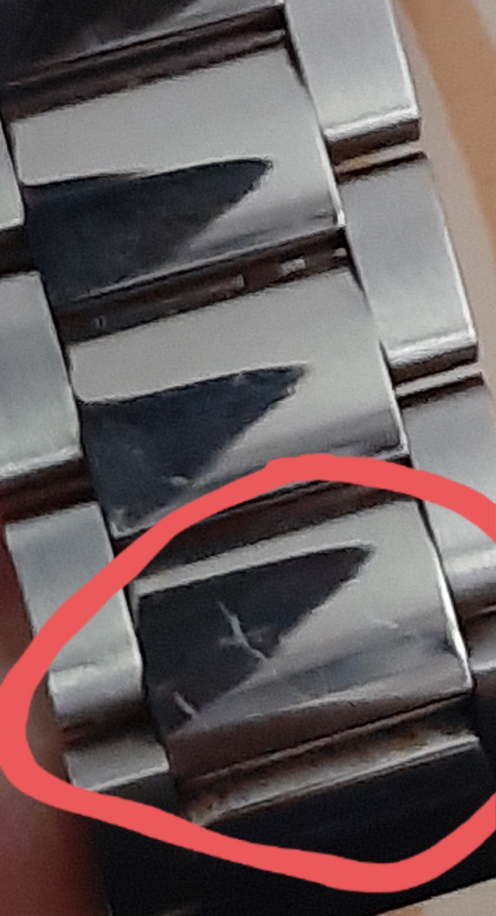

Is not seen at first instance or easily you have to twist and bend it playing with the light to identify them. They are more superficial I think but definitively they had carved the metal.

I would live with them until you take it in for a scheduled service. They can be removed.

If it matters enough to you, you could probably brush it out with some Scotch-brite and then re-polish.

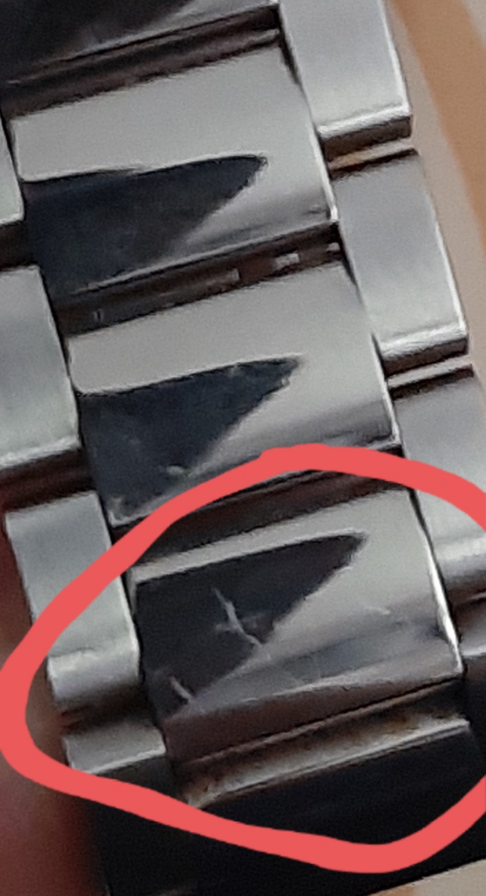

10,813
Difficult to see where this pic is situated on the bracelet. It almost looks like the inside not the outside and appears to be heavily damaged not scratched. Maybe better pics?
334
247
Its halfway between dial and buckle. A little bit more closer to dial and its outside.

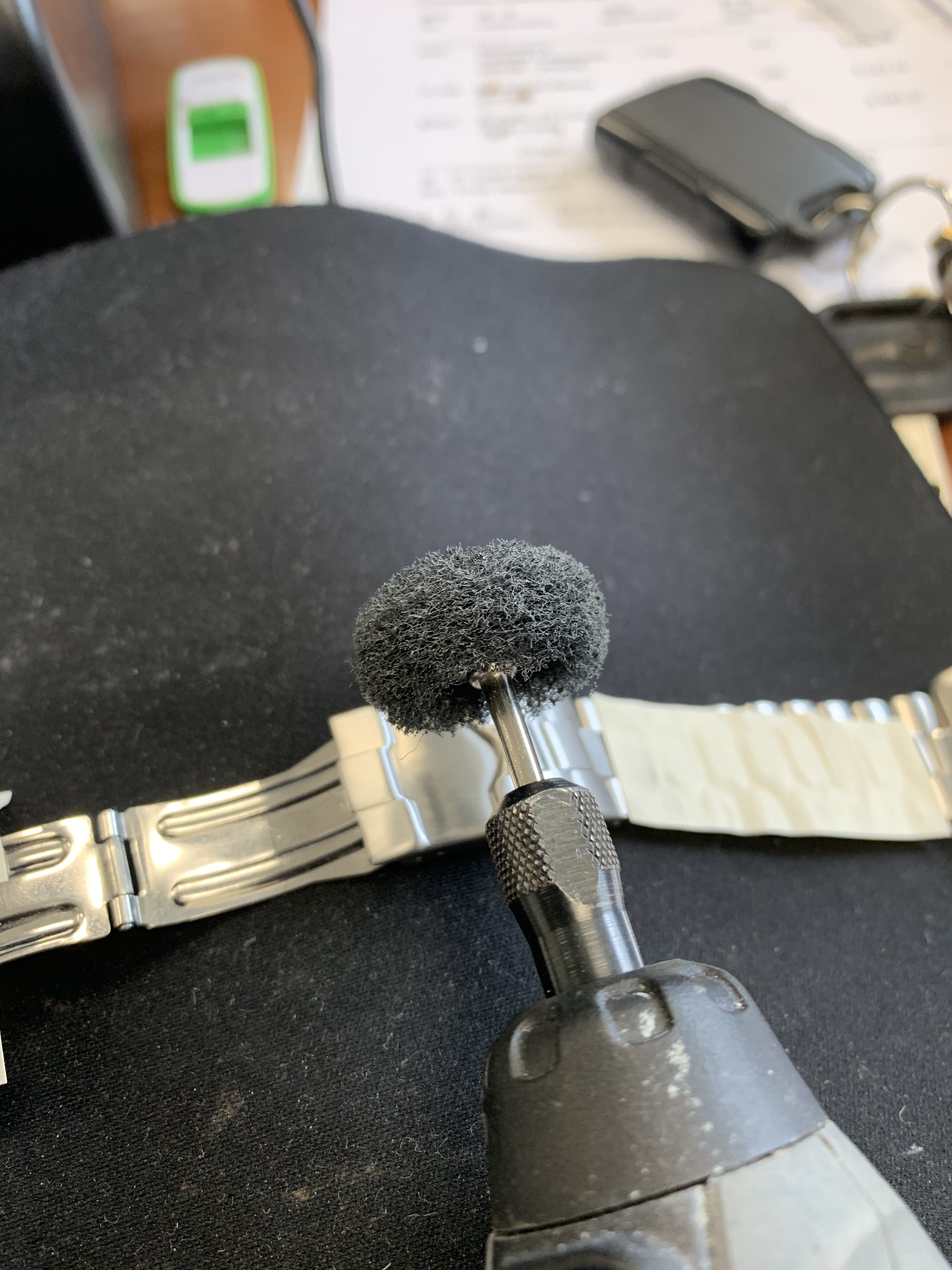

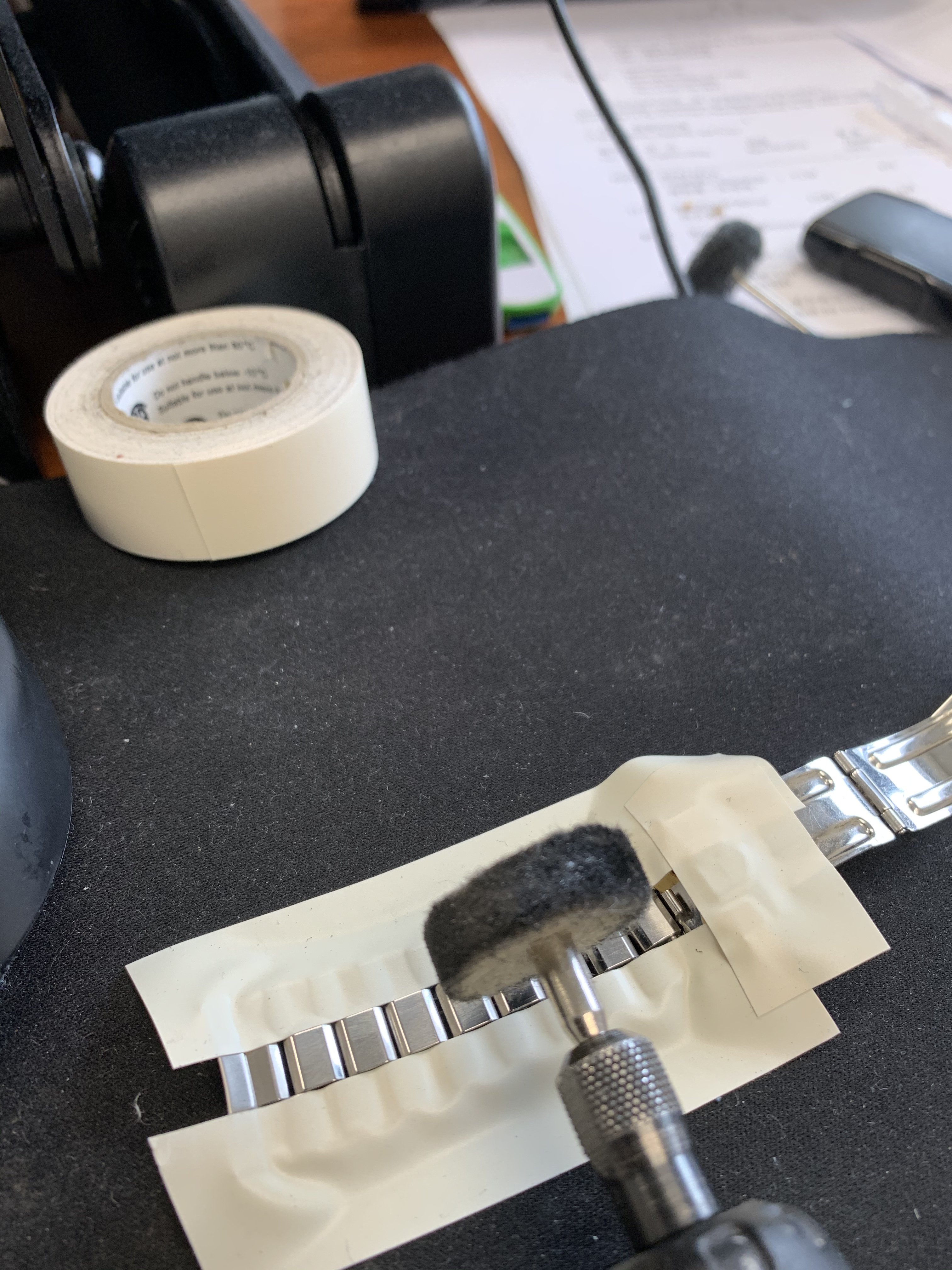

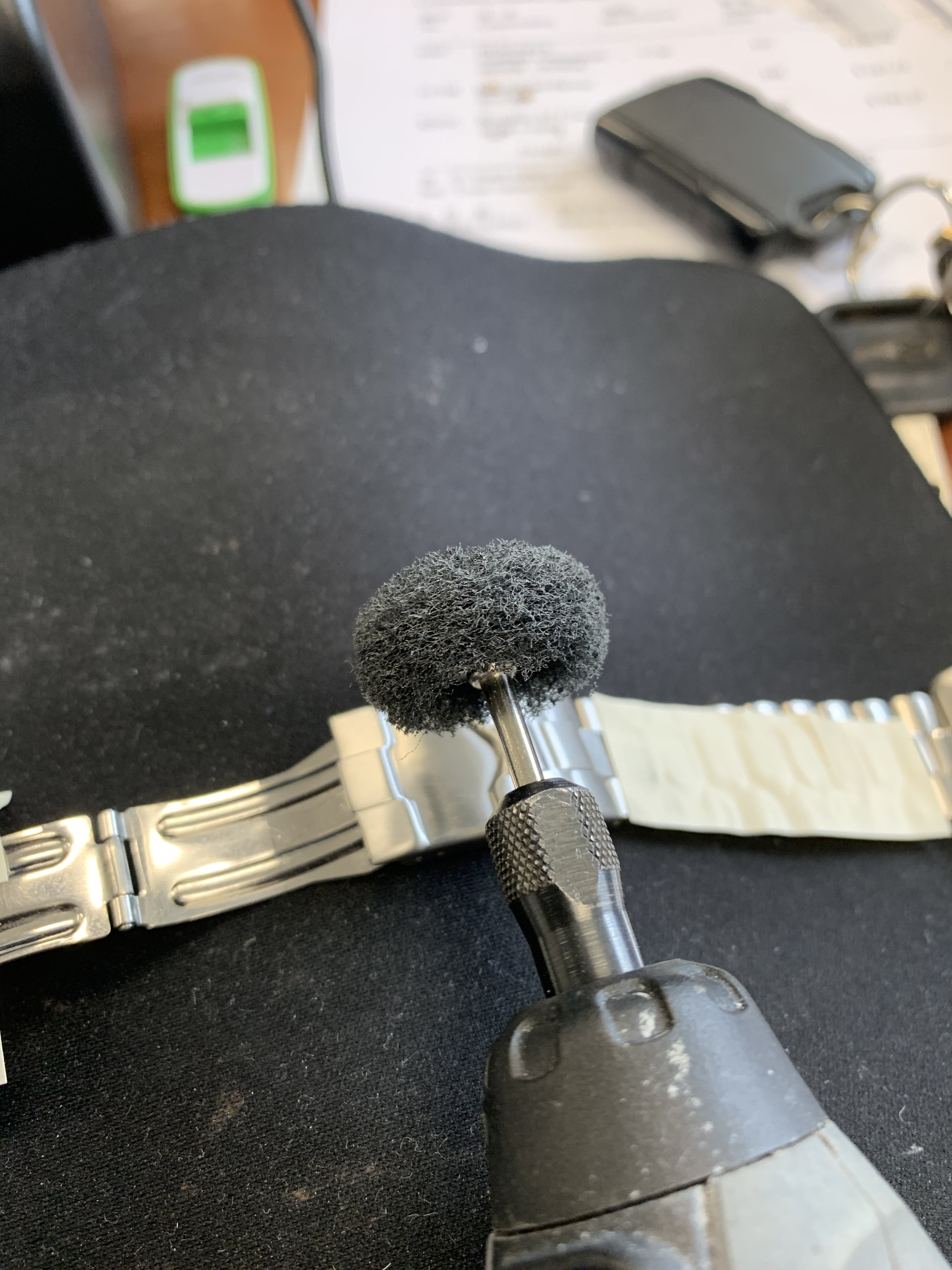

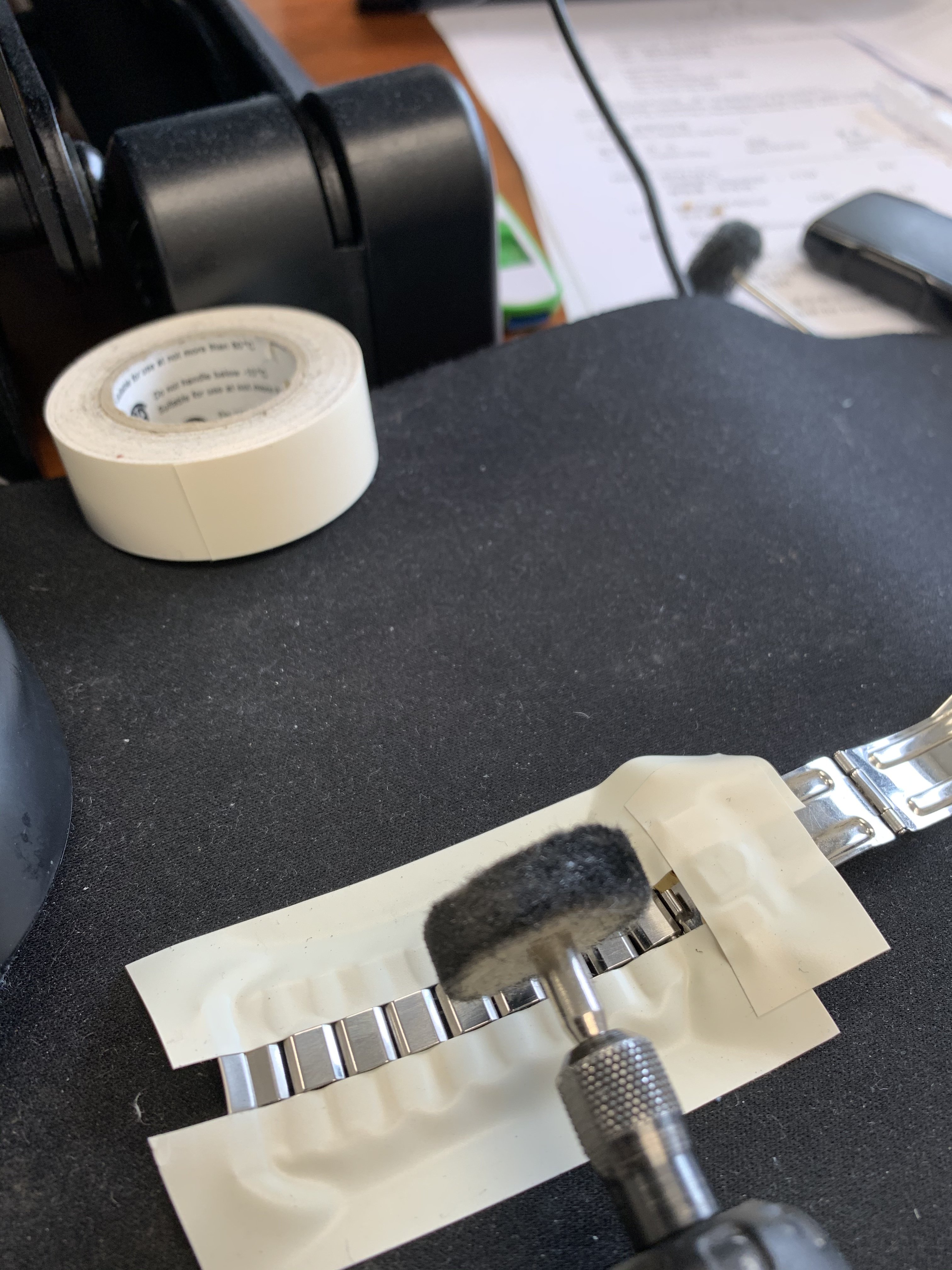

103
265
Scotchbrite does work but as others have mentioned a satin wheel is best. The issue I found with scotchbrite pads, especially green or red, is that they can leave deep striations. The white seems to be finest. I recently picked-up some satin wheels on amazon which are working well using a Dremel Tool. They create a nice satin finish on an old Tag 2000 which is my beater and test watch for things like this. I move the satin wheel perpendicular to the band which seems counterintuitive. Definitely try to get a test watch or bracelet before you do something you might regret. That said, as long as you don’t go too deep mistakes are fixable by a professional. In the pics below you’ll see a felt polishing wheel that I’m using for the center links. Watch some videos of Jool Tool online and you’ll see that that a lot can be fixed. Sometimes I wish I wasn’t so anal, it’s just a damn watch after all!
