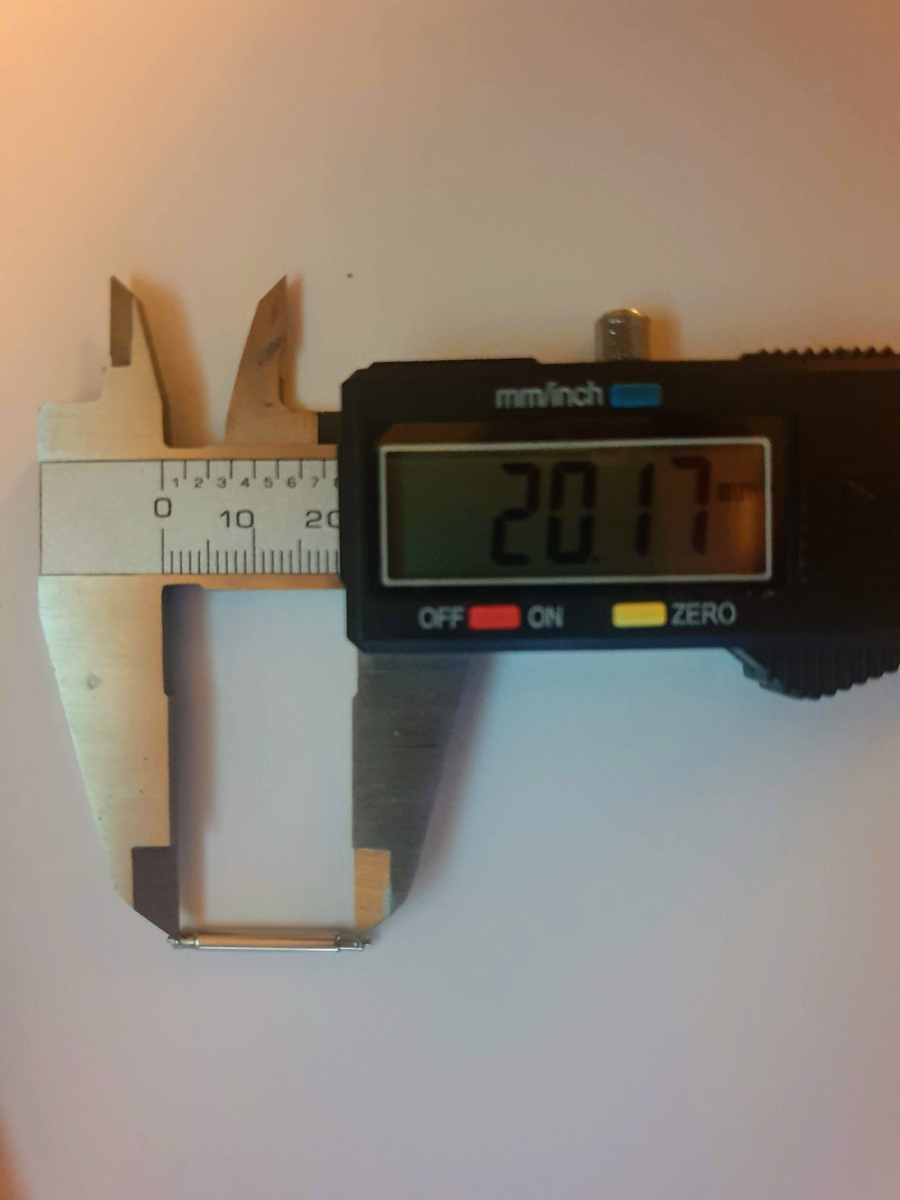

i have an irritating problem in the size of a pair of stuck springbars in a no-holes case. I procured some chunky ones in an effort to stop a 'clicking' sound when tightening the strap, but not only did these not solve the issue (which i think is actually due to thin tips, rather than a thin bar, which these still have), which seem to be annoyingly wide, and i just can't get a grip on the teeth.
See the attached photo showing the teeth to be outside 20mm...hence not really sure of the point of these teeth on 20mm wide lugs, which they were advertised as.
Bottom line, is a hacksaw my only option here? There must be a neater/cleverer/less violent way of removing the damn things ..?

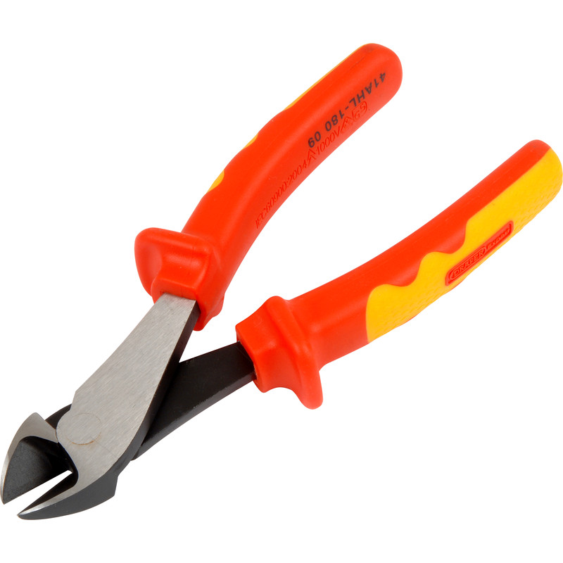

They are typically easy to remove with a pair of cutting dykes, but you have to sacrifice the strap (usually).

I can't understand this post. You seem to be measuring the distance between the flanges when not installed in the watch, which has nothing to do with removing them. The ends are spring-loaded, so the the distance between the flanges must be greater than 20mm when not installed, this allows them to be pushed flush against the inside of the lugs when installed. These shouldn't be any more difficult to remove than any other spring-bars IMO.

I use wire cutters like above (although I do have a small pair that work well too). You don’t have to sacrifice the strap all the time, if it has enough flex fo push it to the side, you may be able to get enough purchase to cut the tube without destroying the strap.
I have also had luck using a razor blade. Slide it down right against the lug until you make contact with the bar and make a prying motion towards the strap in effort to creep the bar out. Works most of the time...and when it doesn’t...out with the cutters!

I’ve got a good set of precise wire cutters from knippex that do an excellent job of both spring bars and twist-o-flex bracelets. In both cases if they don’t come off easily they get cut, its not worth leaving scratch marks on your watch to save a cheap spring bar or junk bracelet (the later I don’t even try to remove if they’re the expanding endlink type they’re too much of a liability and cause damage too easily).

Thank you all - wire cutters did the job. Not sure quite why i couldn't get any purchase on the flanges, but in any case, they're out, and off, and in the bin.
