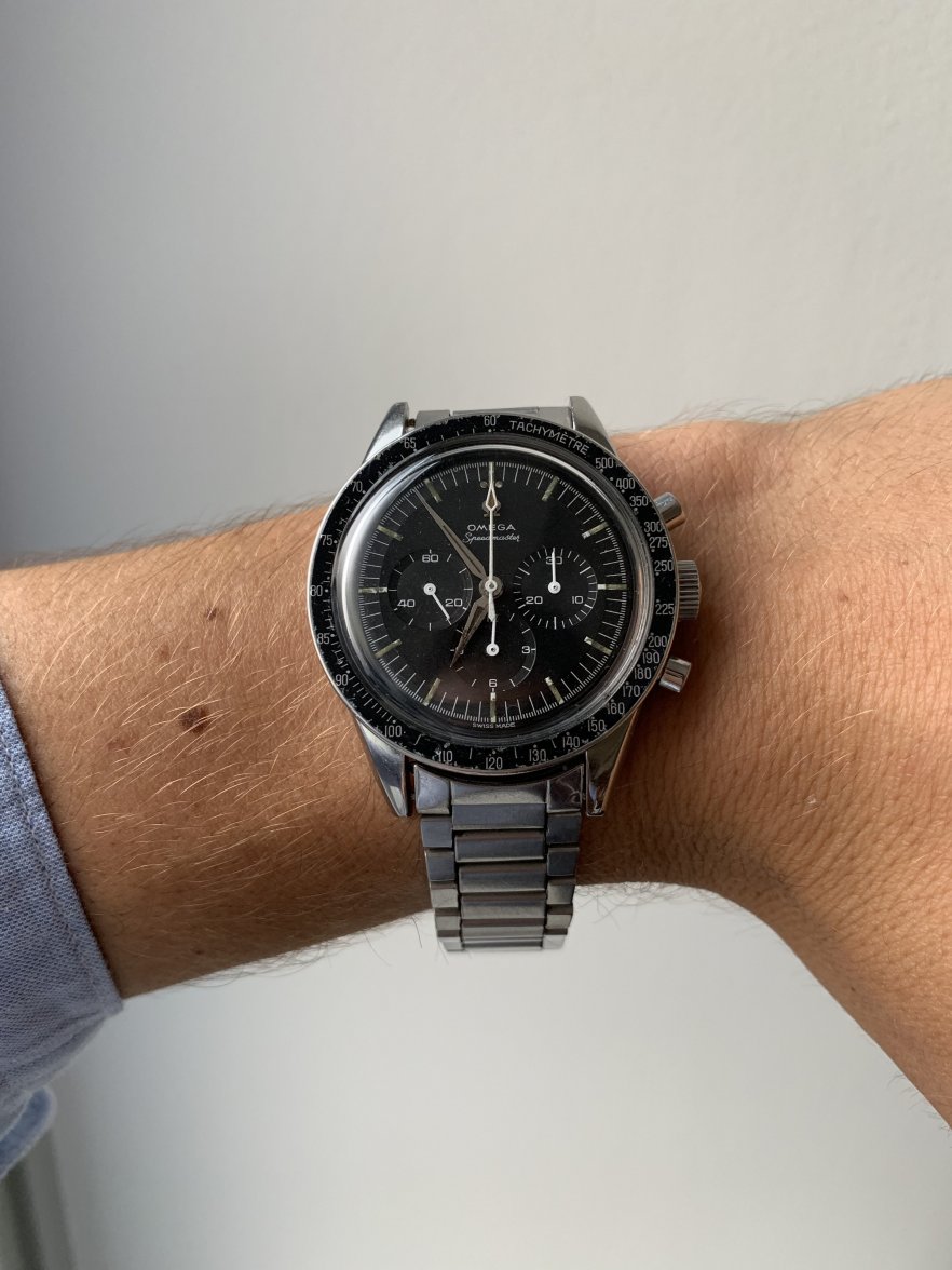

Dear Community,
first of all: wonderful to be a part of the community!
I recently purchased this CK2998-61 (as seen below) with all original parts (besides the No. 4 end links I think), but just can’t get used to the very fainted hours markers.
Compared to my crisp 145.012-67 SP it looks like it has lost its character.
What would you do in this case - relume or not?
I‘ve read earlier threads that some have had their Omega‘s relumed but with new paint.
I was told that there is a possibility to get it relumed with old tritium paint from back in the days, but couldn’t make someone out that offers the service.
Any tips concerning the matter would be highly appreciated!
Best J

@photo500 does a great job with relumes. Not sure if he uses tritium though. You'd have to ask. I think a relume may be justified here. Good luck!
783
458
I stand to be corrected, but I am not sure reluming with old tritium paint (if you can find someone who has any) makes any logical sense? The change in colour over time is after the tritium is exposed to air and humidity, which will not affect liquid tritium paint stored in a bottle.
You can certainly get it relumed with a tinted material to match aged tritium. Tricky one to ponder re. originality vs. aesthetics. For your watch given the lack of lume on the hands and the condition of the dial markers, I would lean towards a re-lume.
3

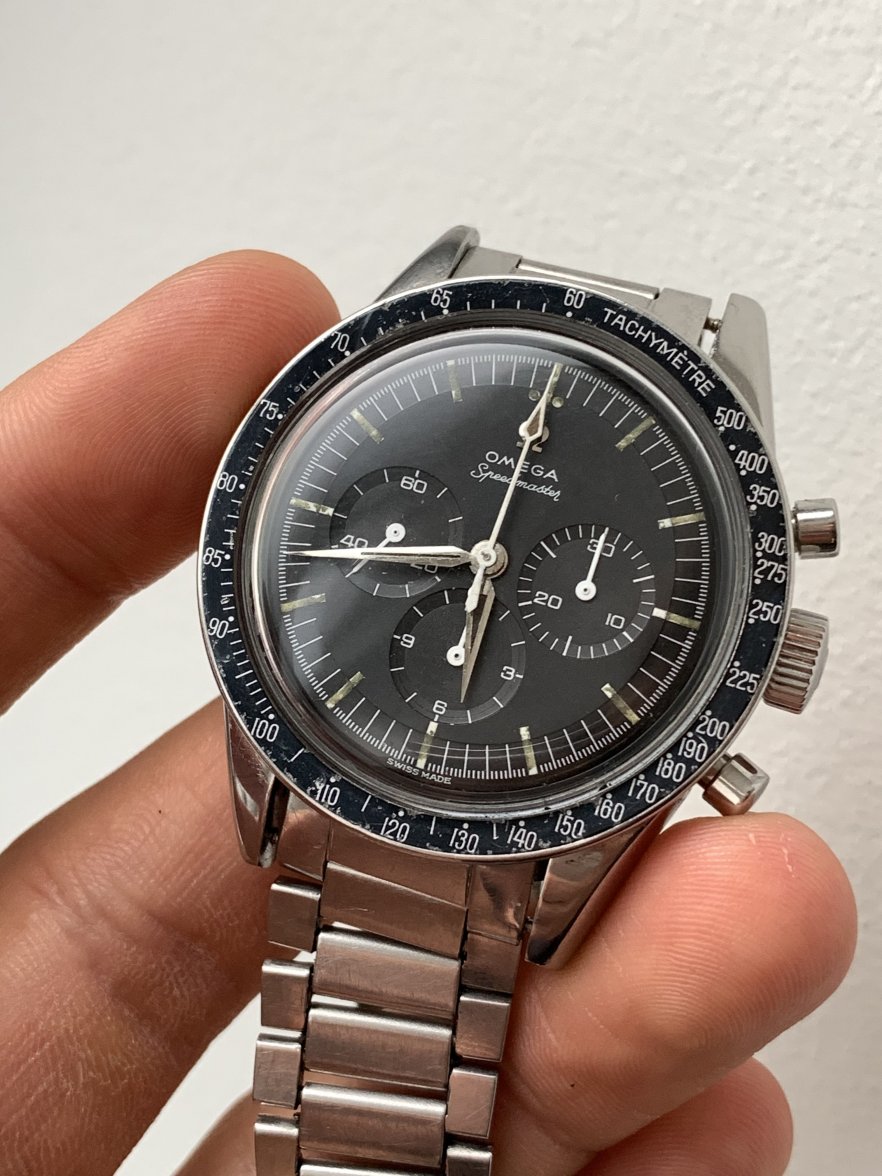

It’s a nice looking watch but I agree, the lume hasn’t aged well and this is a prime candidate for a relume.
You bracelet may also be the wrong size or have the wrong endlinks. There was a flatlink for the 18&19mm lugged watches as well (like my technical dialed seamaster and SM120). The correct endlinks (or bracelet) will get rid of the gap
you have. I’ve actually been on the hunt for the smaller flatlink bracelet like this, so if you can share the clasp and endlink numbers that would be helpful so I know what to hunt for.
