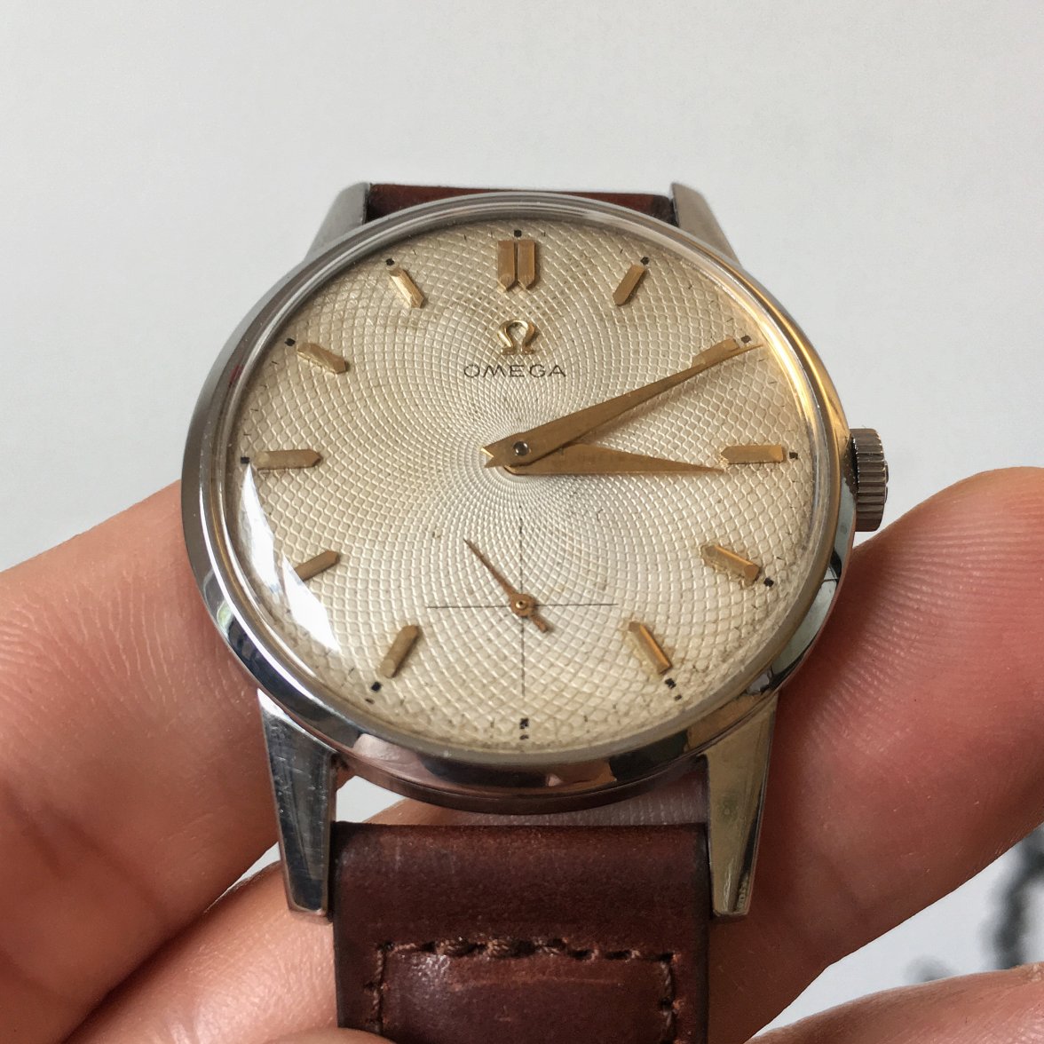

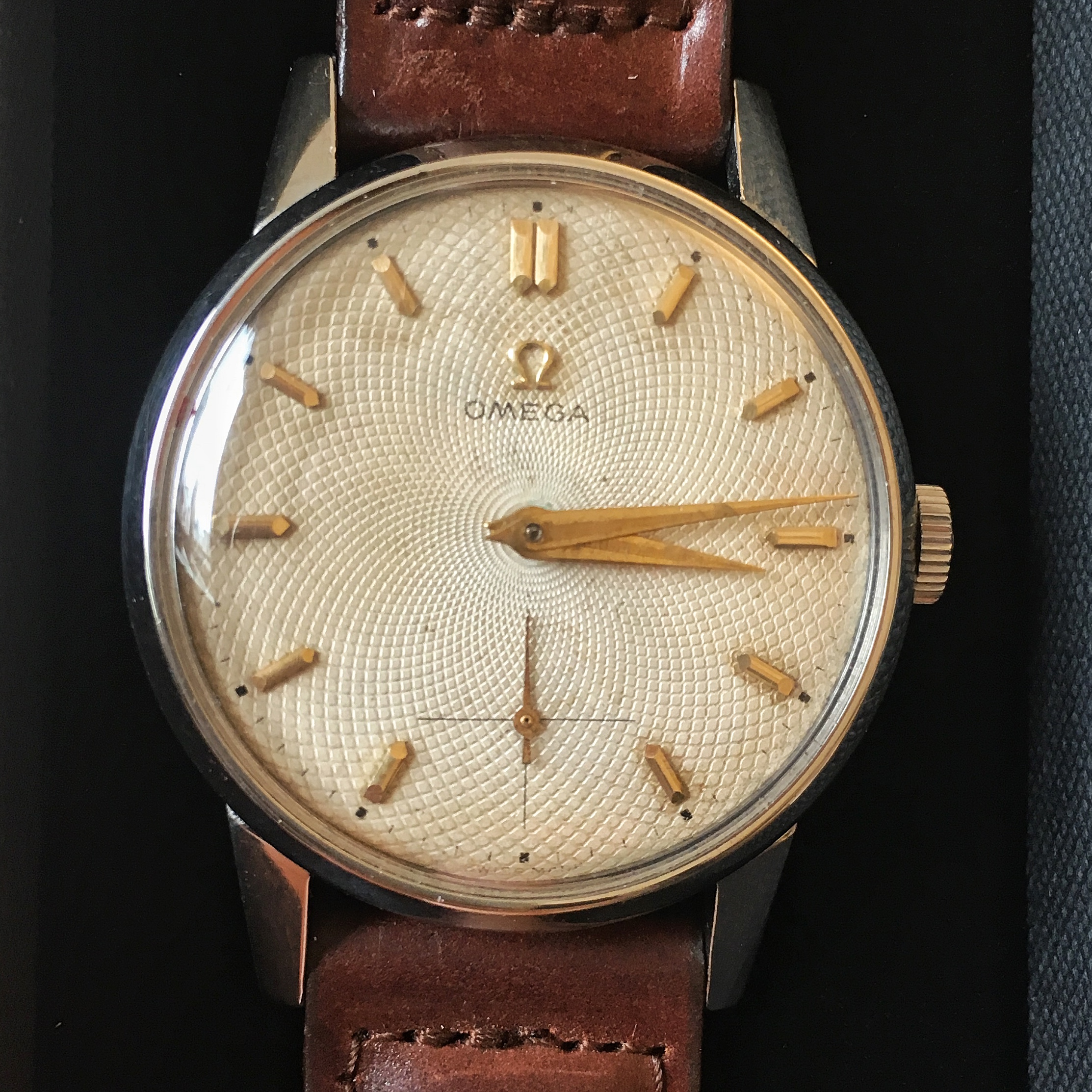

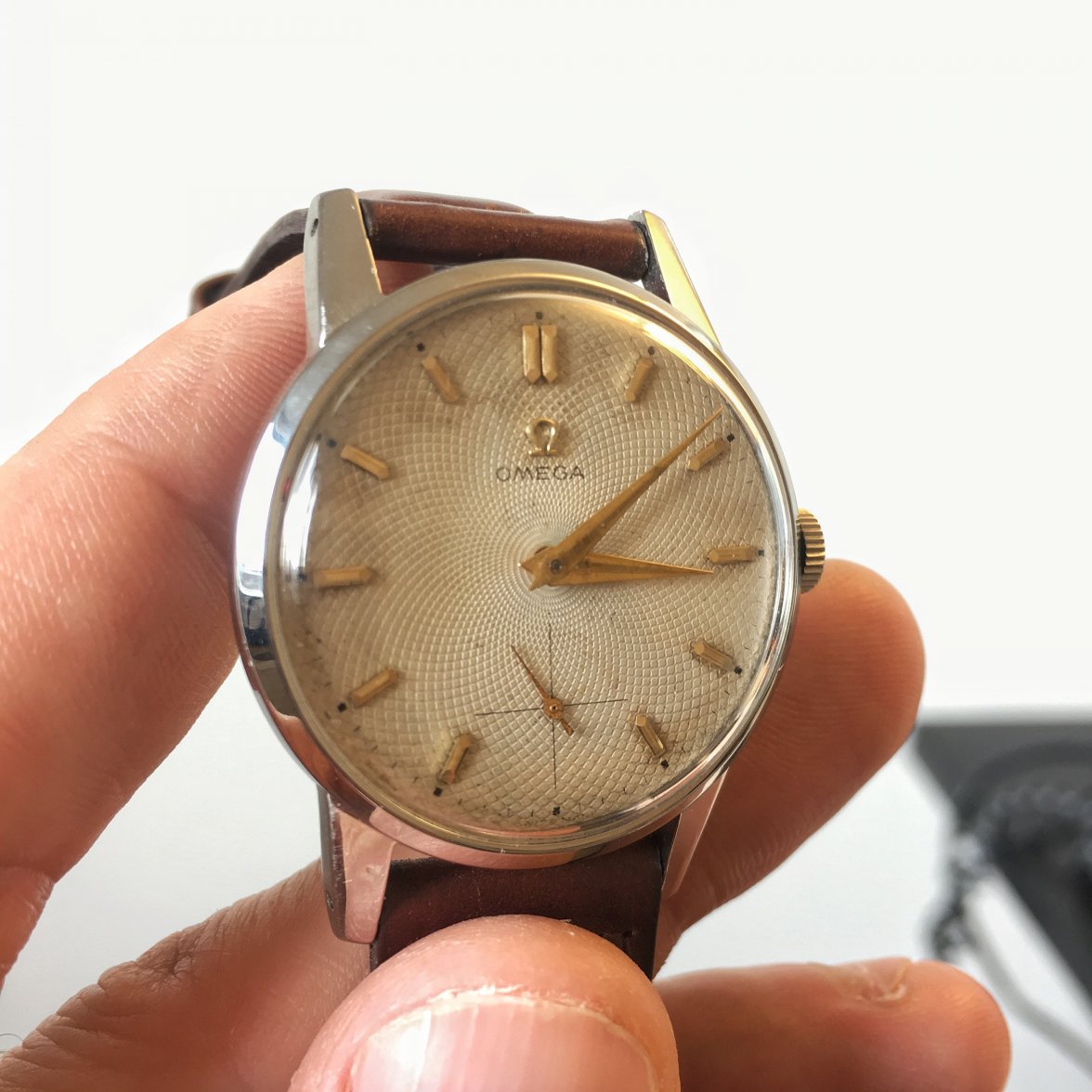

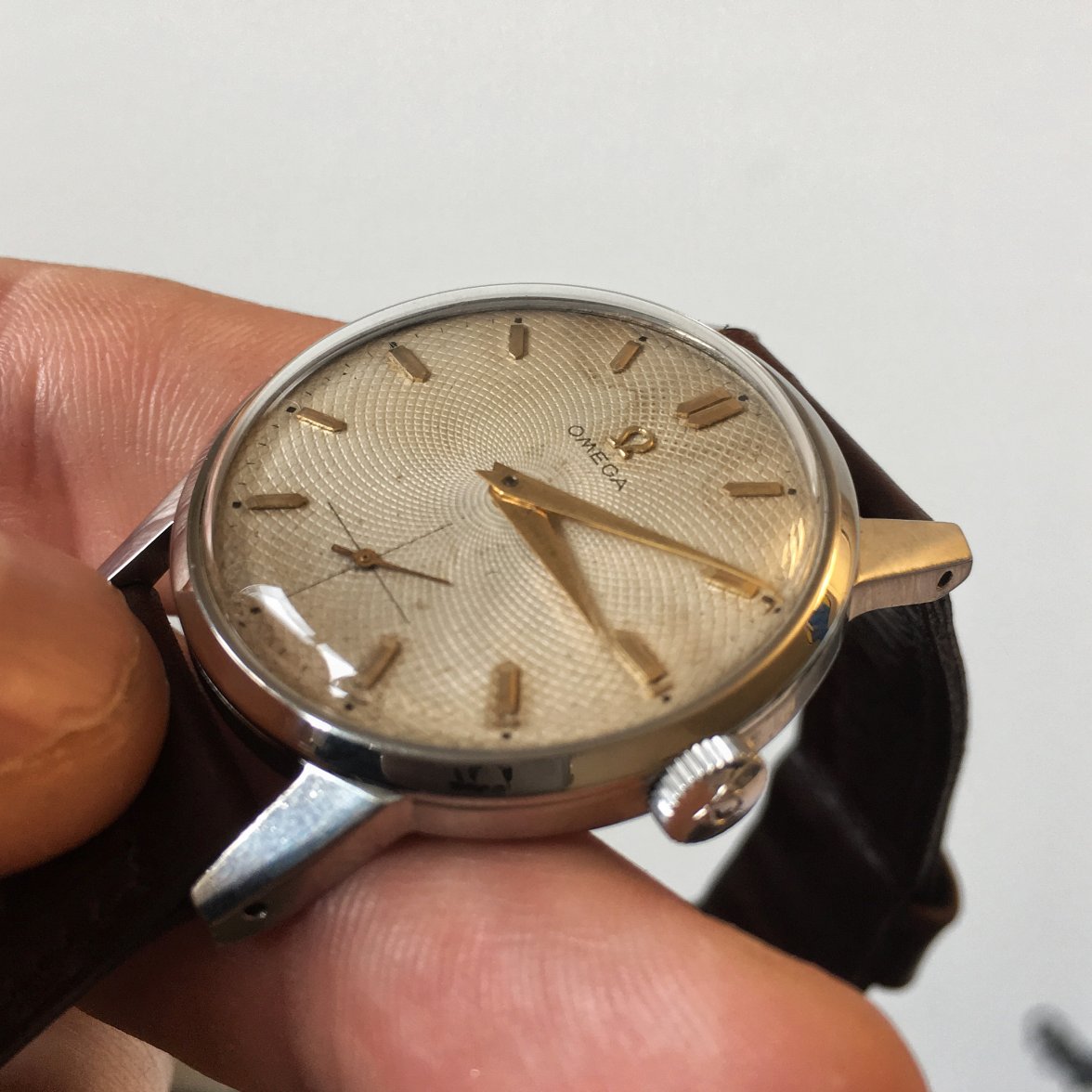

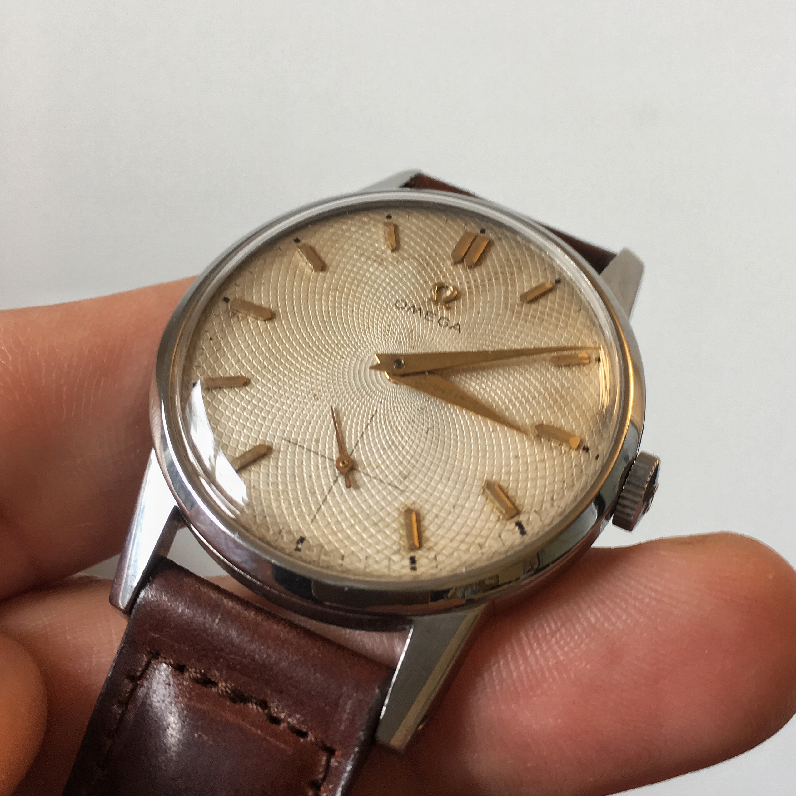

    Hey,
    wanted to share with you my recent eBay snap, a ref 2495-17 from 1950 that just arrived.
    I was a bit suspicious before because the pictures on the offer were not so good (texture of the dial was not visible) and feared it might be a re-dial. In particular because I did not find another model with black dots above the hour indicators. I was still bidding because it came from a professional seller With a right of withdrawal.
    Having it in hand now it looks all original and nicely patinated in my view. Any counter opinions?
    Does anyone know how the structure is called? It's like honeycomb with a twist. IMO it's beautiful
    Lugs look nice and sharp as well for a 1950 watch IMO.
    Another question: did the original acrylic glass for this model have an Omega logo etching? The glass of this watch does not have but I looked for the original replacement glass (must be 062PN1064) and this does not seem to have the logo as well ( https://m.ebay.co.uk/itm/Brand-New-...528795?hash=item283c6dec9b:g:qg4AAOSw4gNZid~lPurchases made through these links may earn this site a commission from the eBay Partner Network ) or this glass is not original as wel :cool:
    Best, Thomas

  2. isaacg Mar 28, 2018
    29
    64
    That texture on that dial is so beautiful and interesting. ::love::

  4. gatorcpa ΩF InvestiGator Staff Member Mar 28, 2018
    12,226
    15,767
    All new Omega crystals should have the logo. The picture in the listing it taken against a textured background which would make it tough to see the logo.
    BTW, I had Omega replace a crystal on a watch from 1949 which likely did not have the logo on the original. The new crystal had it.
    Hope this helps,
    gatorcpa
    turbo_muc likes this.
  5. turbo_muc Mar 28, 2018
    386
    1,511
    Thanks @gatorcpa - so I understand that the original crystals in the 1950ies did not have the logo - so you actually cannot know whether the vintage watch you buy has an original old crystal or a no name replacement, right :confused: you just know when it has been replaced with a new and original Omega crystal.

  9. gatorcpa ΩF InvestiGator Staff Member Mar 28, 2018
    12,226
    15,767
    Omega started using logo crystals in the 1940’s, but not on all models. They were phased in over time.
    Older crystals have a different logo. If you put them next to each other you can see the difference.

  11. ConElPueblo Mar 28, 2018
    9,590
    27,032
    Also, newer Omega replacement acrylic crystals will have a different profile than the originals... Everything else being equal, I'd rather have a crystal with the correct curvature and no logo than one with the logo and a wrong profile.

  13. Archer Omega Qualified Watchmaker Mar 29, 2018
    26,513
    65,770
    Newer logo...
    [​IMG]
    Older logo...
    [​IMG]
    Cheers, Al
