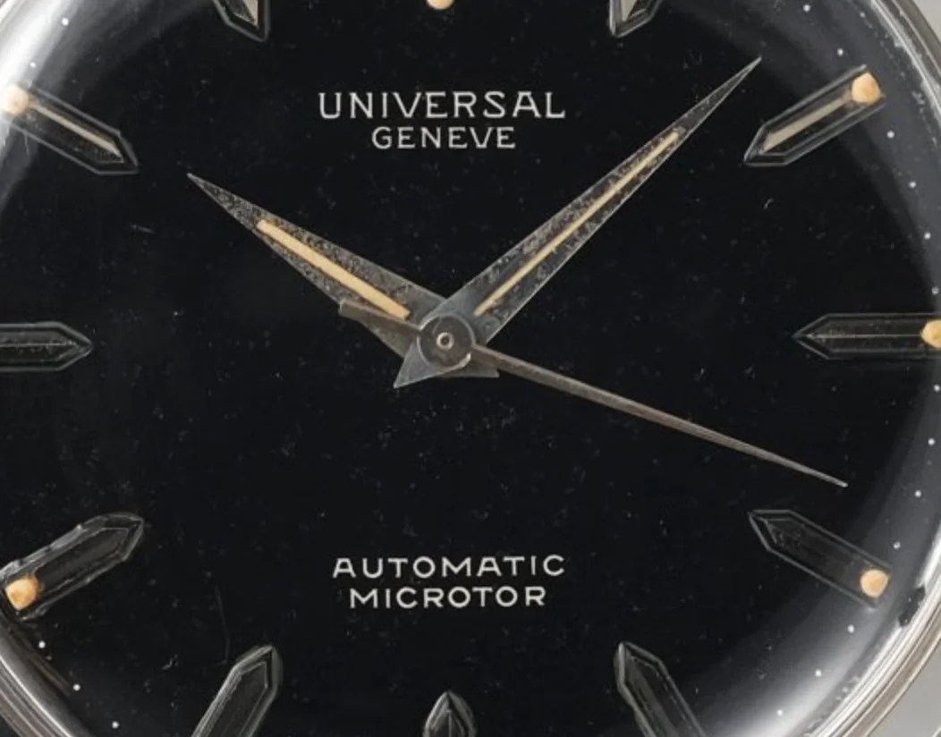

Redial Pre Polerouter 1958?
89
34

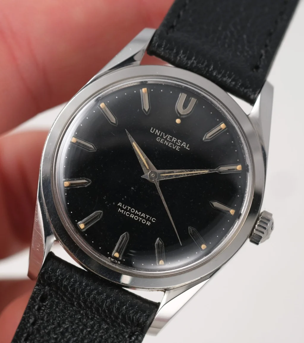

What do you think?
I'm not a big expert, but the lack of the è in ‘Genève’ raises a red flag. Additional internet searches turned up nothing - I couldn’t find this model anywhere..
Obviously redial and move on, or maybe ligit?
Thanks for your help!

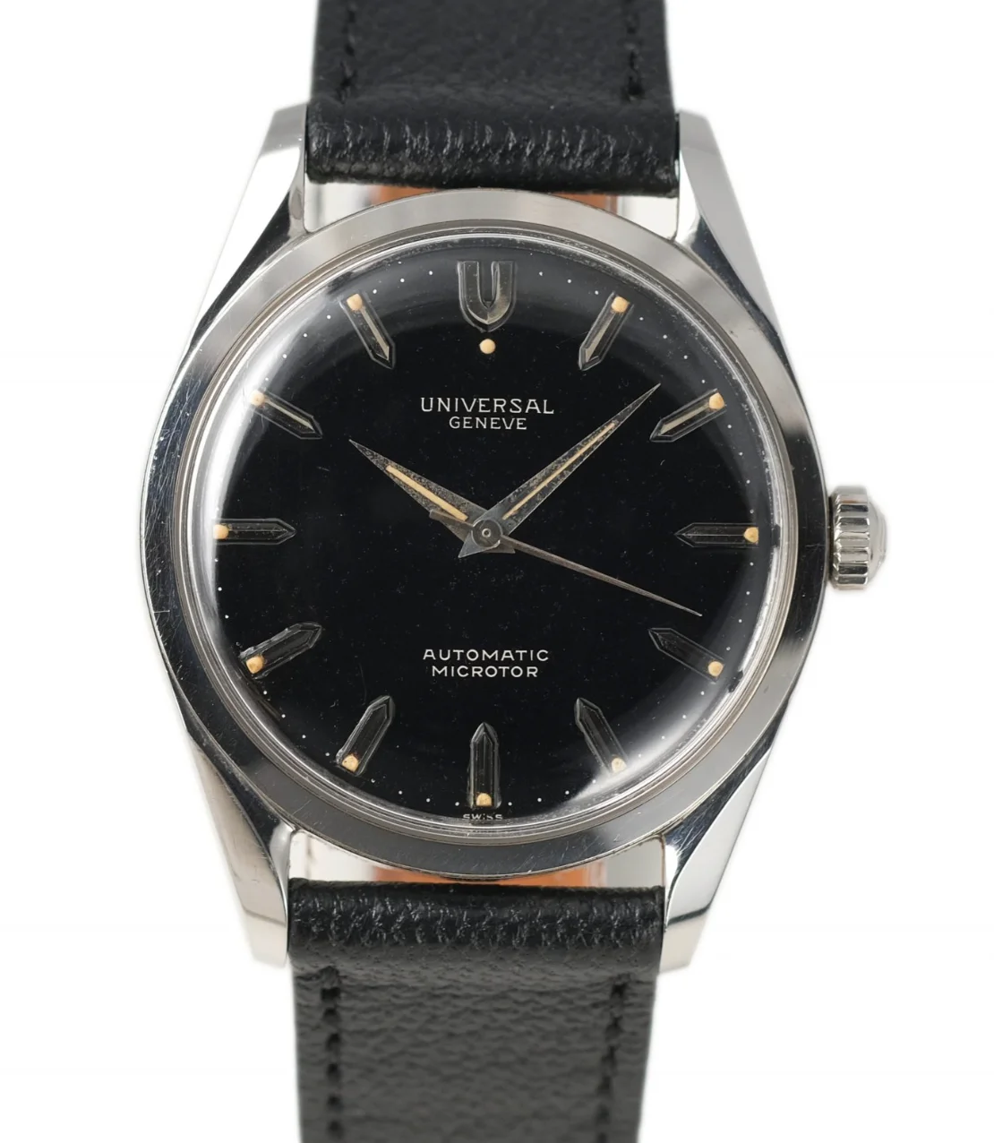

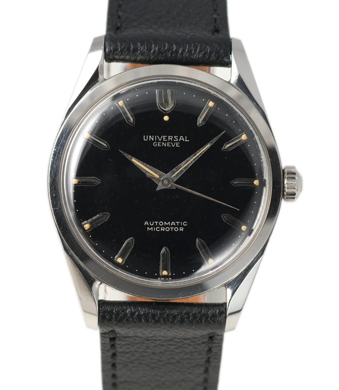

According to the listing:
Model: Pre Polerouter Micro Rotor
Reference: 20358-2
Year: 1957 /1959 (Serial number 198xxxx)
Dimensions: 34mm
Dial: Original black, unpainted in very good condition
Housing: Steel
Movement: Automatic
Caliber: UG 215
24,250
53,997

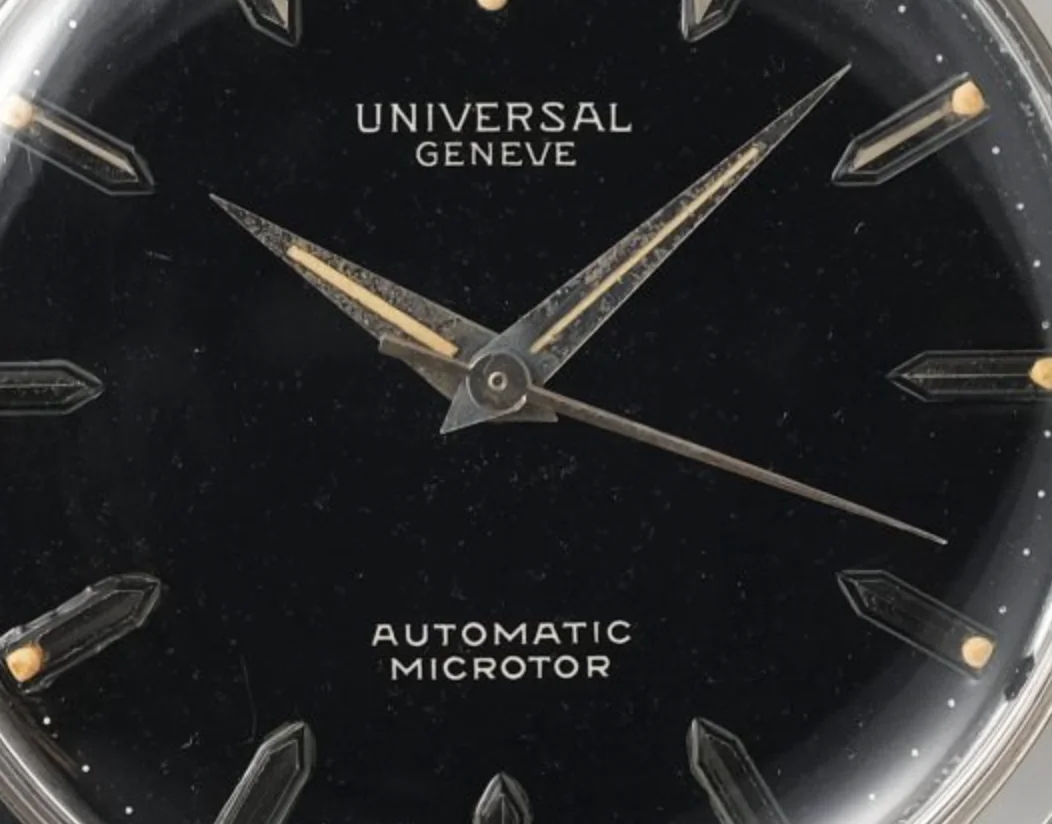

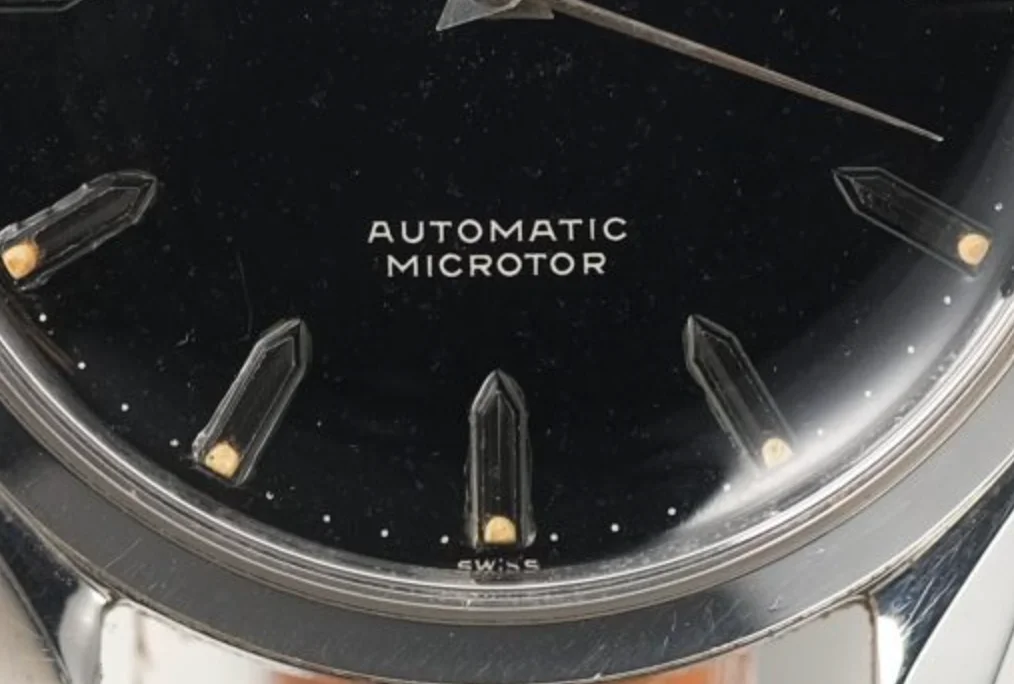

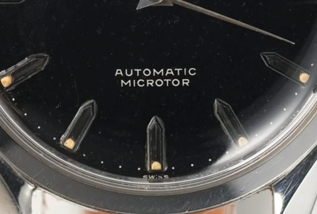

Not sure if it’s just bad lighting in the photos but it Looks like something weird going on with the paint around the markers.

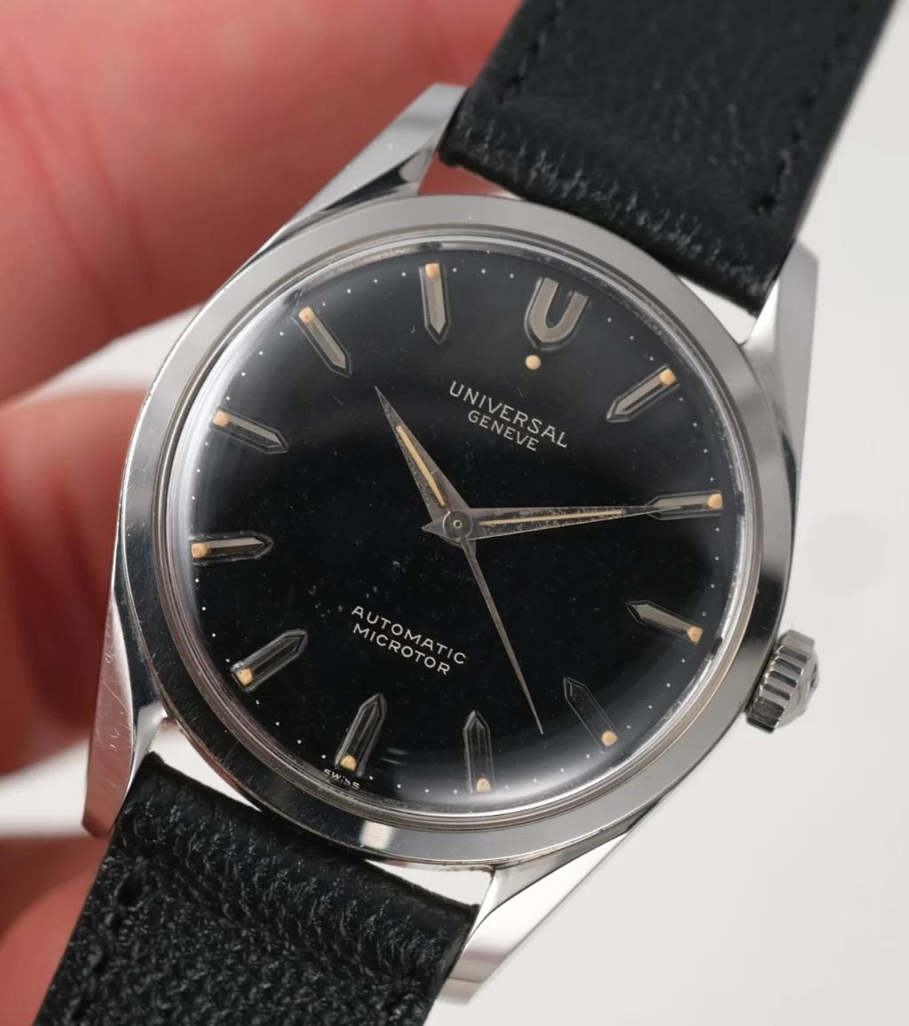

This watch and another near identical example sold very recently at auction in France. The catalogue also described it as a 'pre Polerouter', which made little sense given that the serial dates it to 1957-59.
It is a US market Polerouter Jet. The dial looks original to me.

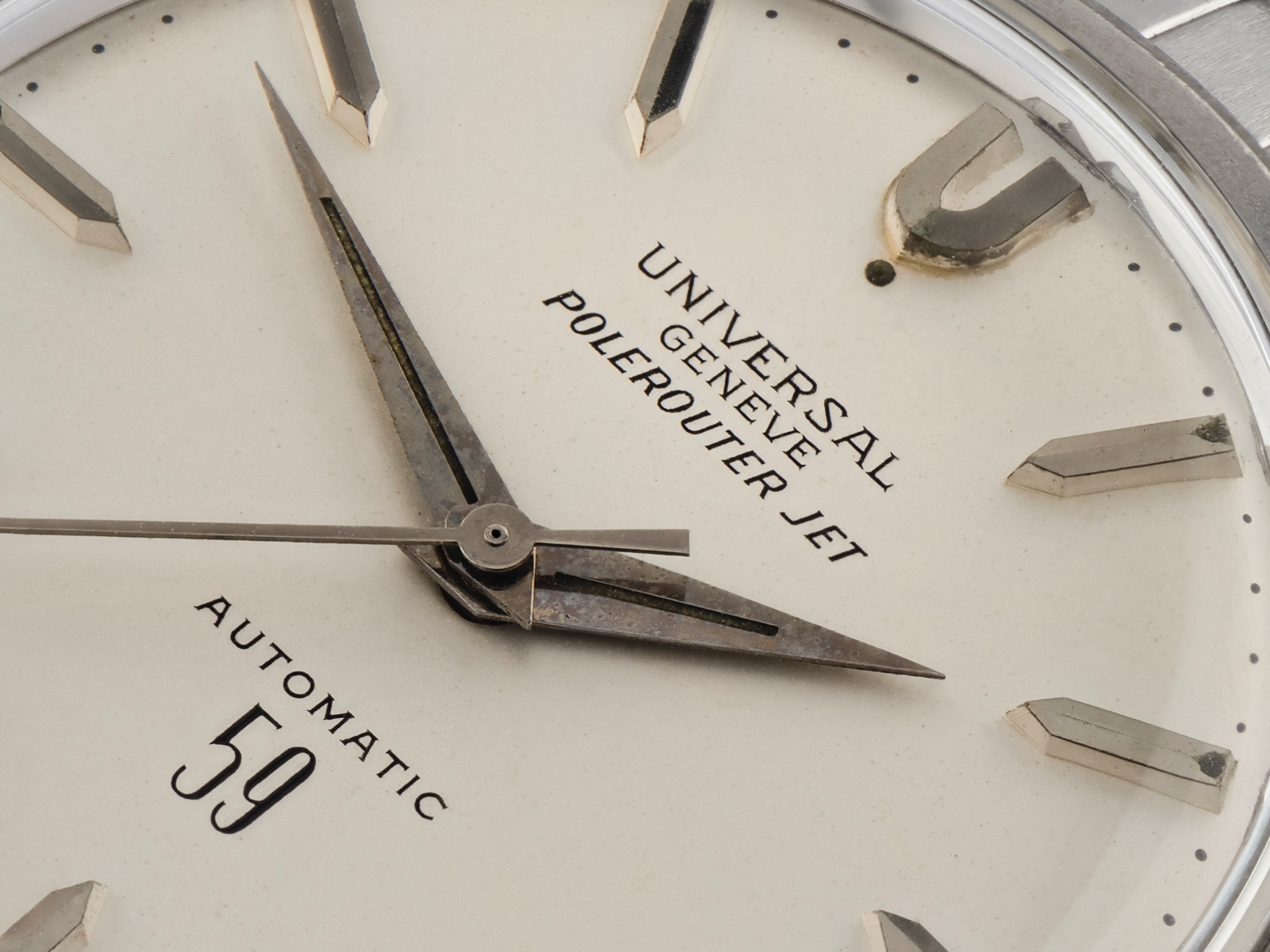

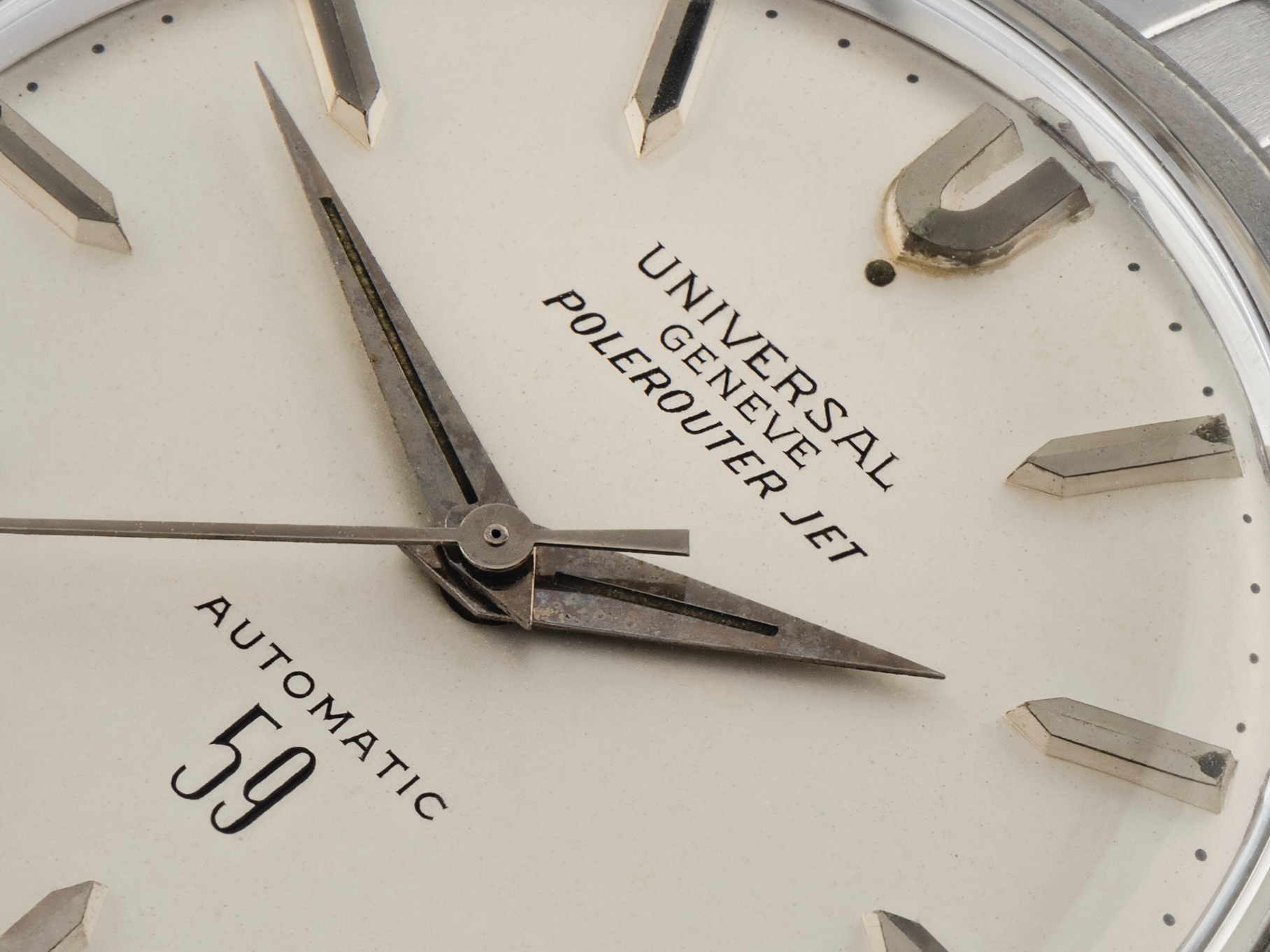

A 20358-1 (the OP watch is a 20358-2) features in the UG archives with a white dial and Polerouter Jet text.
A very similar US market reference, the 20361-1, is pictured below (courtesy of the Polerouter book).

Likely original, IMO. There were non-Polerouter microrotor automatics made.
I see, it’s an embossed dial. That’s why it looks strange in the photos.

References 20357 and 20360 are classic Polerouters with 215 movements
Pol(a)erouters were available from 1954
the informations from the seller (Pre-Polerouter) doesn't make sense IMO

Looks fine to me. Not a redial.

A couple of weeks ago I asked here whether this black-dial Universal Genève had a redial or an original dial. The consensus was that it’s original. Again, thank you.
At the time I walked away from the sale, but the watch stayed in the back of my mind. I just couldn't forget it. I really love dark/black dial watches, but unfortunately they only make up a small percentage of vintage pieces..
The dealer is asking 2,800 EUR. I also know he paid 1,040 EUR at auction for this piece...
If I pay 2,800 EUR for this watch, how bad is it? real bad? or still within a somewhat acceptable range given it’s a black dial UG?
Would really appreciate any honest opinions - am I being stupid here? maybe i just need someone to tell me i am stupid..

It is actually a Polerouter reference, albeit on this particular example it does not say Polerouter on the dial.
The posts above were flagging that the descriptions of this watch, used by the auction house and the seller, as a 'pre-Polerouter' were clearly wrong as this watch was produced several years after 1954, when the Polarouter was introduced.
