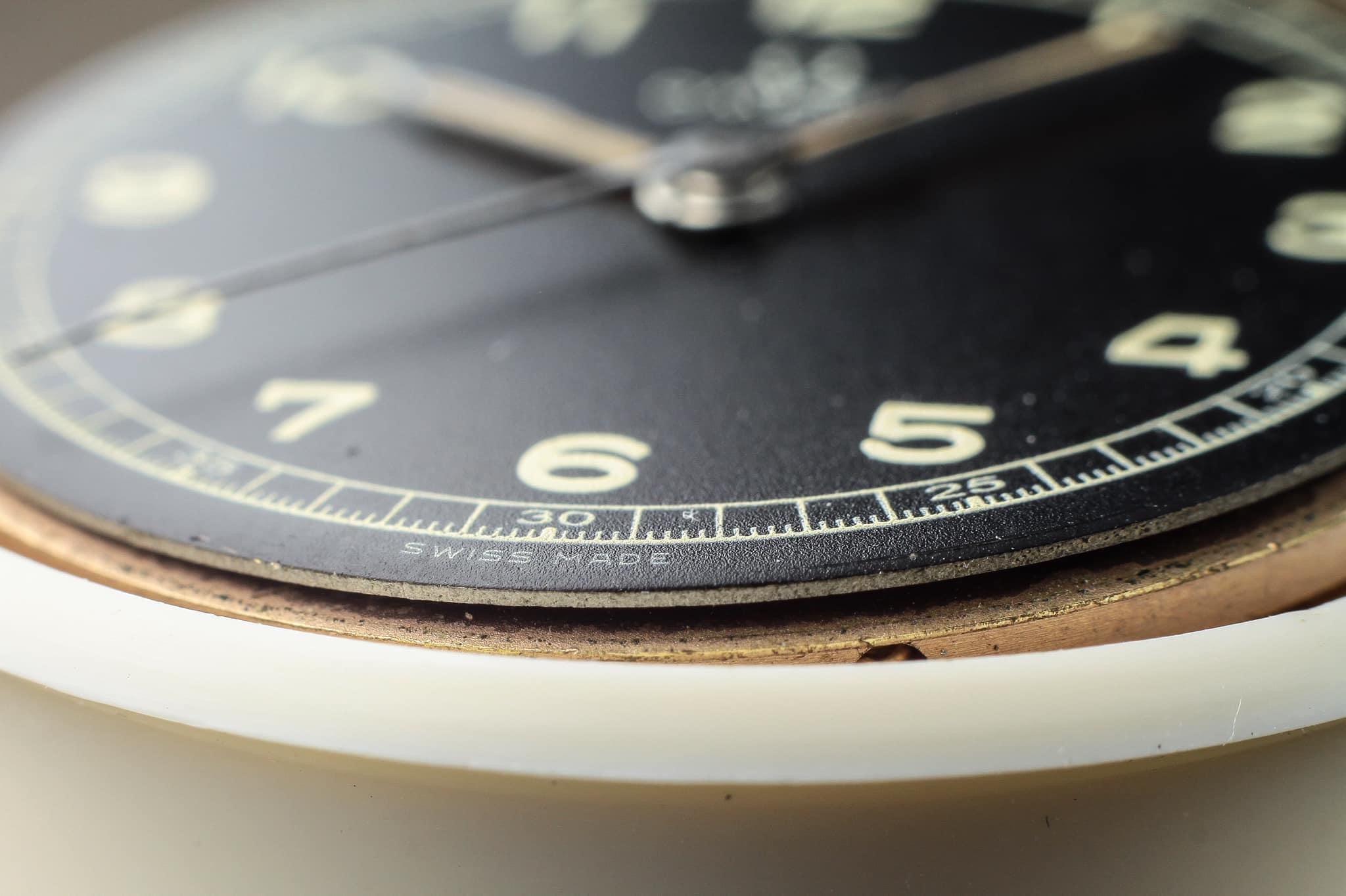

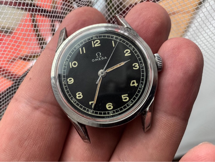

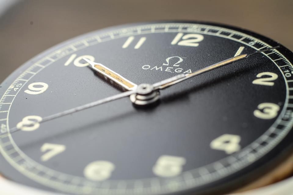

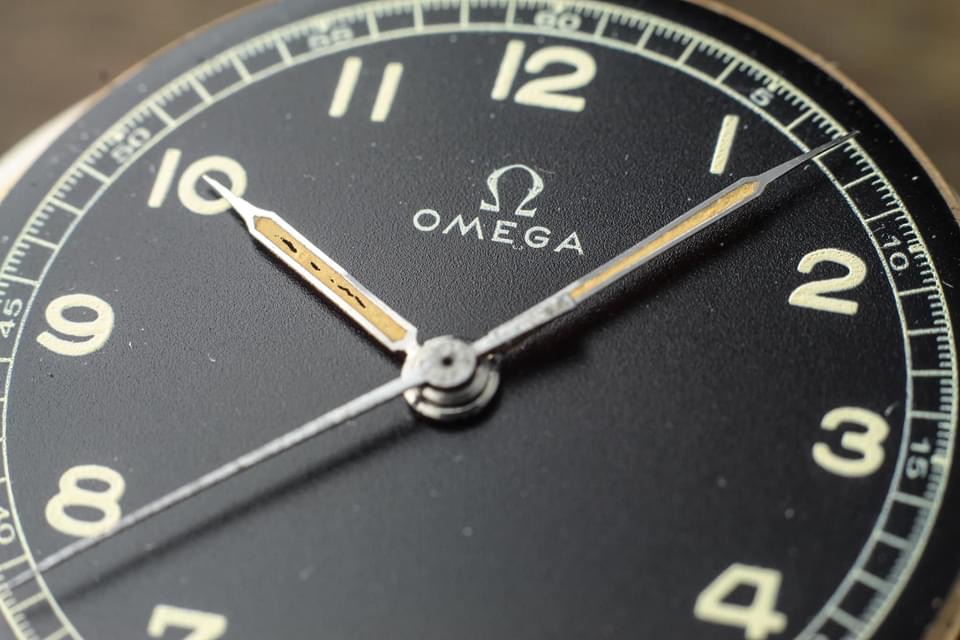

Redial or original?

It´s a redial in my opinion. And i don´t appreciate when this forum is used by people not reveal more information than just the initial given. I can, and will explain my thoughts if more information is given.

Had a laugh at the replies towards the top. I’m not an expert but I’ve seen a few of these and to me the numbering in the seconds ring looks off (3s & 4s especially). And more generally speaking, appropriately aged hands on a flawless dial screams redial/replacement dial to me. It is rather nicely done though.

Imma vote redial. That railroad seems to be a running theme in redials--it really wasn't all that common in watches from the period, but it seems nearly ubiquitous in retreads.
Also, even beyond the spotless condition of the dial, which is very suspicious on its own, why is there be lume on the batons and none at all on the dial numerals or elsewhere?
