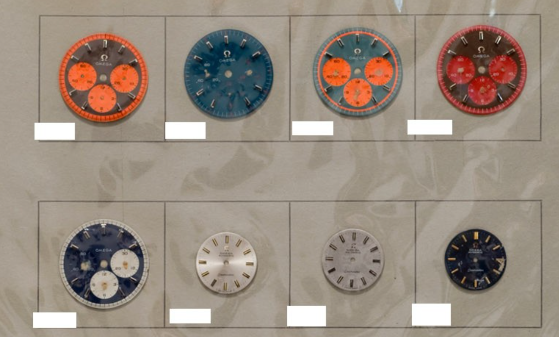

I was digging around references to singer test dials and came across this thread. I found it an interesting coincidence that both of these prototypes came up in auction together, with dials corresponding to a very small and specific sample from a singer test dial book:

These are test dials requested by Omega. They were contained in Singer books (I understand there were 3 books). I see nothing unusual in what the extract says which only confirms that the dial is a prototype, not the watch . A "test" dial requested from an external supplier is in fact a prototype dial.
The same thing happened with Rolex test dials by Singer and it doesn't seem like anyone cried foul.
That's something I'm a little unclear about from the Singer test dial history. My impression is that they may have been more about Singer making pitches about new dial options to watch brands they did business with, rather than commissioning of prototype dials by the brands directly?
