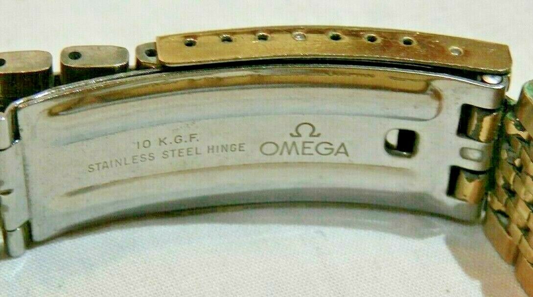

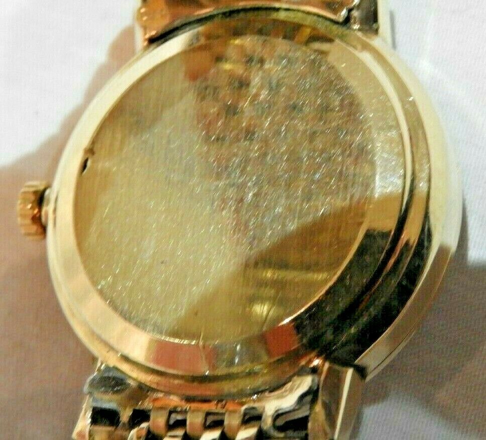

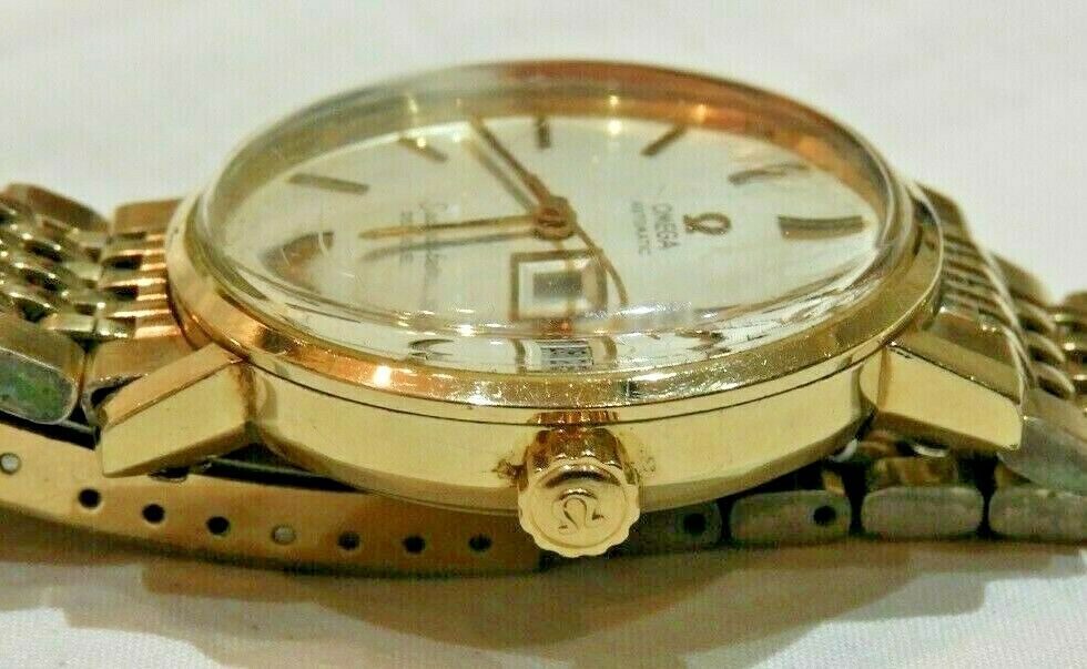

It says it's 10 KGF, here's some more pics.
10K Gold Filled, but it is only for the bracelet. Material for the case is written on the case
If you remove the bracelet, you should see14K gold written between the lugs. In your case, no need to remove the bracelet and check. This is a C6865 (solid gold). C6864 (gold-plated) is bicolor 😀
Most of the time on vintage Omegas, gold-capped and gold-plated ones have a stainless steel back. Solid gold ones have a solid gold back.
(I say most of the time and vintage because I do not know if there are exceptions and if it is still the case today)
