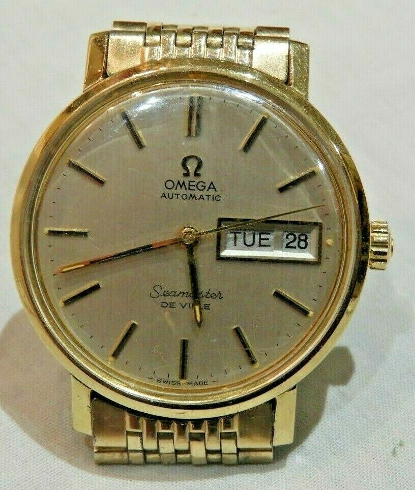

I have this 1970's Omega Seamaster Deville model 1020 (that's all I know) that just stopped working after I sent it to a watchmaker for repair. He was unable to repair it because he does not have access to Omega parts, this is his diagnostic: Erratic rate in different positions, indicator driving wheel cam (#1562) is plastic - replaced by metal cam in newer models, day corrector spring (#7526) appears to be short to engage day corrector wheel (#7524) properly.
Can anyone recommend someone who can have access to Omega parts and is able to repair it? I'm located in South Carolina but can send anywhere. I would like to avoid sending it to Omega unless there's no other option.

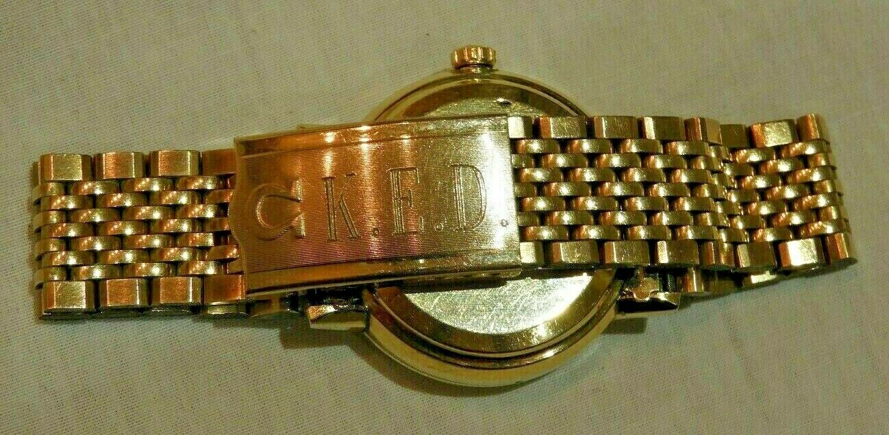

Based on €-$ conversion an Omega service would cost a bit less (~720$) assuming it is solid gold (it looks like a C6864 / C6865, so solid gold or gold-capped, the pic is too "frontal" to tell).
It says it's 10 KGF, here's some more pics.
