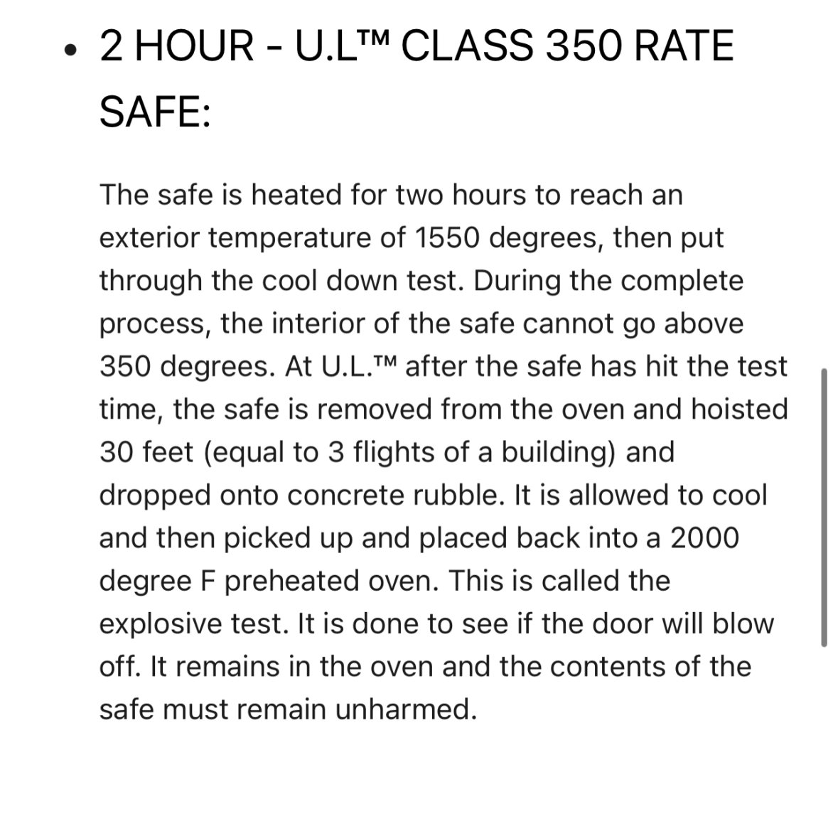

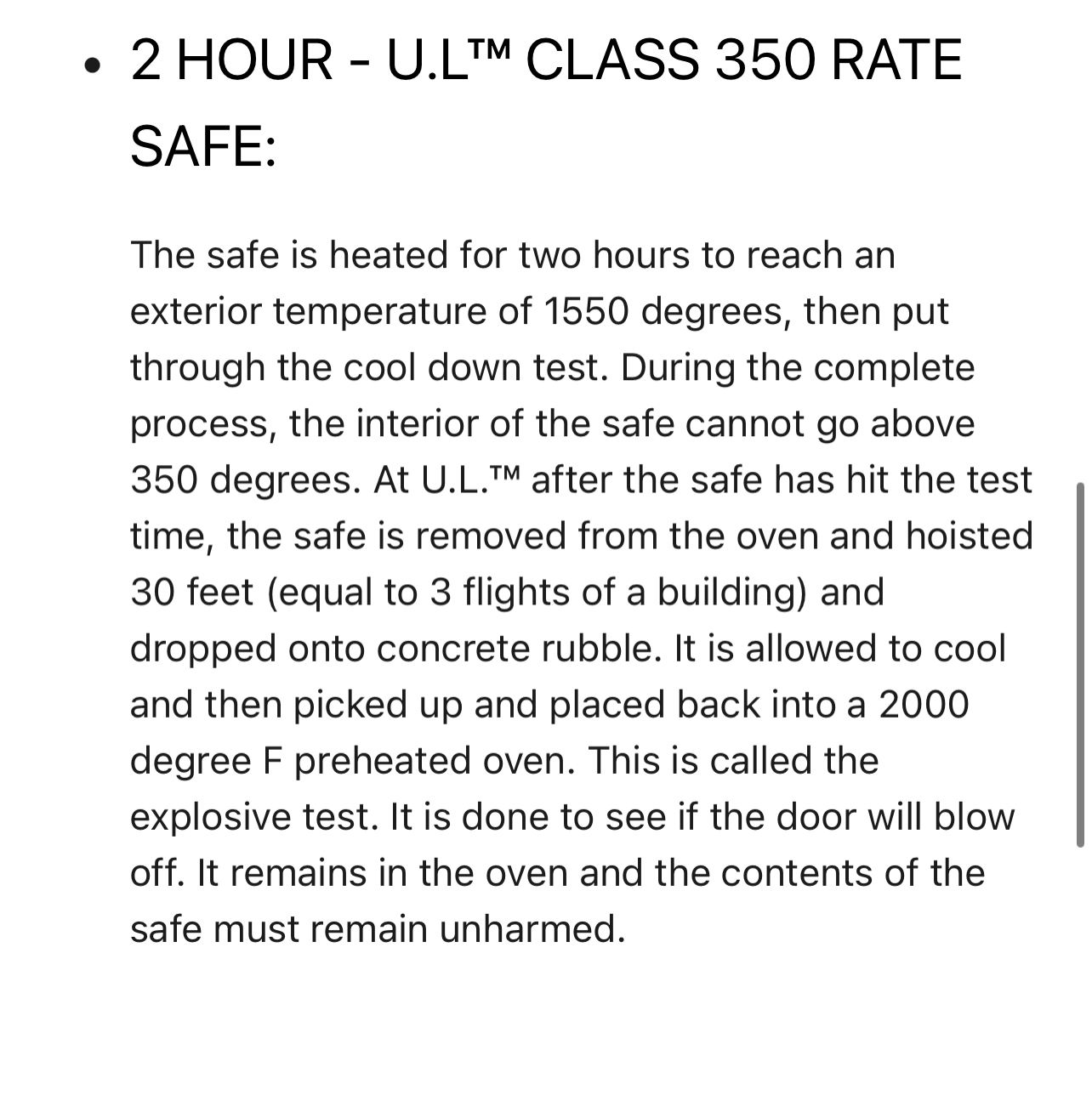

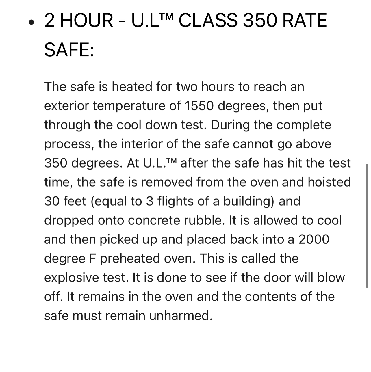

From what I was reading most safes are rated for 350-deg F
generally *fire* safes (different from other safes) have ratings that use a metric of staying below 350° (As a standard) for less than certain amounts of time (as the variable): eg, there 1/2hr 350° safes, 1hr 350° safes, etc.
Here’s an example of the 2hr 350° test:
So no doubt, with a 1/2hr 350° safe, a hot enough fire that burns long enough and burns the house to the ground will probably succeed in destroying safe contents
but the hope is that for other scenarios, like a fire that starts and burns an adjacent room, or is being put out by firefighters in short order, might still preserve the contents

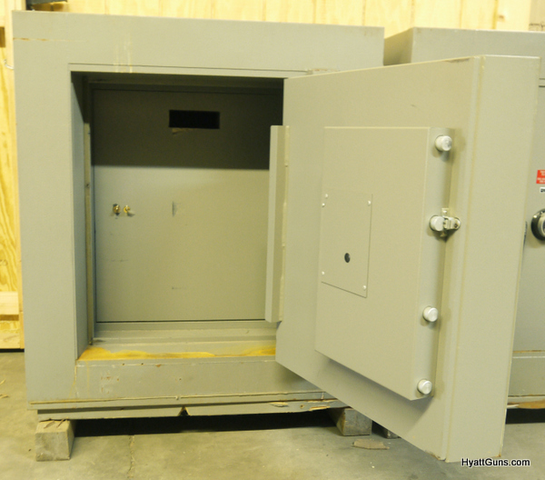

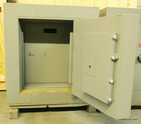

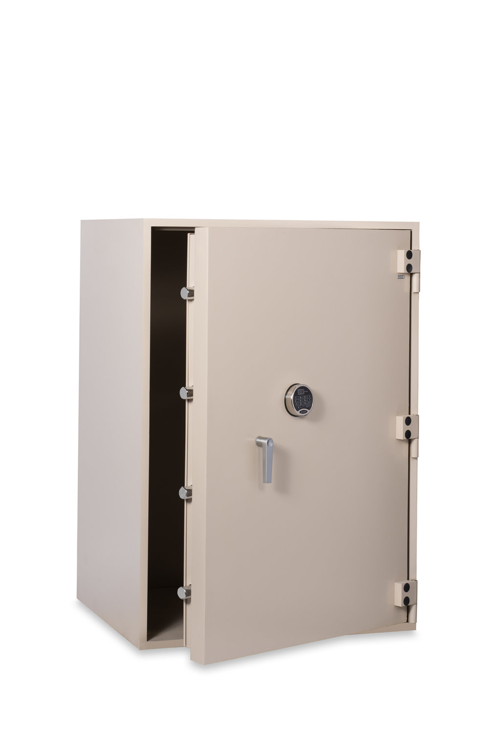

Here’s what one might expect a TL-30 to look like, noting both the depth and construction of the door thickness vs the walls, but also the interior space provided (given the thinness of the other 5 walls):
Safes such as the TL-30 sized above may cost $2,000-$6,000 new for such a high door rating, weigh 1,400 pounds, and provide relatively ample interior space (compared to the safe’s overall volume) with the outside dimensions of the above safe being 38 x 38 x 33½ but and with the inside dimensions being 36 x 36 x 26

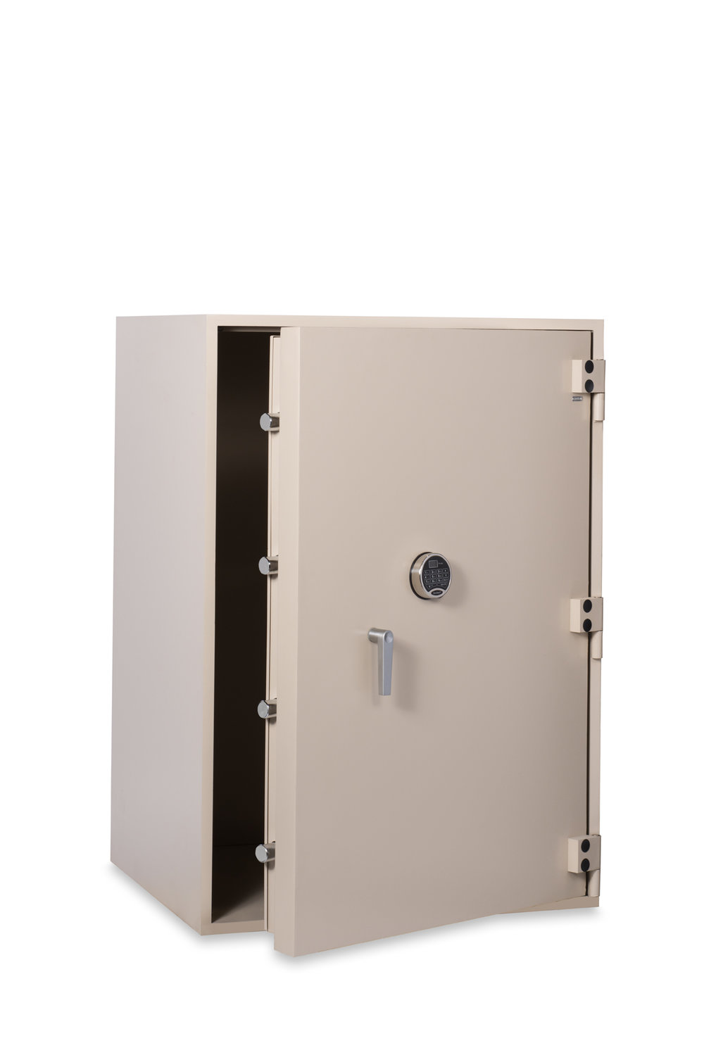

In contrast, here’s a comparably sized but more “commercial”/“industrial” rated “TL-30x6” safe, intended to provide security on all 6 sides, which new may cost upwards of $15,000 and weigh 5,000 pounds, with the outside dimensions of this safe at 38W x 35D x 41H, with the inside dimensions being 27W x 16 1/2D x 30H
Both of above stand in contrast to almost everything sold at sporting goods stores, which technically aren’t safes but instead “residential security cabinets” - those things, the 5 non door sides can be popped open like a tuna can with any sawzall
Which is all to say: almost any safe a person would consider (or afford) for home, no matter how heavy, is intended to be installed to disallow access (even brute force access) to anything but the front door.

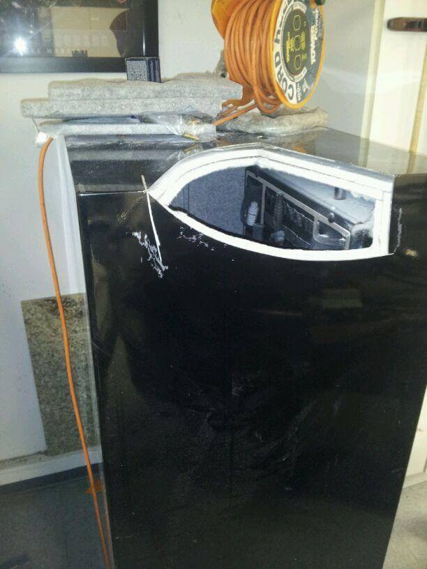

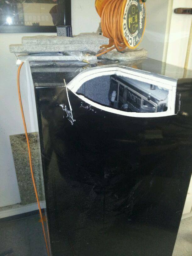

Which is a mistake made by the guy in the video we’ve been discussing - the thieves just took a torch to the top side
