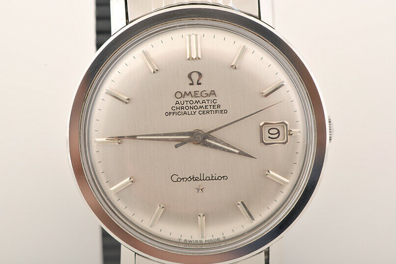

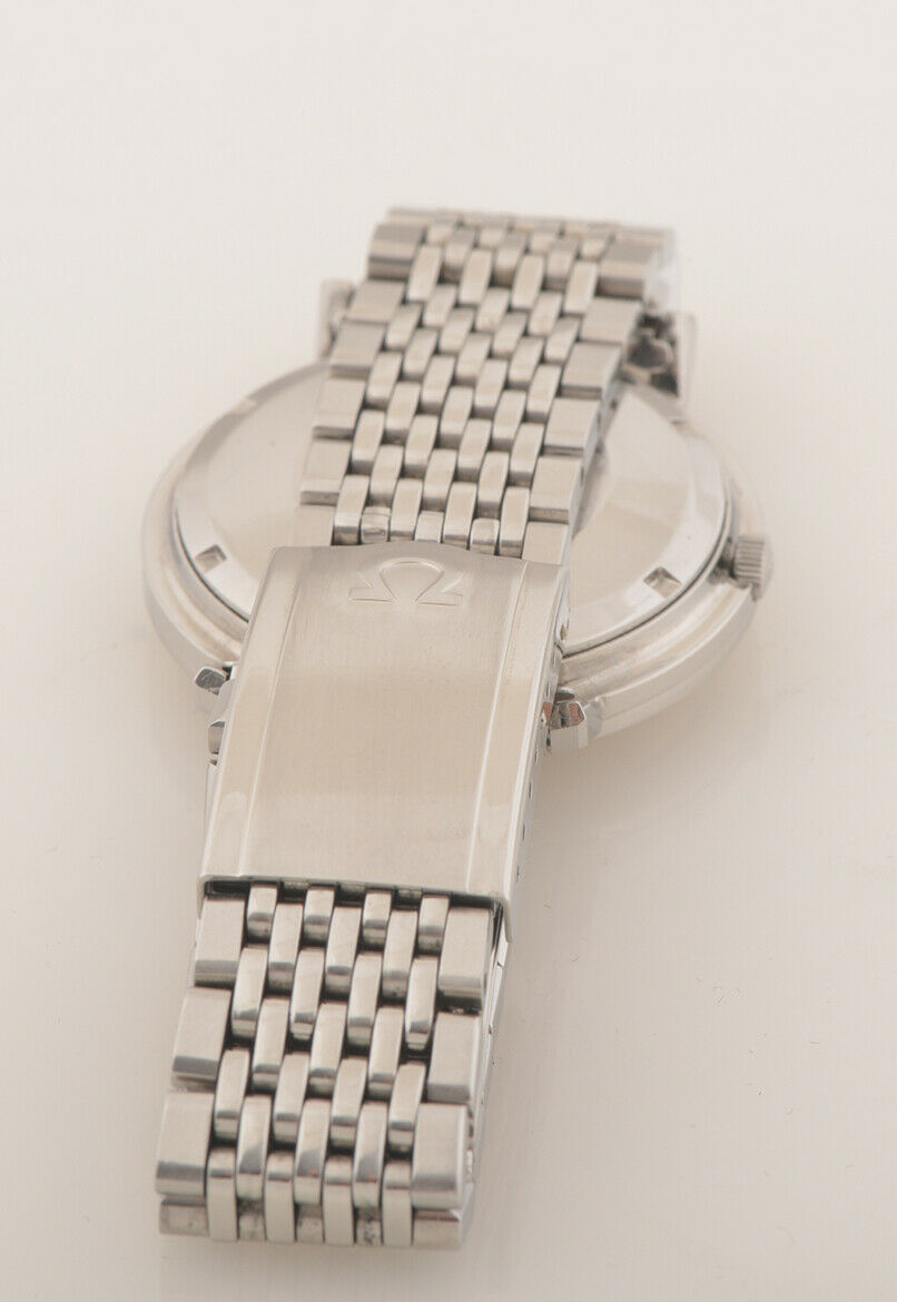

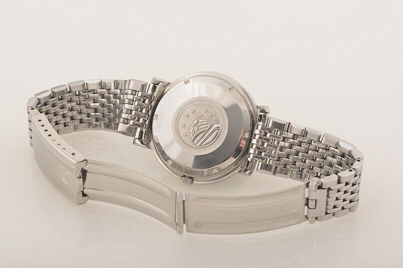

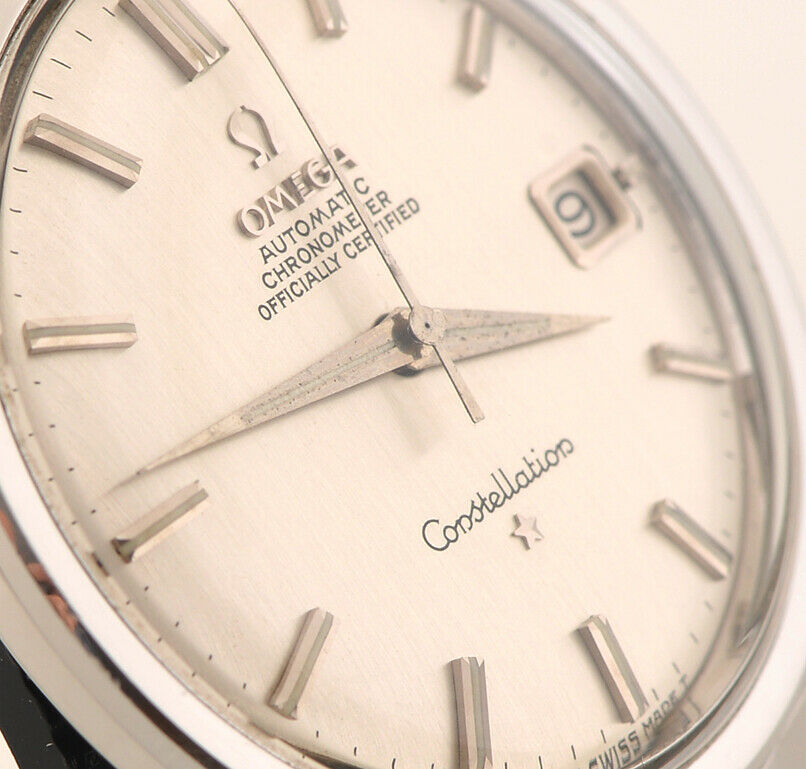

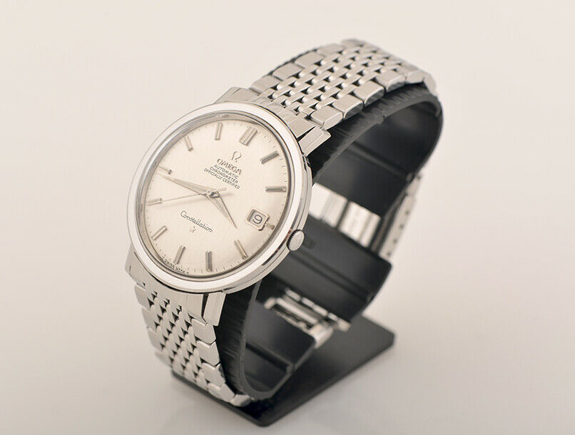

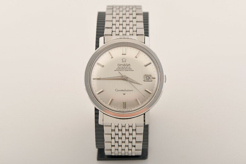

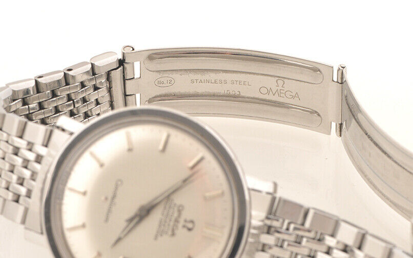

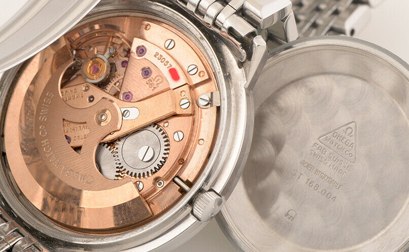

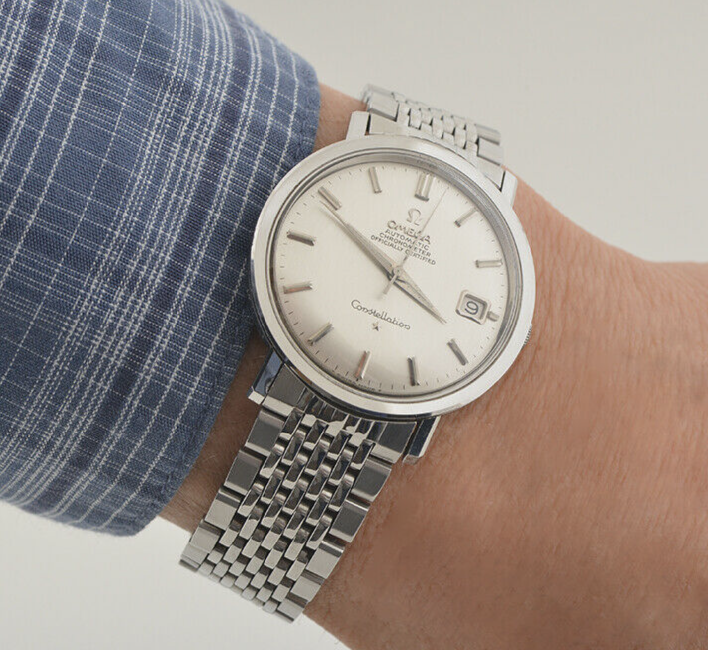

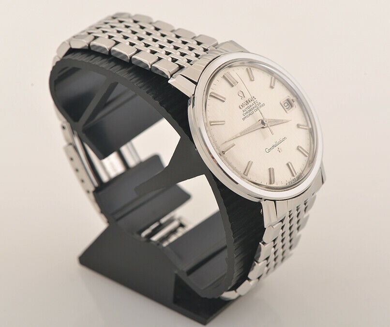

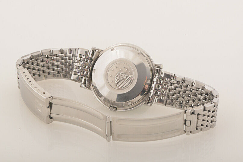

Ok, sorry for the delay. The photos are below. Here are the details: 1966 168.004/caliber 561 on an Omega 1503 BOR.
Seller represents that the watch is all original, one owner who took very good care of it, that the dial is NOT refinished/repainted, and the case may have been polished - but he doesn't think so. Owner had the watch serviced every 5-6 years, most recently last year. Thoughts on conditon and price? I'm generally not a straight lug fan, but I have to admit that this one caught my eye.

Good morning @gbesq
The pictures are a little grainy/over-exposed but I think we can see enough to say that this is a nice watch.
The case looks good with the lugs retaining their facets and the bezel still looks well formed.
The medallion is very nice and the later 'brickwork' version which ties in nicely with the date range for the movt.
The movement looks nice and clean and there is no sign of rotor rub, either on the rotor or case back.
The dome dial is correct and very clean with the 'full-index' style lume.
Correct hidden crown.
BOR bracelet is a nice bonus.
I think I'd happily add this watch to my small collection.
A couple of minor points:
the hands have got some pitting on them.
(note: the lume often appears a different, lighter, colour in the hands and I don't think it has been replaced, in case anyone is wondering)
I'm surprised that there is detritus around the bezel/crystal junction if it was serviced just last year and there are no service marks in the case back, if it has been serviced every 5 years - so unless the seller has proof perhaps take those statements with a pinch of salt.
I'm not sure if the case back has a gasket fitted (there is a grey line around the edge, which may be a gasket but the gaskets are usually black and more prominent)
So, value?
First, I'd want better pics to make sure the lug facets are all they seem to be.
Second I'd want proof of service.
As I mentioned previously, these watches don't bring the same price as a dogleg or lyre lug and dome dials less than pie-pans but they are (unfortunately) rising in price
It's a bit difficult talking £s-v-$s at the moment as the pound is so strong, so I'll guesstimate and base my comments on a more sensible assumed exchange rate.
I would say that for this watch, unserviced but including the BOR, $1500 (£1200) would be a good result for the seller as a private sale.
If it a dealer / retail sale it would of course be more.
If the service is proven, then you could adjust your valuation accordingly.
However, if you like the watch and it speaks to you, I wouldn't lose it for the sake of a couple of hundred $s
hope that helps

And I've said it before, those skinny dog leg connies are blown away by the 168.004 regarding wrist presence. .. : )
6,830
10,500
as the wrist shot of this watch shows - admirably
