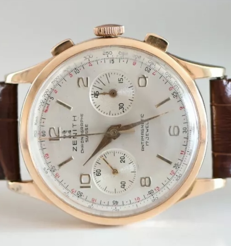

This one would be an interesting test of the authenticity program. If an uneducated authenticator sees Zenith on the dial and bridge, and they pass it through- then you receive it and claim it’s a fake (to which we know the answer), do you have recourse- is the authenticators “ruling” final?

I just looked at the sellers other items. A lot of watches, including other Zenith chronos, with prices starting at 2K+ so they obviously know this piece is fake.

Yes, it's a Landeron 48. What an awful obvious fake. Interesting that eBay flagged it for authentication. Maybe just based on the fact that it's gold and a "Zenith"?
Potential shill bidding too.

Could you or anyone else please elaborate on how you can so quickly determine this is a fake and the movement and any other markers that send up the “red flags” ....I’m trying to educate myself more on how to spot these. One of the reasons I’m so happy I joined this forum is the amazing amount of Information you all are able to impart. Thanks 😀

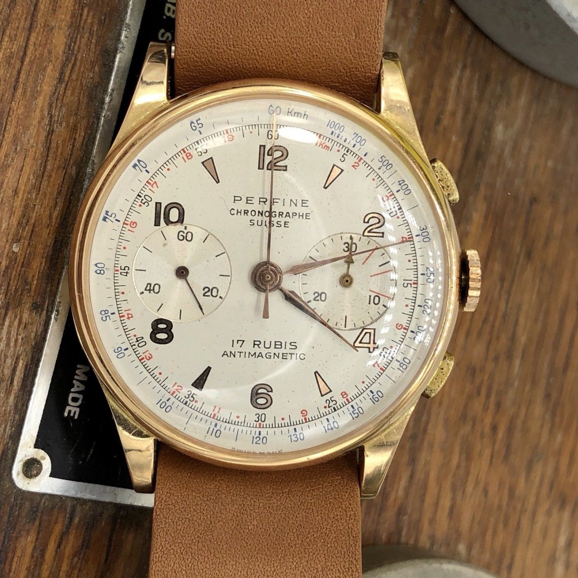

It's a common Chronographe Suisse with "ZENITH" printed on the dial. Nothing to do with Zenith, they never made chronographs like this. The Zenith signed bridge on the Landeron 48 movement (not used by Zenith) has been transplanted and is the wrong color. Zenith logo much more modern than the movement, which is not shock-protected. I could go on ...
Spend a few years looking at tens of thousands of vintage watches and it will be obvious to you also. 👍

Like Dan said, there are some key markers to look for that come with exposure. Chronographs like this were very popular in the late 40’s-early 50’s. Landeron based Chronos were incredibly popular because they were inexpensive and fairly robust. What they lacked in engineering elegance, they made up for in durability and price (I have a couple). It was common practice for a designer or brand to buy stock parts and assemble watches for mass consumption putting their logo on the dial. Even some better brands did this (Leonidas- later incorporating with Heuer comes to mind). But the tell is usually in the dial style and the Landeron movement (if the seller took a picture that didn’t intentionally obscure under the balance we would see L48).
16,305
45,025
And I want to clarify for the uneducated- these Landeron based watches aren’t bad, some of them are beautifully designed and a joy to wear. I have a few as do many members here- they are cheap thrills- but they aren’t a Zenith.
