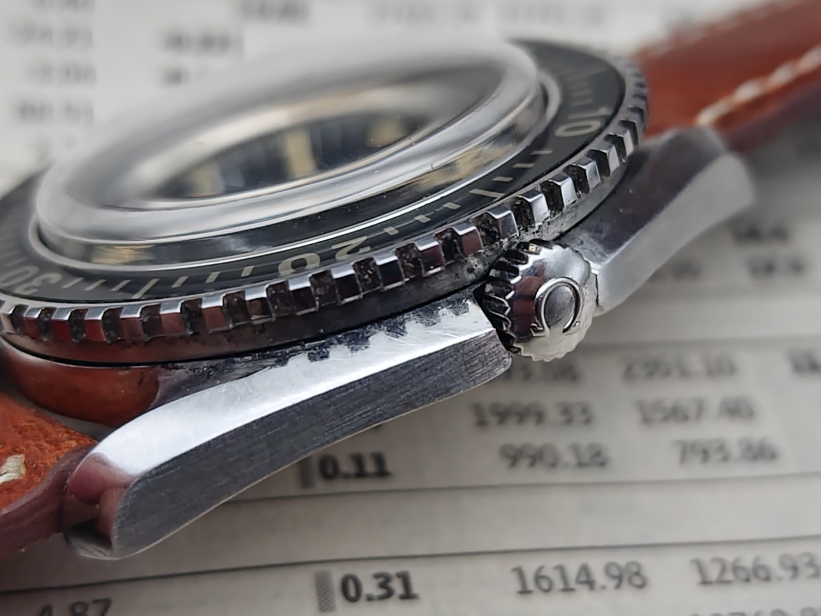

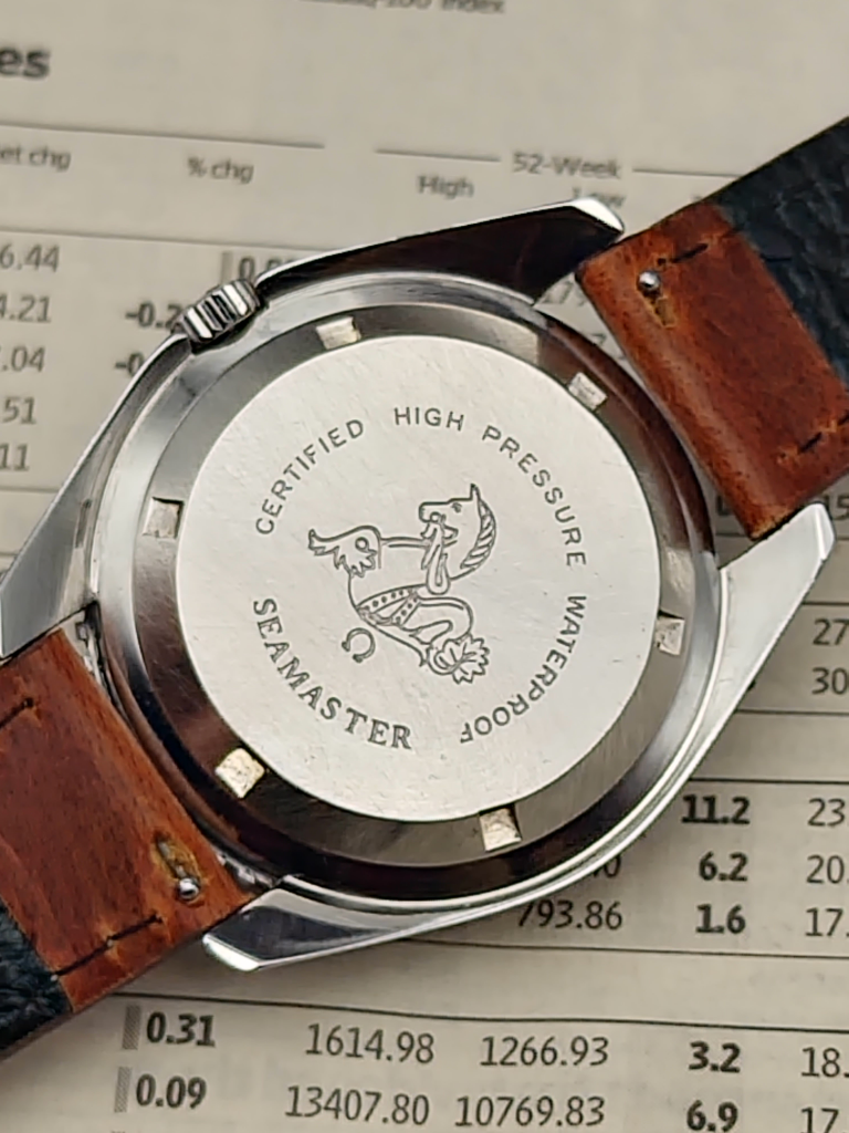

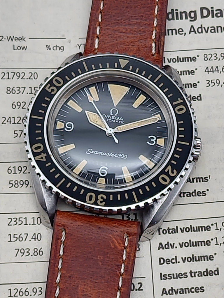

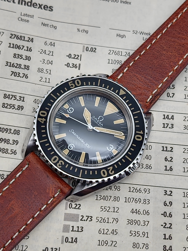

No expert here (and I don't think you need to be for this one), but there are numerous issues!
If you're suspicious, then your spidey-sense is correct!
Edit: someone beat me to my snarky response.
- Dial and bezel not genuine, and generally a non-genuine bezel goes with a non-genuine case....

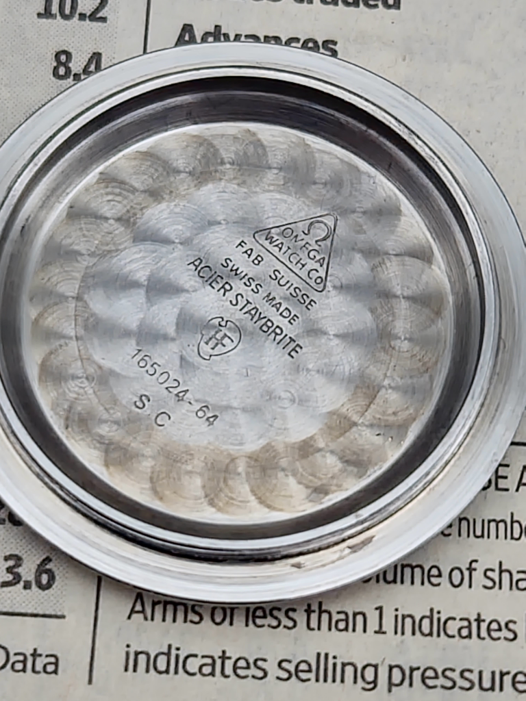

- Even if this was a genuine Omega, the bezel, dial, hands are all incorrect for a 164.024-64, or conversely the caseback would be incorrect for the rest of the watch. These are all moot points though given what has been said above. Stay away.
13,559
23,507
Certainly fake. Look at the bezel, caseback engraving, dial and font.

The movement is likely the only genuine thing about this watch. A 552 movement wouldn’t be hard or expensive to source. However, the movement in this watch never started life in a 165.024 and won’t produce an extract saying it did.
