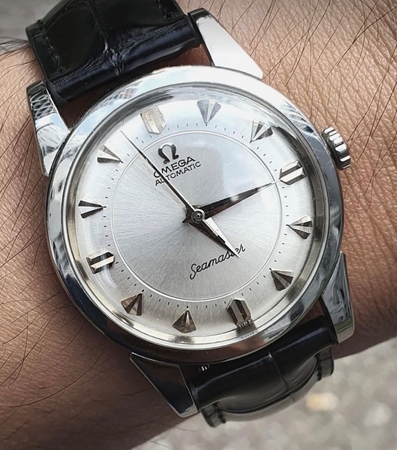

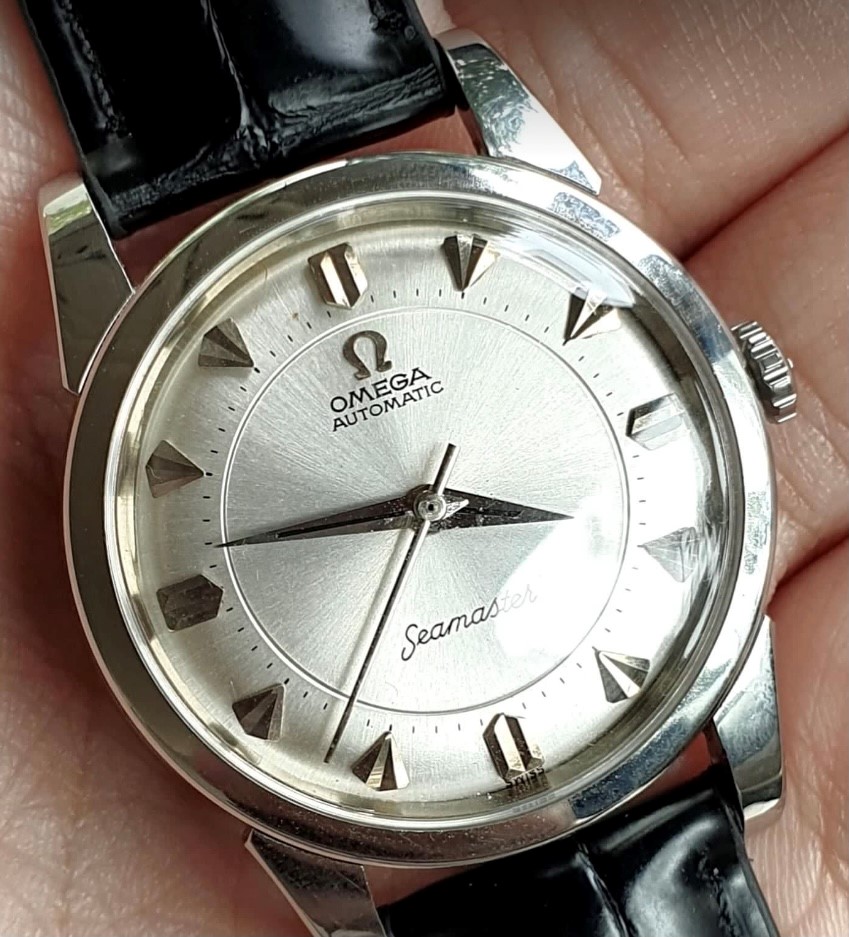

This is a new one to me and I cannot seem to find any similar pieces off the internet.
Go get it or run?
Any comments will be greatly appreciated.
Chye

Fake dial as far as I can see. The exaggerated sunburst finish is (apart from the actual layout) a red flag.
Have a link to it?

Thanks! These 2 are the best pictures I can get from the seller. It is very nicely done up though!

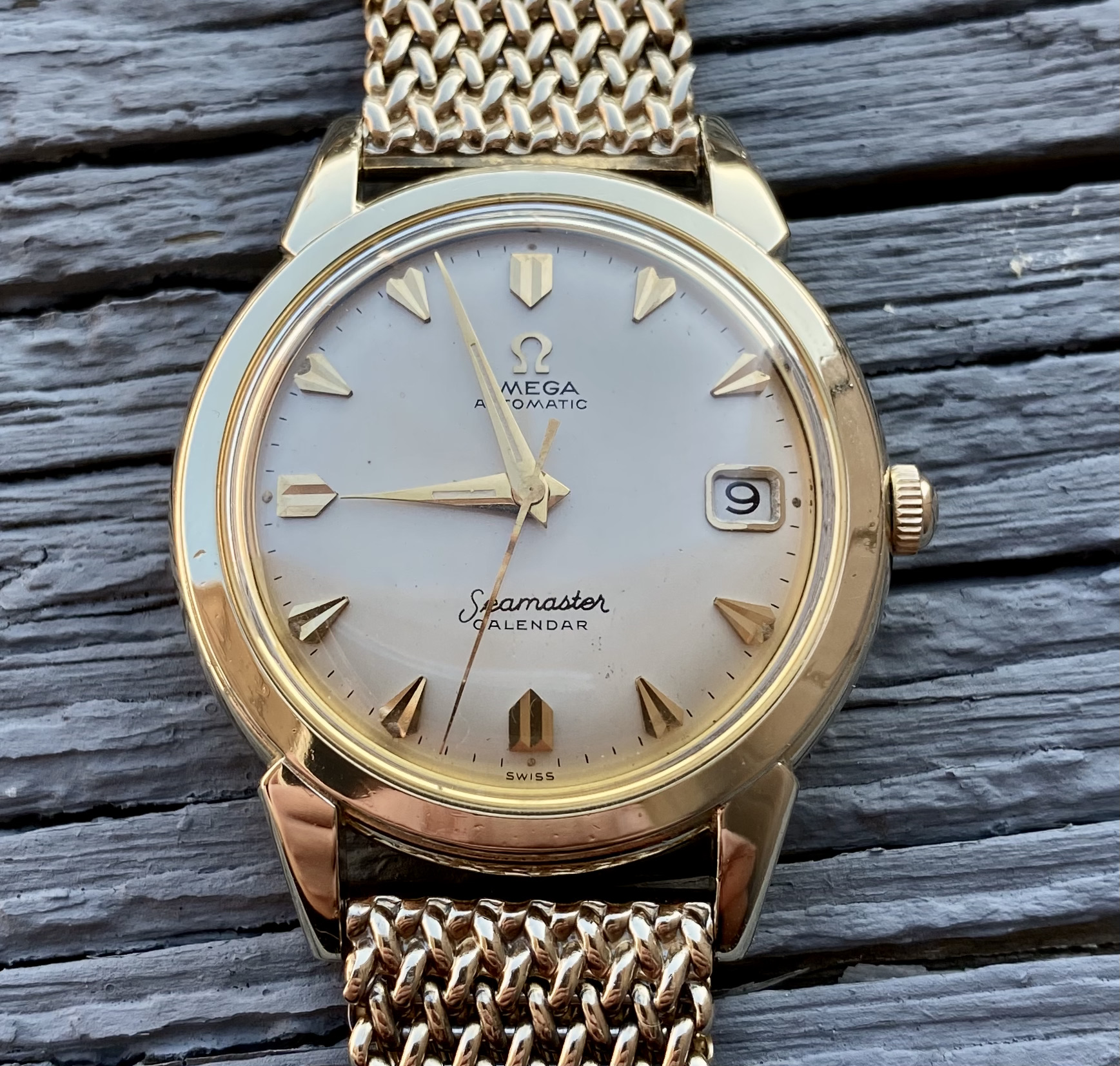

It might be refinished. Not typical of the period, that's for sure.
Mine to contrast. Note "Seamaster" was printed after the rest of the dial, that's why it's wonky. My watchmaker agrees with me, it is not refinished.

Smell fake IMO... Not sure if it is a distortion of the picture angle, but some of minute markers are not aligned to the hours applied markers... At 4 and 5 for example.

I've been coming to believe that this misalignment is less of an indicator than we think. I have a Lemania dial (Lemania was in the same comglomerate as Omega in the 50s and likely used the same dial maker) that my watchmaker tells me is original that is horribly aligned.
The huge difference: yours doesn’t have a sunburst finish. 50s case plus sunburst dial… my vote is with @ConElPueblo here.

Interesting, thanks for sharing the insight... Not sure my OCD will enjoy that though 😀
I'm 98% sure he's right. I did say it was not typical. 😀

It's not just the sunburst effect, it is also the inner ring which has no business on a genuine dial. When you see enough of these, the redone text by itself will be enough to tell it is a fake.

@ConElPueblo: Is the seconds hand correct ??? What do you think?
Not sure, but then I have never studied hands that thoroughly. I would have expected to see a hand without facets just like the one on @SkunkPrince's example.
Edit: never mind, looked a bit more closely on the first photo. Definitely not correct.

My hands are (OEM Omega) replacements, so I would use caution when asccribing originality to them.
Oh, certainly. The correct type would be more accurate.
