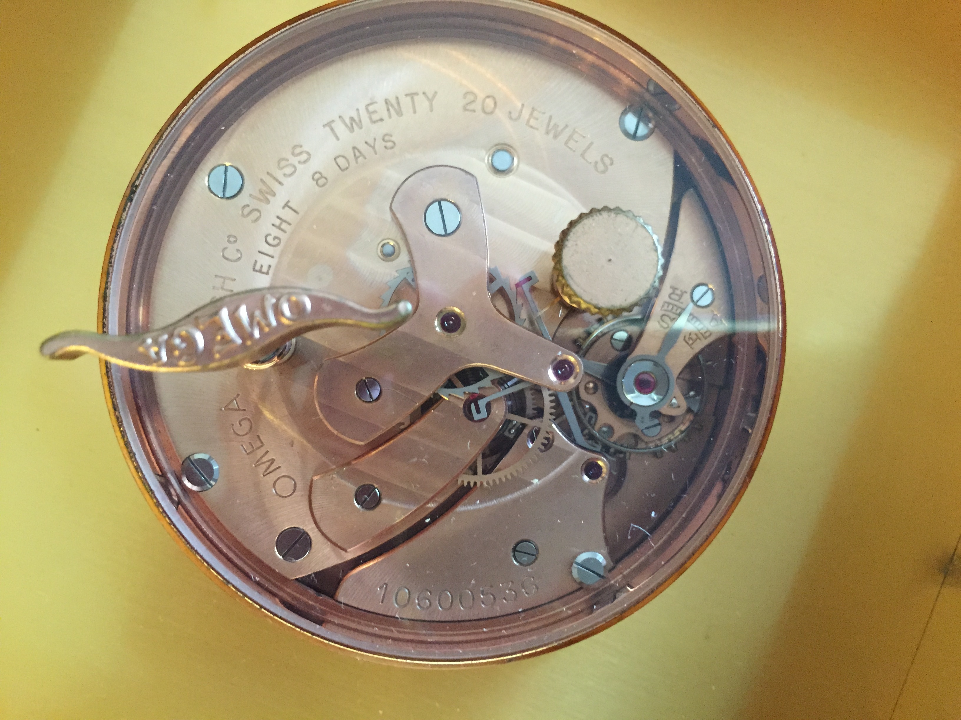

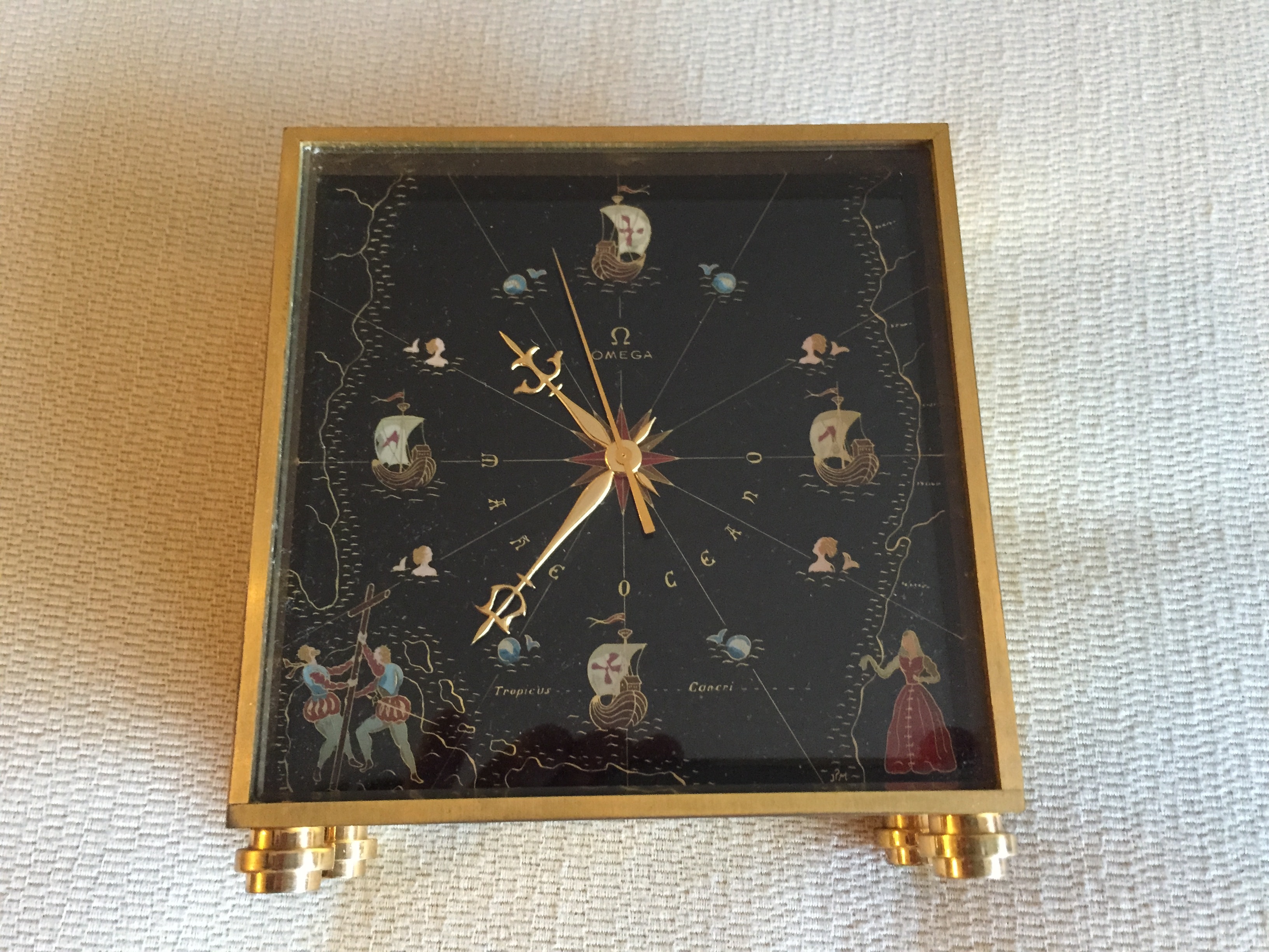

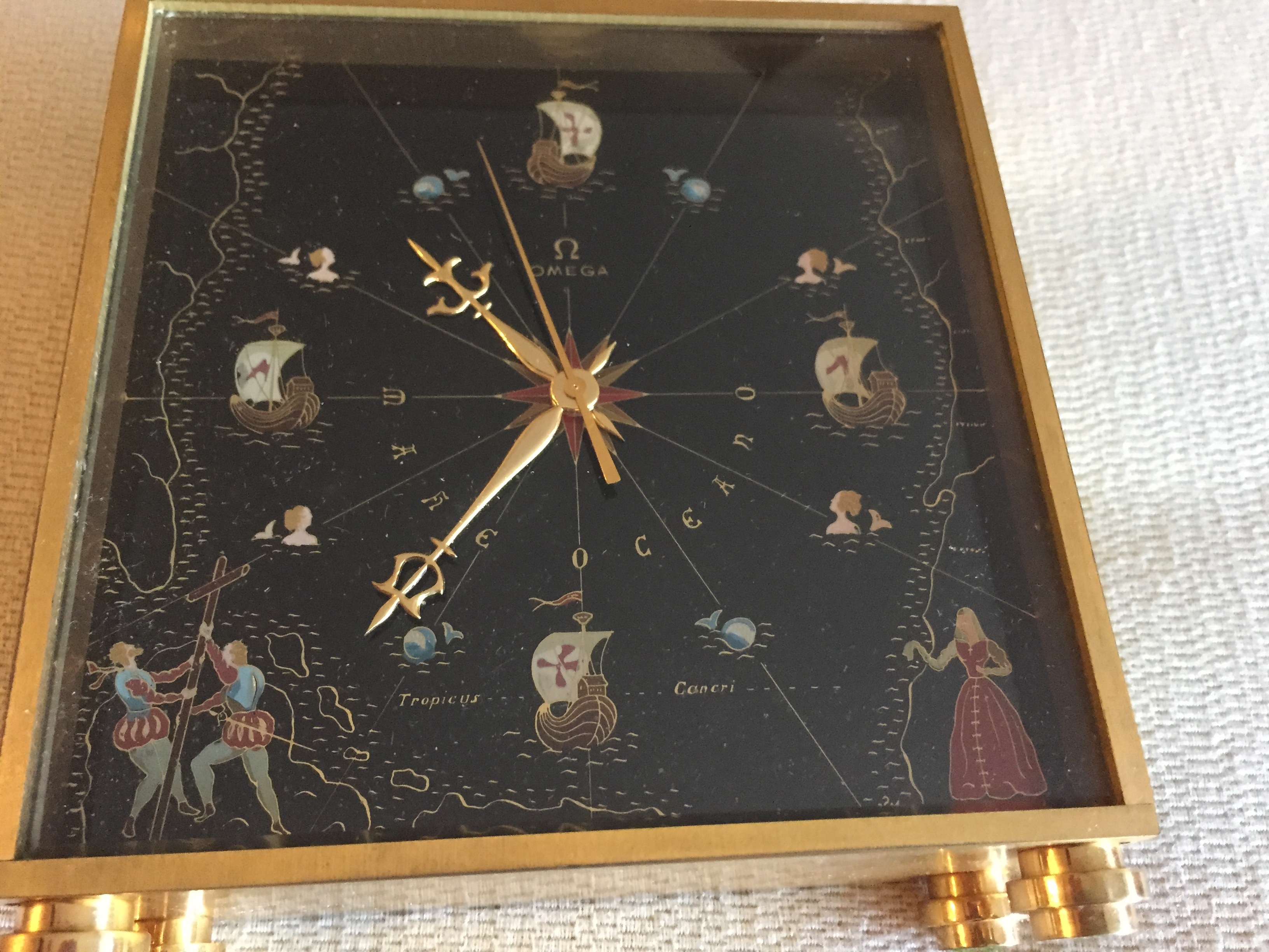

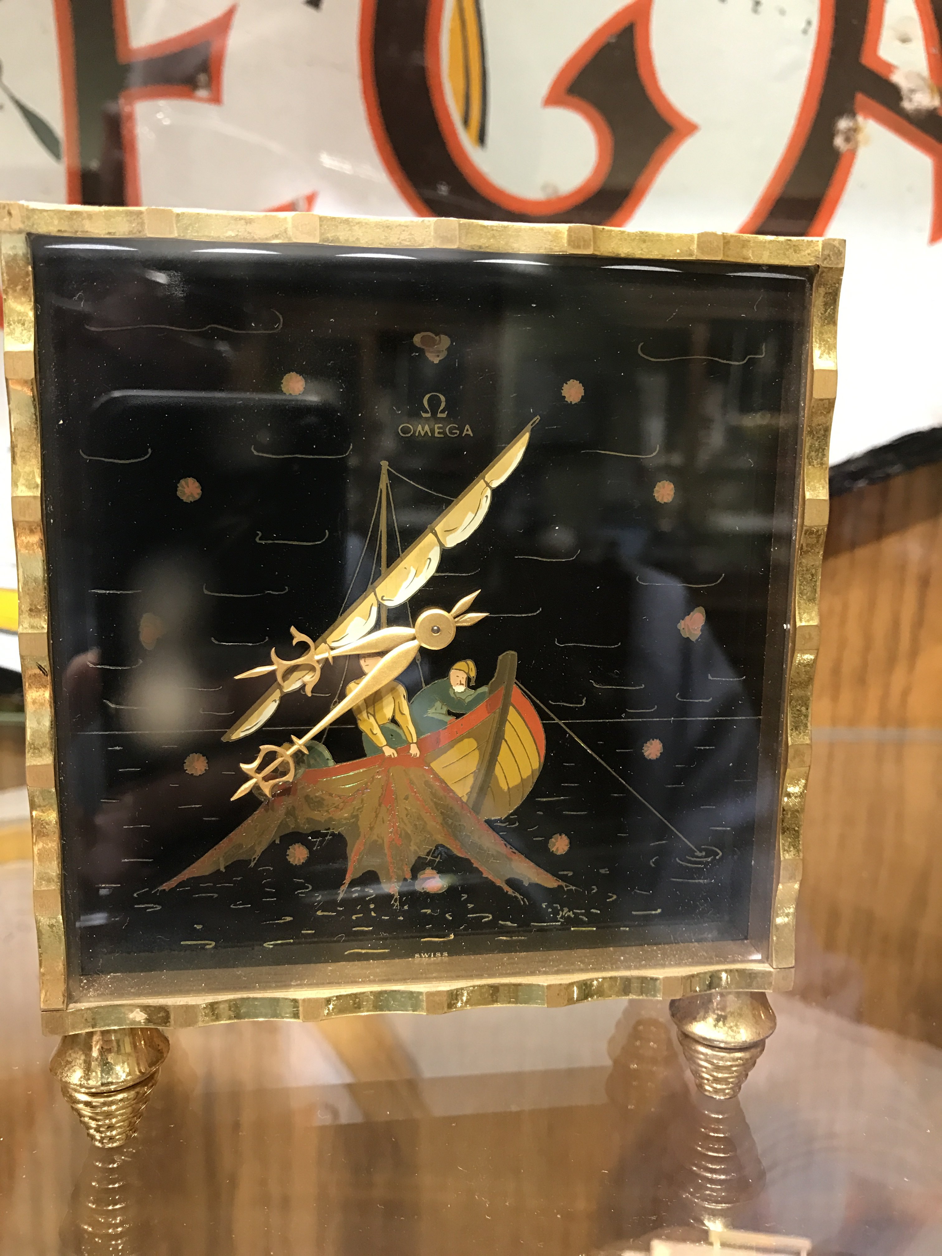

    I own the following Omega Table Clock.
    It has a golden case style with a black ocean background showing Columbus, Queen Isabella, Nina, Pinta, and the Santa Maria. It used to belong to my great uncle. We are from Switzerland and he bought it in Geneva. He was the original owner. I believe that he bought it in the 1950’s.
    Measure: 140 x 130 x 50 mm. It is driven by a high grade 8 day Omega caliber.
    Does anybody in this forum has any information about this clock? I researched different clock web sites in Europe and in the USA and I did not find a matching one! The closest one was on eBay at the following link:
    http://www.ebay.com/itm/Rare-Omega-Luxury-Table-Clock-with-8-day-movement-1950-s-/252004588726Purchases made through these links may earn this site a commission from the eBay Partner Network
    I have contacted Omega in Bienne, Switzerland, and asked them if they have any additional information and if the clock was included in the Travel through Time" Omega book from Marco Richon.
    Any any would be greatly appreciated.
    Thanks,
    Philippe

    Page 456 of "OMEGA A JOURNEY THROUGH TIME" (AJTT) shows a very similar clock, case and movement.
    However, the Chinese lacquer dial shown is not as detailed and ornate as yours but is in the same style.
    Researching the movement, it is either the 59 8-D SCS CLEF bull 20 p or the 59 8-D SCS T1 CLEF bull 20 p.
    Movement was built in the mid-40's (44-47) but could have been cased and sold years later.
    Very beautiful, but not really to my taste as I was in the Army and this is more a Navy man's piece!
    Joking aside, quite a nice clock!

  9. jacksandi Oct 5, 2016

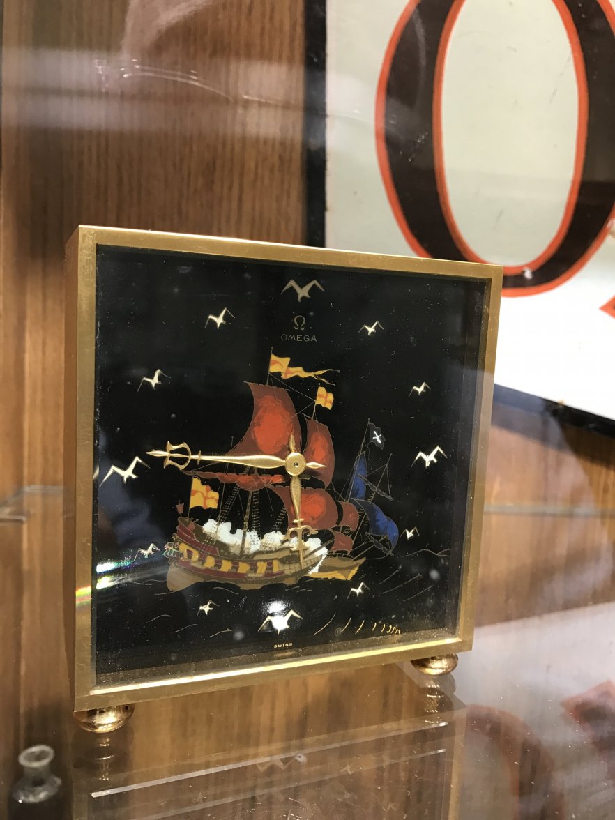

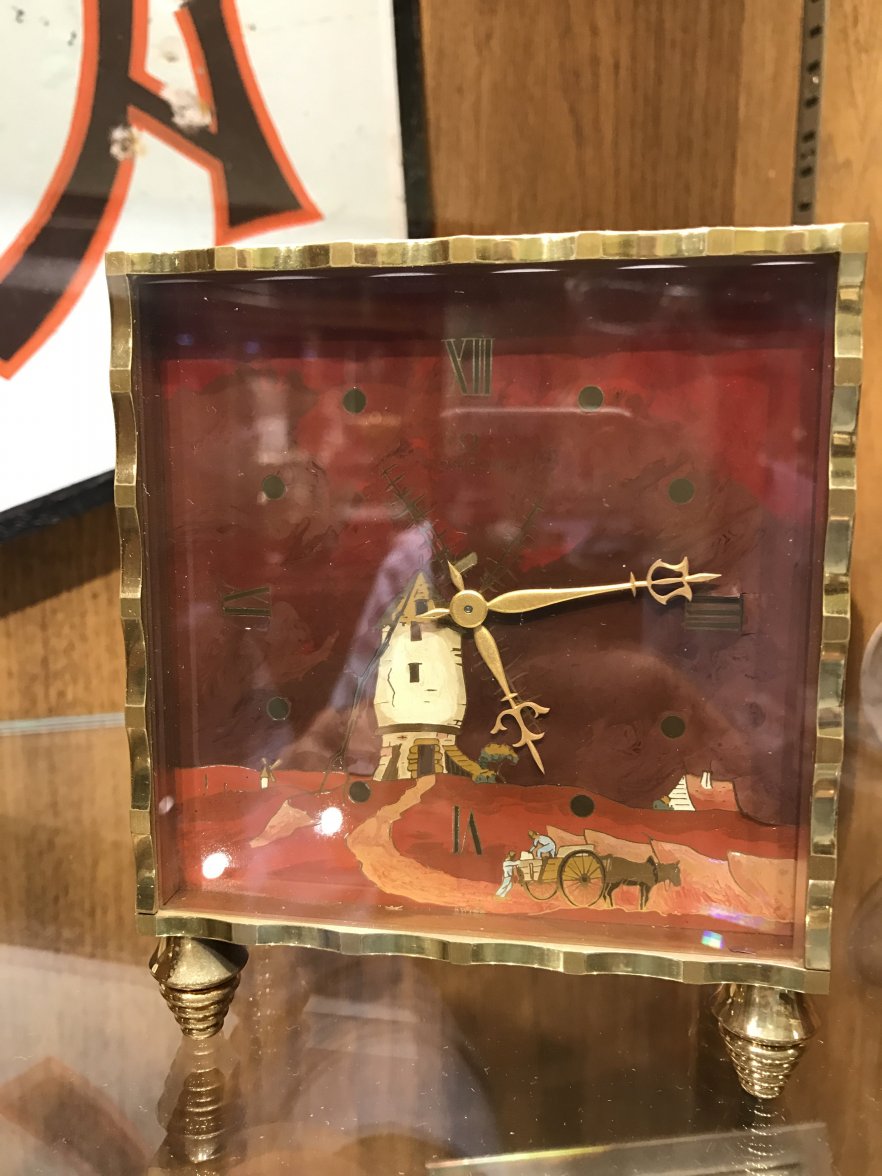

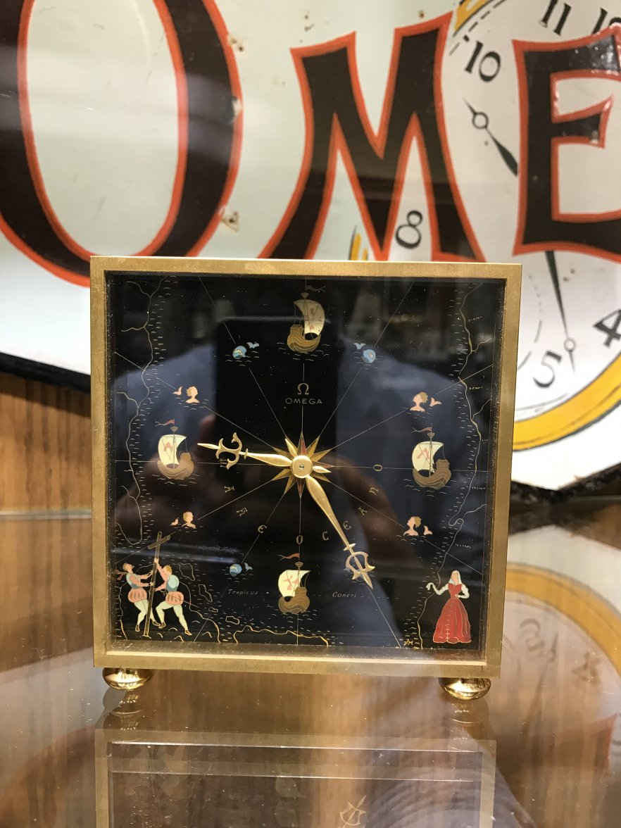

    here are the pictures my clock collections.

    Absolutely stunning!

  12. OMTOM Oct 6, 2016
    511
    1,306
    Very nice. Your four clocks are all Cal. 42.9 – a successor to the 59-8D SCS which is the version shown in the first post (from Gastronome). Both 8-day movements.
    The 59-8D SCS (later became Cal.120) was a two-barrel, 21 jewel jump-second Omega movement (developed from the 59-8D which originated in 1926).
    The 15 jewel 42.9 8-D movement was (clearly) smaller and was by Lemania. The dial was produced in various (even many) versions, sometimes ‘traditional’ and sometimes with a lacquered dial. Many of these were produced for the American market.
    The dials with a picture (all of yours) were signed at the bottom right ‘JPM’ – Jean-Pierre Matthey-Claudet, famous as prototype builder of the Omega Cal.30 and Cal. 30I wrist tourbillon. I understand that JPM set up his own business when he left Omega, producing these (and other) dials.
    As you can see, the dial in your second clock is the same design as the 59-8D in the first post (but smaller).

    Sorry. Error! It had 20 jewels! Tom
