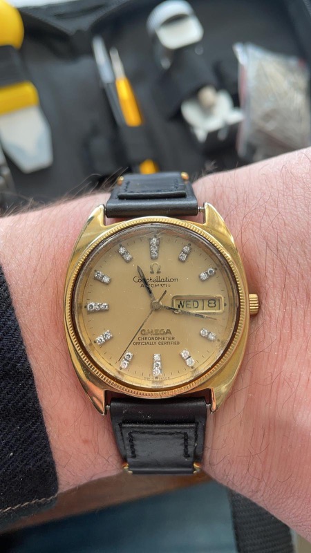

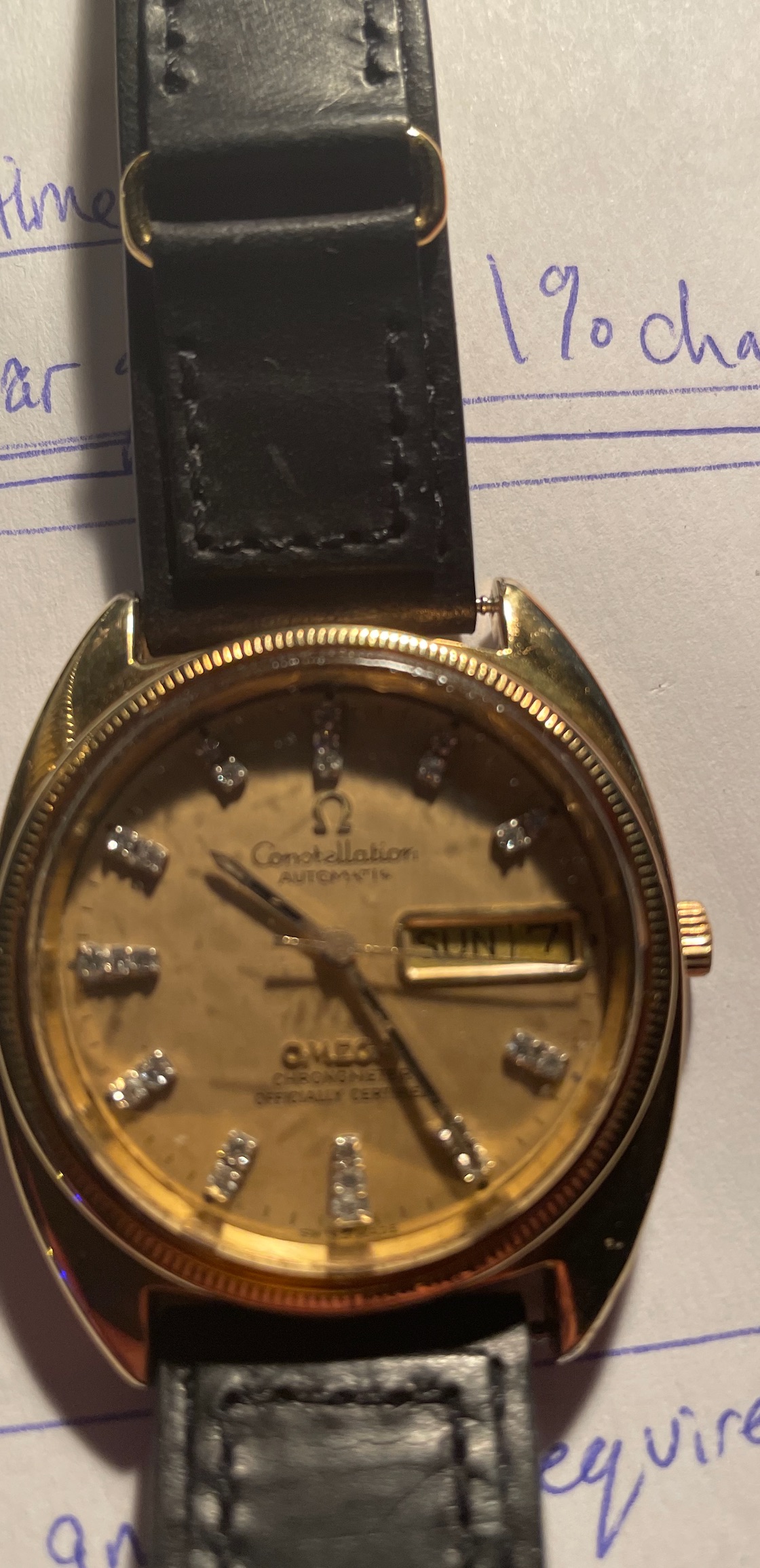

Shame you didn't post a better picture, cant really appreciate the dial.

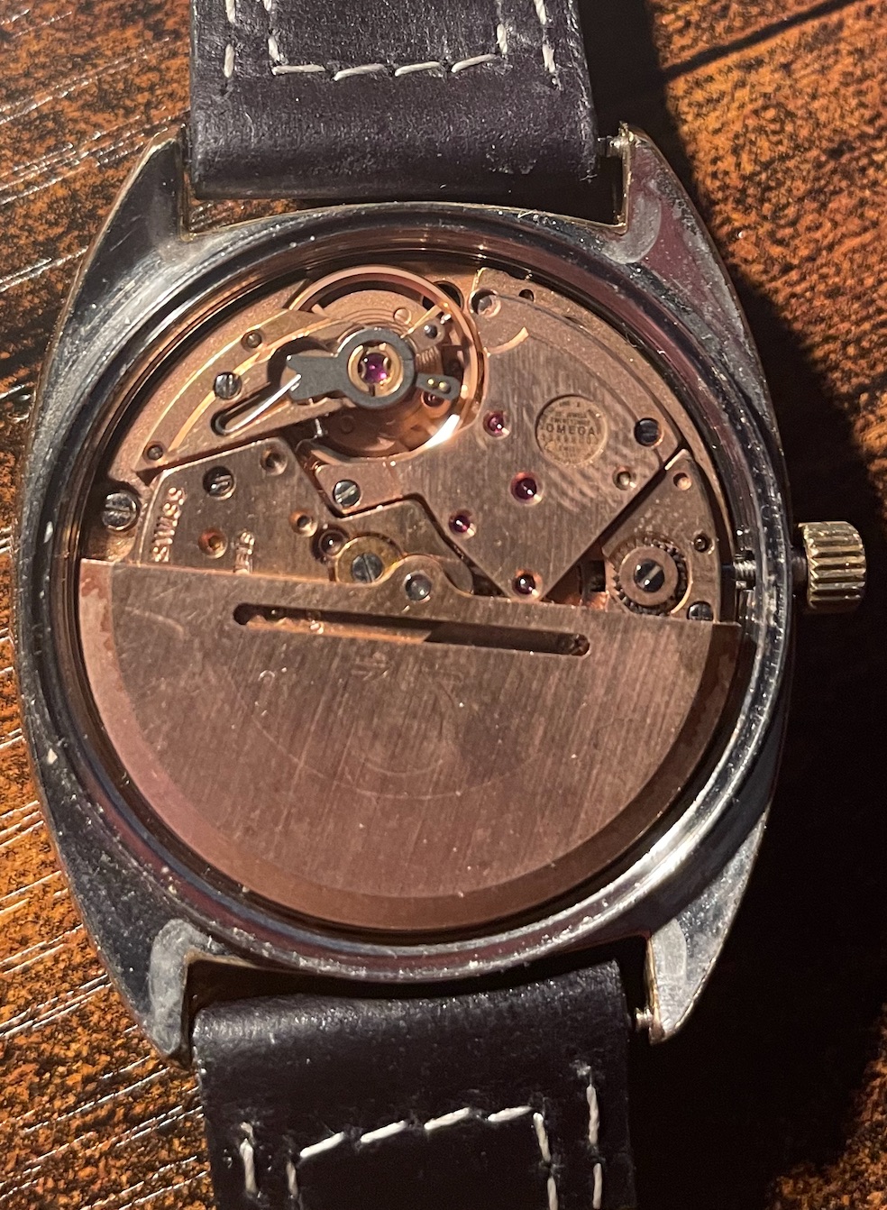

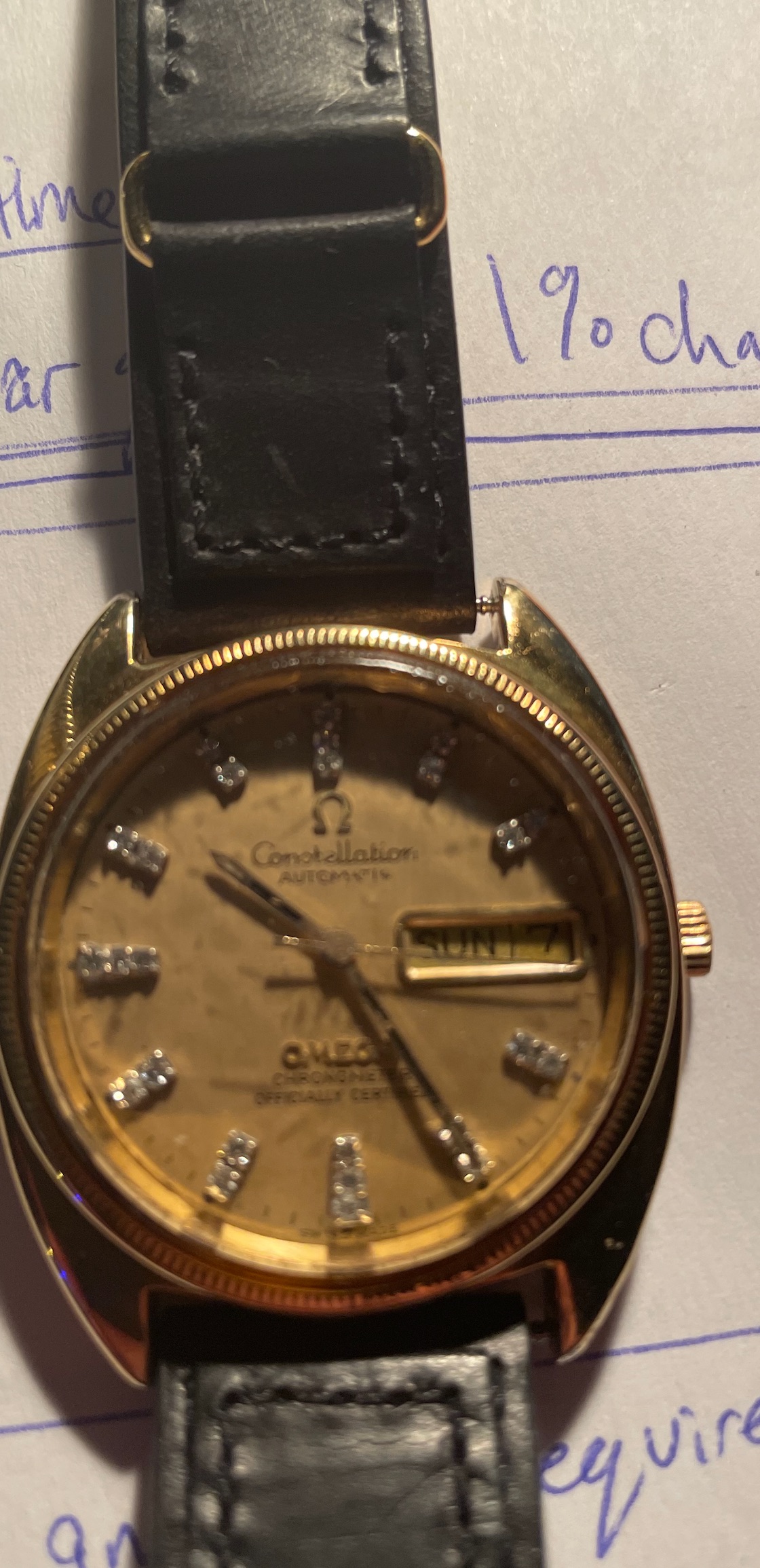

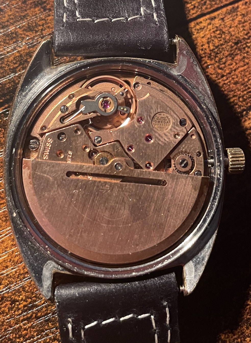

My thoughts are that it is a below average condition gold top C-case with aftermarket 'diamonds' on the dial.
I think only solid gold watches would have OEM diamond dials.

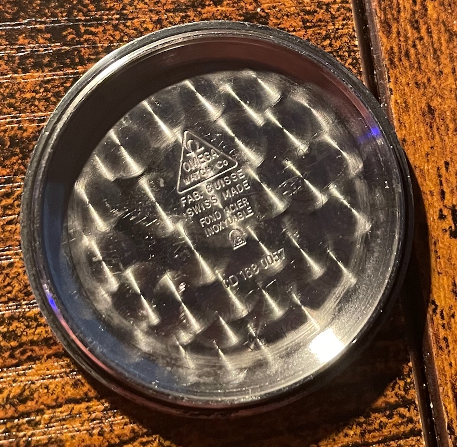

Even though the 1xxx series movements are notoriously plain and under decorated, that one is so low rent as to make me think it’s not chronometer rated at all. The 1021 has adjustments statements stamped on the plates so I don’t think it’s that, meaning it’s possibly a non rated 1020 or 1022 ie a Franken.
Whatever, it’s certainly not from Omega’s golden era and not one I would chase at any price.

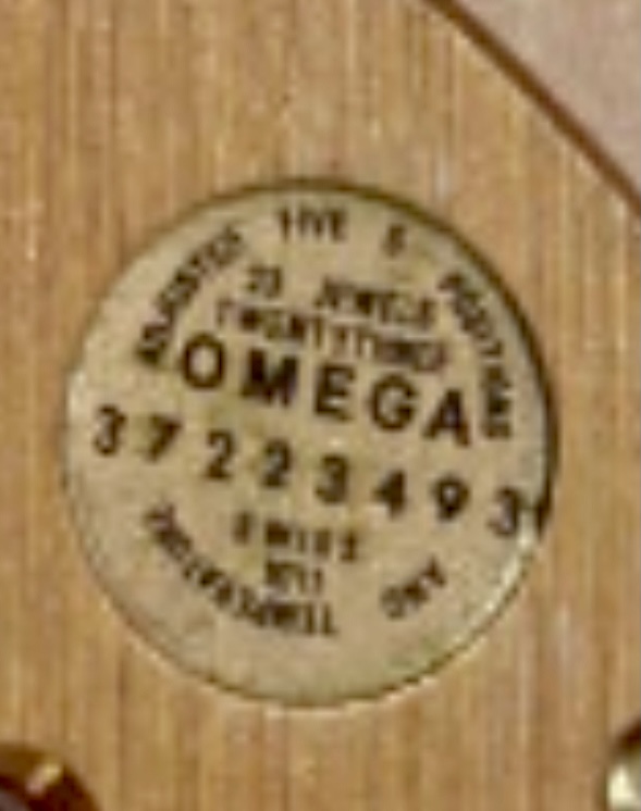

The adjustment language is printed on the sticker shown in the upper right.
Otherwise, there is no difference in the rated vs. non-rated movements.
This is 1970’s Omega cost cutting at its finest.

Yes, I looked again and it seems as you say the 1021 puts it all on the sticker, there is nothing else to differentiate. I would also add that at 37m the watch serial is later than 1972 (if that matters to the OP), more like 1973-5 by my rough estimation. Bad boi indeed, bad as in just bad!

Really interesting insight. The seller noted 1972 and I had absolutely no luck finding anything relevant to origins or comparables. I def know that the band is not original, but one thing that intrigues me is the 'diamonds'. I fully understand this is not an iced out version or some standalone piece of art for lack of a better term. Would you say the 'diamonds' are VVS1 quality, or anything to really talk about? You would think given the year and the cost they would be of somewhat quality. I am not assuming F's
Also, really interested in replacing the crystal on the front of the watch. Certified resellers I would peg at about $200+ and I was thinking of attempting myself, was thinking roughly $75. If anyone knows where I can get or be navigated closer to where I can find the replacement would be greatly appreciated!
As I said above the 'diamonds' are very likely a later aftermarket addition to the dial.
I'd be extremely surprised if anyone would be able to confidently evaluate the 'diamonds' on the dial based on that terrible out of focus picture that you provide.
I personally would not pump any watch into this watch at all as it would be very very hard to recuperate it later
Note that the picture I posted was from another watch (in fact a cal. 1011, not a 1021). The movement picture provided was too out of focus to use.
To the OP, there is no question in my mind that the “diamonds” on the dial are after market. You should take the watch to a jeweler who can ascertain if they are the real deal, paste or cubic zirconium. None of us are going to be able to tell you anything from a 2 dimensional picture.
Regarding the crystal, I would recommend spending $10 on some Polywatch (google it please) before changing the crystal. If there is an Omega symbol in the center, than at least it is likely a factory crystal.

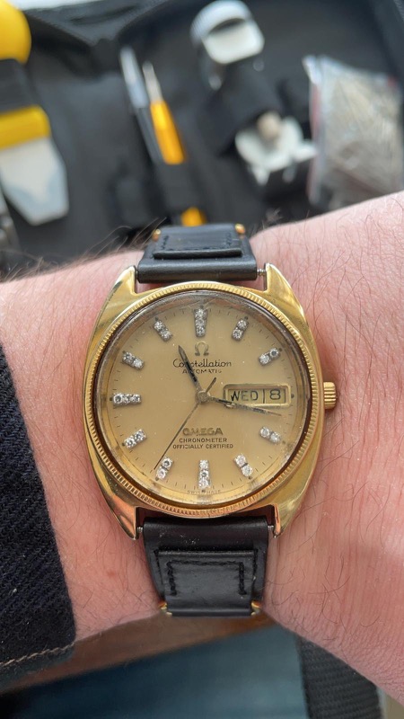

Would also note the strap is too small 🤔

I believe cicindela meant the strap is too narrow for the space between the lugs 😉 Should have been another ~2 mm wide.

It's a clear half ass fix. I've confirmed the 'diamonds' are aftermarket which is fueling the conversation.
