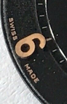

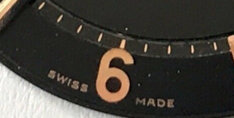

The printing of "Swiss Made" also looks fuzzy.

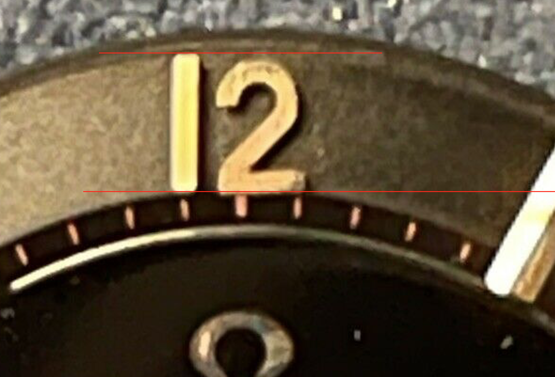

This dial looks very problematic to me. Scripts & serif are a little bit too thick, and markers have been removed before.
At first glance, i just thought the "12" looks wonky. "2" looks a bit droppy with abit of tarnish and not aligned with the shiny "1".

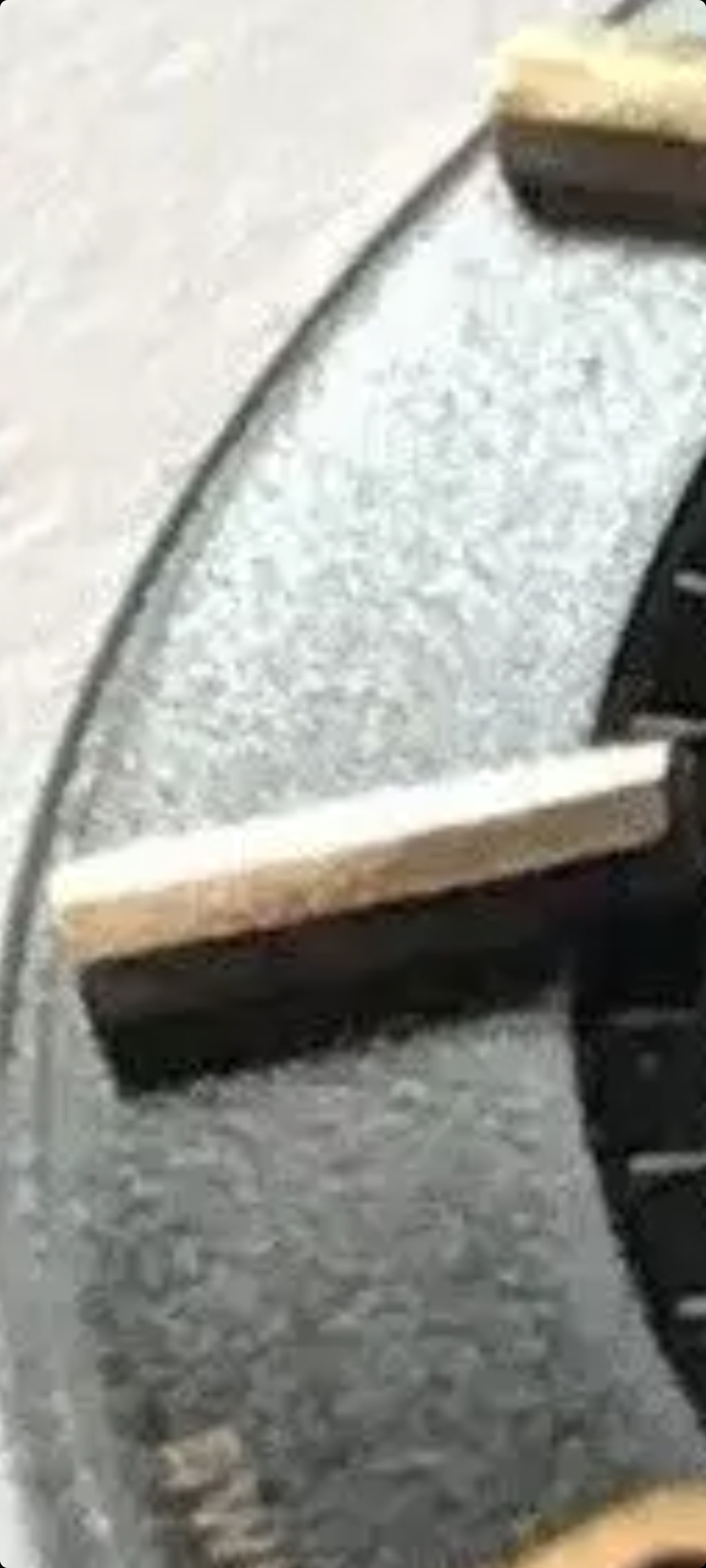

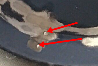

interesting that you mentioned the markers have been removed before. may i know how do you spot that?

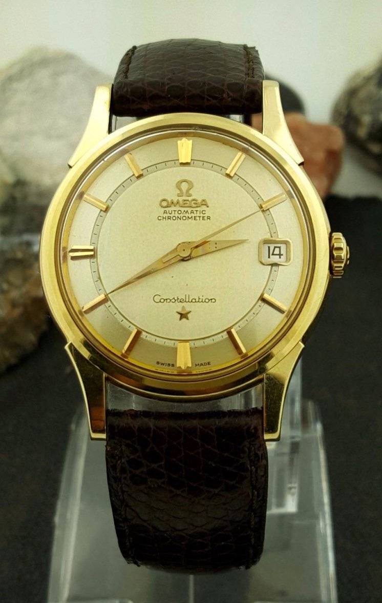

From my research about 1 year ago, I couldn’t find any black and white dial without lume.
I found only gold version that can be (example posted by @Peemacgee )
Looking at the back of the dial we observe that the posts that hold the numerals/markers are clearly seen. If they had not been removed they would had blended with the rest of the dial.
