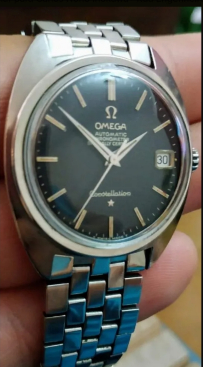

Dear fellow members of OF,

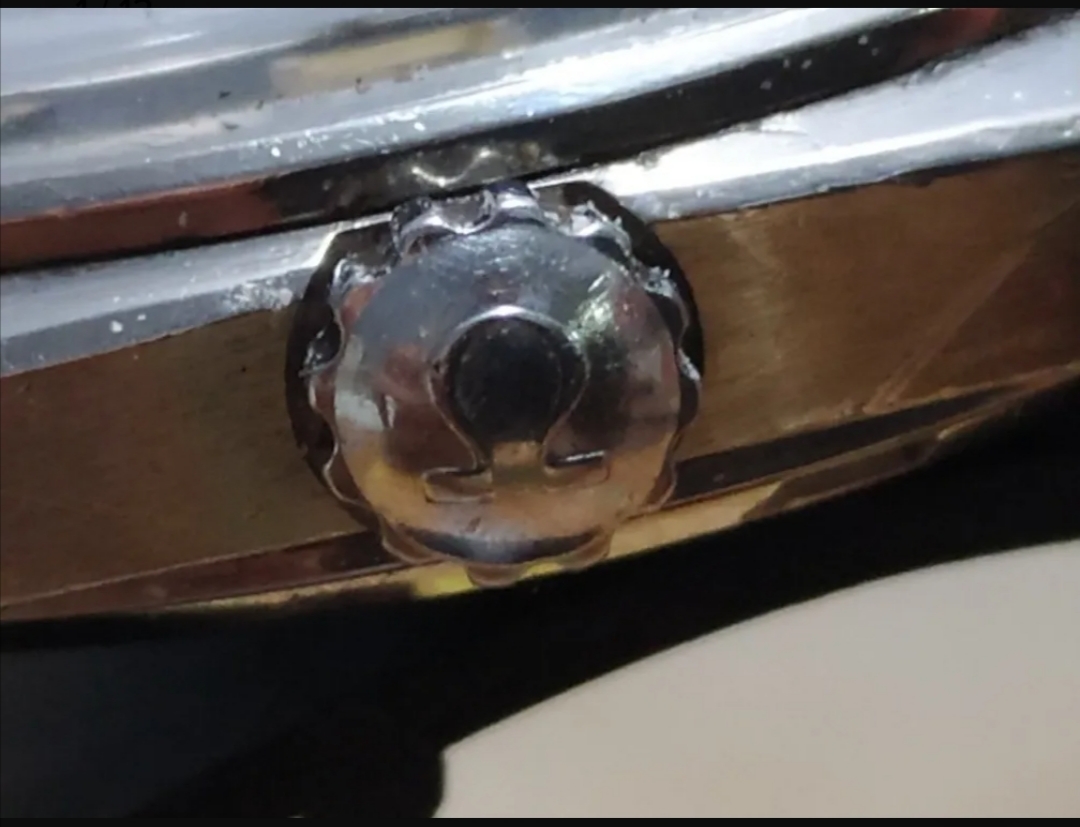

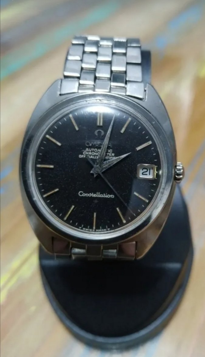

I hope everyone is doing alright. I come again to ask for help before pulling the trigger on this one.
I was browsing through the old market where I bought my first three vintage pieces with your help and fell in love with this C-Shape Connie.
This is a Connie ref. 168.017 with a black dial and cal 564.
It is my understanding, that this black dial version with the dolphin hands, tritium lume markers and the very short crown is quite rare and I was even inclined to think it was either redial or franken. But I did find a couple more examples of it in the internet in the end though.
The fotos provided by the seller, who is not a dealer, are quite terrible and I apologise.
I think it is safe to assume it is not a redial, and the 564 chronometer movement does not seem abused. However, I would very much like your feedback on the watch in general. Maybe I am not seeing something. I do see the case condition is not the best, but I still feel attracted to the watch. Even though they are not common, I believe the dolphin hands are original and belong to this piece.
Like some other examples I brought in here, the asking price is very low and that makes the purchase both tempting but suspicious at the same time.
Thanks in advance, people.
16,305
45,025

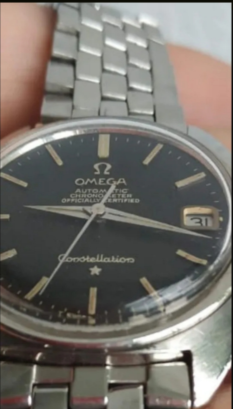

It would be nice to see one sharp picture of the dial- they are all out of focus.
I don’t see any red flags here. I was looking for the lume pips at the end of the markers and can’t because of the burry photos, but I can see one next to the date window at least that one is there.

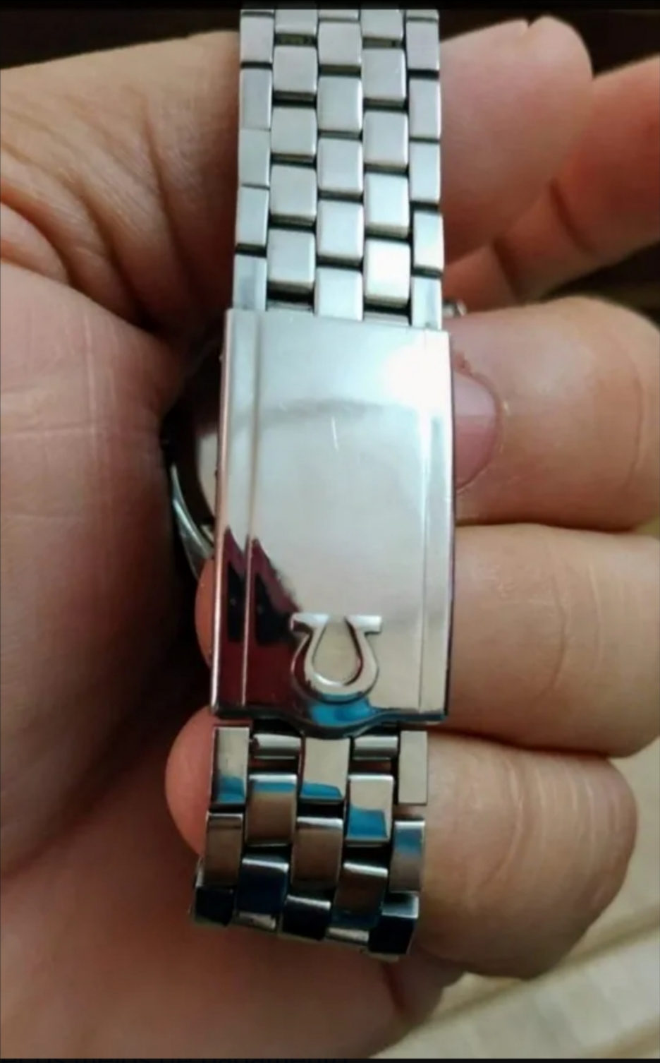

Can’t tell if the case still has its brushed surfaces- that would be a deal breaker for me if it has been polished smooth unless is was dirt cheap- then I would have it rebrushed. Bracelet looks to have been polished to high gloss which is not a good sign (again- it can be rebrushed but the original factory finish is gone).

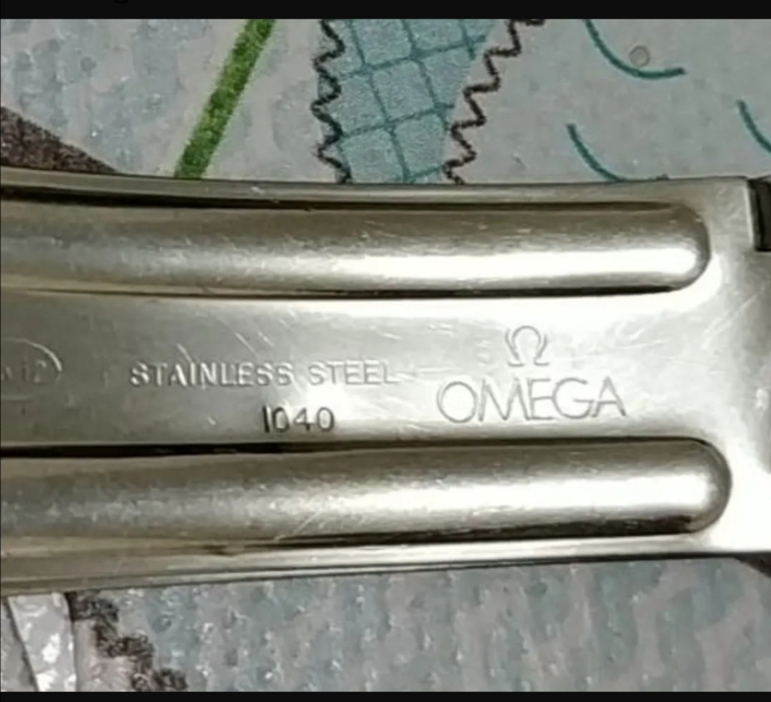

It has the bricks bracelet which is a big deal (that adds $200+ to the value), but you need to verify size- extra links are not easily available for these.
Dauphine hands were used on the earliest C-cases if memory serves, not sure if that crown is correct- mine is a later style.
It looks legit, and would be a fine daily wear- but I wouldn’t pay a collectors premium for it with the condition issue and apparent polishing of non-polished surfaces.

Thanks a lot for the input. I do miss the brushed finish on the upper side of the case and it is a pity given that it is part of the charm of the design of the C-Shape Connies. I didn't think it would be possible to get someone to brush it (cool idea) and as a matter of fact, I was indeed thinking of buying it to wear it and just enjoy it and beat it around. It is being offered for just 400€, which for an original Connie with a 564 movement, even with a polished case, sounds to me quite appealing.. 😬
I thought the tritium lume was there inserted inside the hour markers, right? There is a faint stripe on each hour marker. On the first foto one can see it. Was that not the lume?

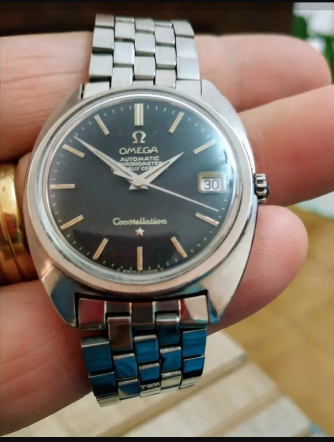

€400 isn’t bad considering the dial seems to be in good shape (can’t really see it well)and we assume it’s running- but of course will need a service.
Any watchmaker can rebrush- the key is getting the specific finishes right and the correct grain (not too course). The bezel should have a semi-course radial brush that plays the light, the case an almost sateen curved brush that follows the case lines, sides have a horizontal strait brush- slightly courser than the top, and bracelet a linear brush like the sides- and don’t forget that ever so important chamfer between the top and sides that need to have crisp lines....these watches are so sexy!
I really can’t see in those pics- but I can’t imagine they have been redone.

And you are wondering if it's worth it? Old watches and their bracelets were sometimes <gasp> repaired and re-polished. Don't get hung up on that or you will start missing out on all the fun in this hobby. However there is hope for those that carry a microscope under their arm as the malls are full of watches with their original finish.

I agree, for €400 it looks like a nice watch. Any watch that had been for service within the last 70 years probably got hit with a polishing wheel- sometimes it was done well and sometimes not. When a watch that was entirely brushed has been polished to a gloss and crisp chamfers have been polished soft (this one still looks pretty good) , it no longer looks like it is supposed to. The finish can be reapplied if it’s hasn’t lost too much material, but it loses some of its value in terms of “collector” value. That is important to some collectors, to others it isn’t.
If the seller wanted €1.5k, I would say pass, but at €400 plus cost of service and having the case & bracelet rebrushed- it’s not a bad deal.
