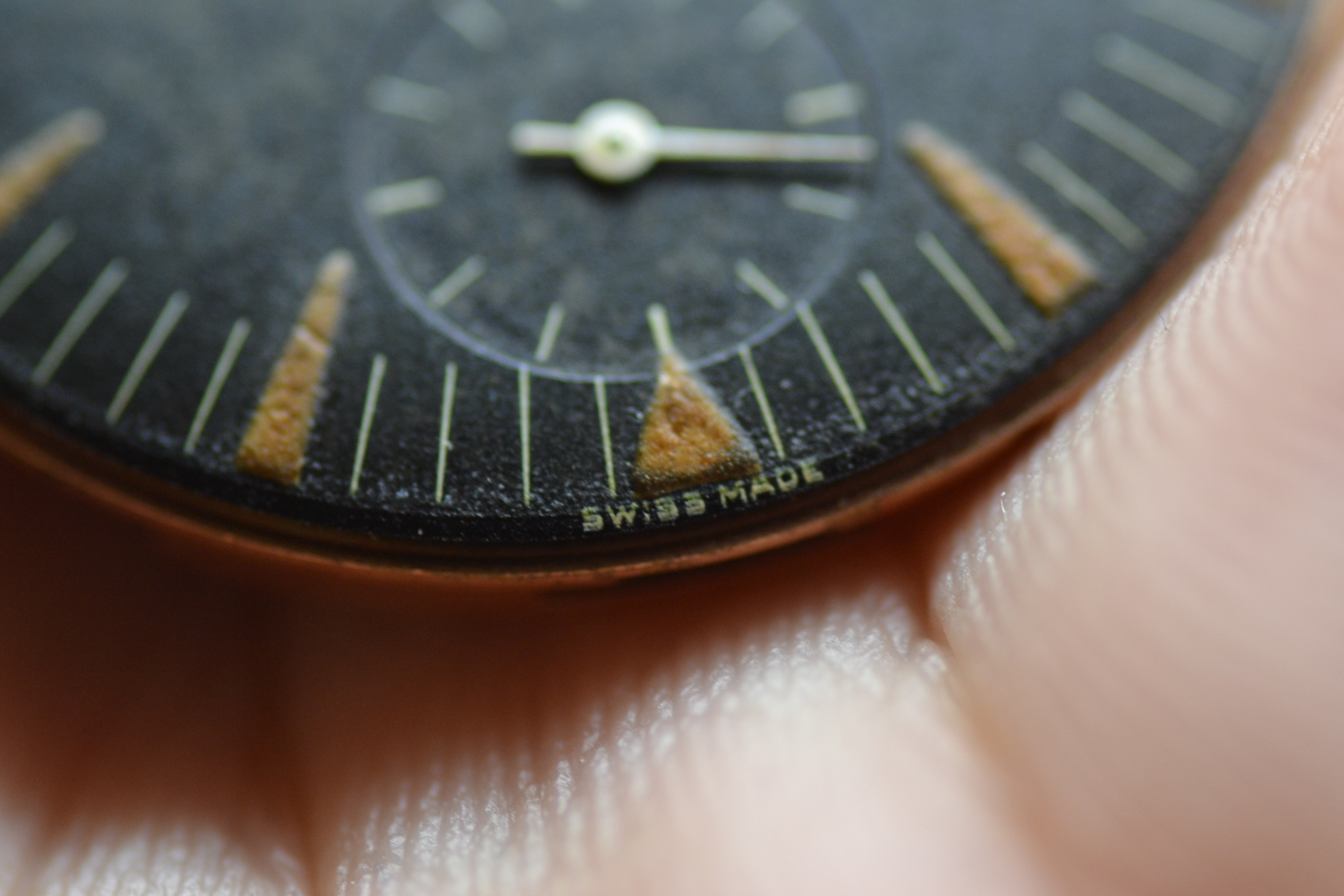

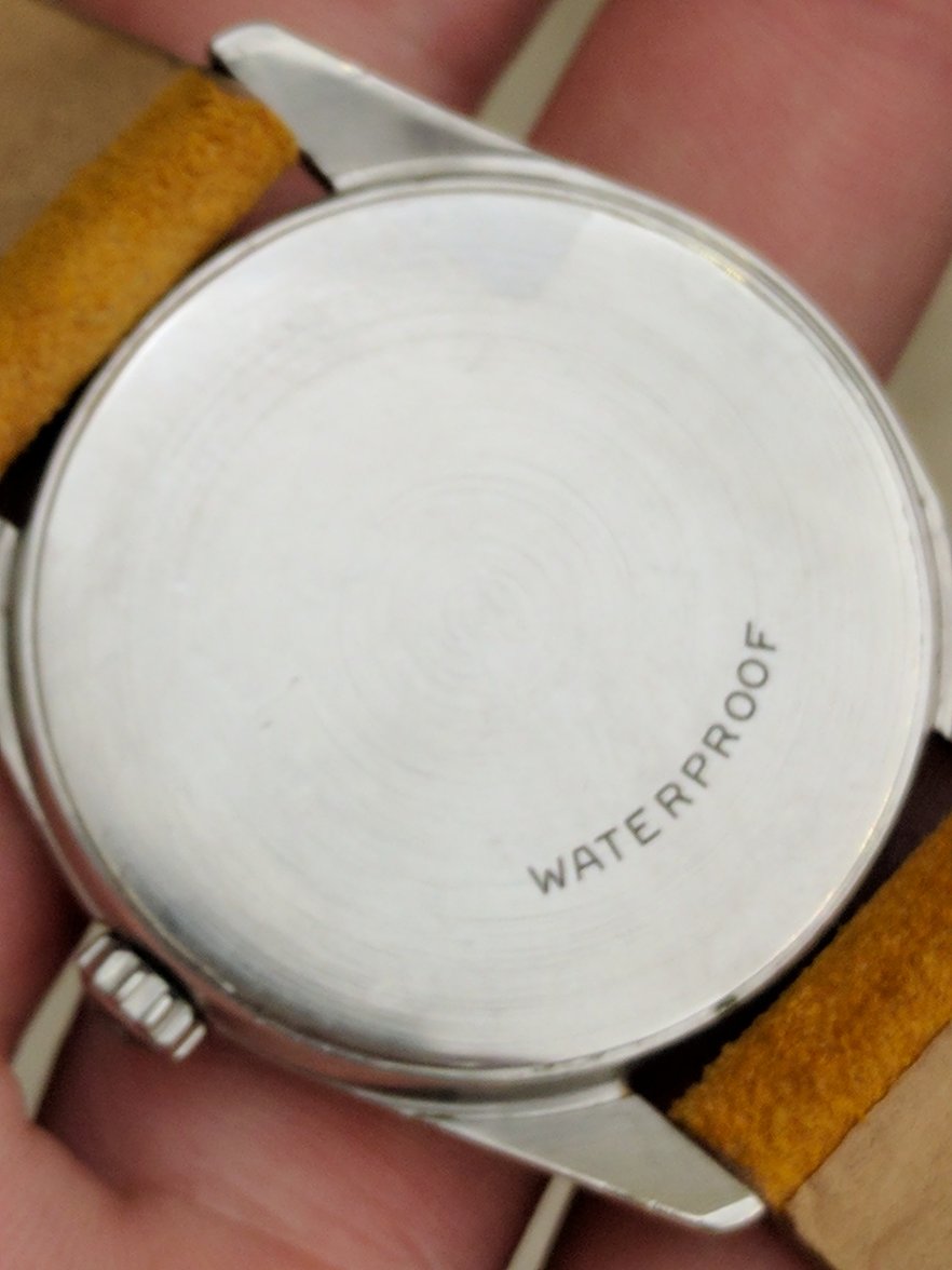

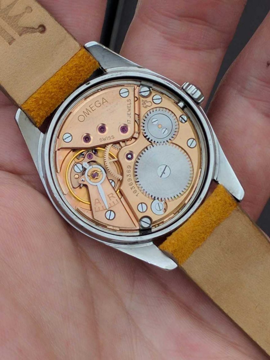

    Hi All
    I am extremely interested in buying a Ranchero from an Italian Dealer but am only too aware of the countless pitfalls involved in such a purchase - please find attached pics of dial/movement/crown etc. - please can the experts have a look and advise?
    All looks good to me but would be a big purchase (+-USD7000) - what do the esteemed members think?
    Many thanks in advance. ranchero dial 2.JPG ranchero dial 3.jpeg ramchero movement.jpeg ranchero caseback.jpg ranchero crown.jpg
  2. Dgercp Jun 5, 2017
    1,072
    1,454
    Looks correct to me.
  3. redpcar Jun 5, 2017
    3,699
    7,910
    price is shocking :eek:
    Watch ......errr timepiece looks correct. 16,3xx,xxx movement puts it at 1958.
    Let me know if you buy it, that way I can raise the price of mine :whistling:

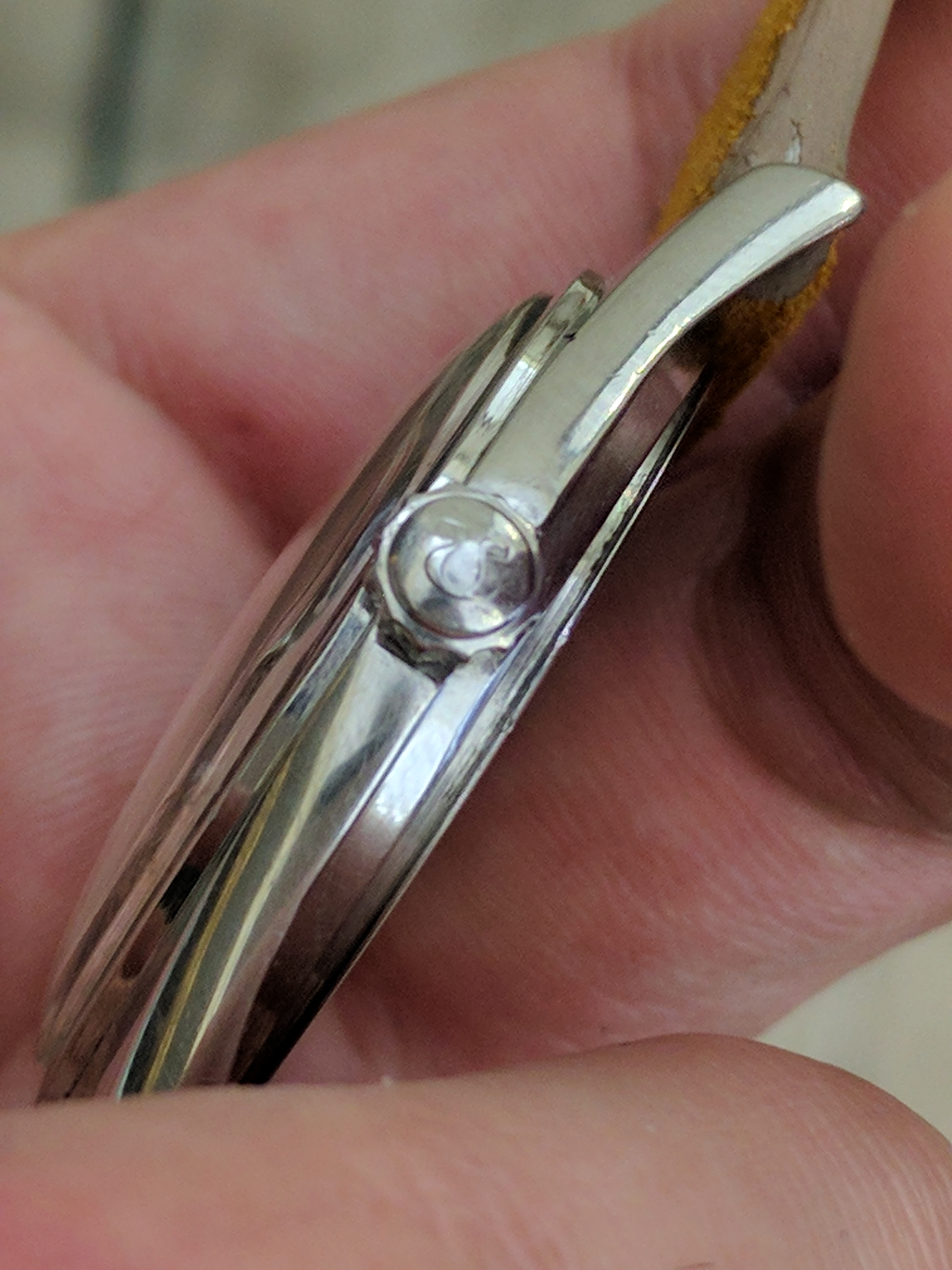

  4. gemini4 Hoarder Of Speed et alia Jun 5, 2017
    5,855
    16,584
    I think watch is ok except for the crown

  6. Kippy Jun 5, 2017
    43
    24
    Thanks but what is wrong with the crown?
  7. gemini4 Hoarder Of Speed et alia Jun 5, 2017
    5,855
    16,584
  8. Kippy Jun 5, 2017
    43
    24
    Maybe I am missing something but the crown looks very similar to the one in the article you linked?
    Apart from saying that the price is shockingly high - can anybody please give an objective response linked to recent sales as to what would constitute a reasonable price? Many thanks!
  9. redpcar Jun 5, 2017
    3,699
    7,910
    Look at the knurls.
    gemini4 likes this.
  10. JimInOz Melbourne Australia Jun 5, 2017
    15,492
    32,382
    FIFY
  11. redpcar Jun 5, 2017
    3,699
    7,910
    Scallop
    Knurl
    :D
    micampe and gemini4 like this.
  12. Kippy Jun 5, 2017
    43
    24
    Okay point taken - thanks! How much does a non-origjnal crown affect the value?
    Appreciate all the advice and comments so far!
  13. Temprus Jun 5, 2017
    282
    123
    Not much. I think crown + new stem could be found at $100 -$150.
